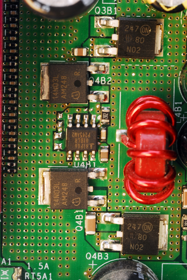

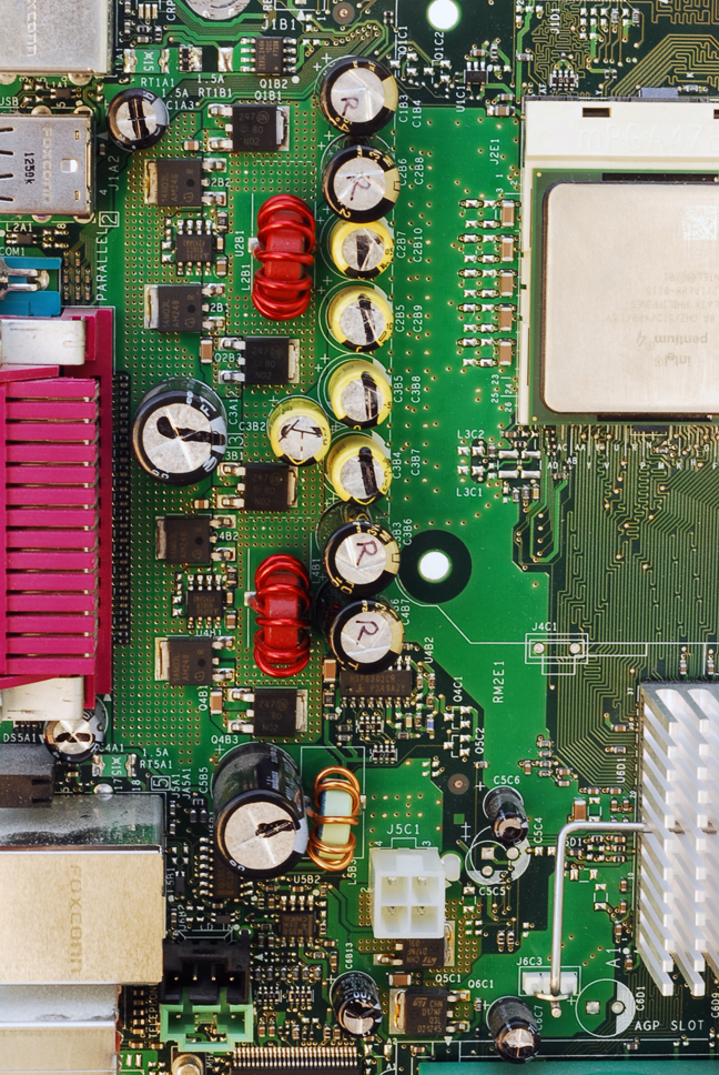

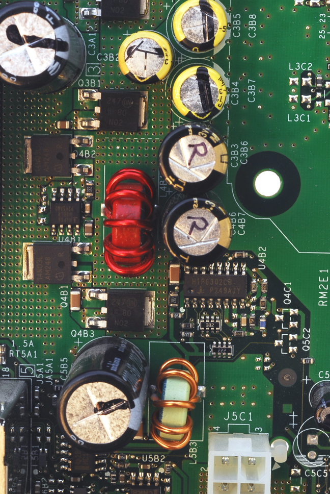

      Dell Dimension 4550 VRM, i845 chipset.
      I'd like to start a visual tutorial 101 of the VRM using these photos. I'm trying to tie this back to AKOR's vrm troubleshooting pdf file. As comments are added, I will update the photos with text and arrows.
      Q: how many phases, why?
      Q: where are the meter test points for basic dianostics
      Q: where is the control IC (buck controller?)
      Q: differentiate the MOSFETS shown, and why they have different voltages
      When I have it all done, I will make it available as a tidy PDF.

        Two phase VRM, two top FETs and two bottom FETs per phase.. VRM phase inductors are the two large red ones, the smaller green one is part of the +12V input filter.. The VRM controller IC is the HIP6302CB right next to the lower VRM phase. The little chips that are between the FETs for each phase are what actually turn the FETs on and off.. The 4 FET's that are in a vertical line, furthest to the left are the top FETs that pull the switching nodes up to +12V, the 4 FET's that are in the next "row" to the right, flanking the two Red Phase inductors, are the Bottom FETs, that pull the switching nodes to ground. The two Red phase inductors couple the switching nodes to the Vcore plane and the row of low voltage output caps and MLCC's by the CPU socket..
        I prefer to probe Vcore at the inductor outputs, but that may be difficult on this board due to the close proximity of the output caps.. You can check Vcore on the inputs of the phase inductors, but there may be more switching noise there, as that's the switching node.. There are a few MLCC's left off, but the CPU heatsink will cover those, otherwise that would be a perfect place to check Vcore..
        To check the FET's in operation, you would need an oscilloscope.. But if the board has no power you can check for shorted FETs...
        Each pair of top and bottom FETs are in parallel, to double current load capability..

          This is a tutorial, so please spell out how to test shorted D2PAKs. I don't understand MLCC. I want to do as many checks in-circuit as possible before desoldering components and chasing a wild goose.
          With the PAK oriented East-West, I find the NE leg to be Output, and the SE as Input. The absent middle leg is apparently tied to the base. I measure voltage from Base to Leg. Probing a working KG7 board with a 3+3 FET layout, I found the outputs of 1 group at Vcore, the other at Vdimm. Measuring across the associated caps show the same voltages.
          AKOR's Diagnostic Procedure
          Referencing AKOR's diagnostic procedure (A), where in these photos would one measure for resistance between the VRM input and ATX24 pins?

                    Try touching each of the FETs in the VRM with power applied and a CPU in the socket.. A shorted FET will get very hot.. FET's and caps can fail either open or shorted, though caps are more likely to fail open, but if the electrolyte dries out, the damndest things can happen.. I'm sure you've seen pictures of badcaps that have more than just domed their top or bottom or spewed crap.. I"m talking about the caps that blow their cans apart.... As for a shorted FET, they can kill other parts quite promptly.. This is why i keep a junker CPU of each socket type that is designated for VRM testing..
                    As for testing a VRM with no CPU, the VRM will not turn on if there is no CPU in socket.. The VID bits are designated pads or pins on the CPU that are either open or shorted to ground on the package.. The VID lines are pulled up to a voltage via a set of resistors, one per VID bit, and the ones that are shorted are pulled to ground, while the others remain floated high.. This results in a binary code that tells the VRM how much voltage the CPU wants.. Of course this works differently on LGA775 and perhaps other newer type boards, as the VID bits can change during system operation..

                      As for your Dell board, i would get the datasheet for the Intersil VRM controller from their website, and see if the VR controller is signalling a shutdown state.. Most VRM controllers are smart enough to sense a failed FET or dropped phase, and will typically shut down..
                      You really can't look at the gate of the FET with a DMM.. You'll get an average DC voltage.. You need an oscilloscope to actually see what the VRM controller is telling the FETs to do.. With the system off, and all power disconnected from the board, all FETs should measure open from source to drain.. Since the FETs are connected in parallel on your board, having one bad FET in the phase will make the other FET in parallel with it appear to be shorted also.. I doubt you have a shorted top FET, as a shorted one of them will probably make the CPU burn up, and the Power supply should switch off immediately if the VRM is squeaking. As you said in your other post, you may hear some noise when the VRM is under heavy or fluctuating load, but not at idle...
                      I'm guessing your short is after the VRM phase inductors.
                      Also check for a short from Vcore to ground.. From the picture, it looks like the component designator L3 should be at Vcore.. Vcore is the massive green pad that goes from the line of VRM output caps to the CPU socket.. You can see the row of MLCC caps right next to the CPU socket also..

                          I'd take a look at pins 1 through 5, which are the VRM VID bits, pin 16, which is Vcc for the VRM controller, pin 15 which is Power_Good, the signal that indicated that Vcore is at it's correct value and stable, and pin 10, which is where the VRM controller senses Vcore from the microprocessor..
                          I believe in your other thread, you mentioned that you measured some shorts in the bottom VRM phase.. Have you confirmed that??

                            I don't know if I have shorts or not. The left four behave one way, the right four another. They are uniform. Now that I'm armed with more tasks, I will do them Thursday when I can do more testing. The next three days are on a contract, and I'm away from my test bench.
                            None of my FET are warm. Nothing is warm. The board does indeed require a processor in the socket to power up. Doh. I knew it had to read the VID bits.
                            This came about when I recapped the four 3300/6.3v caps. I will simply pull those out and meter them all. I will pay attention to the DVM negative lead on the stripe side... KC8 pointed out the possibility of a reversed jacket. If I have a bad cap it will be the first MCZ I've hit with this problem. It makes sense, board died after recapping. One or more must be bad. KC8 says the singing FETs are indicative of an output short.
