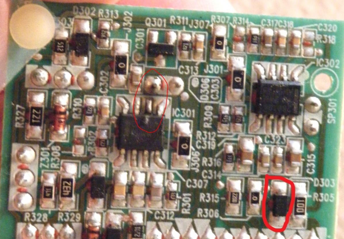

                  It looks like a problem with the chip burned 5 pin.
                  • rayfloyd170
                    • Jun 2015
                    • 58
                    • saudi arabia

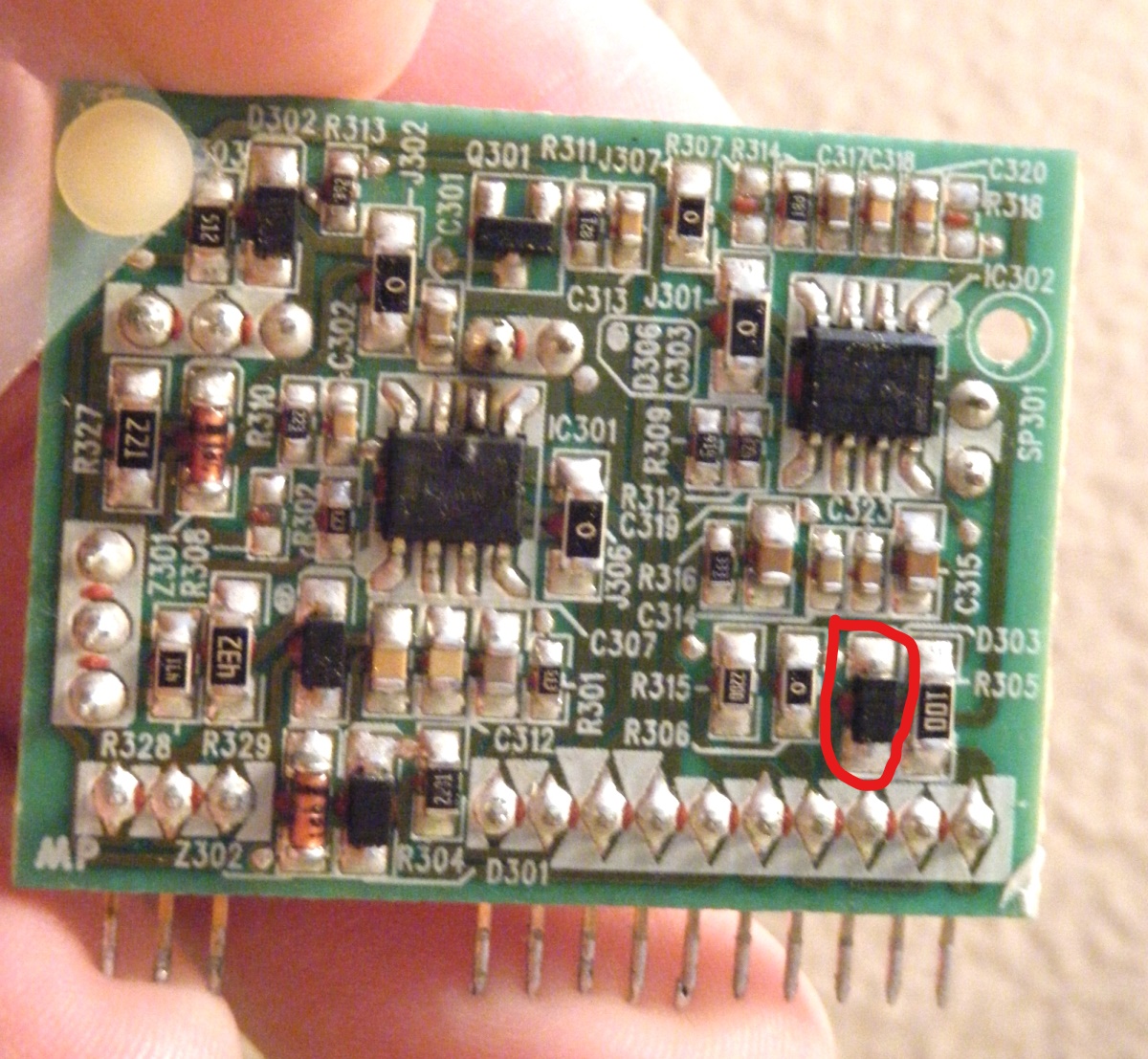

                    #49
                    Re: DELL OEM H240AS-00 (HIPRO) ~ major blow up!
                    Hi, actually i am just grabbing the photo from here and encircled in red the diode that was shorted. All other parts are physically in good condition. i successfully replaced the diode but still with the same problem.
                    I was thinking it has to be something related to over/under protection sort of thing because it powers up with good voltages for a few seconds only and autoshut off and after that i have to wait for a moment before i can power it again for few seconds.
