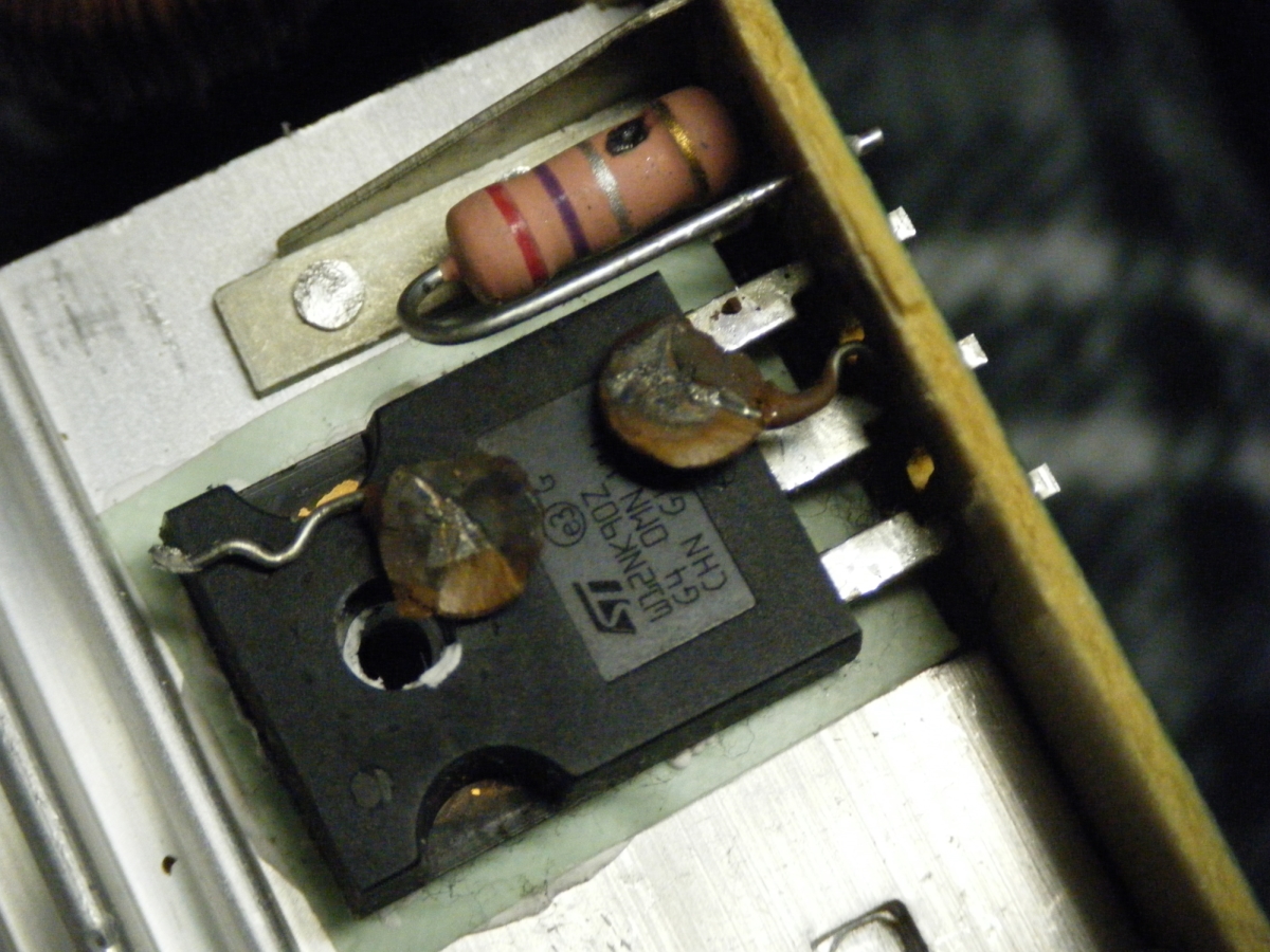

    It turns out, it finally blew! So far, it took out:
    -STW12NK90Z (Main switching FET)
    -680pF 1kV ceramic cap (This is the one that went bad)
    -SPW16N50C3 (APFC FET)
    -A 0.27 ohm resistor (2W rated I think)
    -The control IC (more on this later)
    -And various other parts (a few SMD resistors, a transistor, and a diode)

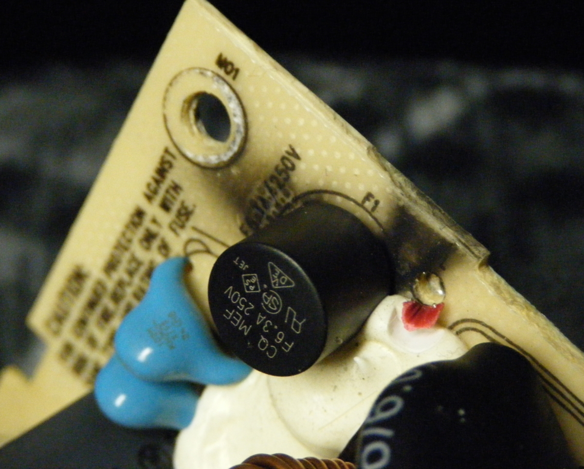

    -Oh, and don't forget the fuse! It really took out the fuse in spectacular fashion!

    The badly burnt and blown fuse.

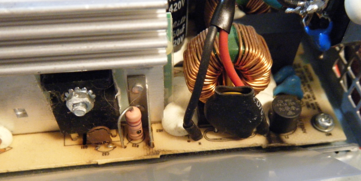

    Overall visible carnage.

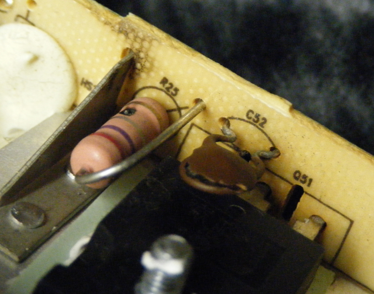

    Cracked ceramic cap, and blown resistor.
    The ceramic cap came out in two halves!
    (Note this cap was across the STW12NK90Z's D and S pins. No wonder it did so much damage when it shorted out.)

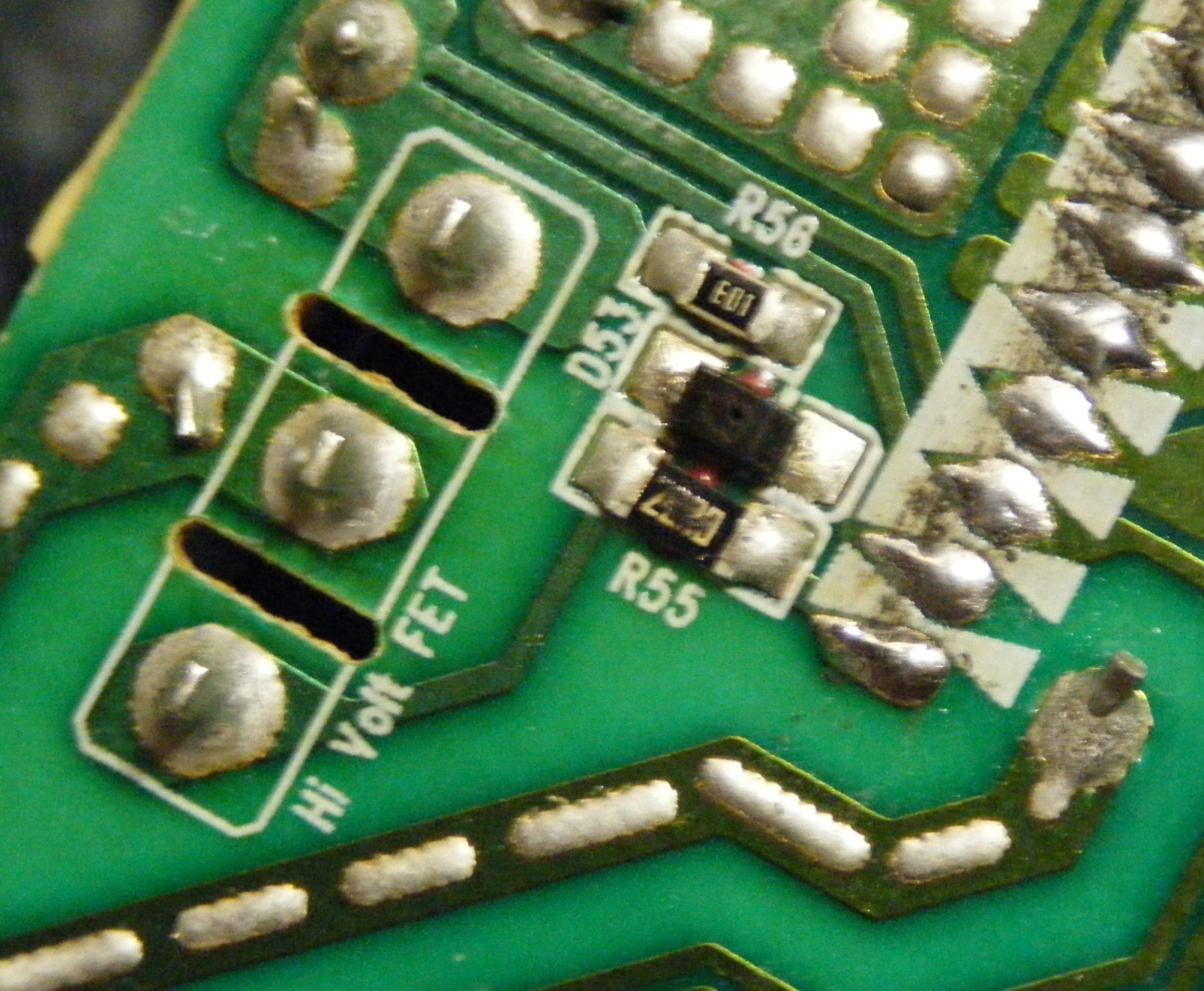

    D53 and R55 are blown.
    D53 appears to have "D1" on it, which appears to be a 1N4148W
    R55 looks to me like it was a 22 ohm resistor "22R0"
    (Note the markings "Hi Volt FET" .. this is the STW12NK90Z for the main switching converter (a forward converter I think?))

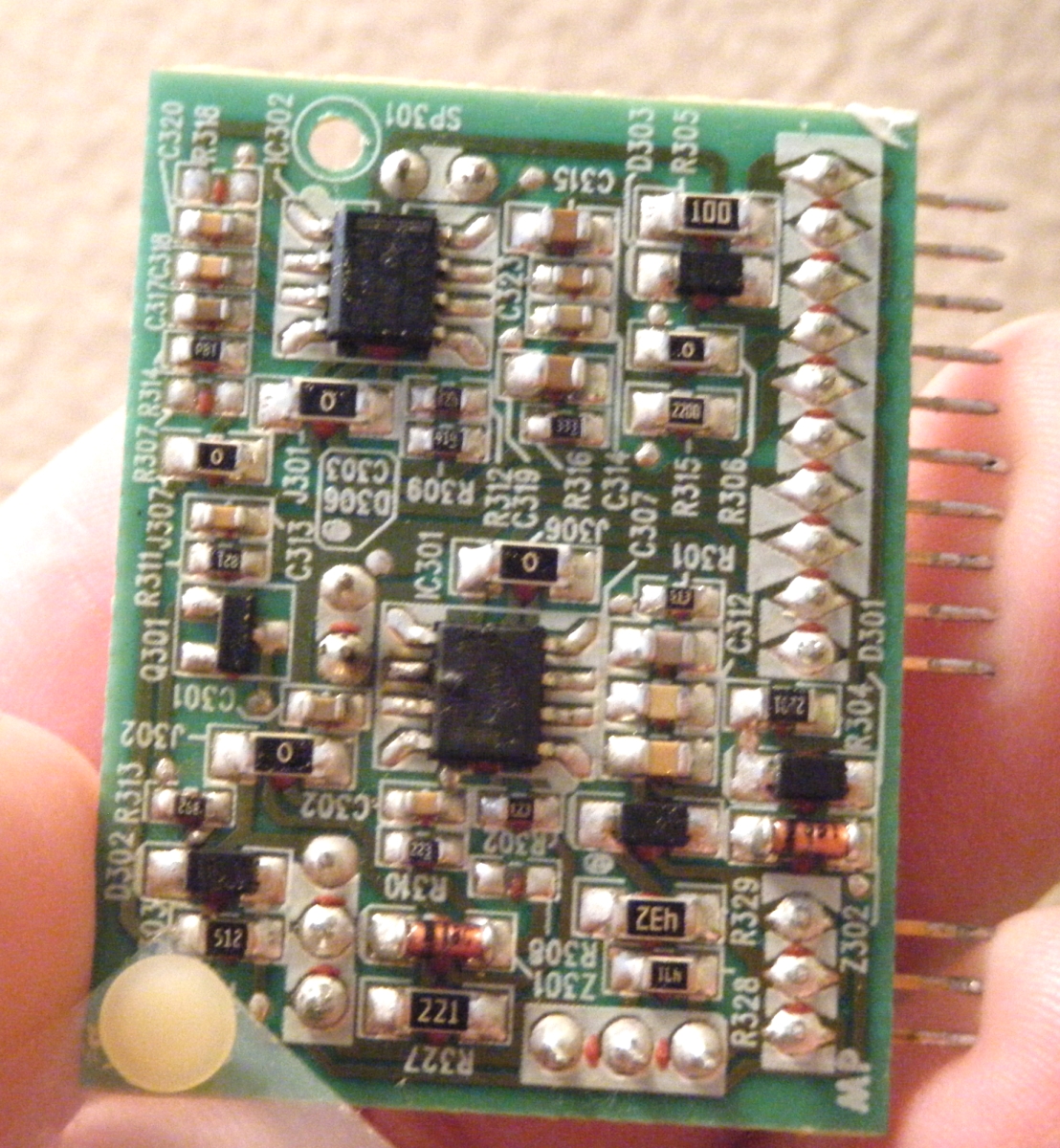

    IC301 is the mystery IC, you can see that pin 6 has soot marks around it, and the plastic/resin is bubbled.
    R304 is blown, it looks to me like it is a 2K2 resistor "2201"
    Q301 tests quite a low resistance. It's marked "1P" which appears to be a 2222A NPN transistor.

    The burnt ceramic cap C52 is the snubber cap, the 0.27 Ohms resistor is for the Source of the MOSFET.

        notes for the sub-board.
        r301 - 513 / 51k
        r302 - 123 / 12k
        r303 - 512 / 5k1
        r304 - 2201 / 2k2
        r305 - 100 / 10r
        r306 - 0
        r307 - not fitted
        r308 - not fitted
        r309 - 914 / 910k
        r310 - 223 / 22k
        r311 - 821 / 820r
        r312 - 623 / 62k
        r313 - 392 / 3k9
        r314 - 18d / 150k
        r315 - 2200 / 220r
        r316 - 333 / 33k
        r318 - not fitted
        r327 - 221 / 220r
        r328 - 471 / 470r
        r329 - 432 / 4k3
        d301 - 1n4148
        d302 - 1n4148
        d303 - 1n4148
        dxxx - 1n4148
        z301 - ?
        z302 - ?
        q301 - mmbt2222a
        q304 - ksp2222a
        q305 - mps751
        ic301 - cp012a
        ic302 - ucc28019a (ti)

          Thanks for the info, but I think I'm screwed over on repairing this POS XD
          1. The mystery IC is an unobtanium part ... after a LONG search, I found that it cross references to SCY99087 ... which is just sold by 3rd party, chinese vendors.
          2. Looking online, it appears other people have had the same PSU fail, repeatedly (after being replaced). Even cases of arcing and smoking while continuing to work!
          I think I'll probably end up getting a different PSU and modding the connectors to fit this computer.

            As for the mystery IC: see how it is connected on that daughterboard. Maybe you can successfully substitute a UC3842/3/5. Or perhaps do so with some modding. A simple UC3842 drive circuit isn't that complex, actually.

              I'm going to look in a few places to see if I have a CP012A chip ... I doubt it, but I might as well look...
              Heh, in the end, I may end up going as far as reinventing the daughterboard using parts that can be bought everywhere (like a UC3842, etc...).

                        as for your cap question, the cap is hammered by reverse pulse every time the fet shuts off.
                        higher voltage caps are stronger in general and usually have a lower esr.

                          This is a ceramic cap, so it shouldn't complain about reverse polarity, right?
                          Is the pulse just too high dV/dt?? (Too fast for the cap, because of ESR and/or inductance?)

                            i think it's just a disipation issue.

                                i now know what the zeners are:
                                z301 - 18v 500mw zener
                                z302 - 5v1 500mw zener
