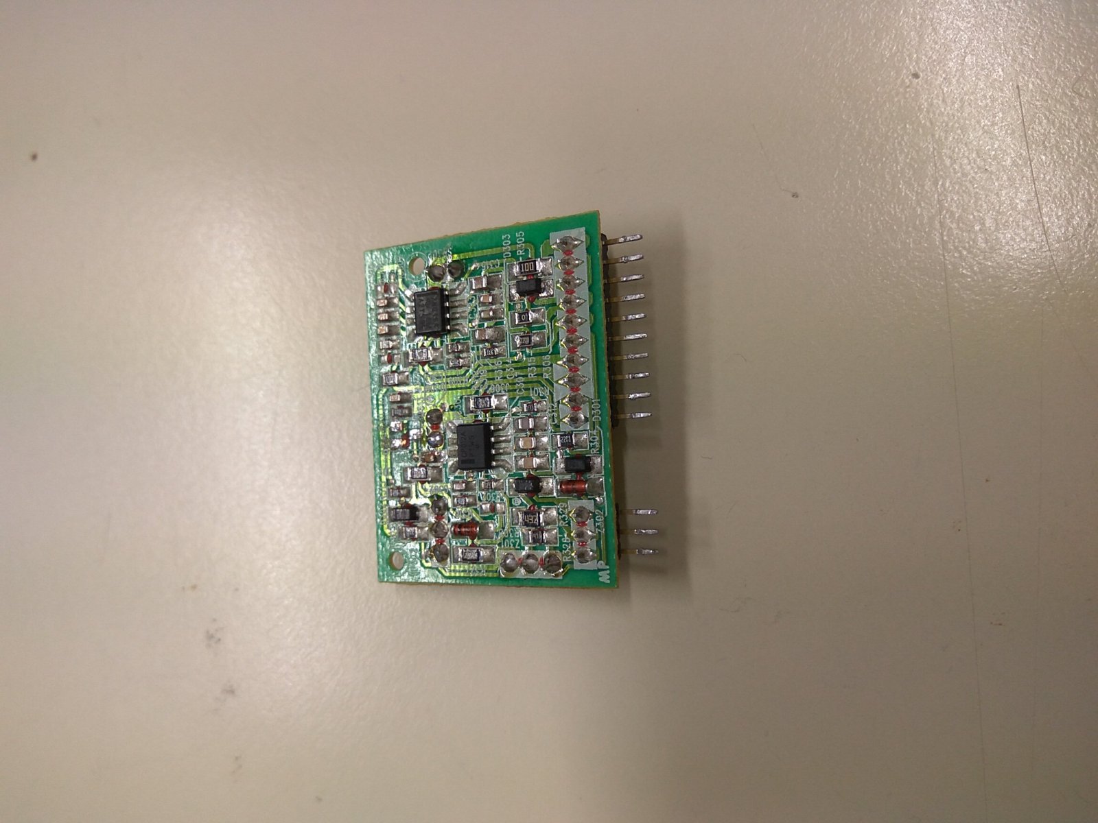

                  Re: DELL OEM H240AS-00 (HIPRO) ~ major blow up!
                  Originally posted by momaka
                  Fix it! (okay, only if you have nothing better to do or just as a challenge, that is)
                  I suggest to not bother with fixing the APFC circuit - not now, at least.
                  As for the mystery IC: see how it is connected on that daughterboard. Maybe you can successfully substitute a UC3842/3/5. Or perhaps do so with some modding. A simple UC3842 drive circuit isn't that complex, actually.
                  For the main FET, you can use whatever you got in your junk bin, as long as it has the same Vds voltage rating. This is for testing purposes, of course. Once the PSU is fixed, use same or equivalent parts to the originals.
                  And, of course, use the series incandescent bulb trick for all live testing. Unless you like to start New Year's fireworks show early .
                  can u help me with that?
                      I have 4 of these PSU's here and i'm trying to fix them, one of them has the driver board burned, maybe i can save some smd's on it, but im trying to test de 2 IC's (IC301 and IC302) but i don't know how. there's a small transistor too that is burned... i'm trying to find some of these components on junk circuits but it's hard to find...
                        • 31304
                        #31
                        you cant test them, if they are bad you will see a small hole burned into the top.
                        the pfc chip ihas never died in the ones i had, but the other chip was *always* toast.
                          They aren't burned at all but i need to figure it out why the power supply doesnt start.
                            Originally posted by budm
                            Can we see the pictures of the whole board top and bottom side?
                            R55 (22 Ohms is about right)/D53 (1N4148 will be fine) is the RD Gate drive network, so the IC that drive the Gate of that MOSFET is more likely to be damaged, yes, I would change it for sure.
                            The burnt ceramic cap C52 is the snubber cap, the 0.27 Ohms resistor is for the Source of the MOSFET.
                            What is the value of the snubber cap C52?
                              • 31304
                              #34
                              680pF 1kV
                              it's in the first post.
                              but use a 2kv or 3kv replacement.
                                Beware, most CP012A on eBay or AliExpress are fake. Before using any of them, check voltage drop from GND (pin 5) to all other pins using a diode test on a multimeter. If any is missing or over 1000mV, the chip is fake.
                                Luckily, the CP012A is only a remarked NCP1252A. Verified.
                                I've fixed many of these PSUs. List of usually bad parts:
                                F1 (F6.3A/250V)
                                C52 (681K/1KV = 680pF)
                                Q51 (STW12NK90Z)
                                R25 (0R27 or 0R2 fusible)
                                DB1 (GBU606)
                                D53 (D1 = 1N4148W SOD-123F)
                                R55 (22R SMD 1206 1%)
                                C51, IC52 (Cosmo 357NT C = KPC357NT0C (CTR=200-400% VCEO=80V) or 357T)
                                R36 (4R7 SMD 1206)
                                sub-board:
                                IC301 (CP012A = NCP1252A)
                                J306 (0R SMD 1206)
                                R304 (2K2 SMD 0805 1%)
                                Q301 (1P = MMBT2222A)
                                if R302/R310 showing bad values, replace Q301
                                D301, D306 (D1 = 1N4148W SOD-123F)
                                if R329 (4K3) shows bad value (not around 4K25), replace IC51
                                if R327 (220R) shows bad value, replace Q304 (KSP2222A)
                                IC302 (UCC28019A - PFC)
