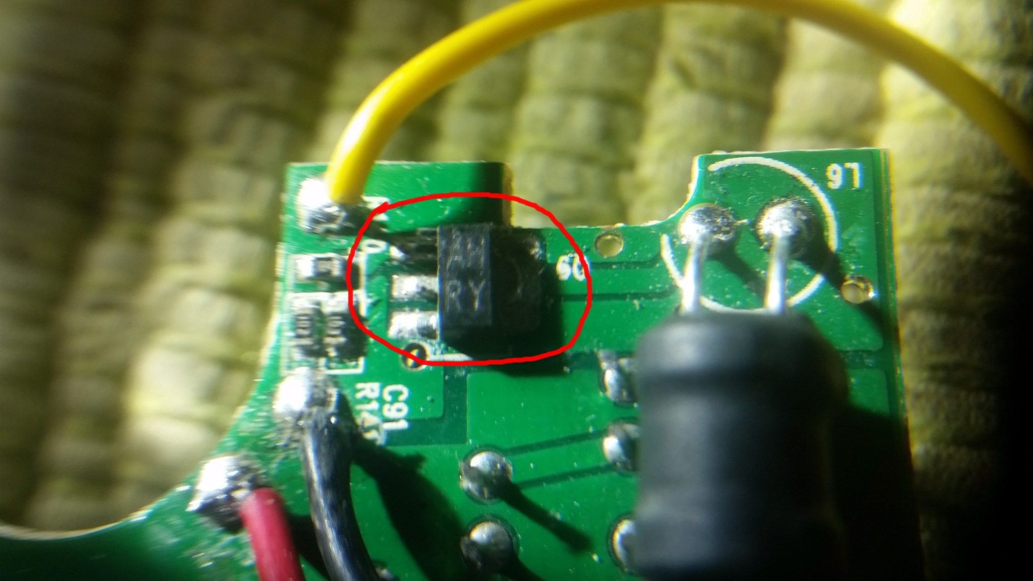

    Hello All,
    I'm trying to identify and source this part. The letters are AH RY. Attached is a pic of it.

    Re: Part ID Help
    According to this it is NPN transistor (it's SOT-23) but who knows with these tiny ones http://www.s-manuals.com/smd/ry

      Re: Part ID Help
      it could also be a switching regulator,
      that code matches a lot of parts.

        Re: Part ID Help
        There is something which looks like Q5 on the PCB which leads to me to think it may actually be a transistor

          Re: Part ID Help
          What is the board from?
            Re: Part ID Help
            Good straight shot pictures of the whole board (top and bottom side) will help.
            It looks like it drives Inductor L6.

              Re: Part ID Help
              something like this?
              http://www.torexsemi.com/products/detail.php?id=240

                Re: Part ID Help
                I see no SOT-23 in there.

                  Re: Part ID Help
                  i see not SOT-23 on the board - 3 legs and a tab = SOT-89

                    Re: Part ID Help
                    Oh, right. But isn't it smaller than SOT-89? Seems to me. And there is still that Q5 (or Q9) marking on the board.

                      Re: Part ID Help
                      SOT-89 is the small one, SOT-223 is the larger one.
                      i'm not saying that's the part, but i wouldnt be surprised if it was a similar part from that company.

                        Re: Part ID Help
                        Thanks guys for trying but, I found the problem to be cold solder joint on one of the terminals. This board has 32 IrLEDs on it and is used with a camera to take pictures via a motion sensor. (A hunter's camera). Thanks again guys for trying.
