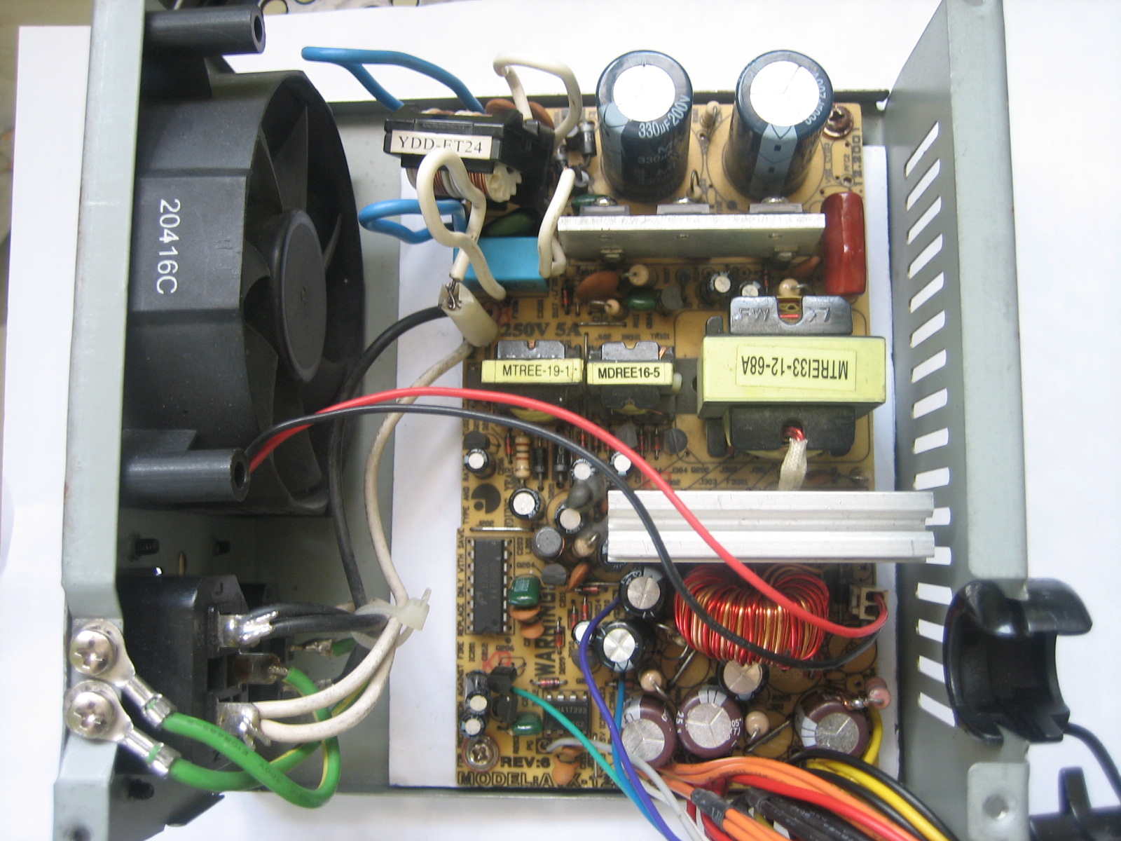

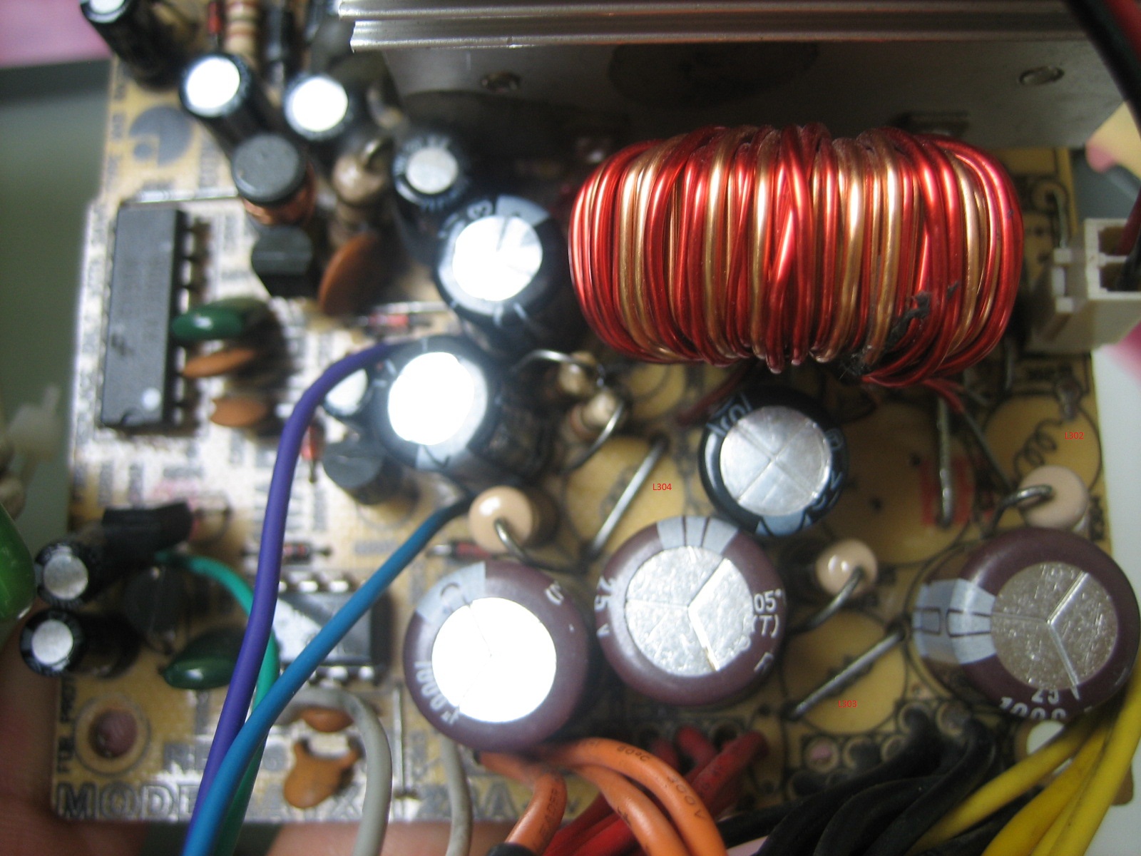

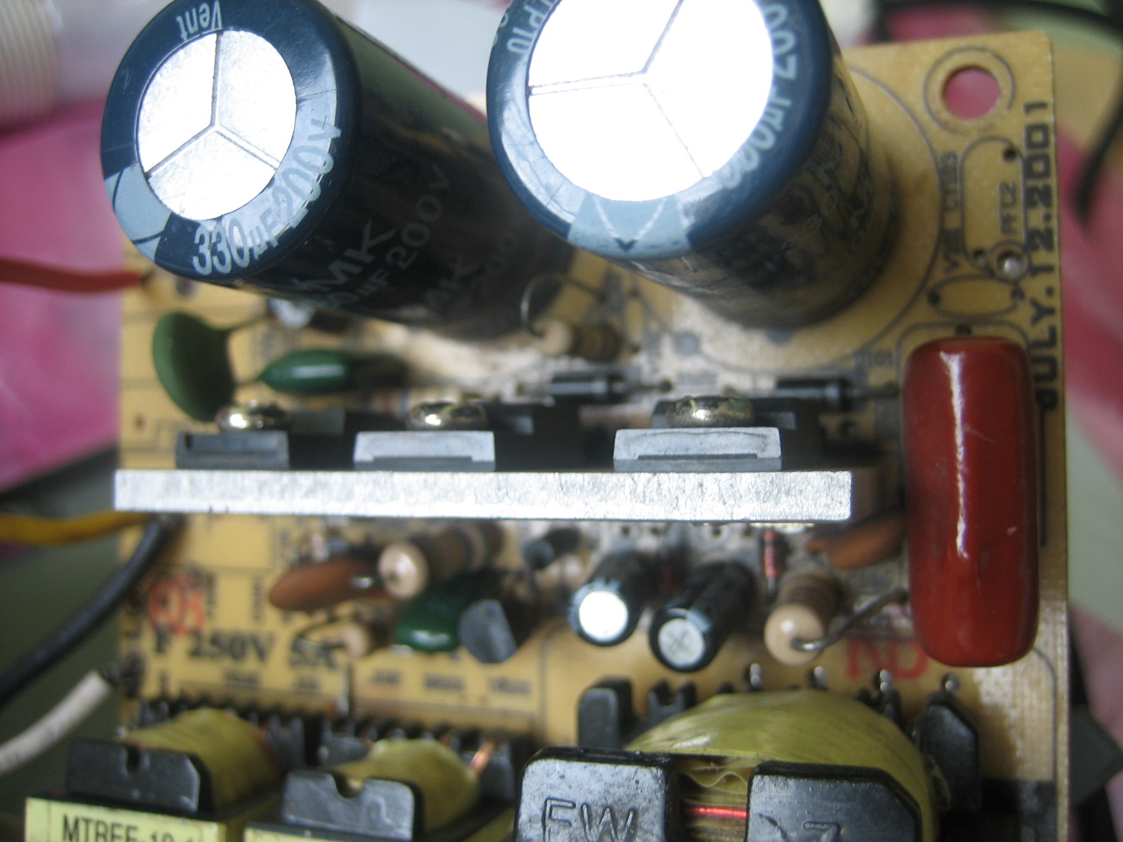

Hi momaka,
Referring to your earlier suggestion, I removed the 2nd diode label "24" from board and test it off circuit and finally saw the diode labelled CT(first row) SB240(second row). I used diode range and it read 001(beeps) at one end and swap probes and get 001(beeps) the other way. The result seem to point this diode is shorted. Is this a schottky diode 40 Volt 2.0A type? The nearest diode stock that i have is a LT116(first row)2A05(second row) which gives a peak repititive reverse voltage of 600V and average rectified output current of 2.0A. Can I use this to replace the shorted CT SB240 ?

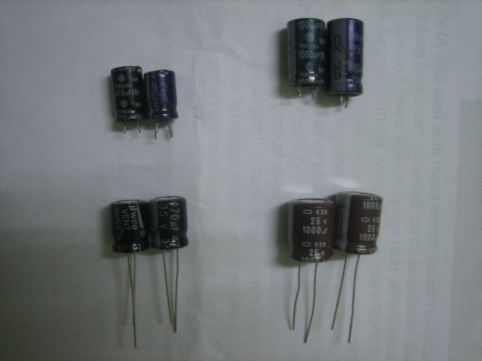

I have not put back the six removed caps in the PSU due to waiting replacement of the above shorted diode. Once this diode is replaced and the six caps soldered on pcb and put a load(maybe a 12V DC fan will do ?) and the series 60W bulb still connected, is it time to power up AC to see if the 5V purple wire will output 5v DC?
Appreciate all the feedback and suggested points on the troubleshoot.
Thank you all.
