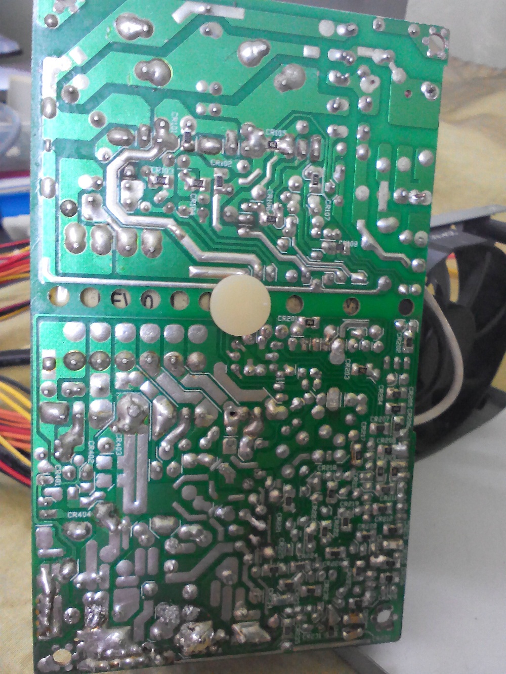

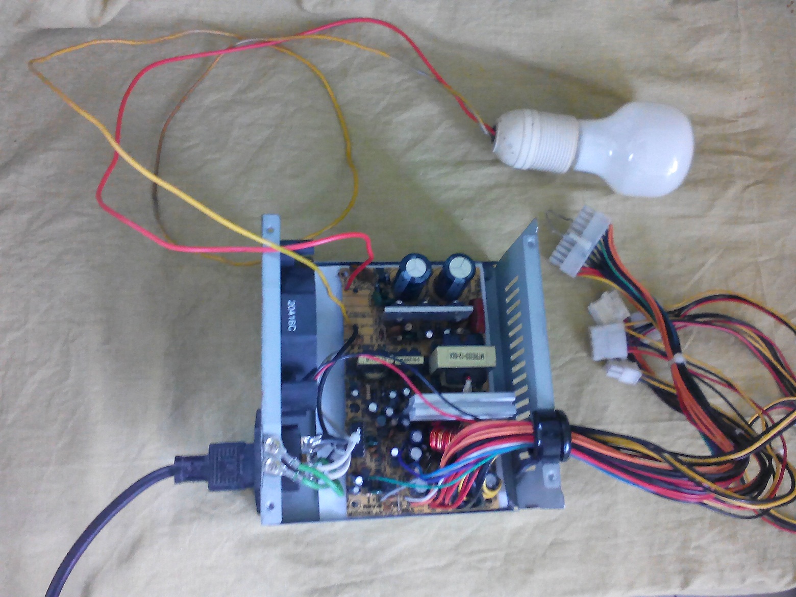

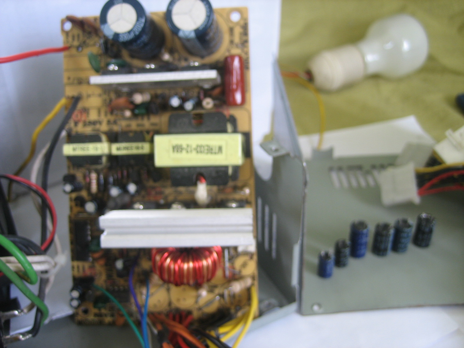

    Hi All,
    I got a dead AVF brand china made switching power supply from a friend recently who previously used in on a pc. It is labelled as a 350 watt power supply suitable for ATX type pc. I opened the case and did not find any burnt marks or bulged caps.
    Before I make any further damage I connect a 100 watt light bulb in place of the 5A glass fuse. My country is using 220V as AC main. So I switch on the mains but still nothing happens, no fan turning and light bulb also not on.
    At this stage I have no idea where else to check for the fault. Hope that someone with experience to diagnose power supply of this type can assist and guide me. On hand I have a digital multimeter, a digital capacitor meter and a 40 watt soldering iron with basic soldering skill.
    Thanking in advance for any help and suggestion.

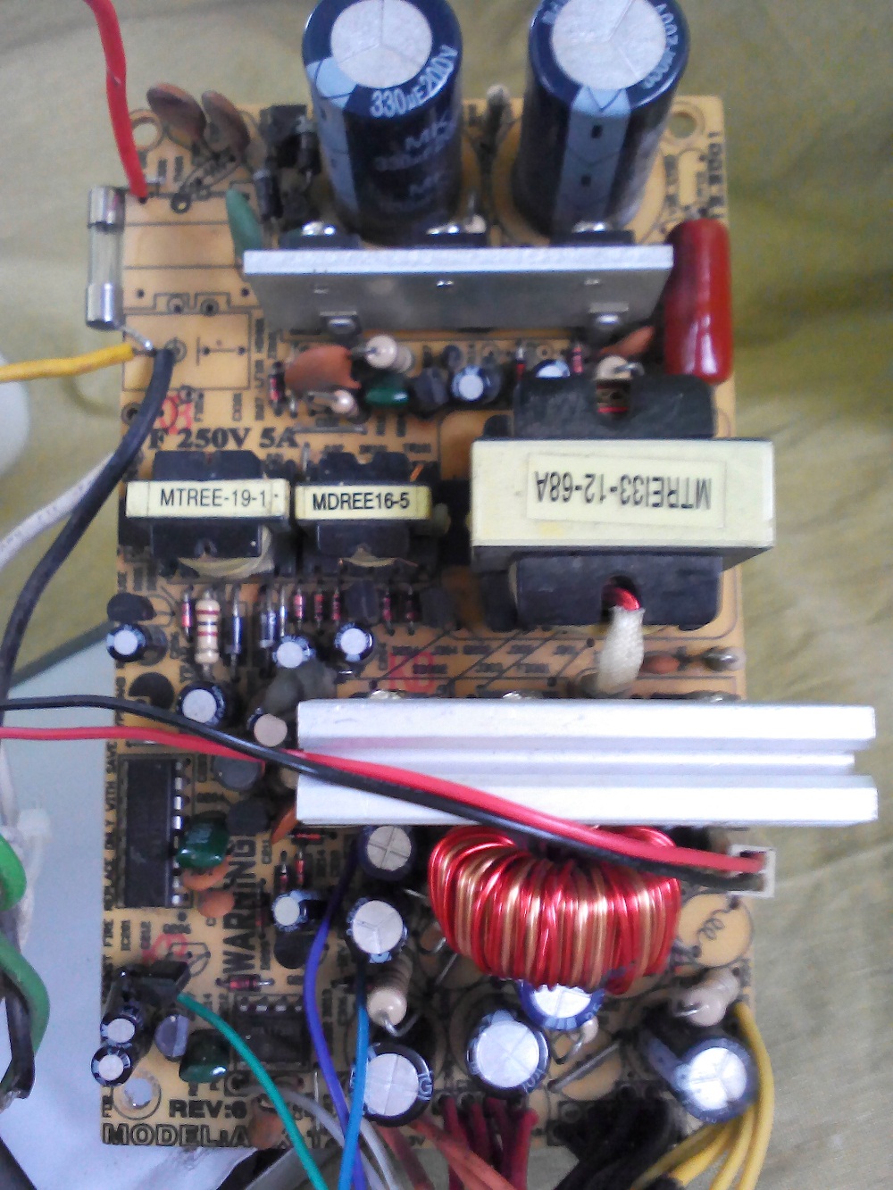

      The PSU looks a bit cheap... probably only good to fix as a learning experience... but let's troubleshoot it anyways .
      First, check if there is 5 VSB rail is there. That is check between purple wire and ground (i.e. black wire). Should be 5V +/-0.25V.
      - If the 5 VSB rail is there, short the green wire on the ATX connector to ground and see if the PSU turns on. You may need to put a load on the PSU's 5V rail (that is, between any of the red wires and ground). Usually a 12 V car bulb or 12 V halogen bulb will work fine for that.
      - If 5 VSB is not present, check the thermistor on the input. It is that green disk-shaped thingy next to the primary heatsink, right across from where the fuse was. It should read maybe 10 Ohms at most. If it is open-circuit or anything above 100 Ohms, it is definitely bad. The next item to check after that would be the bridge rectifier (in your case, the four diodes, next to that thermistor), followed by the transistors on the primary heatsink.
      I'll stop here for now. Let us know what you find.

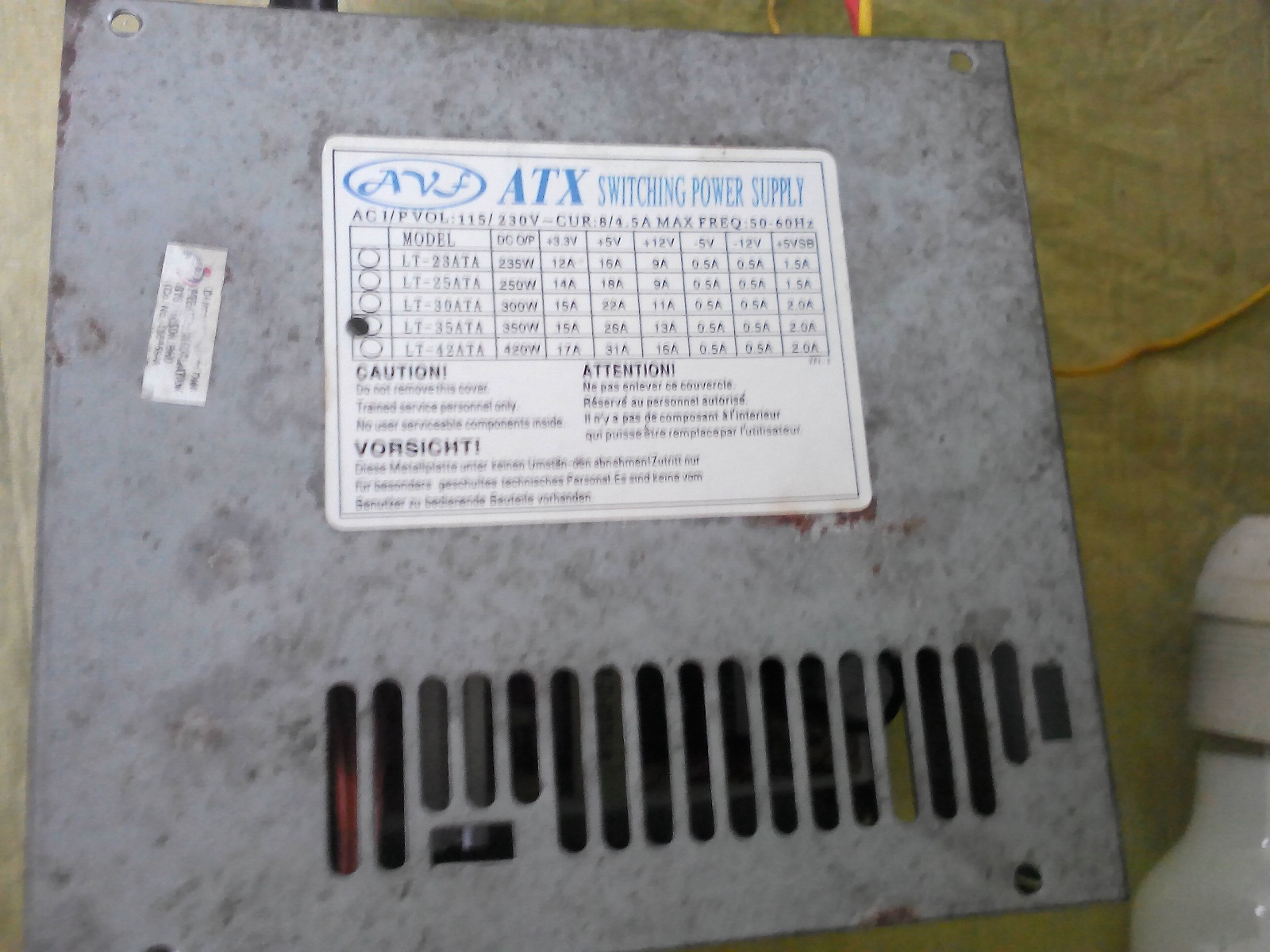

      Also, this is not really a 350 Watt PSU. Probably 200 Watts at most with that primary heatsink (if even that). The lack of PI output coils will definitely let a big amount of ripple go through to the computer. I don't recommend you use this PSU with any piece of hardware you care much about.

        Seeing the faulty ps is rather cheap, my intention is to try repair it and get learning experience but later to use it as a test bench; i will definitely not use as computer ps or any critical equipment.
        As per your suggestion, I have not checked the 5VSB rail as my previous picture I had earlier short the green wire on the ATX connector to ground(black) but the PSU does not turn on. Can I still switch on main power 220V AC safely without burning any house fuse since I had removed (desolder six caps as mentioned below) and use mulitmeter to check on 5V rail?

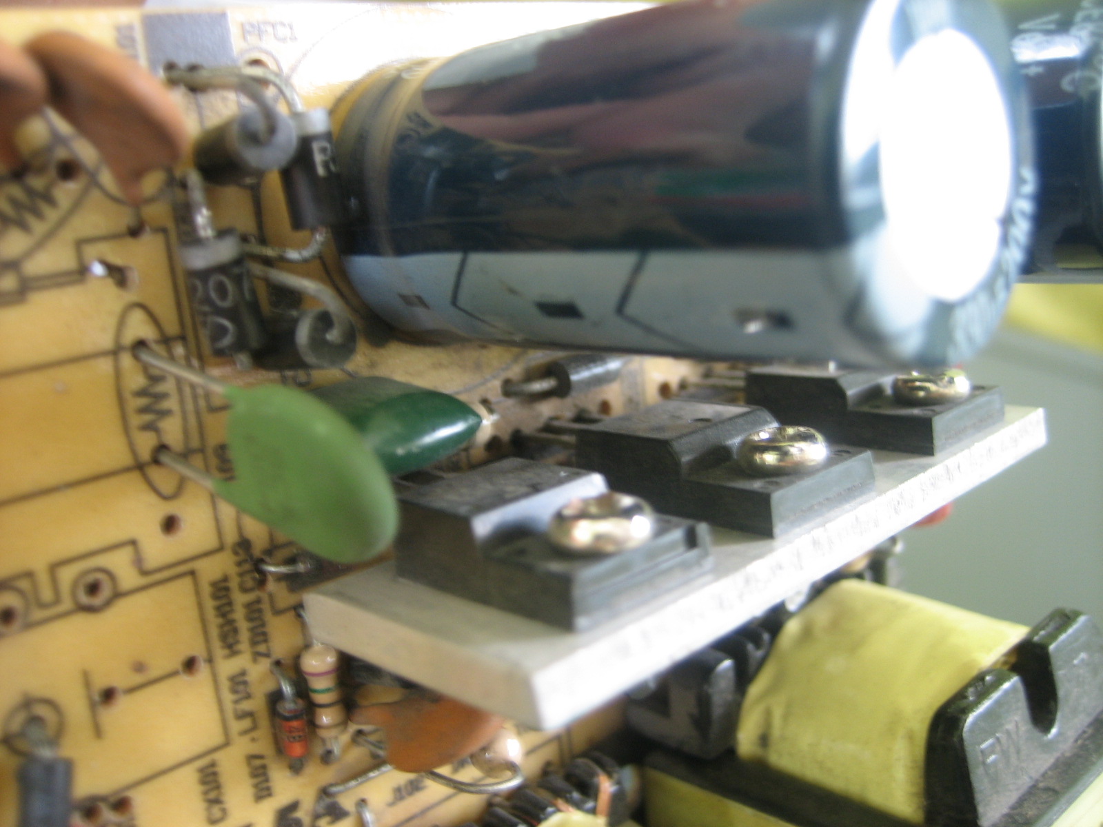

        I try to rule out the suspect one component at a time.From my attached pictures, I had desolder six(6) electrolytic caps from secondary side,then use my caps meter to check each of the caps,but the UF reading seems within 5% range as stated on caps. With power off, I checked resistance reading on the green thermistor SCK054,on scale 200ohm, the thermistor reads 6 ohm. This should still be good.
        Then, I use diode range to check the four diodes next to the thermistor, each diode reads OL(over limit)on one side and about 594 ohm on other side. All four diodes should still be good. Next I try check transistors on primary heatsink but no idea how to do it.There are three transistors, my noob understanding is the left pin i assume is Gate(G),middle pin is Drain(D) and right pin is Source(S). I will use my digital multimeter on diode/continuity setting, first place the negative(-) black probe to Drain(D) while the positive red probe (+) on Source(S),next step is place the positive probe on Drain(D) and negative probe on Source(S),last step is place negative
        probe on Drain(D) and positive probe on Gate(G).

          As long as you have the incandescent light bulb in place of the fuse, you can still apply 220 V AC power. Just do NOT short green wire to ground on ATX connector, because the caps you have removed are for the output. The PSU will not like it.
          However, the 5 VSB rail (purple wire) will come on as soon as you plug in 220 V AC into the PSU. And it looks like you didn't remove the caps for that, so plug in the PSU and see if you get 5V on purple wire. If NO, then that would prevent the PSU from turning ON. If YES, then I will explain troubleshooting in more detail later.

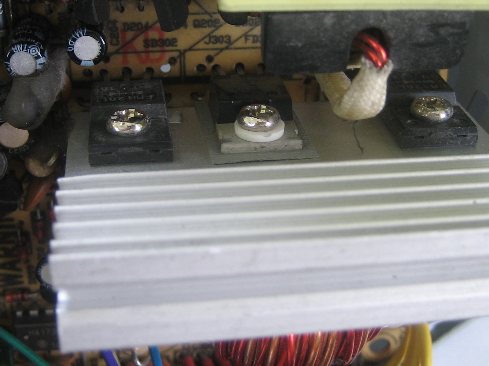

          You were close .
          That's the correct testing procedure for a MOSFET. What you have in your PSU is Bipolar Junction Transistors (BJTs). In particular, those transistors are NPN type.
          Generally, TO-220 case BJTs (like the ones one your heatsink) have left pin as Base (B), center pin as Collector (C), and right pin as Emitter (E) - that is, if you are looking at the transistor from the text side.
          The way you test NPN BJTs is you set multimeter to diode test. Then put multimeter positive (+) probe on Base and negative (-) probe on Collector (C). See if you get a reading between 500-750 mV (or 0.5 to 0.75V depending on how your multimeter counts) - that would indicate a good transistor. Less than 100 mV (or 0.1V) indicates likely bad transistor.
          Now repeat that step above again, but this time with multimeter positive (+) probe on Base and negative (-) probe on Emitter (E). You should get the same or very similar readings again.
          Originally posted by mikey5791
          On first transistor label C5353 2C, I got these readings:
          -D&+S=739
          +D&-S=1(over limit)
          -D&+G=524
          That transistor is likely good.
          In particular, that last reading, "-D&+G=524", is essentially the same as +B&-C, which will yield between 500 and 750, as I mentioned above.

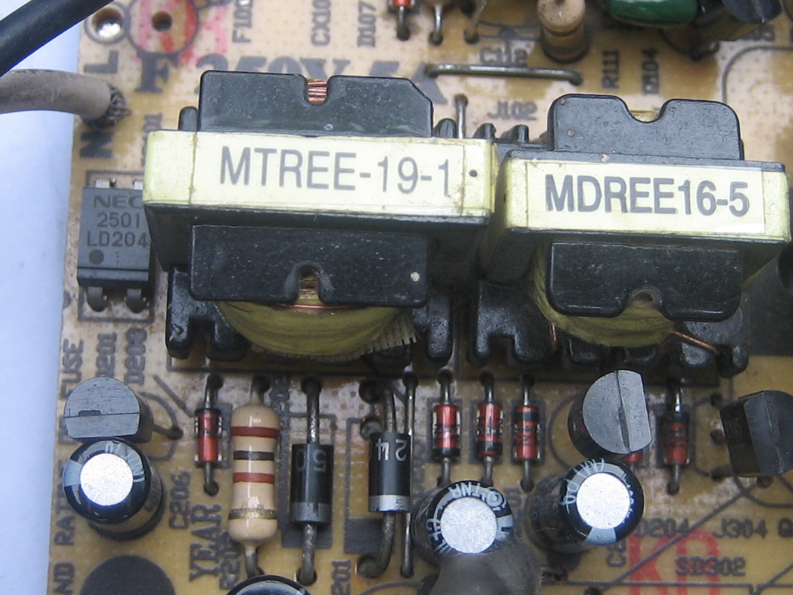

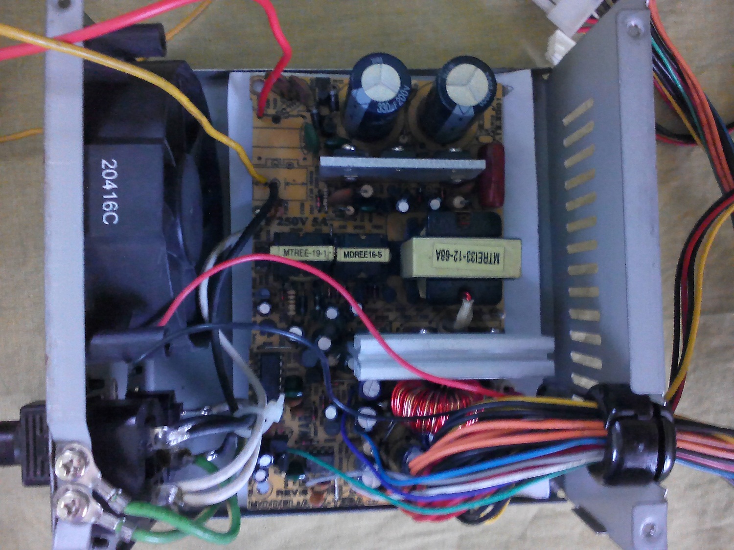

              There is NO need to short green wire to ground when testing voltage on purple wire (5 V stand-by rail, or 5 VSB as it is often called). 5 VSB should come up to 5V as soon as the PSU is plugged in, regardless of anything else.
              The fact that you don't see 5V on purple wire indicates a problem. It means the 5 VSB supply is not working. So this is what we must troubleshoot first.
              The 5 VSB supply consists of that C5353 transistor, the small transformer labeled "MTREE-19-1", and the components around it. I am using this picture as a reference:
              https://www.badcaps.net/forum/attach...0&d=1444016456
              In particular, there are two black diodes (next to a 100 Ohm resistor) below that "MTREE-19-1" transformer. Test them with your multimeter and let me know what you get. One of them appears to have overheated near its leads.

                As per your procedure, I tested the two black diodes namely the first diode (nearest to a 100 ohm resistor) got label "50" reads 1(over limit)on one end and 924 on the other end. The other diode label "24" reads 1(over limit)on one end and 003 on the other end. (too low?) Suspect this diode is roasted. For reference, I attached pic of img1010 on the two black diodes.
                BTW, I follow your guide on testing schottky rectifier using + for positive red probe and - for negative black probe, A1 as the left anode pin, A2 as the right anode pin and C as the middle cathode pin.
                The results are as follows:
                On left side FMB26L
                +A1 & -C= 45
                +A2 & -C= 45
                On middle BY028E
                +A1 & -C= 146
                +A2 & -C= 146
                On right side FMB26L
                +A1 & -C= 10
                +A2 & -C= 10
                Does the results mean anything ?

                • everell
                  • Jan 2009
                  • 1514
                  Re: Need help repair dead AVF brand power supply
                  momaka: It looks to me like he has the black wire (Line) going to the neutral side of the AC connector, and the white wire (Neutral) going to the Line side of the AC connector. On the pc board, looks like the black going to Line and white going to Neutral properly. Can you verify this? This could create safety problem.

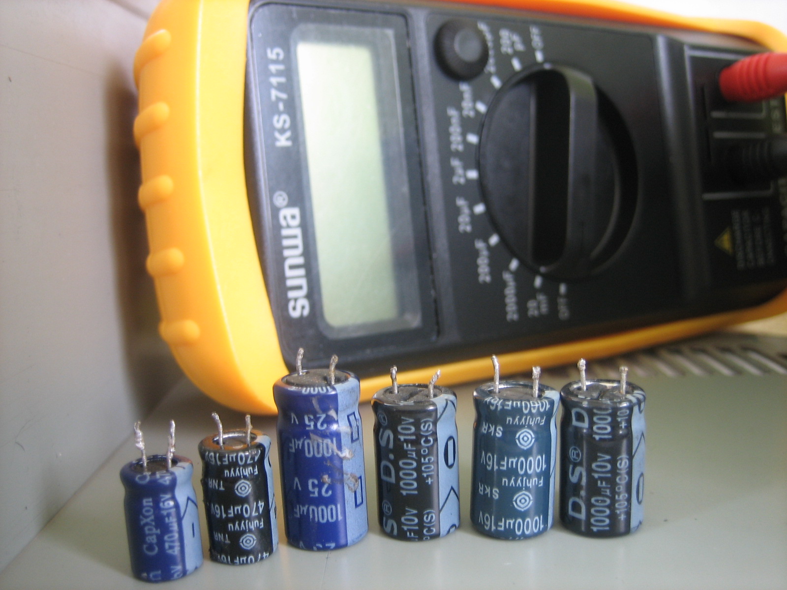

                        put the caps back in the PSU and plug in power with the 60 watt bulb in series. After the light glows and goes off, see if you get 5V on the purple wire with your multimeter. I just want to verify this one more time before we proceed.
                        And yes, light bulb will glow and stay glowing if something is very wrong with the PSU. But in your situation, I think the PSU has a small problem preventing it from working.

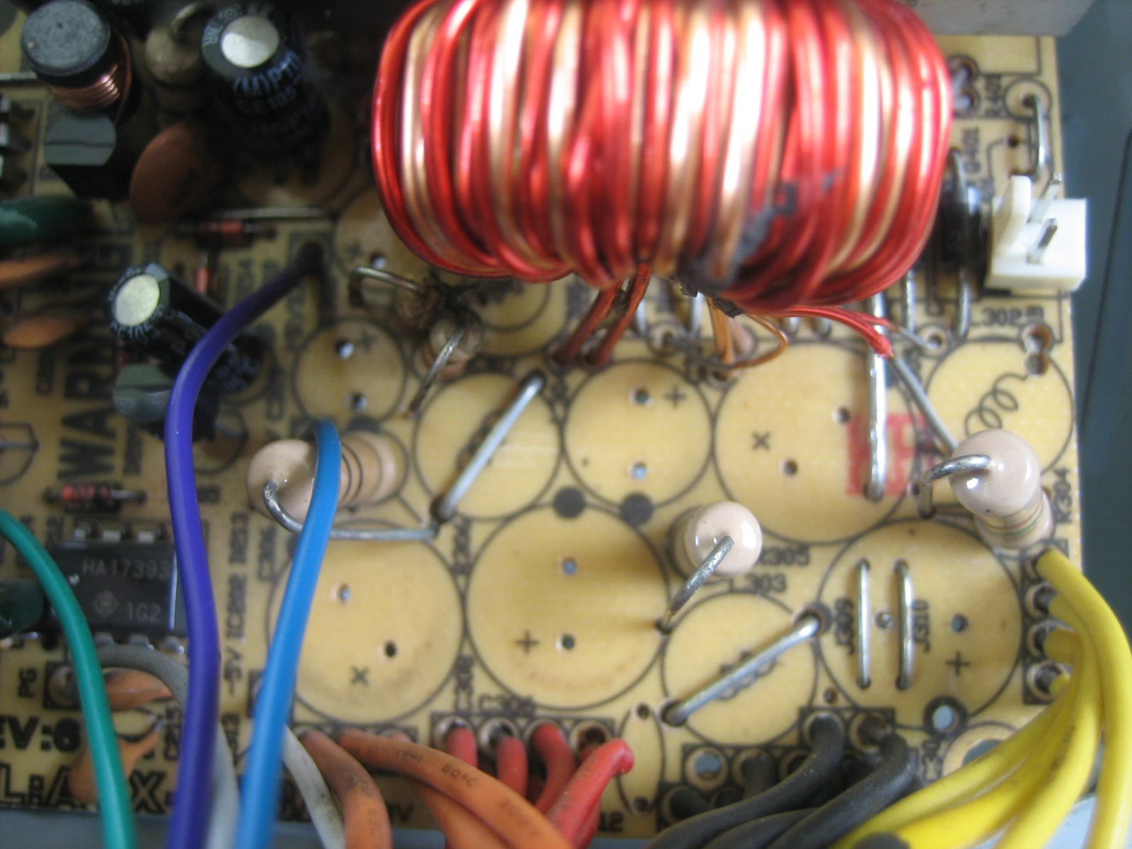

                        Yes, it means there are "dummy" load resistors on the output of the 3.3V, 5V. 12V rail. Looks like the dummy load resistors are:
                        10 Ohms for 3.3V rail (resistor color code: brown, black, black, gold)
                        47 Ohms for 5V rail (resistor color code: yellow, purple, black, gold)
                        150 Ohms for 12V rail (resistor color code: brown, green, brown, gold)
                        And you can see them in this picture:
                        https://www.badcaps.net/forum/attach...2&d=1444485096
                        I think that would be R304, R305, and the resistor by the blue wire. So the results for the diode rectifiers above are inconclusive. To test the diode rectifiers, you must either remove the dummy resistors or remove the rectifiers themselves. I think it would be easier to remove the resistors.
                        Remove that "24" diode from the board and test it out of the circuit again. The reading you got for it in the circuit is not quite right (but not obviously wrong either). It is strange to have it test very low in one direction (the 003 reading you got) and over limit on the other.
                          Yes, you are absolutely right.
                          It looks like the wires were soldered incorrectly at the factory. Unfortunately, this is not the first time I have seen this!
                          Either way, as long as ground is connected, this should not be that much of a safety problem (in Europe, for example, the Schuko plug has ambiguous polarity - its L and N contacts can be reversed).
                          The real possible safety problem with this power supply is the ceramic caps used in the line input filter as Y-caps. Real agency-approved Y-caps will go open-circuit in case of failure, whereas these ceramic caps might go short-circuit. This is where it is critical that the Live wire be across the fuse.
