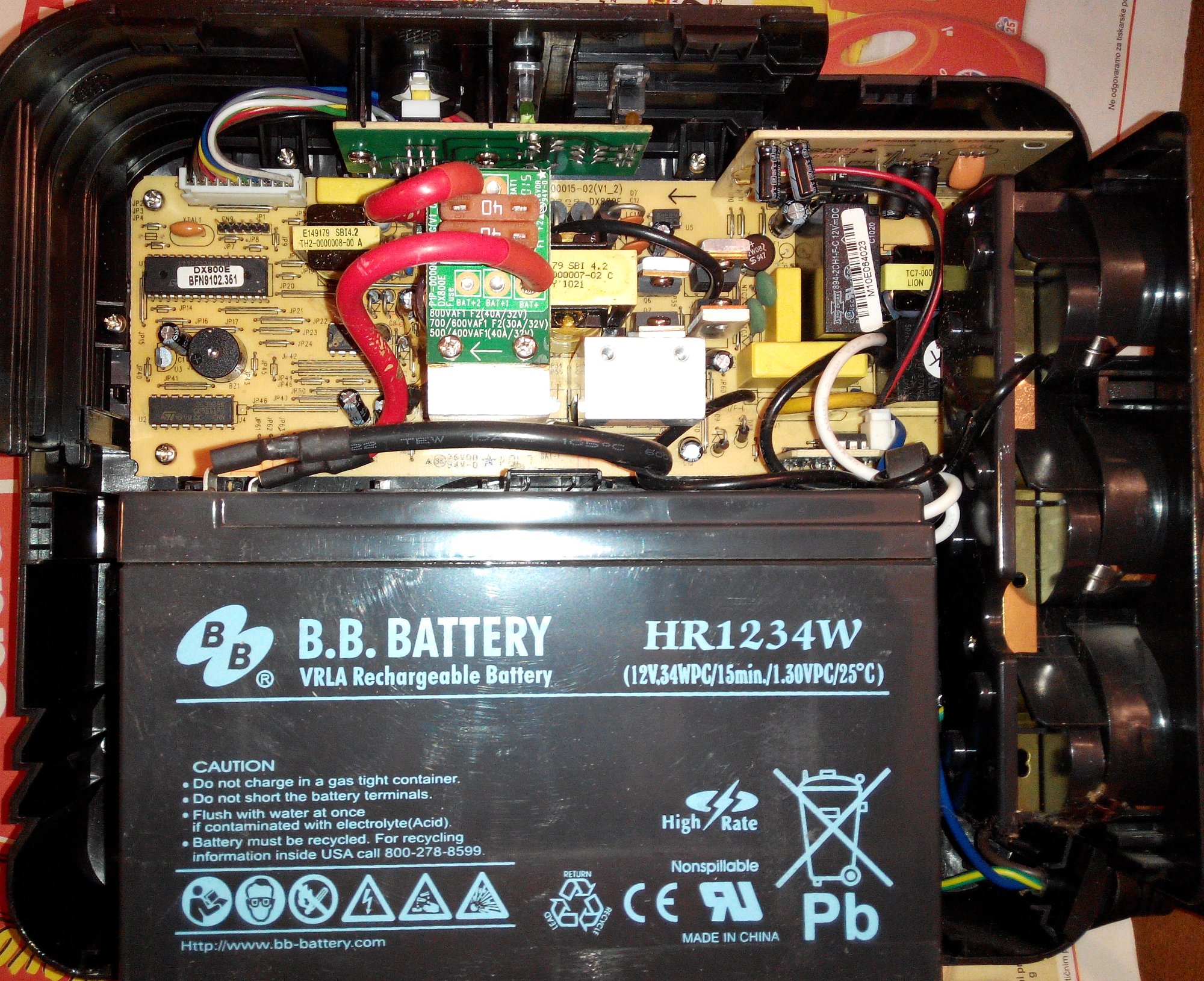

    USP is 4 years old, simptoms were:
    - on power loss it would not switch to battery but reported error instead
    - sometimes the pwrstat service would turn off the computer on boot, as soon as the service started, UPS told it battery was low and it would issue a shutdown signal

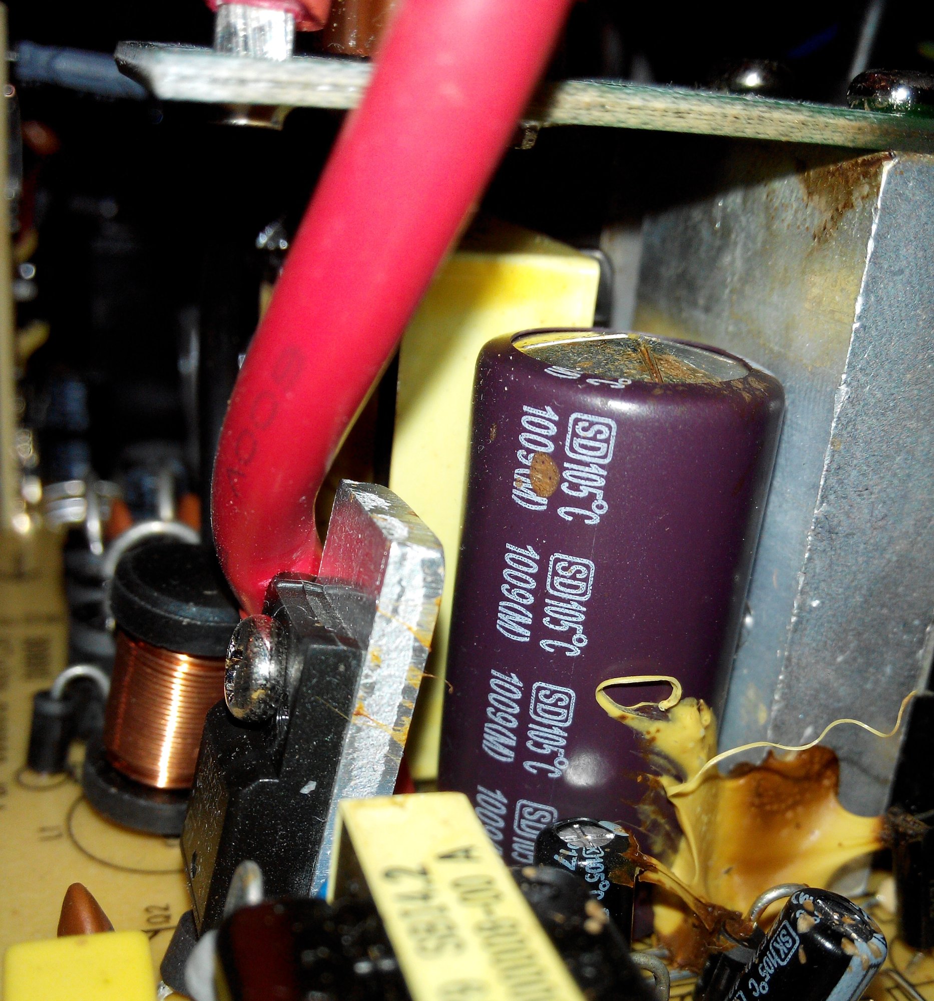

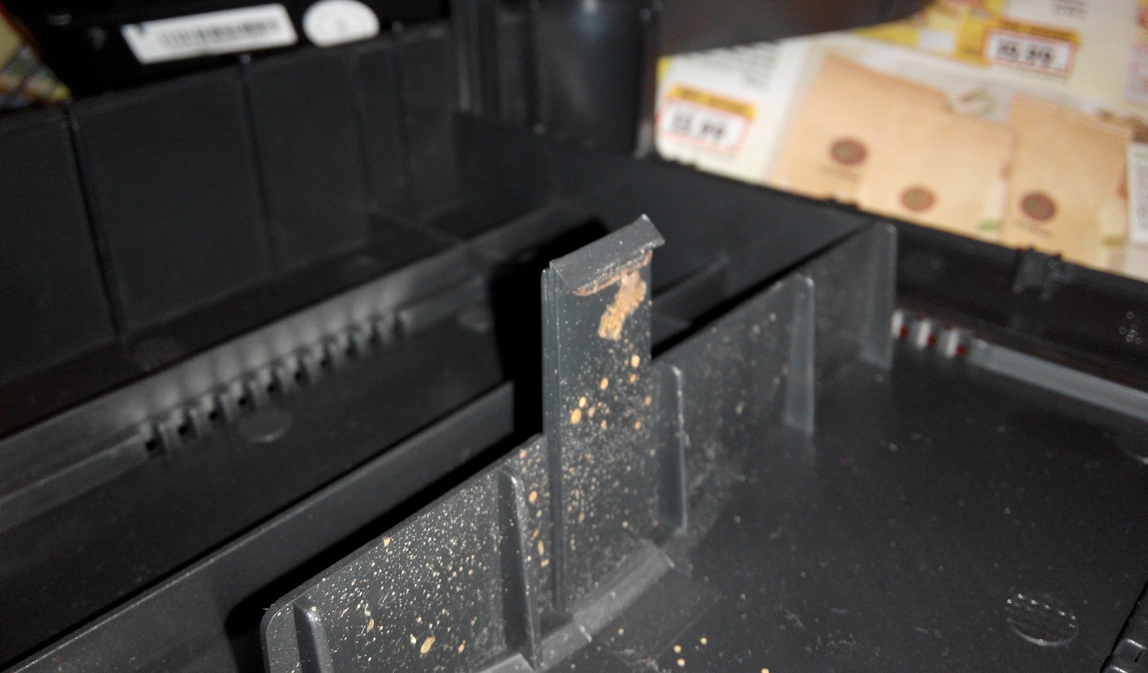

    First I thought it was the battery, opened it up and found a bulged cap. It seems it also leaked brown fluid around the case (last picture).
    It was Su'scon 4700uF 16V SD series (low ESR), replaced with Yageo SC series 4700uF 16V 16x25mm that I had at home. The big cap is right under the small PCB with fuses.
    Now, the other caps are all su'scon SK series - standard, not low esr.
    Cap replaced, cleaned interior with alcohol, UPS works fine for a couple of weeks now

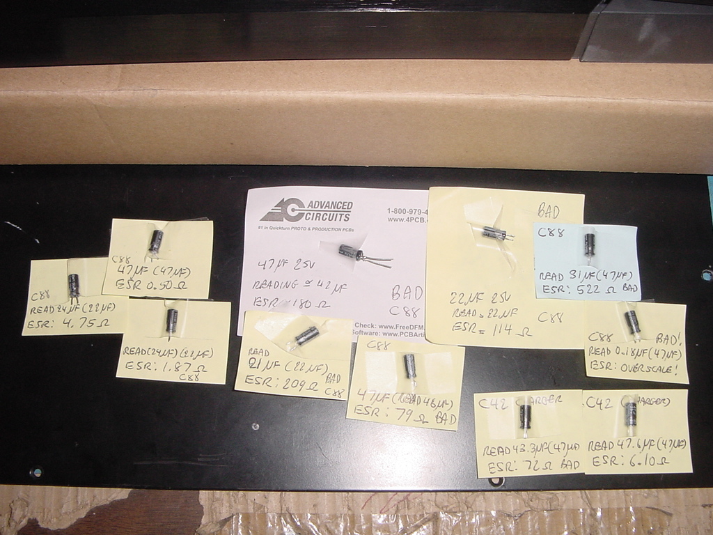

    I would replace the other caps as well.
    I replaced lots of bad cap in Cyberpower, see pictures of the bad caps I tested, as you can see, lots of them are failed due to ESR and lost the capacitance. I replace them with LOW ESR Panasonic FM/FC series. Some of those caps are used in the charger circuits.
    https://www.badcaps.net/forum/showth...ght=cyberpower

        Re: Cyberpower DX800E UPS bad cap
        Those crappy caps in the pictures are su'scon SK series. I replace them with better brand, PANASONIC low ESR, 105c FM/FC series.
        Some of them read 31uF instead of 47uF (+/- 20%).
