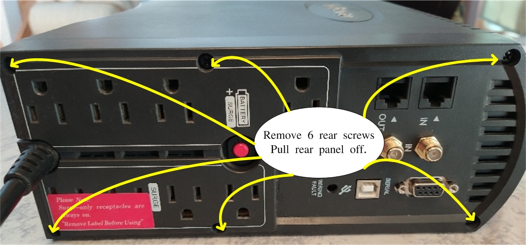

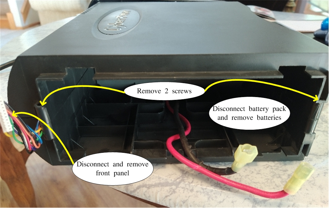

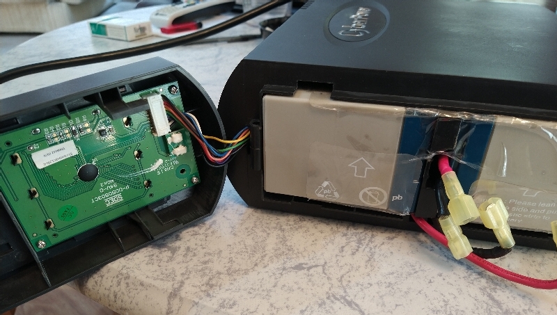

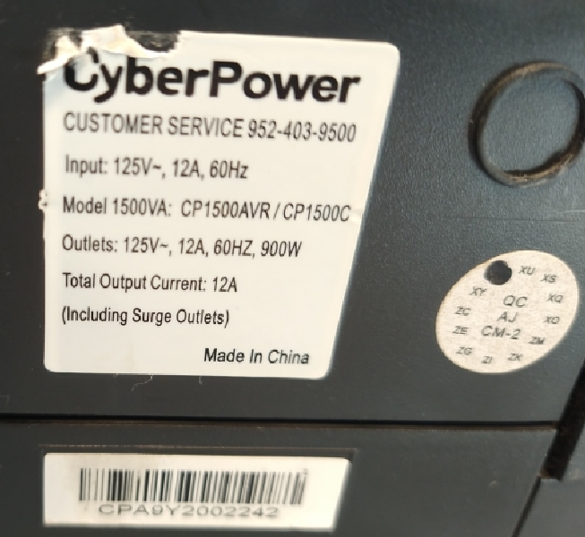

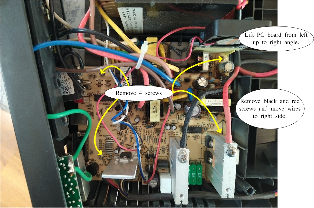

    I took apart the Cyberpower 1500C / AVR. It was still working but only showing 12-13VDC charging voltage. I see issues on the main board as described in previous posts.
    Bottom tag on Cyberpower 1500c
    Remove screw pictured and pull panel down and off. Disconnect front panel cable and two battery pack wires red and black.
    Remove two screws holding case together on front of case as shown in picture and six screws on back of panel. Lift cover off to see board.
    Remove red and block wire on the top of board as shown. Remove 4 screws holding the board to the case. Lift board to remove, clean and replace parts.
    The Cyberpower 1500c purchased ~ 10 years ago was still working but taking a long time to charge up batteries to 100%. (4-5 days).
    Next steps shown will be removal of caps and IC and clean up and replacement of parts.

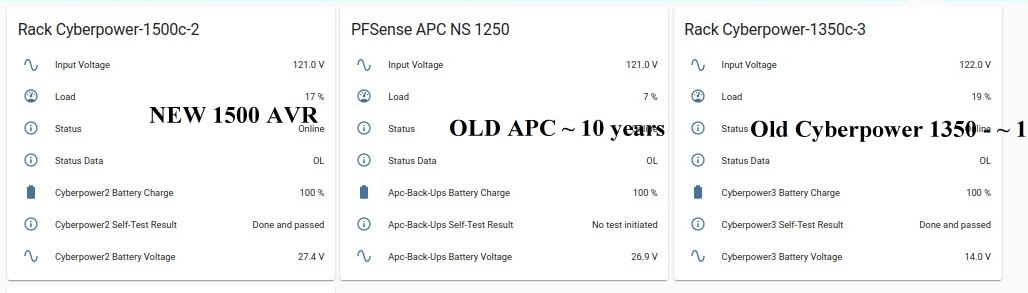

      Re: CyberPower 1350AVR and 1500AVR - Repair
      BTW here running NUT on BSD PFSense / XigmaNAS and built a couple of RPi2's which are NUT servers. Monitoring them with Home Assistant.

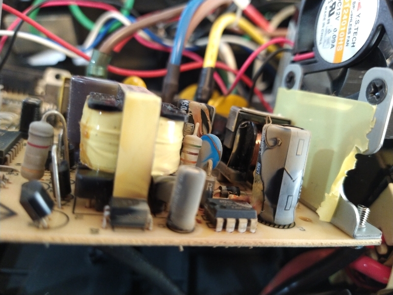

      Here is the Cyberpower 1350 which will need to be repaired. Notice the charging voltage on it.
      Here is the new Cyberpower 1500. Noticed the difference in the charging voltage.
      I have yet to move the Cyberpower 1500 to the work bench. Looks easy to de solder the caps and IC. Looks difficult to clean off the old glue.
      Might try..

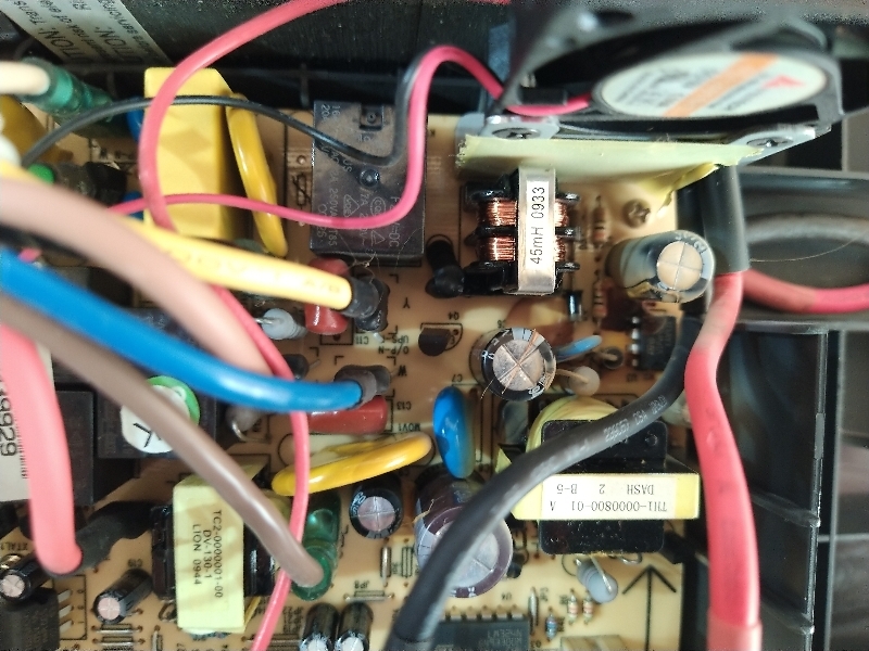

        8th of May, 2022
        Took the board out with all of its connections intact. Brought it down to the basement workbench where I have a soldering station and heat gun.
        Using a large magnifying glass with lamp for all of the desoldering stuff. It is very old. Real glass and a fluorescent circular bulb on it. Got this in the 60's when tinkering with Amateur radio.

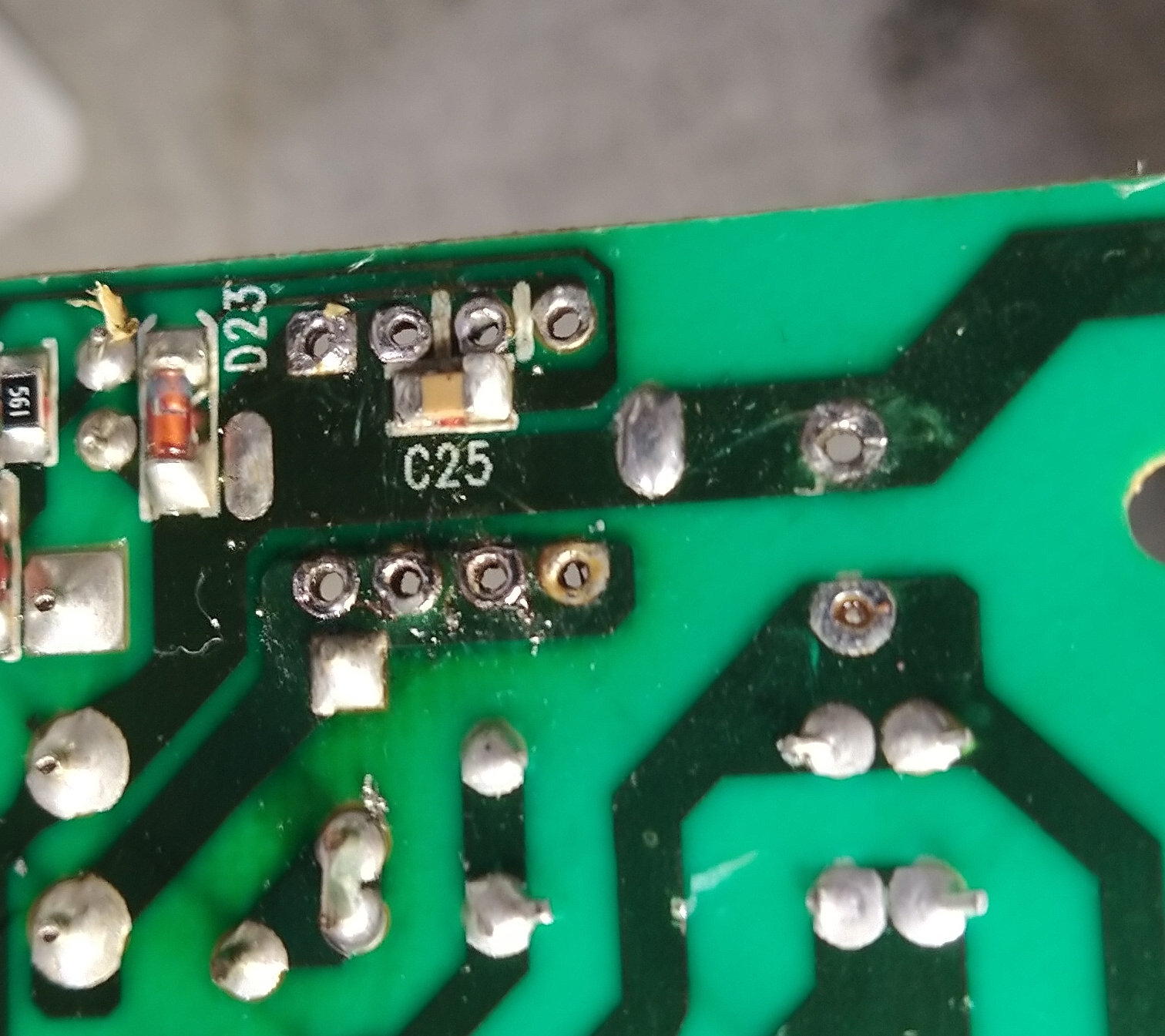

        Desoldered and removed two capacitors. Easy to do once I re soldered the posts.
        IC difficult.
        Purchased tiny wire cutter which I did not have to nip off the IC terminals on the top of the board.
        Have desoldered IC posts. This way I can grab one post at a time to remove it.
        I was going to purchase a soldering vacuum but really not necessary for doing this a couple of times.
        There is a lot of glue that goes between one post on IC and Capacitor.

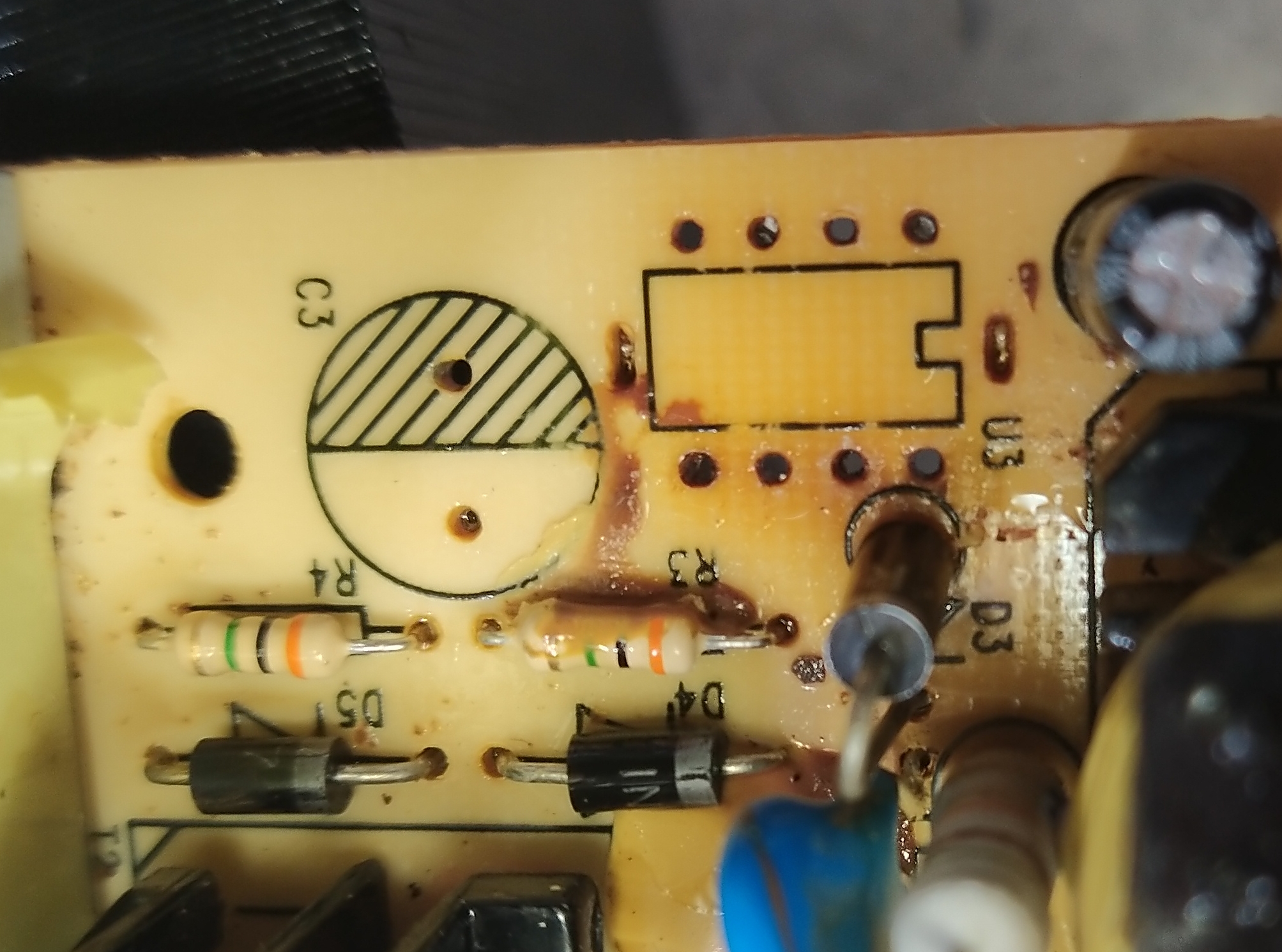

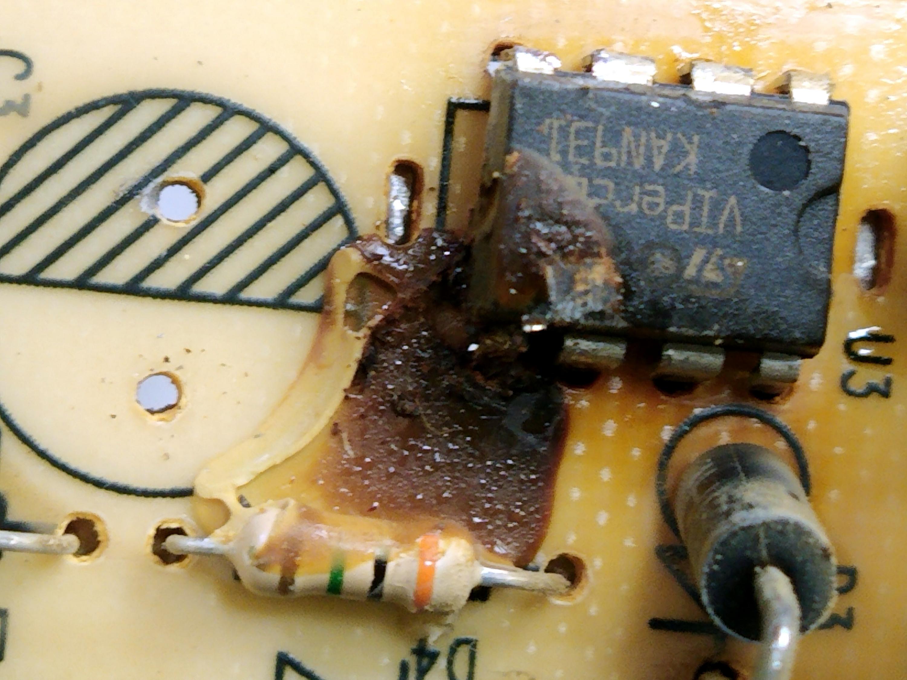

        Here is a large picture of the damaged VIPer22A. I am surprised that the UPS still kind of worked; well with 12-14VDC charging two batteries.
        Still wondering best way to clean the glue off.

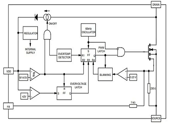

        Here is a block diagram of the VIPer22A.
        How does this provide 24VDC + charging voltage to the UPS two 12VDC batteries?
        What is the purpose of the glue that is there?
          Update 10th of May, 2022
          Got my little wire clipper today.
          Clipped the top 8 IC pins with the wire clipper. Chip was burnt and brittle.
          Using a small needle nose pulled on pins as I de soldered them.
          Closes pin to capacitor did not have any solder on it and fell off.
          Using a pin to make sure that there was no solder in the holes.
          Using an exacto blade lifted the glue off in one chunk. Fell off.
          Cleaned top of board with alcohol.
          Typically have taken pictures of projects using my digital SLR. This is the first time I have used my phone to take pictures like this.

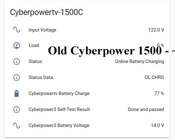

            Plugged it in and it showed a 72% charge. 2 hours later it was at 100%.
            The battery voltage showing is what each battery is for the older 1500 and 1350.

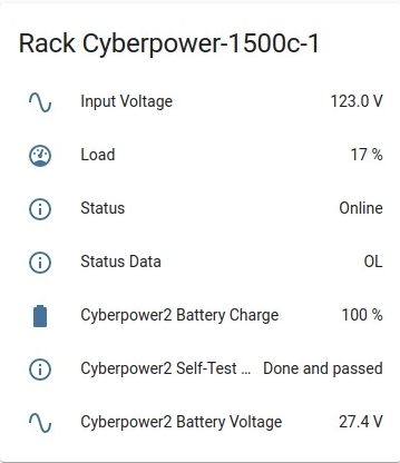

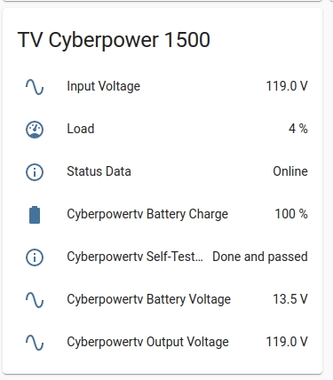

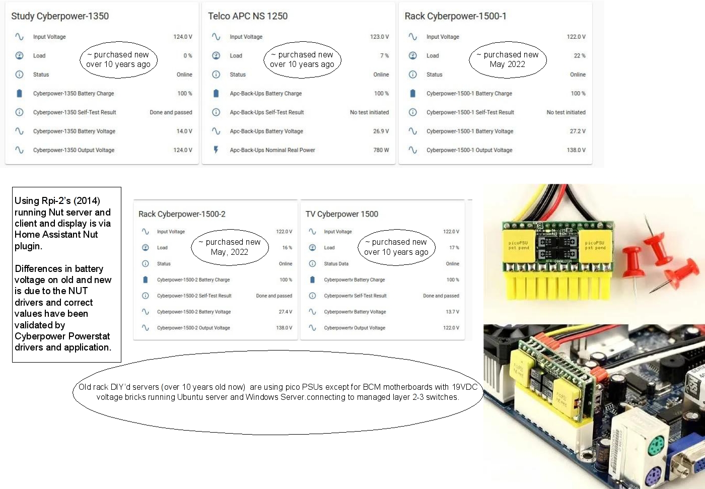

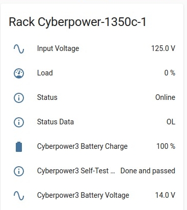

              Just a quickie note between NUT values on the older Cyberpower 1500 and new Cyberpower 1500.
              NUT Values
              Battery Voltage
              Old Cyberpower Battery Voltage 13.7 V indicates voltage per battery
              New Cyberpower Battery Voltage 27.2 V indicates total battery voltage of two batteries.
              Output Voltage
              Old Cyberpower output voltage ~ 120 VAC
              New Cyberpower output voltage ~ 137 VAC*
              * This is a NUT issues which has been documented. Using Cyberpower Powerpanel in Windows or Linux will show ~ 120VAC.
              The Cyberpower 1350 has no load on it for testing. Today unplugging it and will let it run down the battery until it shuts off. Then will power it up to see how long it takes to recharge the battery.
              0800c time - unplugged Cyberpower 1350.
              status On Battery Battery Discharging
              Cyberpower-1350 Battery Voltage 12.9 V
              Note Battery voltage immediately dropped from 14V to 12.9V

                    Here is a quickie overview of the NUT servers running and display using Home Assistant.
                    Most power consuming devices on the rack today are Russound distributed audio amplifiers and the XigmaNAS box #4 (8 SAS drives using a Xeon motherboard).
