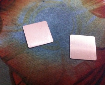

    Hello, guys.
    I have a question and I wasn't sure where to put it exactly, so I decided to it here as my greatest concern is the well-being of my PSU.
    I had an accident with my PC casing, where it turned over and fell to the floor, hitting it hard with one of its upper rear corners (where the PSU is). Aside from the PC housing denture and a slight buckle at that area, no functional damage was noticed and the PSU housing also looks intact, the PC has been running just fine. However, a few weeks later, when I opened it to remove the dust, I found this litle copper-looking plate dangling inside the PC case, as in the photo. This pad is about 1x1cm, it is very thin, and on one side there is a residue as if it was welded (or soldered, but there is no solder, just a slight discoloration) onto something with a small circular connection.
    Now, the PSU in question is SeaSonic X Series SS-660KM and I would like to ask if any of you know whether this little peace fell out of this particular PSU due to being knocked off by the force of the hit. I did inspect the PSU housing and concluded that there simply isn't large enough space anywhere for this little square piece to fall through (so that convinced me that it wasn't from the PSU). I also searched on the internet for various detailed reviews of this PSU, hoping to see whether somewhere on the images showing the inside of this PSU I could see this little piece, but I couldn't find any image showing some PSU components with this particular pad (so, this also made me feel it wasn't the PSU, but...).
    My PSU is still under warranty and I am reluctant to try to open it, so do you know for sure whether SeaSonic used some parts like the little piece in any of their PSUs, especially this X model?
    Also, any idea about where this little piece could have originated from would be very appreciated. My biggest concern is the PSU as I still use it (other components at the time of the accident were all replaced in the meantime), I really hope it didn't damage itself or lost some of its components.

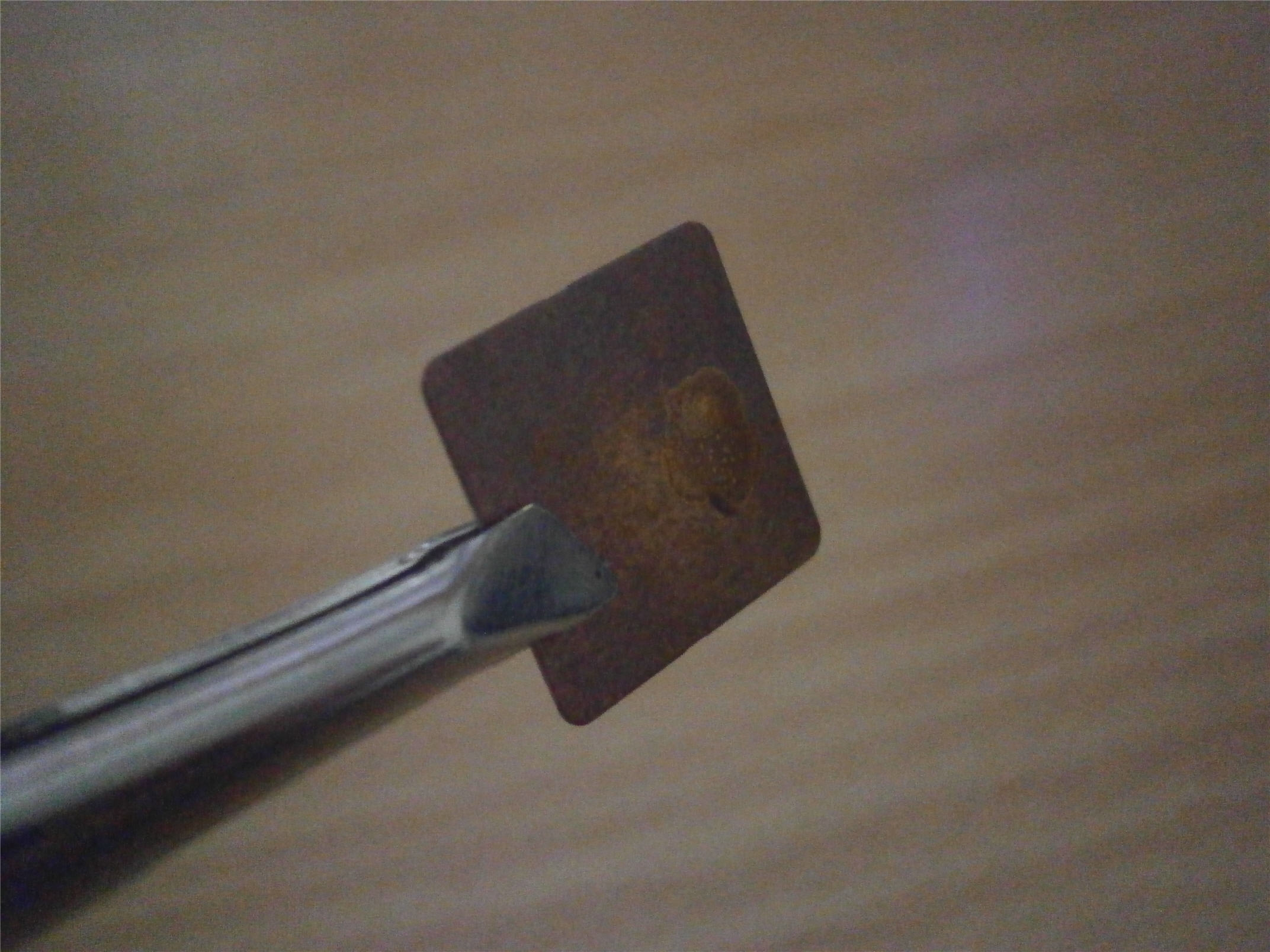

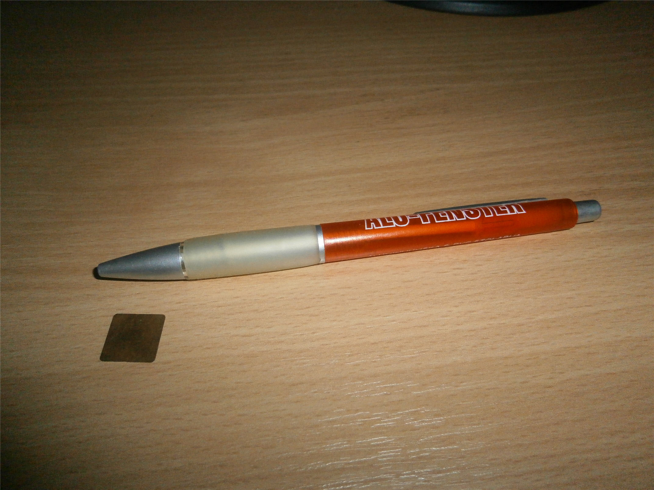

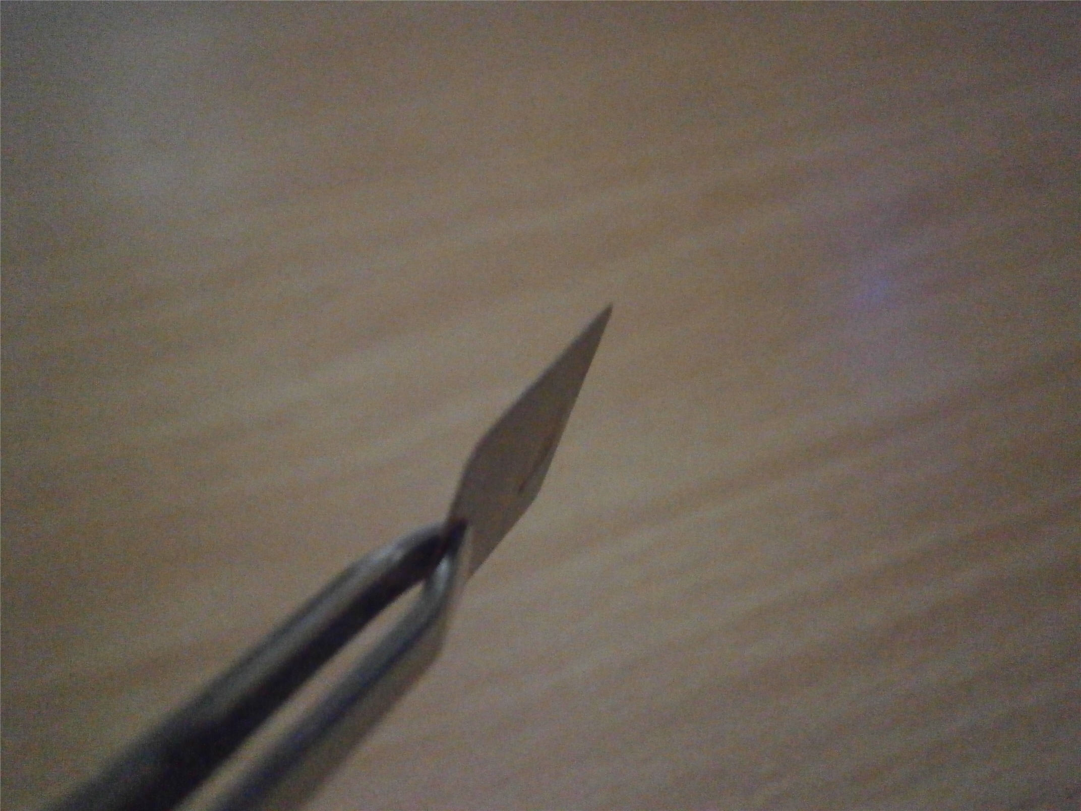

          Here is the little pad:

              actually, looking at your new foto's i think it may have acted as an RF shield - possibly glued onto something sensitive to act as a shield.

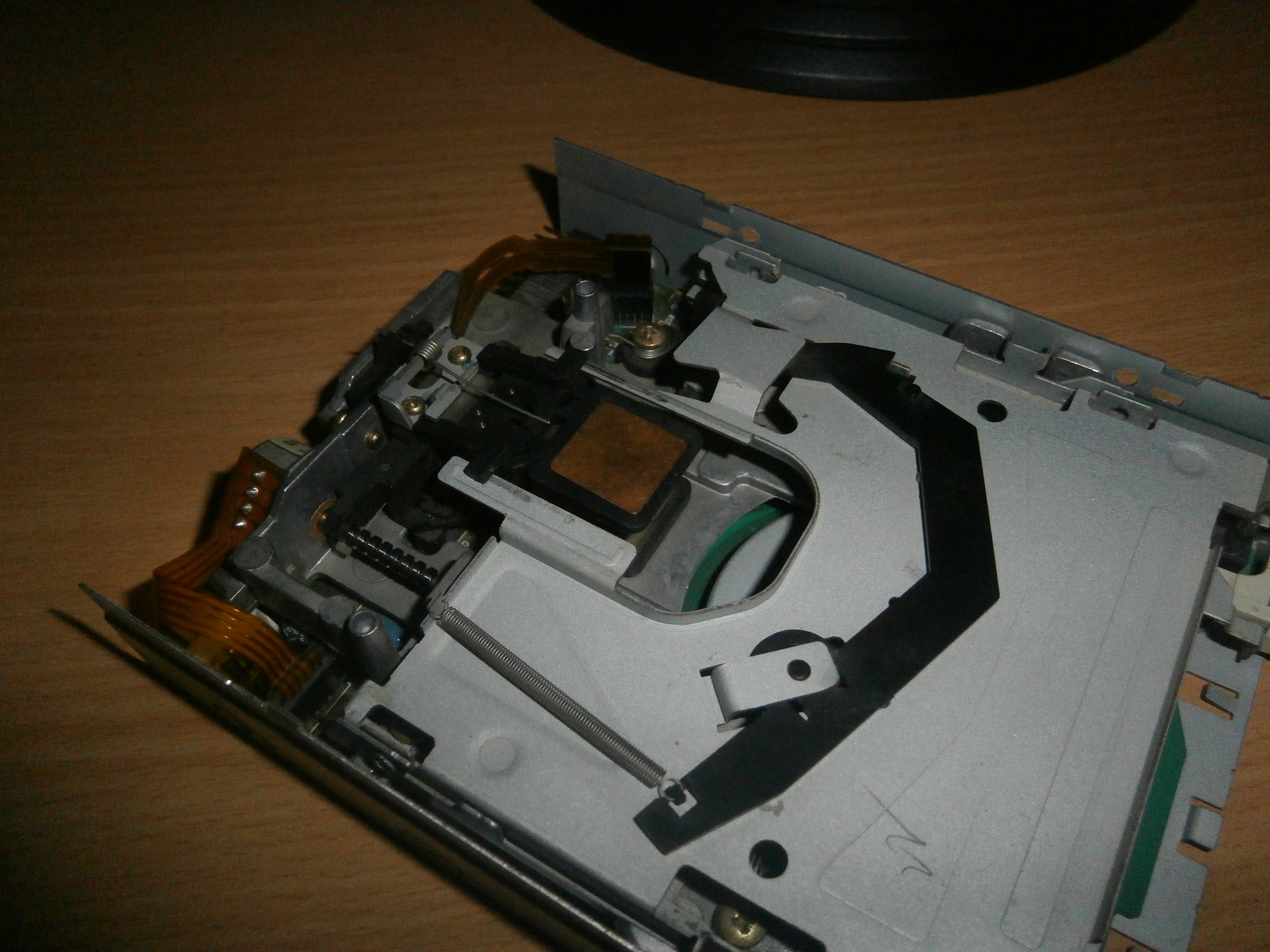

                  i'll tell you one place i'v seen something like that in the past - inside floppy drives on the back of the heads!

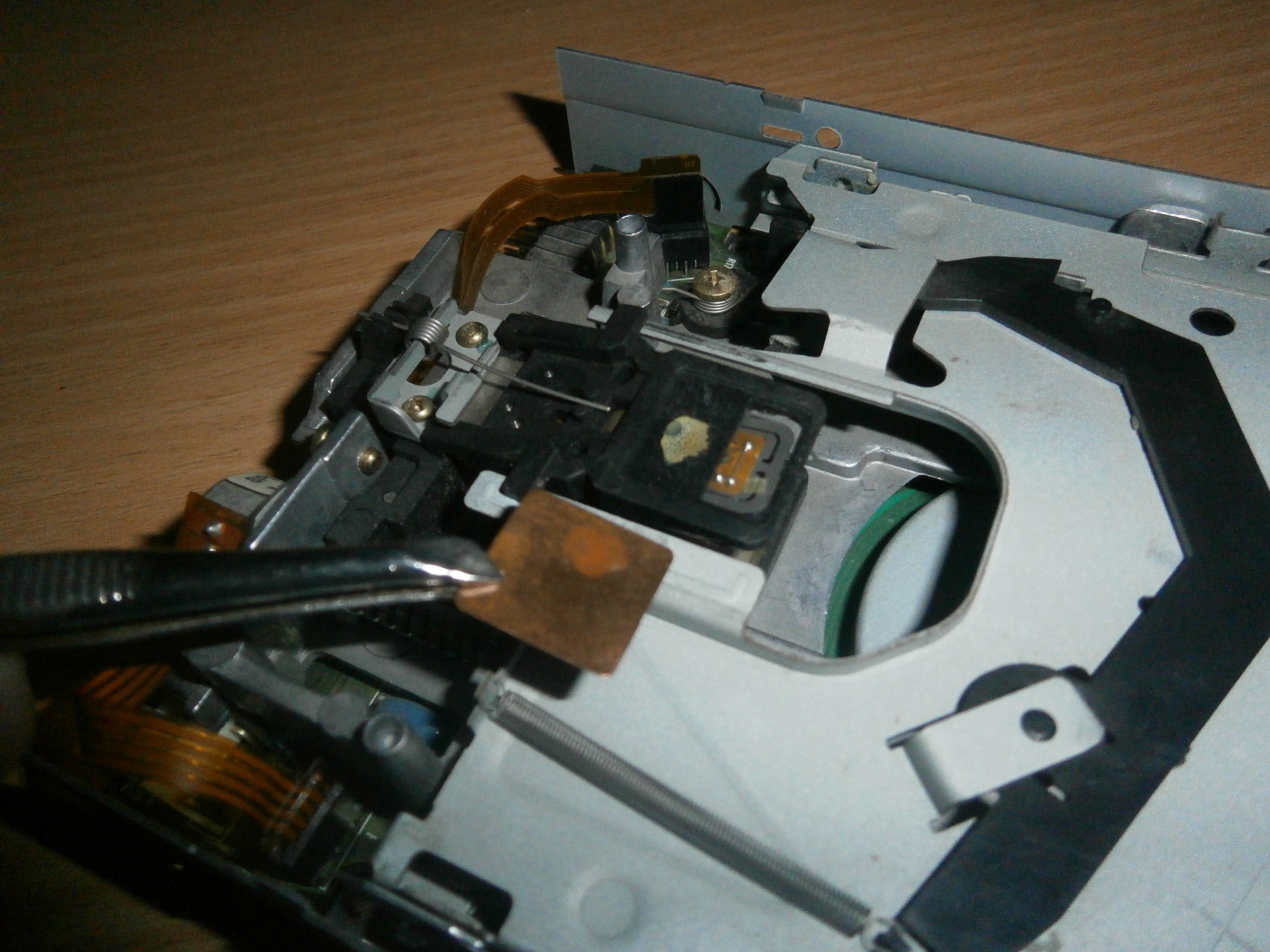

                    My dear stj, you are a genius! I would have never thought to check out the floppy drive. There actually was a floppy drive in that casing at the time, but it was only left mounted in there and wasn't in use. So I decided to take it out and check. When I opened it, there really was a light square indentation on the upper head, along with a matching glue residue on its surface! The pad I found fits it perfectly, and the glue position also matches it to the forensic level!
                    Just to be sure, I then took apart the lower portion of the floppy drive and moved its head to see whether the lower head also had this pad - and it did, an identical one! So this little pad definitely came off of this floppy drive, and its housing had plenty of spaces through which it could fall out, ending up dangling inside the computer case.
                    I am so happy and relieved! Thank you all for your kind suggestions, but stj hit the spot! The mistery is finally solved. And the most important conclusion now is that my PSU is obviously instact and complete.
