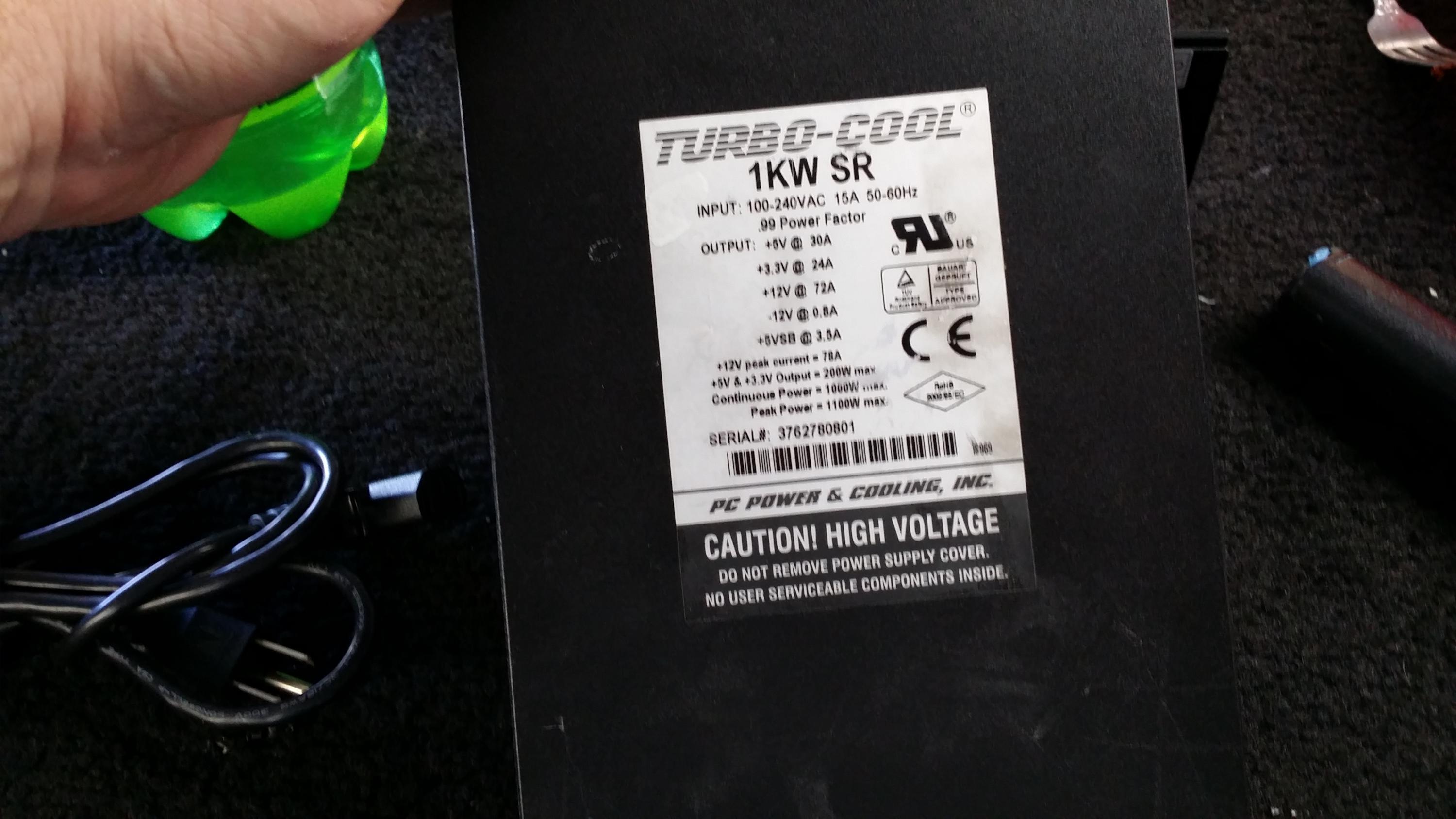

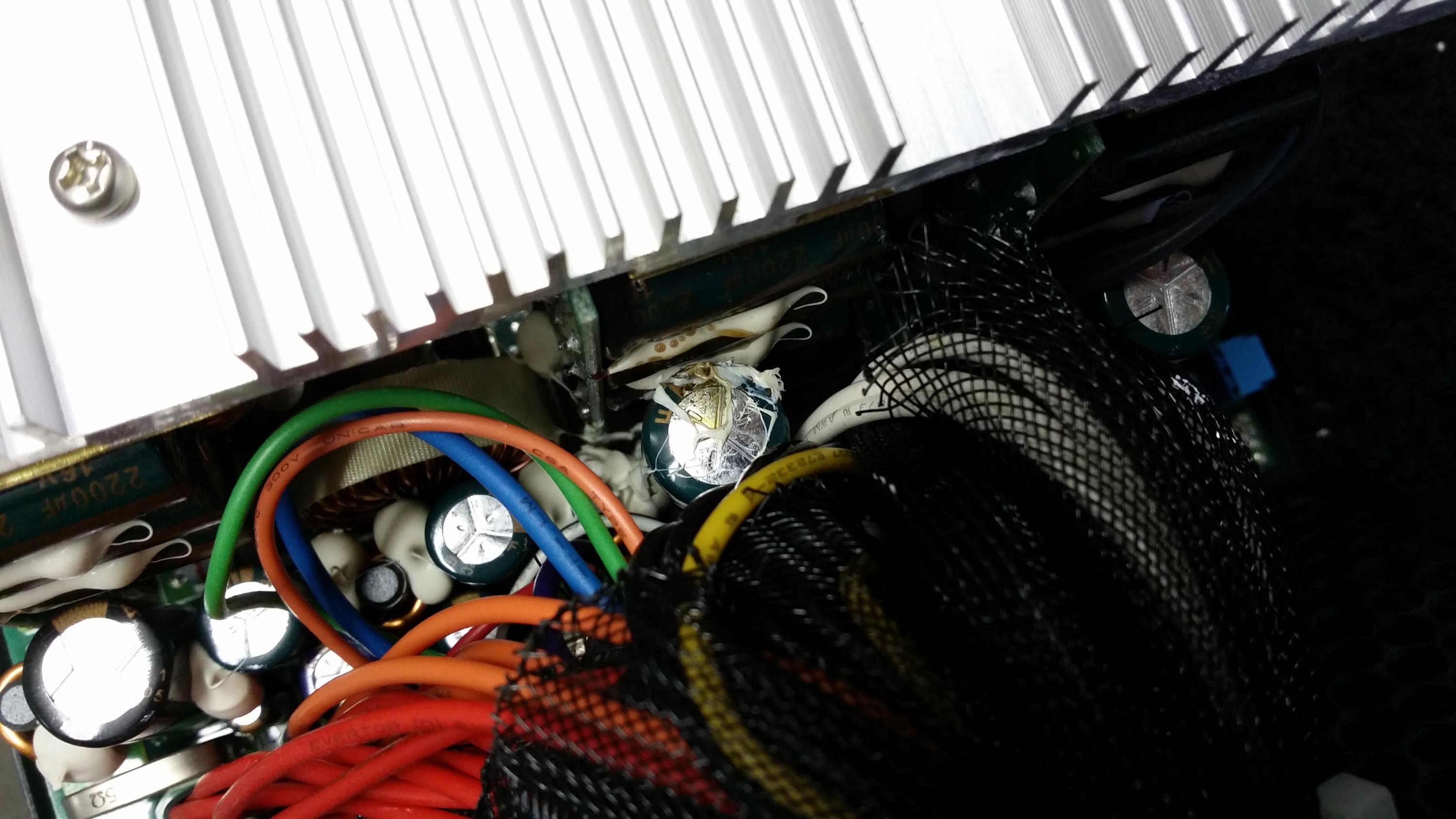

    got 2 of these for recycling.teapo caps are the problem.
    i deployed some of these new and they were $500 units.
    one was working fine on a psu tester with a 4700@16 on one of the +12 rails whistling like a teakettle!
    these will get a full rebuild.several more are coming my way soon.

    I guess it goes to show that good design only does so much to improve the live of the caps (and why I don't regard Teapo that highly).
    • Wester547
      • Nov 2011
      • 1268
      • USA.
      Re: pc power and cooling turbo cool 1kw-sr
      Well, Delta and Newton do manage to substantially prolong the lifespan of Ltec and Taicon in their power supplies, so good design definitely means something. Teapo are just undoubted junk, not much better than Fuhjyyu and CapXon really. It probably doesn't help that it's a 1000W unit with 72A on the +12V rail, so the computer powering it was probably +12V heavy to put it in one manner? I don't imagine the Hermei are in much better condition.

        Capxon is worse than Fuhjyyu and Teapo. I see them failing all the time.

          Is that SC or SM series?
          The SC Series is rated for just 2k hours, so it's not that bad...
          Though you don't know how much the cap was stressed...

            Teapo are less likely to show signs of failure than Fuhjyyu and CapXon. IMO, that's the difference between them. I'd only trust all three brands in the voltage doubler and that's only because ESR isn't critical in that application. Just my opinion, of course.
            SC series, I'd guess. Both series are actually rated up to 3,000 hours.

              4700/16 sc.
              thats a bit of a hotspot there with limited/no airflow.
              all the 2200/16 on the modules were 1.x to 2 esr.goners.
              the 4700 is a custom as its not in the datasheet.
                ^This, a turbo-cool 1KW is probably at least 7-8 years old now (I believe the 1,200w replaced them in 2007/2008), and most are used in high-stress high hours applications, it is honestly surprising they lasted as long as they did.
                It is still pretty ridiculous that they used Teapo SC's in a $500 unit though. At least they fixed that with the Turbo-Cool 1,200W, I've got one of those and it is pretty much all electrolytics on the secondary are Chemi-Con KYs, and Hitachi Primaries.
