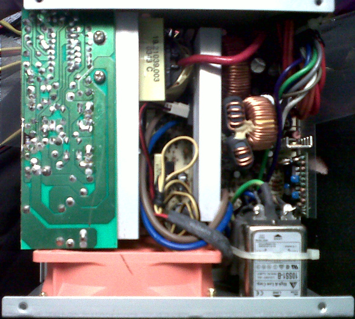

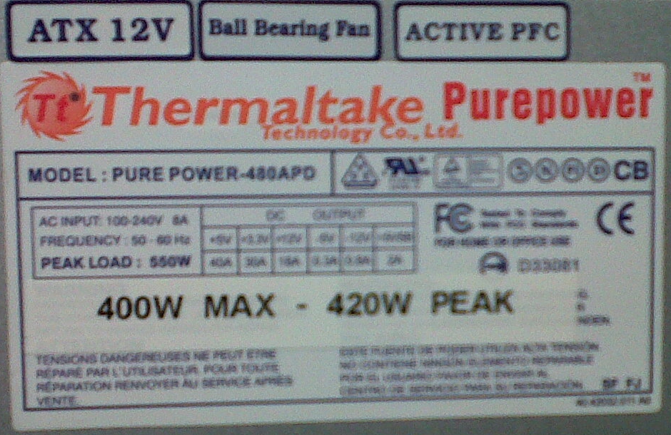

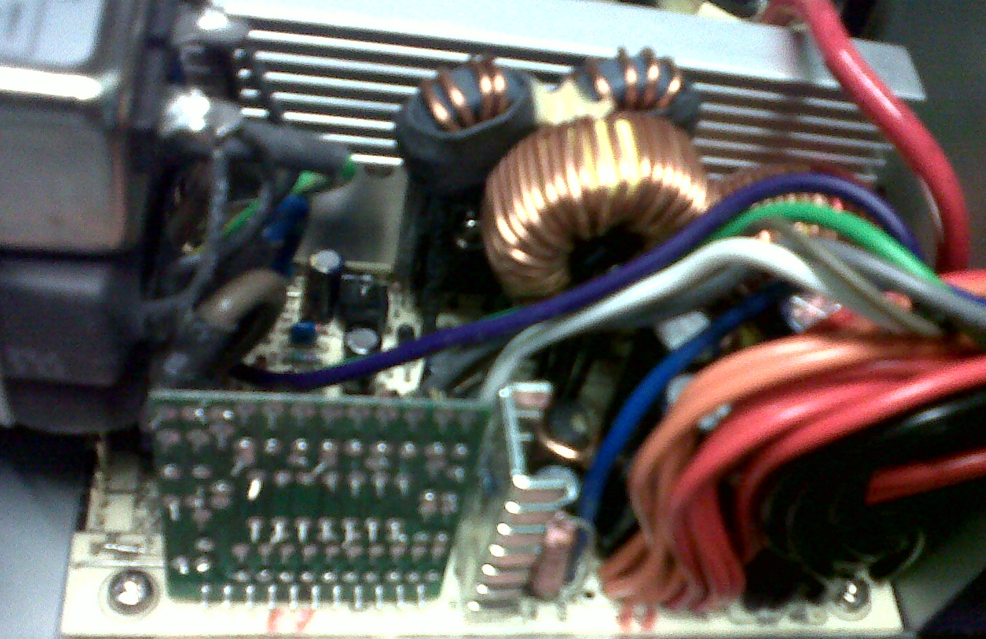

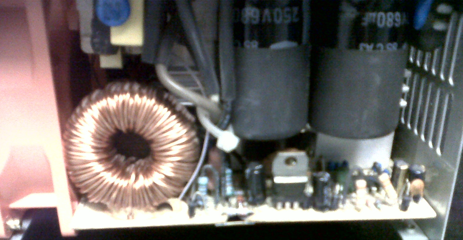

          • 31163
          Re: PFC question
          o.k.
          they are chieftech psu's re-badged.
          thermaltake
          pure power-480APD
          the pfc board has "WAN NIEN" printed on it.
          the pfc board is using ucc3818 controller, byc10 diode, 20n60 fet and some other big semi i cant see.
          notice the bullshit wattage rating on the label, and the sticker i put on it with the wattage ratings from the chieftech badged unit!!!
          pics.

            Re: PFC question
            I am sorry to deliver some bad news but this platform oscillates if it is loaded heavily at 12V. It was never designed for ATX12V in the first place, but a tweaked 5V heavy psu.
            I have the PPFC version. You can easily remove the APFC, but the input caps Voltage would be lower. Q=C*V. Less Q means the psu will be able to output 350W.
            If this thing has worked many years without failing or drying the input caps I would leave it alone.
