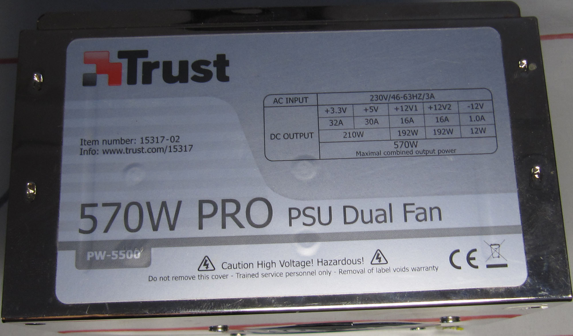

    First, a label shot:
    https://www.badcaps.net/forum/attach...1&d=1434896244
    Something is missing. Can you tell?

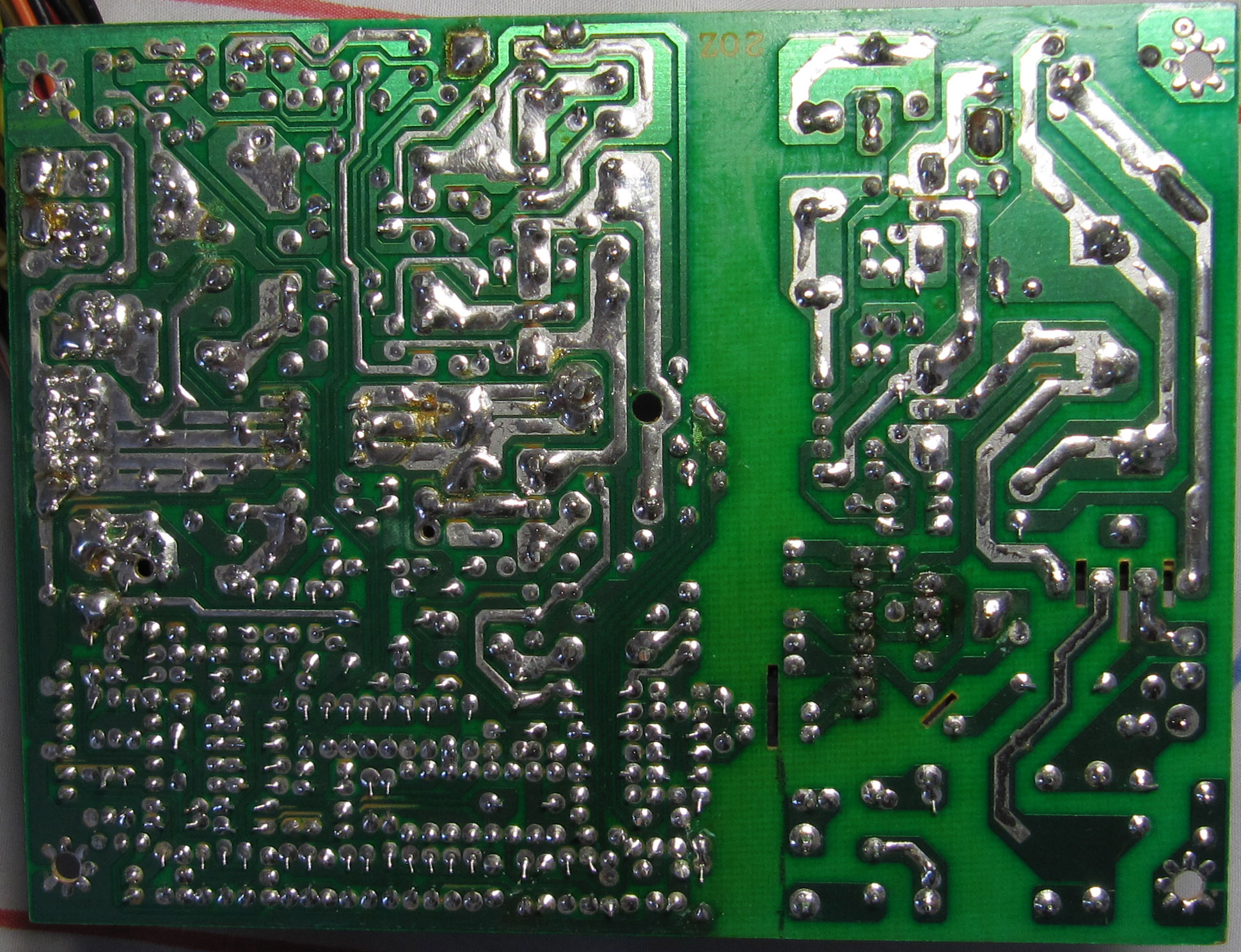

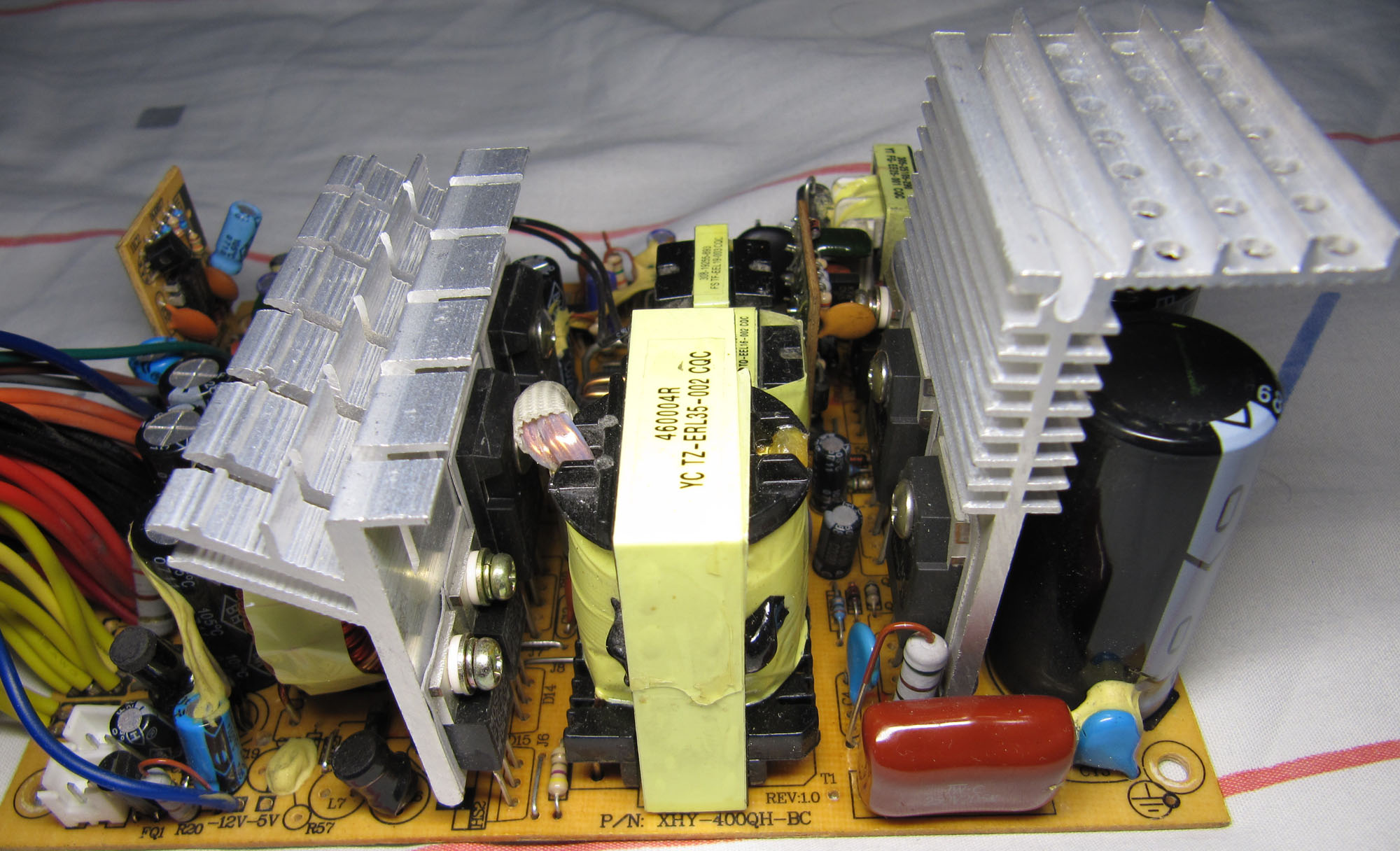

    XHY-400QH-BC is written on PCB. Google doesn't return anything useful.

    It's made by this company: http://www.sinhuiyuan.com/ The real company is XHY power, but if you type in http://www.xhy-power.com.cn/ it redirects to the first link I posted. They JUST redid their website a few weeks ago, so there might have been some sort of acquisition.
    PPFC coil and 5VSB output rating?
      You found it! No 5vsb rating

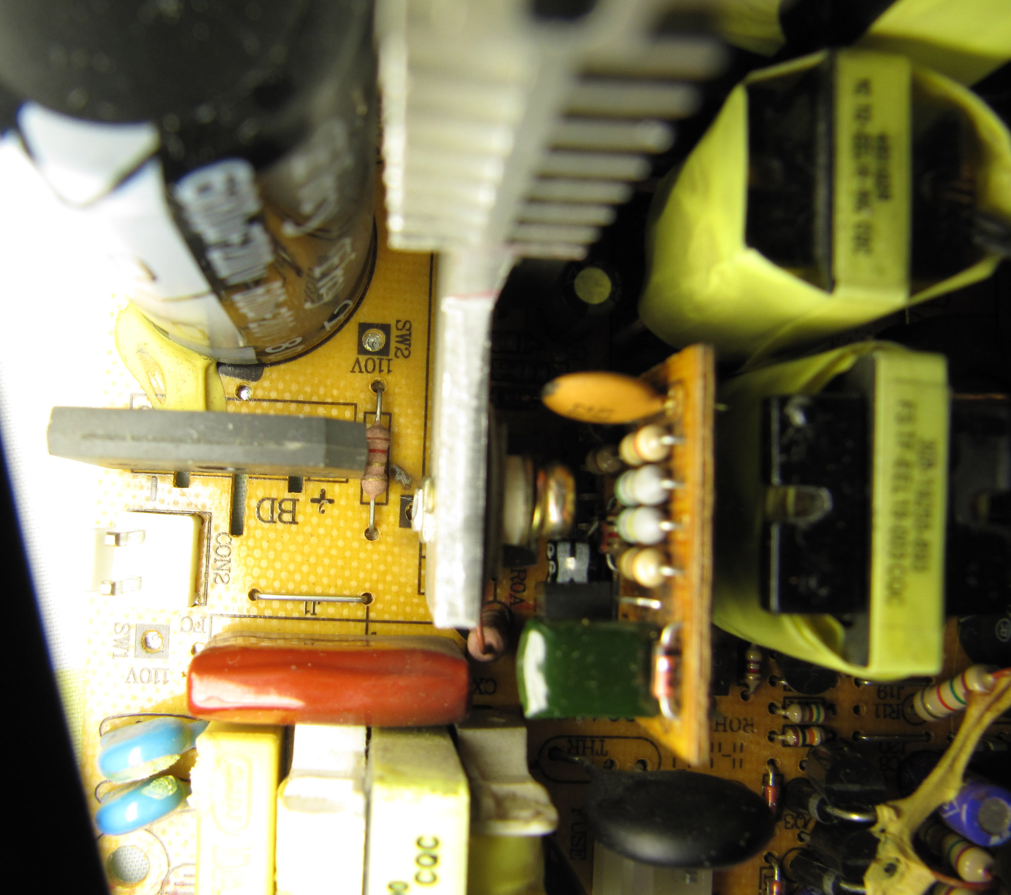

      It's completely dead! But I think I found something:
      https://www.badcaps.net/forum/attach...1&d=1434932101

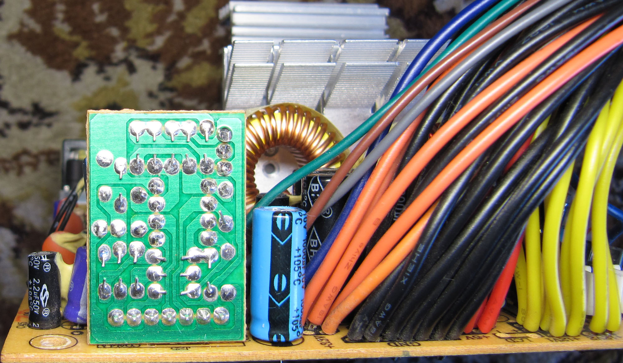

      That resistor is burnt and open. I wonder what could have caused this. I checked every capacitor including the tiny ones and they were in specs. The only cap that I had difficulty measuring was the 5vsb critical cap, located on an add on board between the 5vsb transistor and the 5vsb transformer.:
      https://www.badcaps.net/forum/attach...1&d=1434932723

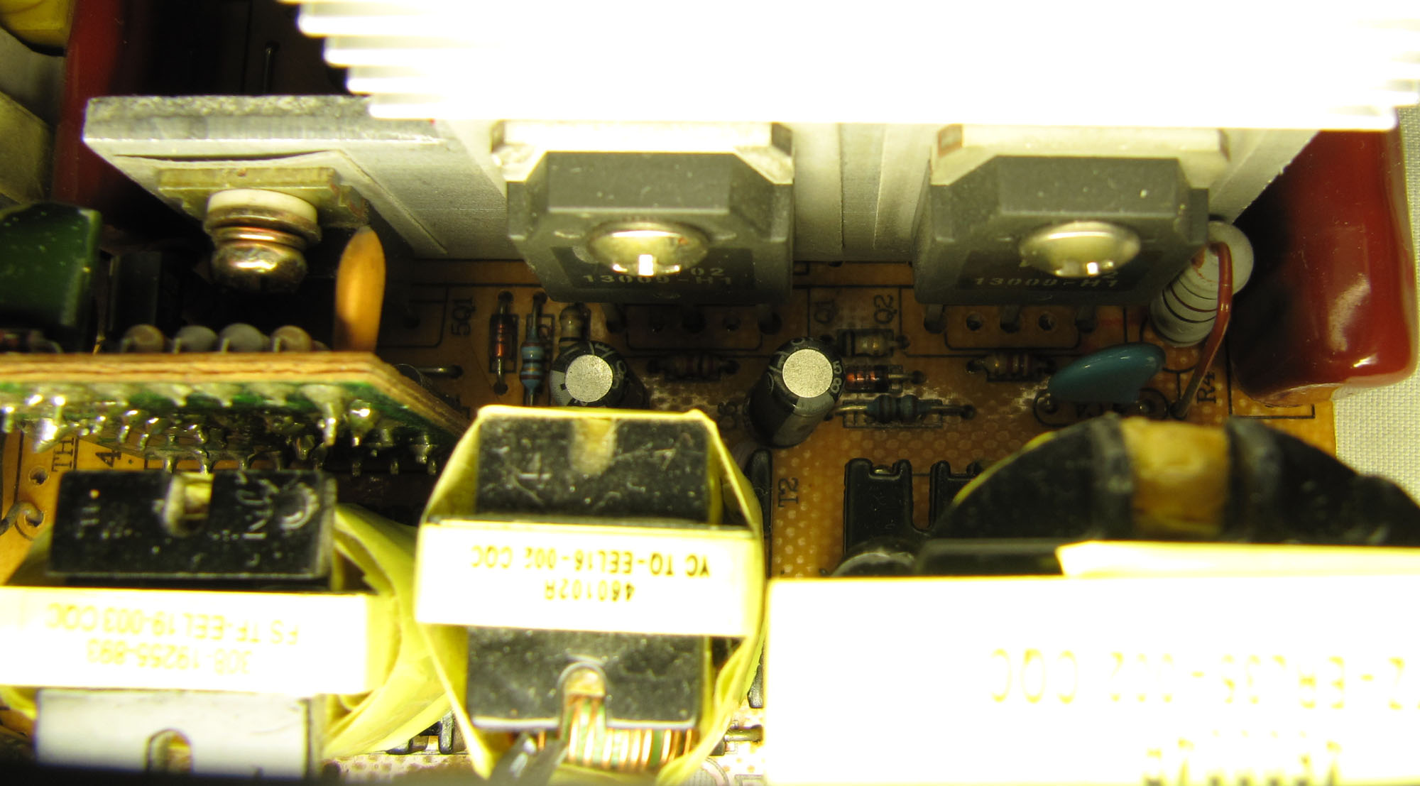

      As you can also see the primary transistors are 2x 13009 from unknown manufacturer.

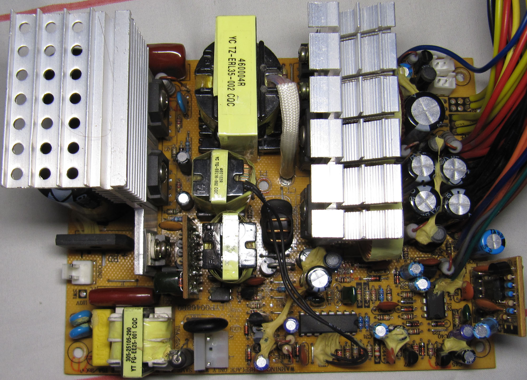

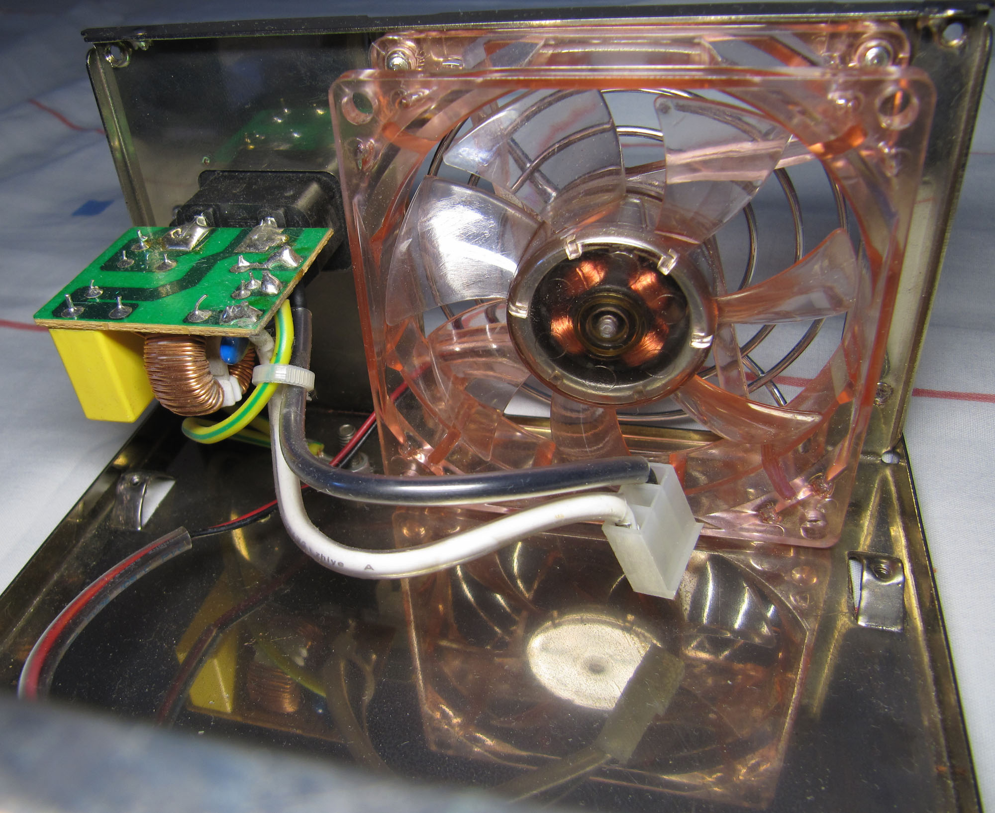

      It is a PPFC and dual fan psu:
      https://www.badcaps.net/forum/attach...1&d=1434932455

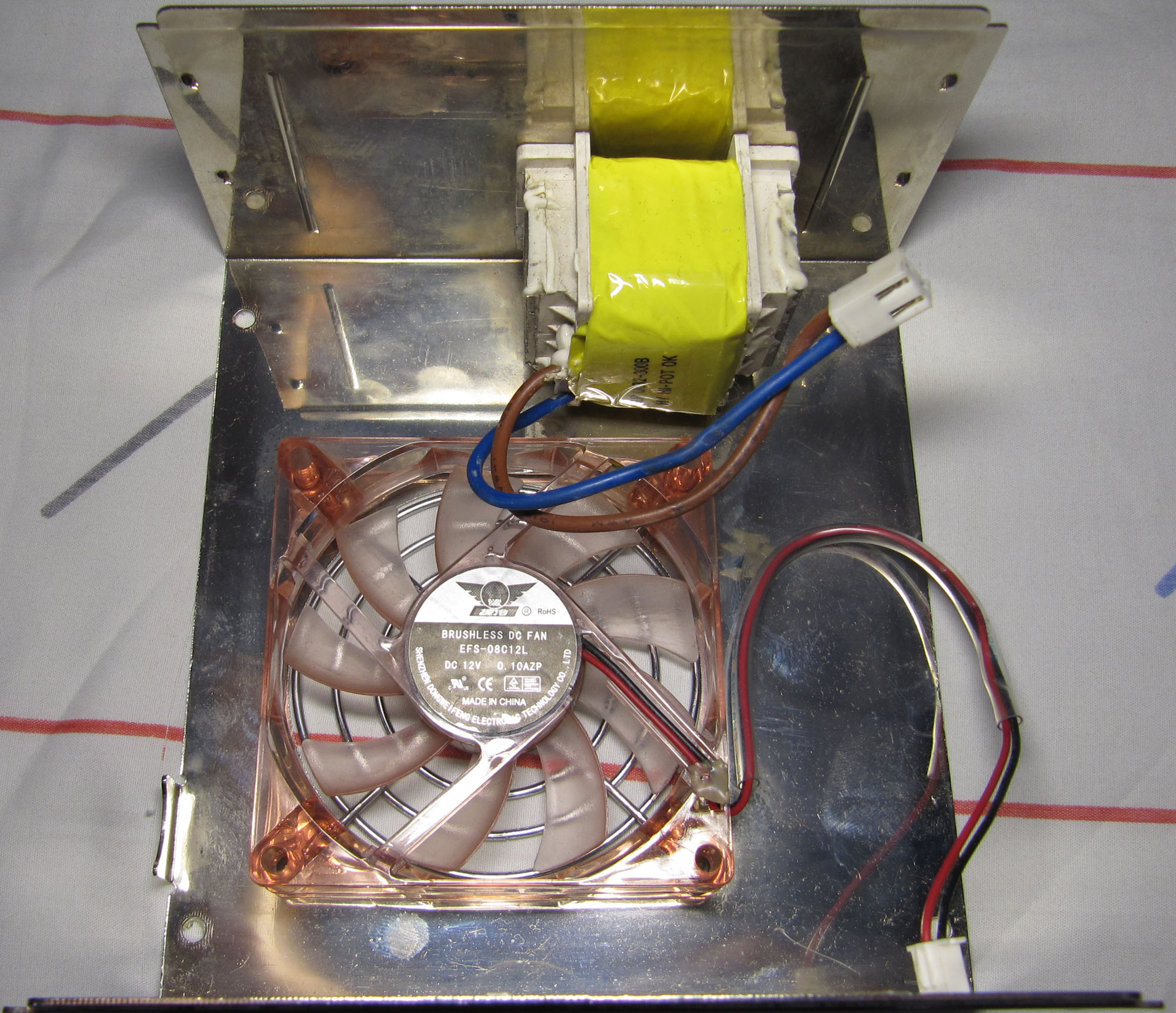

      Fortunately the fans are not directly connected to 12V, they are thermally controlled.

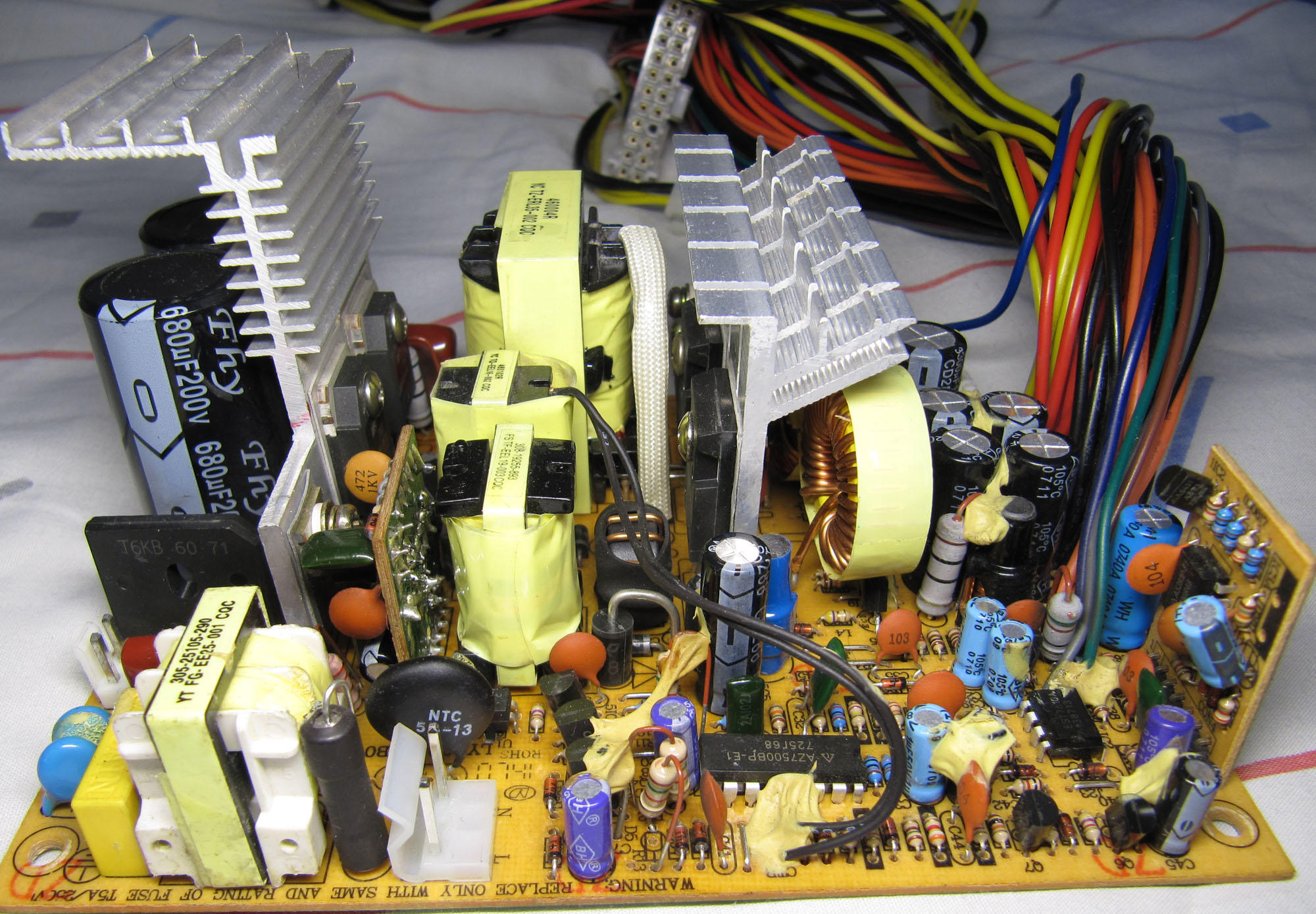

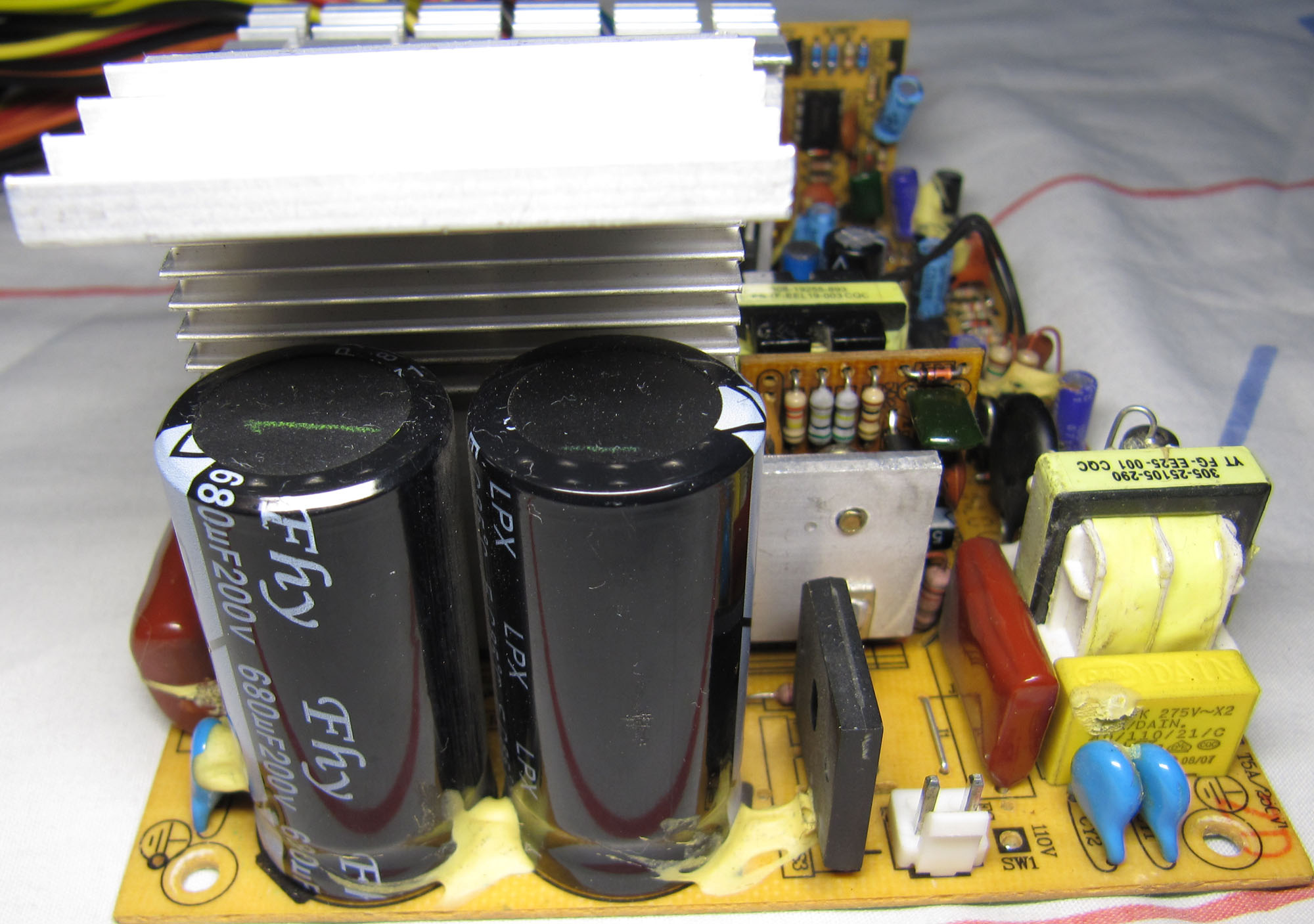

      The primary caps are 680uF "Fhy", but their real capacitance is 560uF and 562uF
      https://www.badcaps.net/forum/attach...1&d=1434933041
      There are no varistors installed for surge protection.

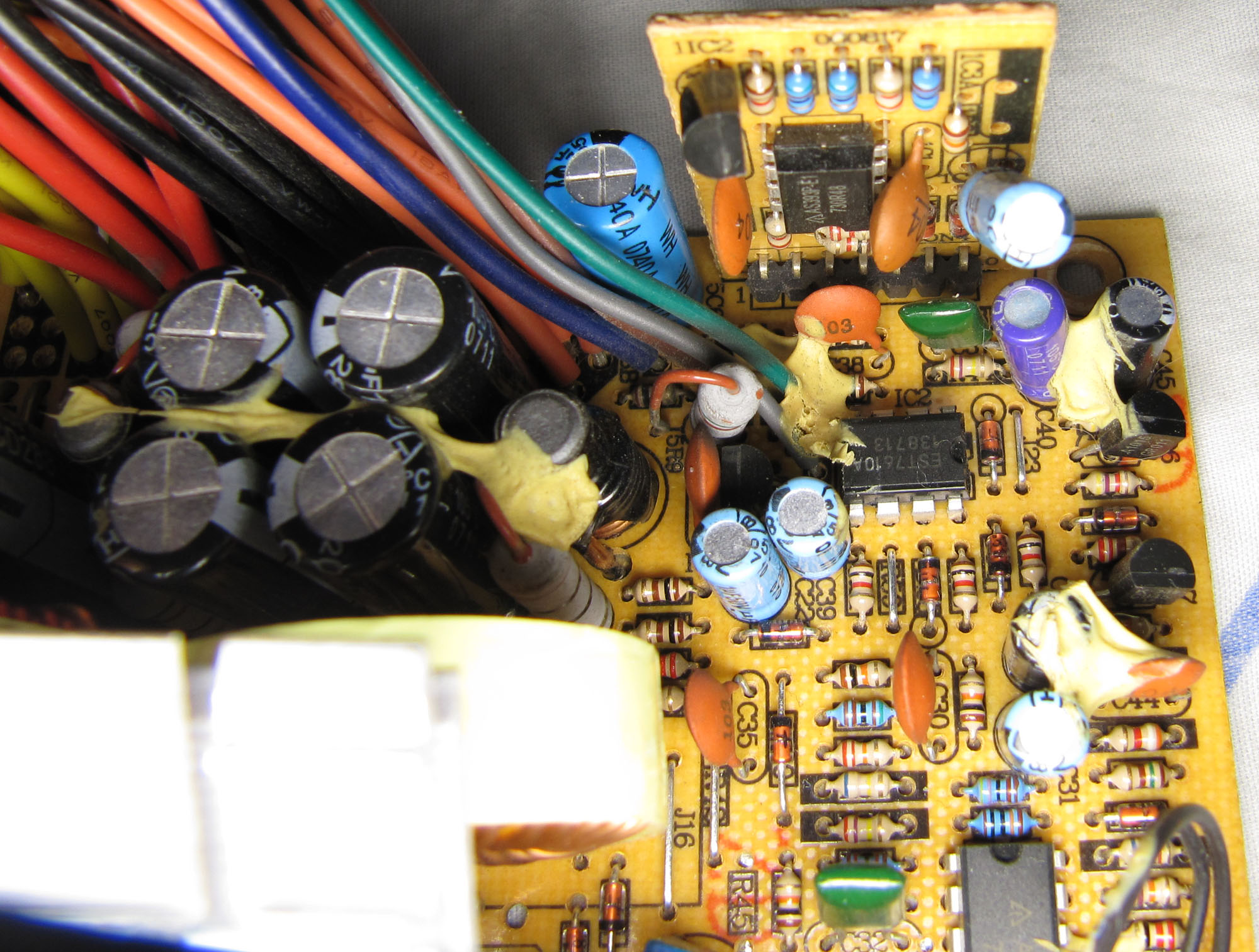

      The label didn't lie about the dual 12V output. The add on board takes care of that with AS393P-E1 IC:
      https://www.badcaps.net/forum/attach...1&d=1434933338

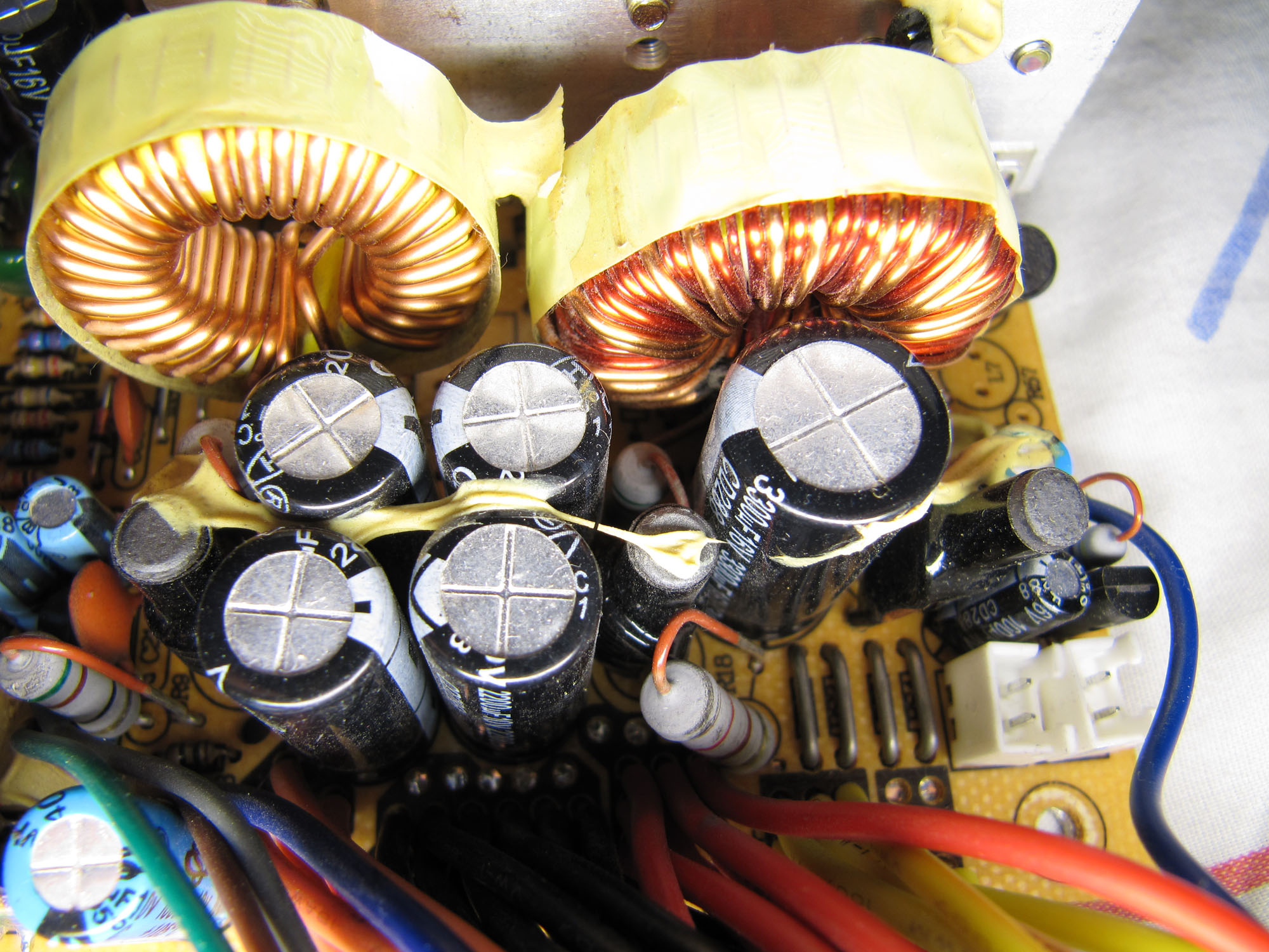

      Every output has coil and the caps are 2x2200uF for 3.3V and 5V and 1x3300uF for 12V.
      https://www.badcaps.net/forum/attach...1&d=1434933837

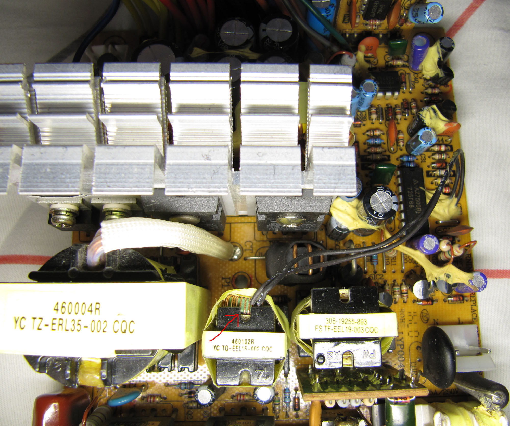

      Why is a coil hiding inside the feedback transformer?????
      https://www.badcaps.net/forum/attach...1&d=1434934137

        Been just yesterday doing some crazy shit (sticking 6 big 4pin snap-in caps instead of five even bigger 5pin ones) so I took measurement and…about 720 uF. They are brand new (well, older stock) Panasonic THA 820/450. I would call those input caps OK, these meters just measure them lower…
          Here is momaka's theory:
          Originally posted by momaka
          Some kind of OPP?
          My guess is they are *trying* to pick up stray flux from the core of the feedback traffo. But I somehow doubt that will work. If this really is for OPP, I will be very surprised if it works at all.
          Which pins does it feed to on the PWM controller?
                It's normal, fhy use the next capacitance and put that on the cap instead of the real one, I have a couple 330s that are 220s
