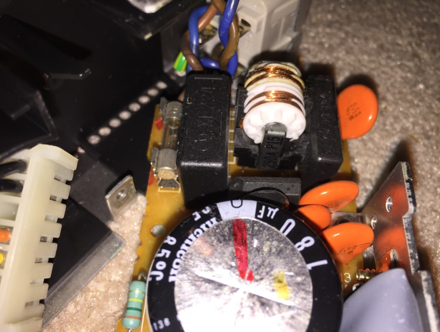

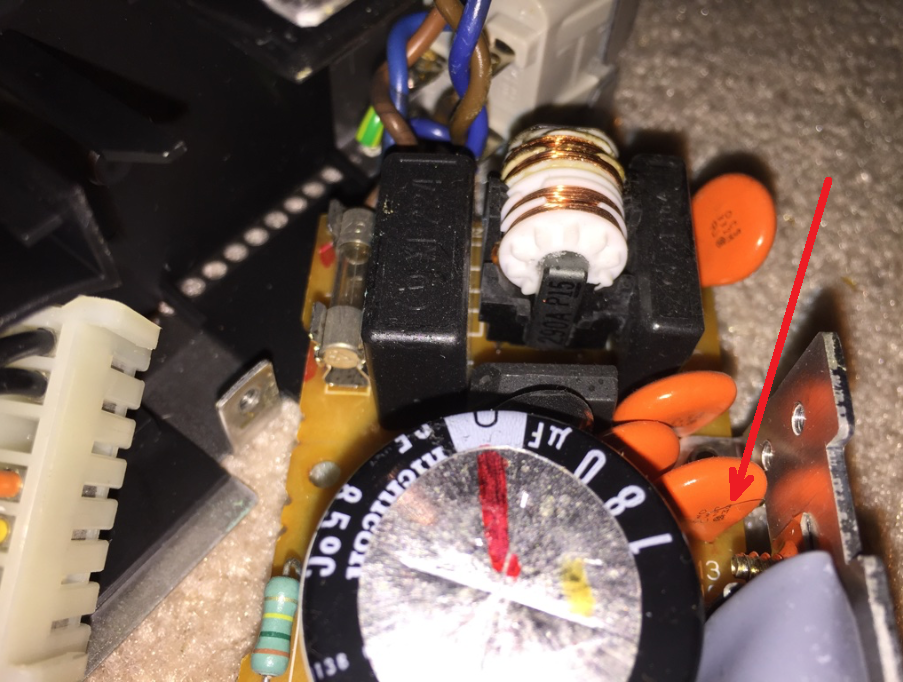

    I accidentally fried the inductor on an Apple LC PSU. Can anyone help me locate a replacement? The only part number visible to me is 290A P15.
    Thanks!

      Re: Apple TDK PSU
      The fried component in the picture is a common mode choke for EMI filtering - they should not be all that hard to get in the right size, but current capacity needs to be considered.

        Re: Apple TDK PSU
        Originally posted by goontron
        thats not the only thing fried! when that goes, something is very wrong!
        Didn't mention it was plugged in when I tested and it shifted and 110 touched it. The value and a suitable replacement is what I'm having a hard time with.

          Re: Apple TDK PSU
          ok, what are the dimensions of the choke? and lead spacing? also, what's the incoming line amps (or watts?) written on the PSU?

              Re: Apple TDK PSU
              The lead spacing is Half inch by 7/16, with the choke not much larger. I've attached a picture of the outside label.

                Re: Apple TDK PSU
                this one look about right? http://www.digikey.com/product-detai...0-5-ND/1994023
                if not, can i get actual package size for the choke?

                  Re: Apple TDK PSU
                  Looking at the picture, there is also a component that might be a varistor, wich is split in half (or so it looks).

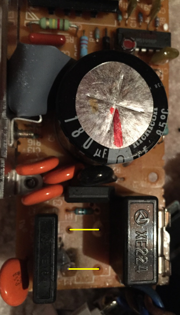

                    Re: Apple TDK PSU

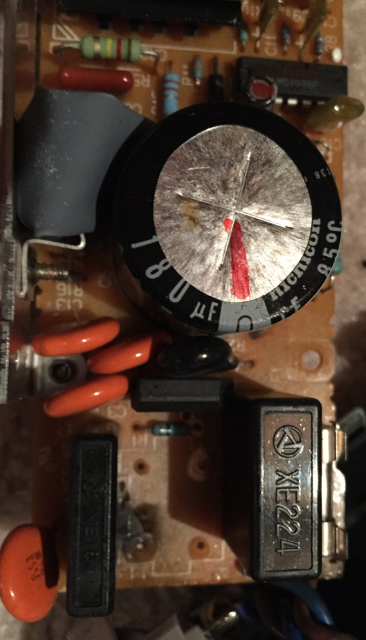

                    Adding a picture to double check..everything appears ok to me.

                        Re: Apple TDK PSU
                        I pointed the suspect component below. Could you check if it's a crack or just paint line..
                        In a transistor circuit protected by a fuse, the transistor will always blow to protect the fuse.
                          • 31048
                          Re: Apple TDK PSU
                          looks like a crack.

                            Re: Apple TDK PSU
                            I think it was just a molding line. I looked again and it looks ok. Any guess on at the mH that I should replace this with?
