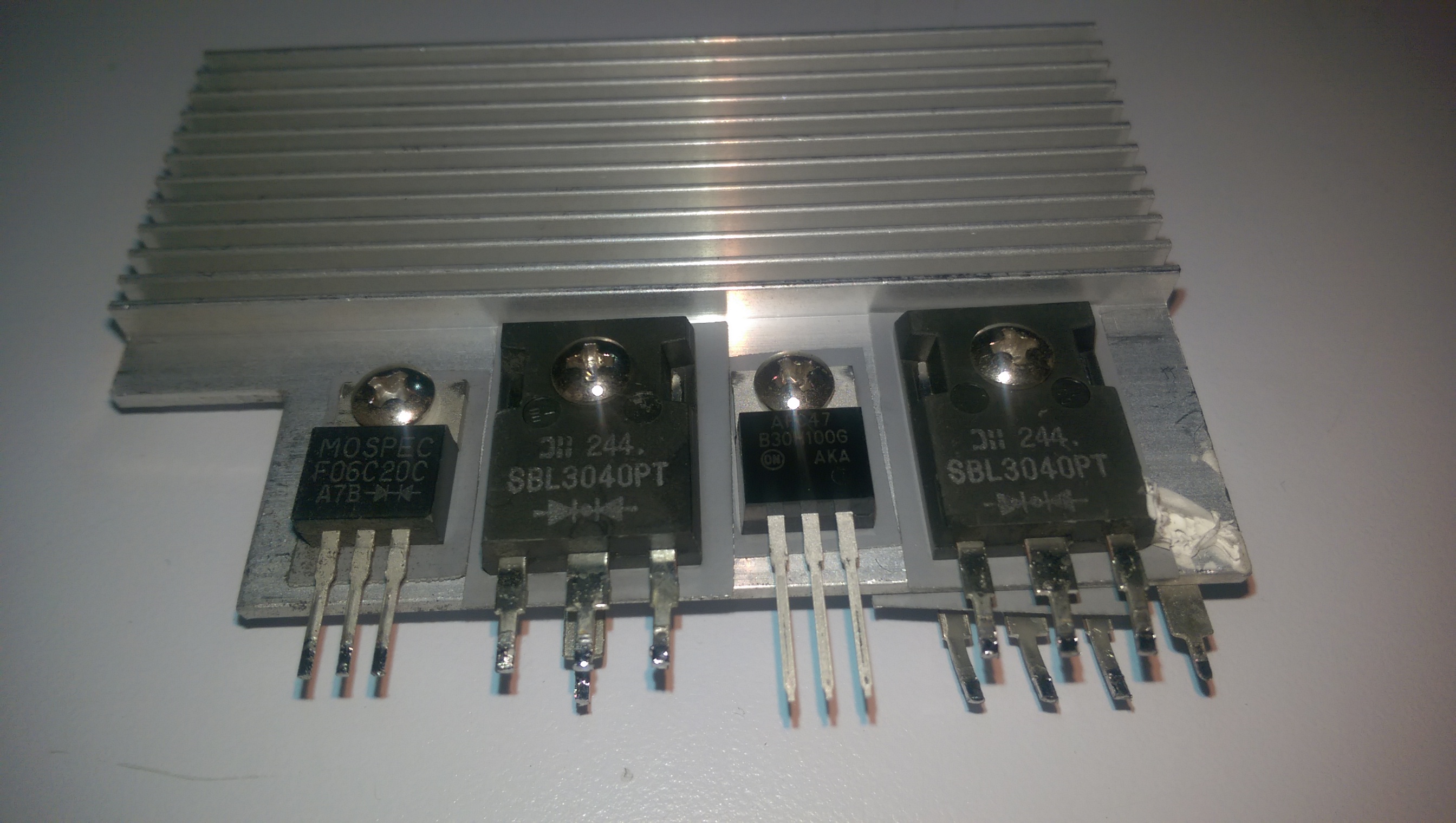

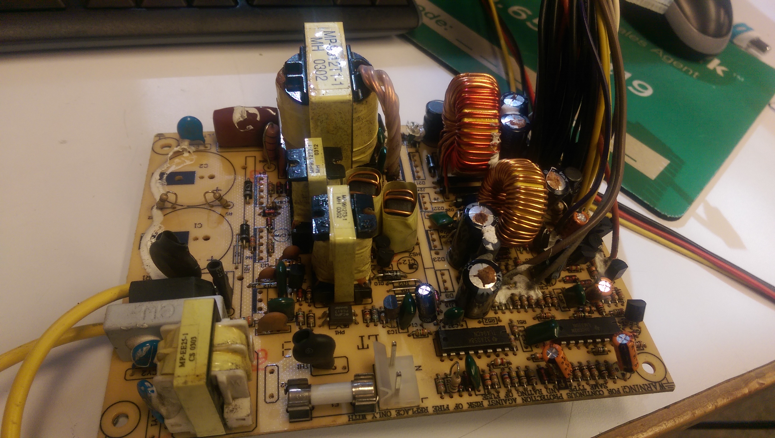

Another Macron MPT-301 saved
  • Pentium4
    CapXon Be Gone
    • Sep 2011
    • 3741

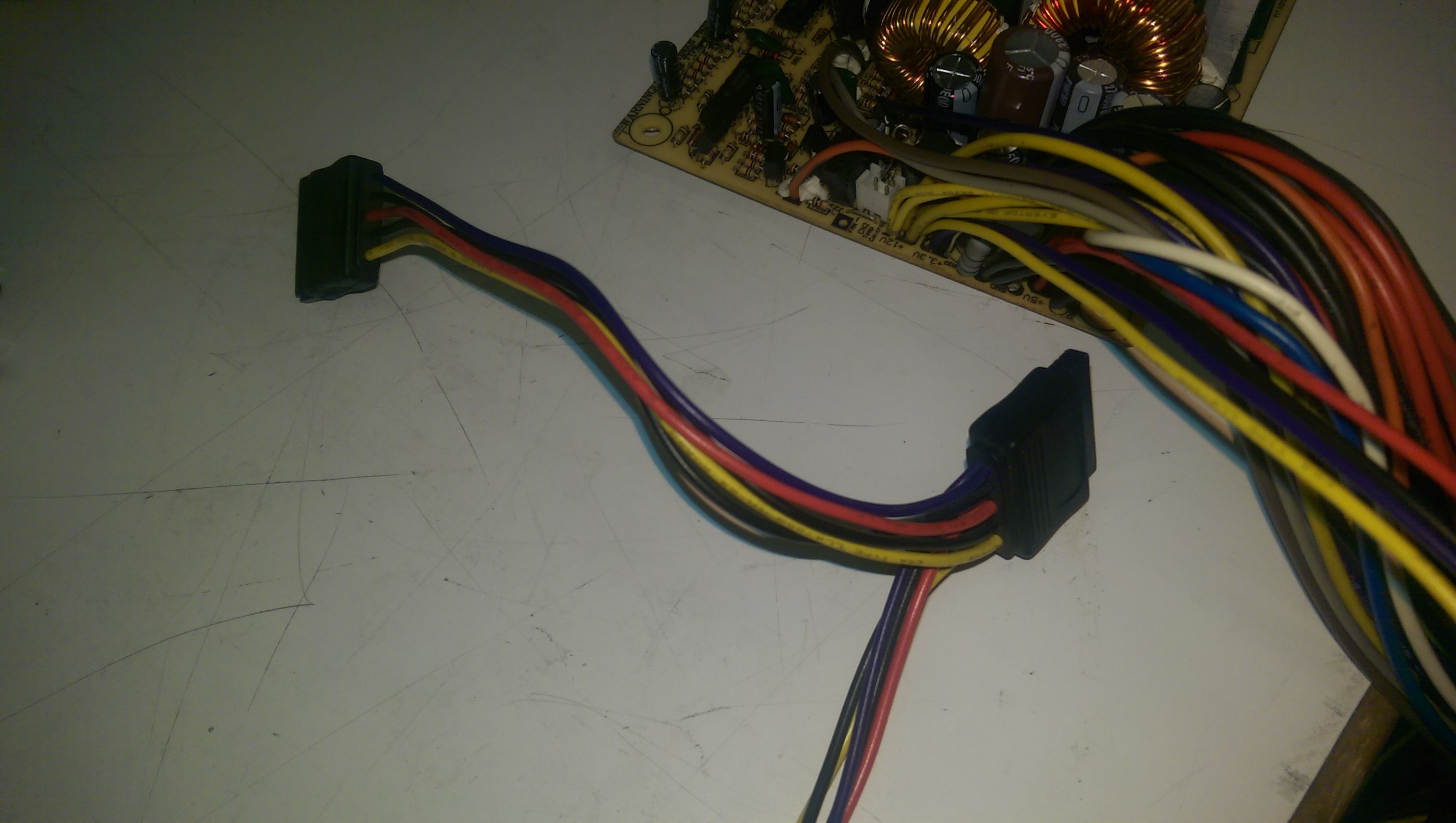

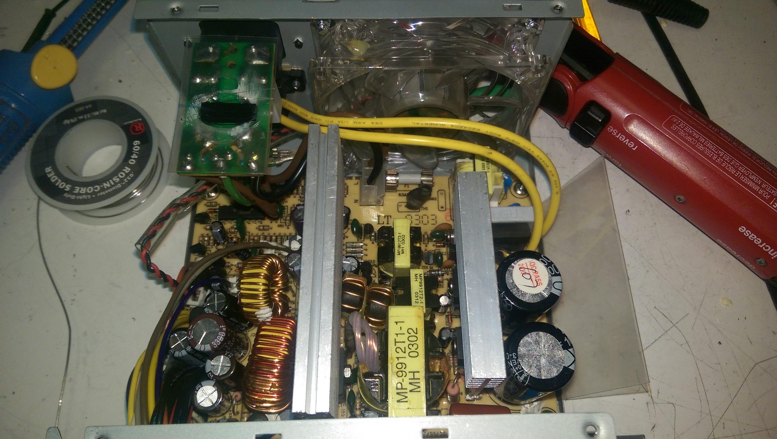

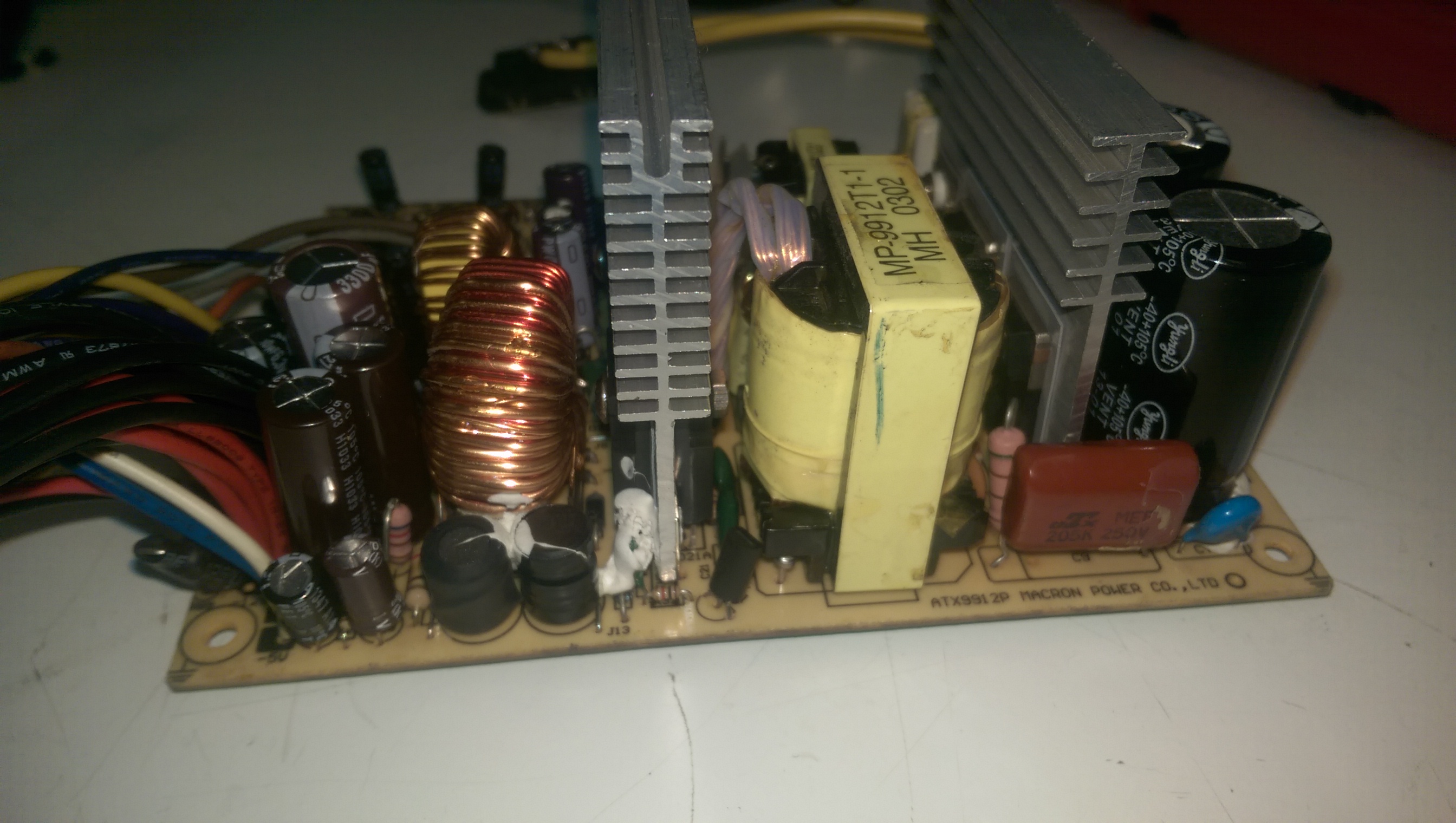

    Yep, I definitely have a soft spot for these old Macron's. But they're very respectable units. This one, when I got it, had seen better days. Even the Power Logic ball bearing fan was getting tired. Just about every cap in this thing failed. They only consist of 12Kuang Jin and CEC International. I can't really blame the CS caps too much for failing, their date codes are all from January, 2003 and the unit saw about 55,000 hours of running time in a very hot office with an Athlon XP machine. Every filtering cap was CS, and every single one was bulged and leaking except oddly enough one (Not pictured...) The 470uF 25V one on the 5VSB auxiliary tested perfect, 472uF 0.02Ω ESR. All the CEC caps tested good, but they only ranged from 1-22uF 50V. I replaced them all anyways.
    Another strange thing, the two input caps were CS 680uF 200V. They both looked like they were bulging underneath the plastic discs over the top. Sure enough, they were. However....they tested perfectly in spec. ~720uF 0.13Ω ESR. Do you think they were tricking my meter? I ended up replacing them anyways. I upgraded the 12V rectifier from the stock 16A ultra fast to that 30A schottky. 12V runs very strong. It could handle a Pentium 4 3.6GHz and 9600GT under full load all day long and stay at a firm 12.16V compared to 11.83V before with the same load. I also noticed that the snubber resistor on the primary was cooking the film cap for the switchers. Since I have so many lying around, I replaced the 1uF stock one with a 2.2uF part. I also removed the primary heatsink to tighten the screws.

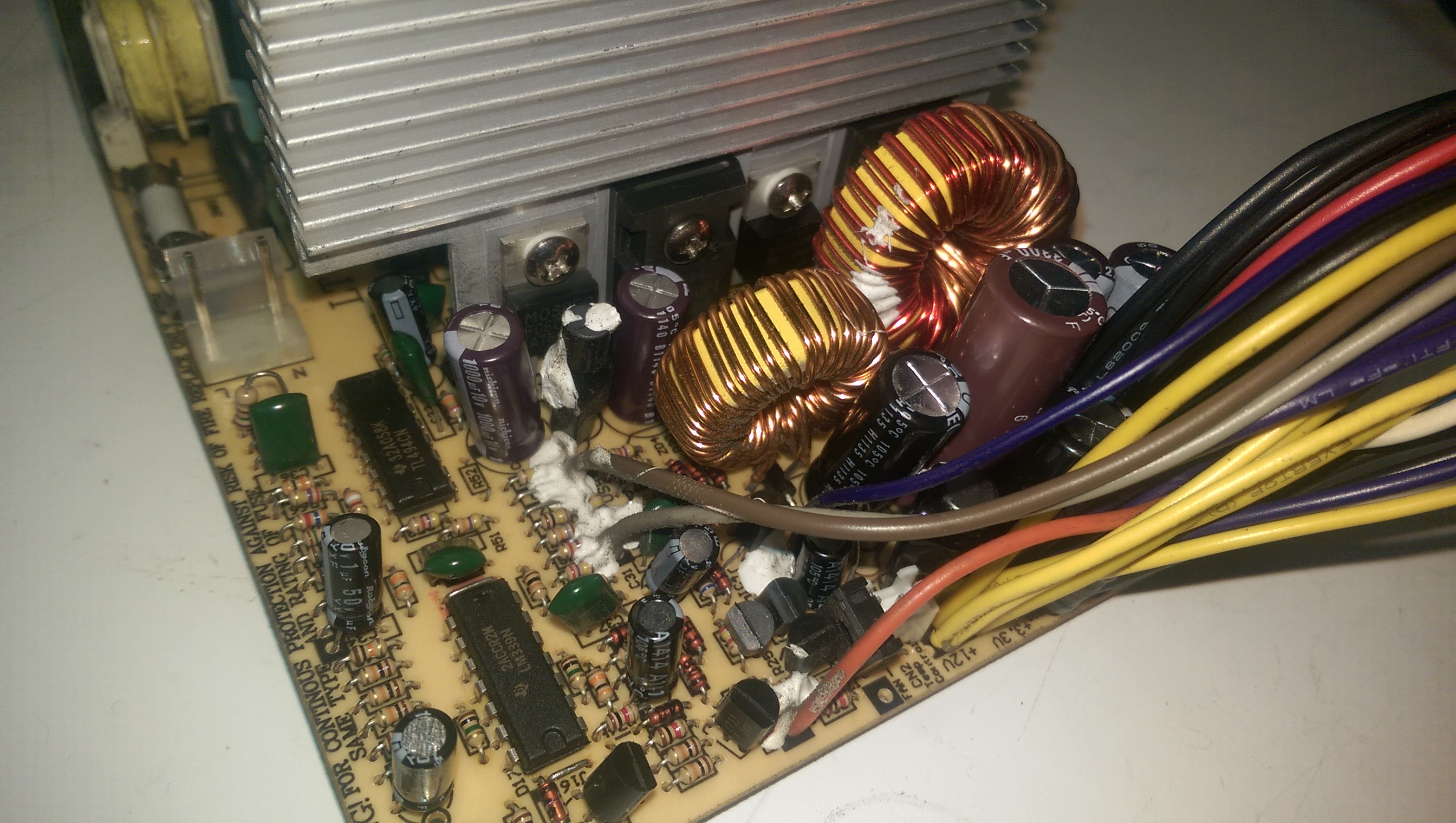

    I also moved around or replaced the minimum load resistors on the 5V and 3.3V. 12V didn't have one, so didn't have to worry about that. The ones on the 5V and 3.3V were way too low. I can't remember exactly but I think the new ones I put on the 5V and 3.3V were 100Ω. One of the stock ones was 22Ω and the other 47Ω
    Also replaced the stock fan with that oiled sleeve bearing fan and added a SATA power cable. It's very silent even under heavy load. The thing looks great now!
                  Yeah, my MPT-301 also runs much better on the 12V rail now with a 20A schottky vs. 16A fast rectifier before. But with a 5V-based PC (like Athlon XP), the 12V rail jumps to 12.6V. Before, it stayed at no more than 12.25V. So I guess, if you are going to use this PSU on a 5V-based system, keep the fast rectifier. But for a 12V-based system, definitely replace it like you did.

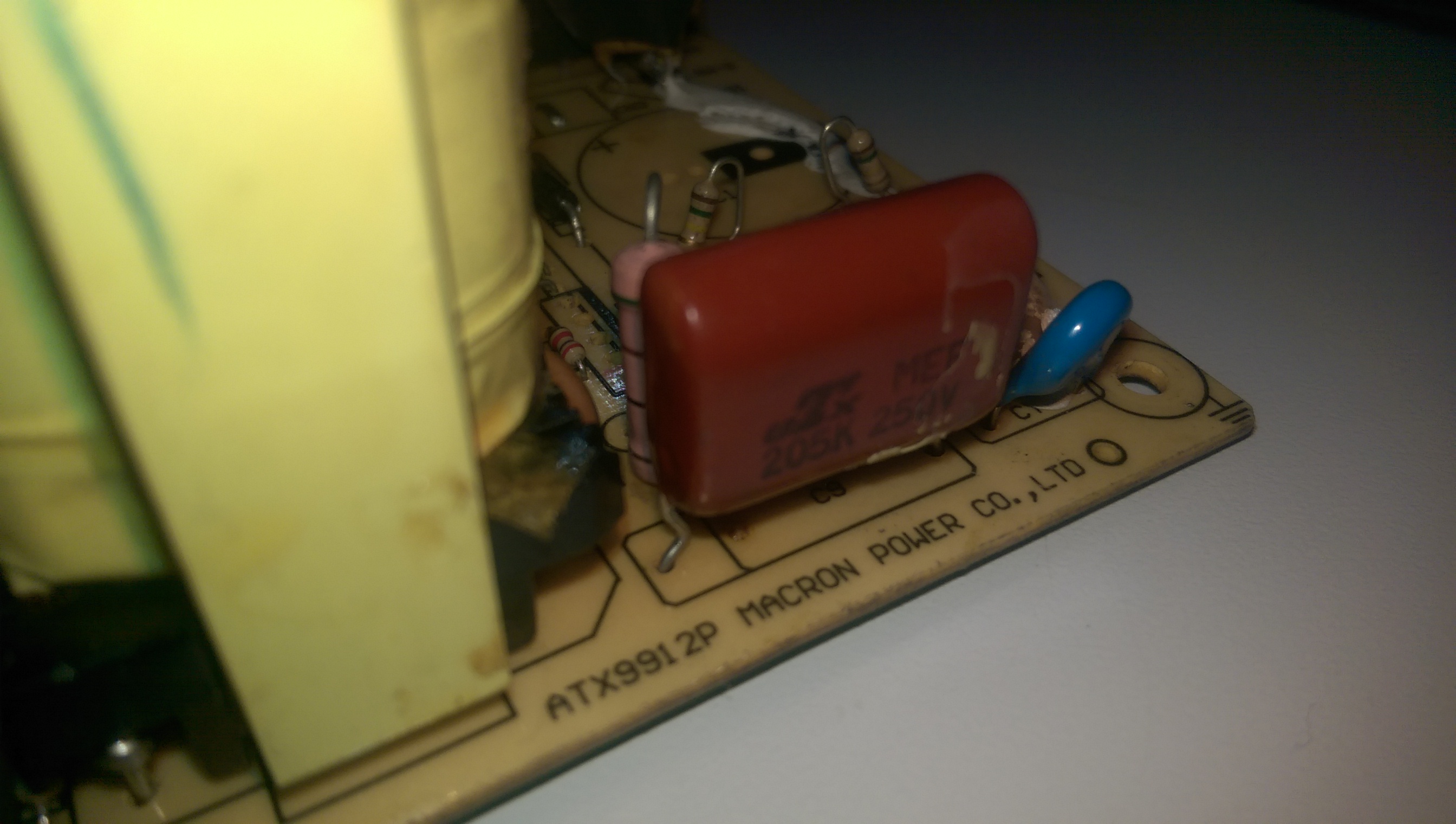

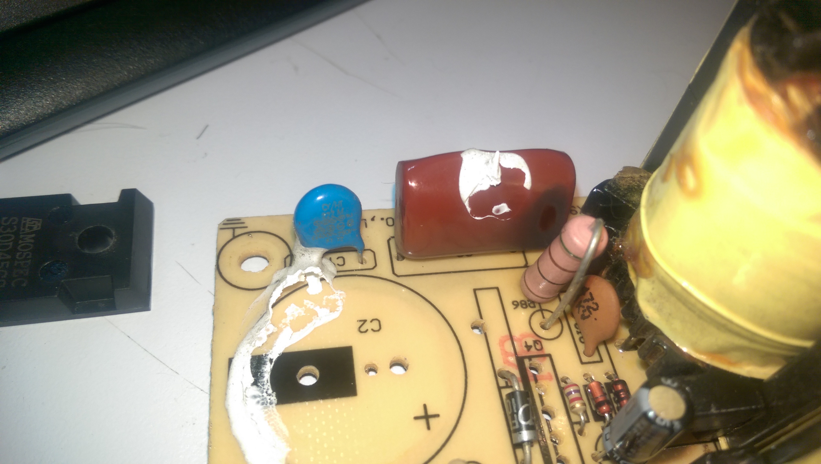

                  Interesting find. I wonder if the ceramic cap in the snubber network is going bad then. Maybe pull it out and check its capacitance?
                  Yes, same on mine. I think it was 25 Ohms for the 5V rail and 10 Ohms for the 3.3V rail. I don't have my files on this PC to check right now, though.
                  Just a word of caution: the PSU may start producing some nasty whining noises now on 12V-based motherboards with very low-power chipsets. Use the chipset heatsink size as an indicator - if it's tiny glue on stuff, it probably is very low power and your Macron may whine. Not that I noticed any problems with that, though.
                    I'm lazily going to respond with "I think it will be fine" haha...I think it's because this unit ran in a hot office and was INSANELY dusty. I don't say that lightly either. I never mentioned before that I swapped the chassis on this thing because it was so nasty. It took a long time of using an 80 PSI hose to clean all the dust out of the unit itself. So, this Macron is being housed in a Thermal Master chassis

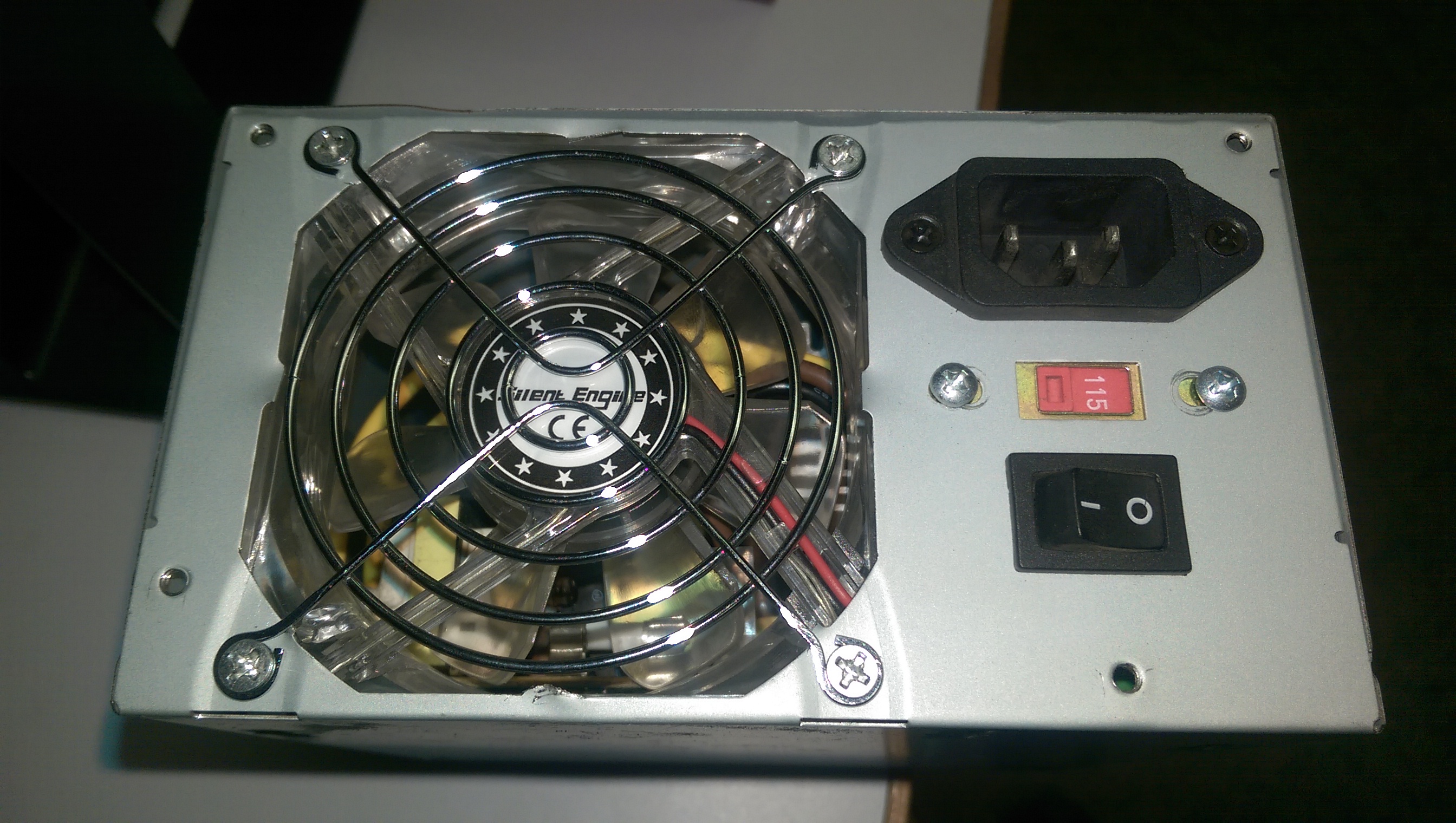

                        Noooo.
                        A Macron without that "AMD INTEL ATX12V TEST PASS" and the goofy Macron text label just doesn't look right IMO
                        Hopefully no one looks at the label of this PSU now and chucks it just because it appears to be a crappy Thermal Master PSU.

                        AND it did 19A on that 16A part! The heatsinks aren't particularly big either. I guess I'm just impressed by these things.
                        Same here. Actually, when I got my Macron a while back (maybe 2008-ish or so) and first opened it, I though, "no way this will do the 300W rated on the label with these heatsinks." But after fixing it and seeing how cool it ran both with 5V and 12V-based PCs, I changed my mind completely.
