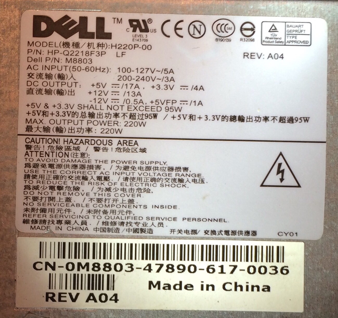

    I am working on Dell computer power supply that was totally Dead
    I found one bloated cap that was a 3300uf @ 16 volts
    I found all of the cap below 100uf @ ten X the ESR value that the new ones are of that value
    I recapped the power supply except the two main caps
    The cooling fan dose not even tiwitch or move at all
    If I need to post photos of this power supply I can but it will have to be later

      Re: Dell Power Supply fan not coming ON
      follow the fan supply, one side is going to be ground the other is 12v.
      and one is probably going through a transistor to control the speed.
      replace the transistor with a jump-wire.

        Thanks for your reply
        I thought that might be the way they did that or with a thermistor which could also be be bad because I saw one those in there as well what are the ohm value of them as a rule of thumb
            SAM if you are trying to start it with a paperclip on the bench this might be of interest.
              The power supply comes ON and works
              The fan is the only thing that is not working
                OK did you test the fan yet? or the voltage at the pins.
                I am not sure if there is a standard for thermistors - is the one you see related to the fan or is it current inrush near the mains socket.
                I have seen a table of some NTC thermistors which suggest 3000 ohms at 70c
                and goes to zero at 90c but depending on use I suppose the figures could be anything as long as it reached zero ohms at the temperature full speed was required.
                Here is a way to test if it actually works at all
                http://www.ehow.com/how_5398454_test-thermistor.html
