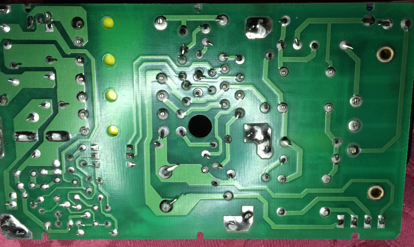

Bought a new 5 volt @5 amp power supply
    • Jul 2011
    • 6070
    I would like to know what you guy think about this power supply

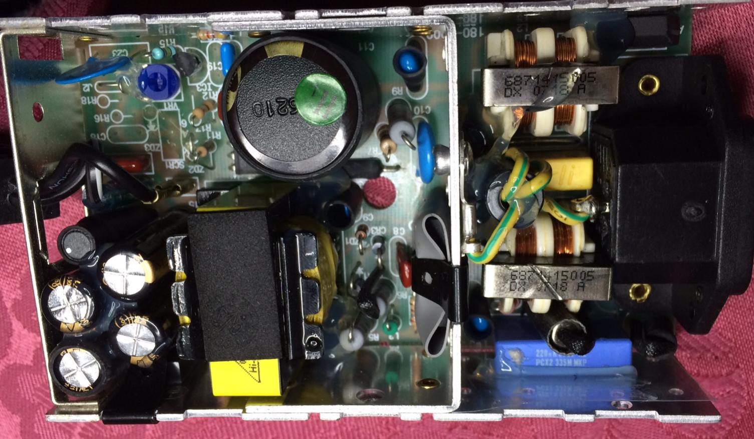

    Re: Bought a new 5 volt @5 amp power supply
    I see they left out the parts for the crowbar overvoltage protection circuit.
      Other than that is it a well built power supply
        So dose that mean that I need to add a 5 volt Zener diode in the power cable to what ever unit I going to use this power supply on
        What parts would I need for the crowbar overvoltage protection circuit to work right [ if this can be done ]
          ok other than cheap caps and no crowbar.you would need a scr too.i would use 6.2v zener.
            SCR1, ZD3, and R16 appear to be the missing components for the crowbar circuit.
              What part number should I use for SCR 1 ?
                I know that for ZD3 is going to be a 5.5 or a 6 volt
                And for R16---->500 to 1000 ohms
                Could I use this for ZD3
                http://www.digikey.com/product-detai...FSTR-ND/977219
