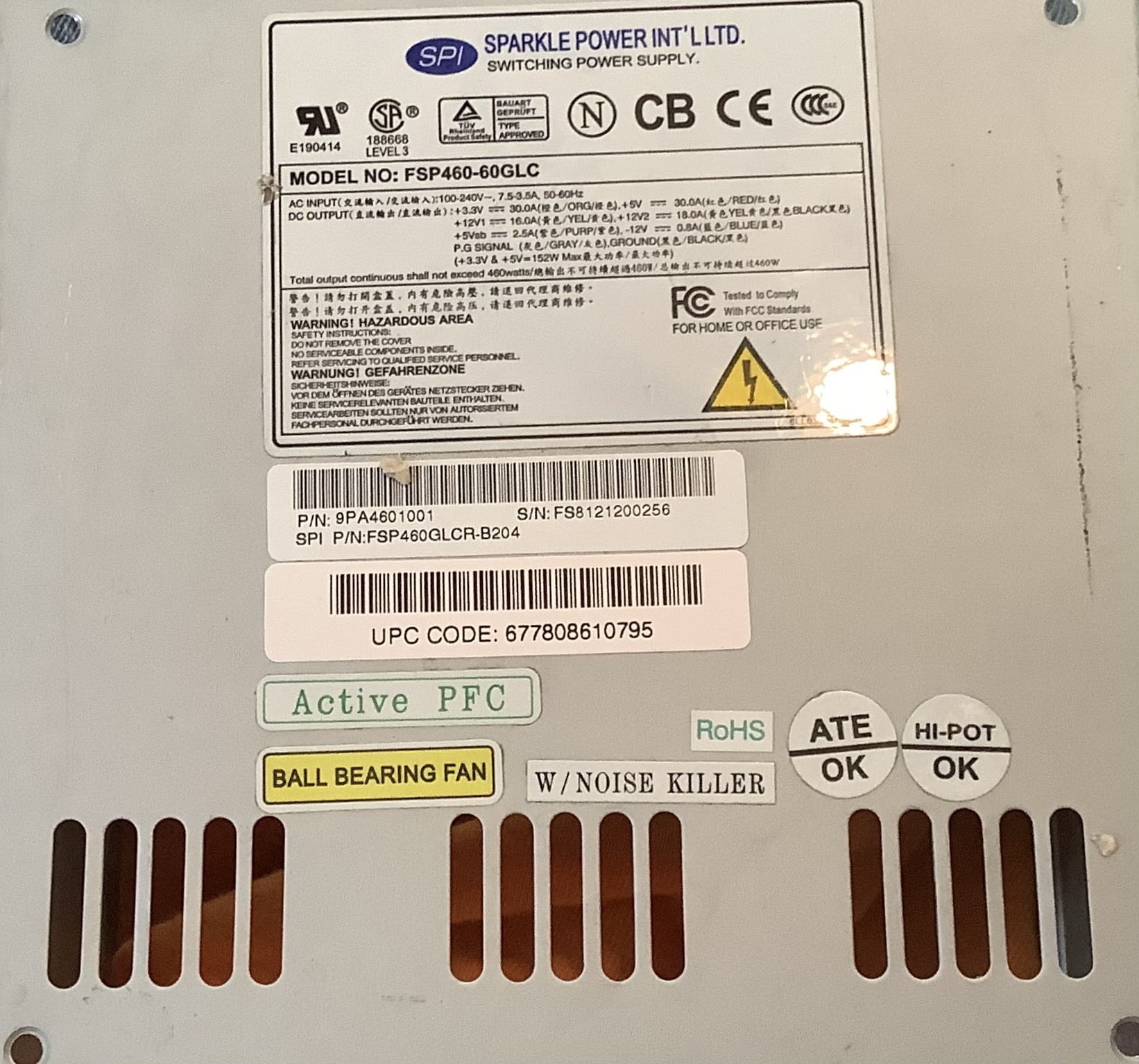

I bought three of these Sparkle Power FSP460-60GLC - Computer Power Supply 460Watts recap need
    • Jul 2011
    • 6030
    I have bought computer switching power supplies from Electronic Goldmine before and every one of them the capacitors were bloated and or leaking out of the capacitors so I am sure that these are going to be the same way five or six years ago I had bought some 300 and 350 watt computer switching power supply from Electronic Goldmine these are all from FSP brand
    Here is the listing for this switching power supply they only had three of them in stock and I bought all three of them
    https://theelectronicgoldmine.com/products/g28149
    I have one old computer that I plan on putting one of them in this computer and bring it back to life I just have to find a complete computer case with all of the covers but this is for another day

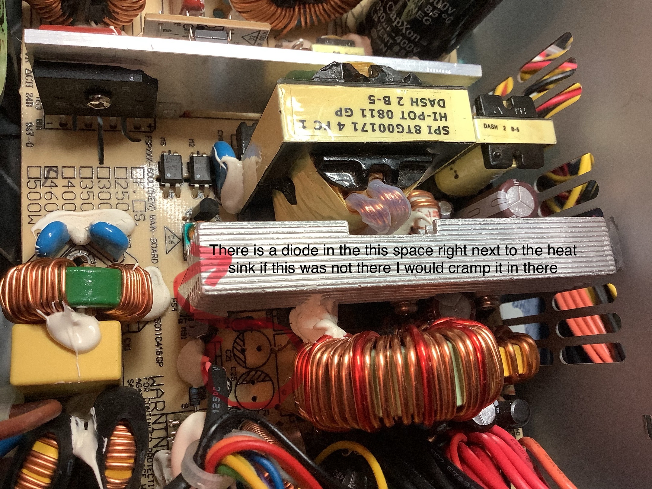

        Well I recapped the switching power supply and used some very old “FC” 1000uf @ 16 volts and one blew its top with in a couple of minutes of use ( unfortunately these capacitors are at least 10 years old or older than that )
        The issue is that it has to be 8mm in diameter because there two of next to each other there is also a diode next the heat sink one end and on the other end there is a coil so I to find something that will fit )
        When I find something that will work for this switching power supply series wise and diameter wise I will replace all of 1000uf @16 volts “FC” series
