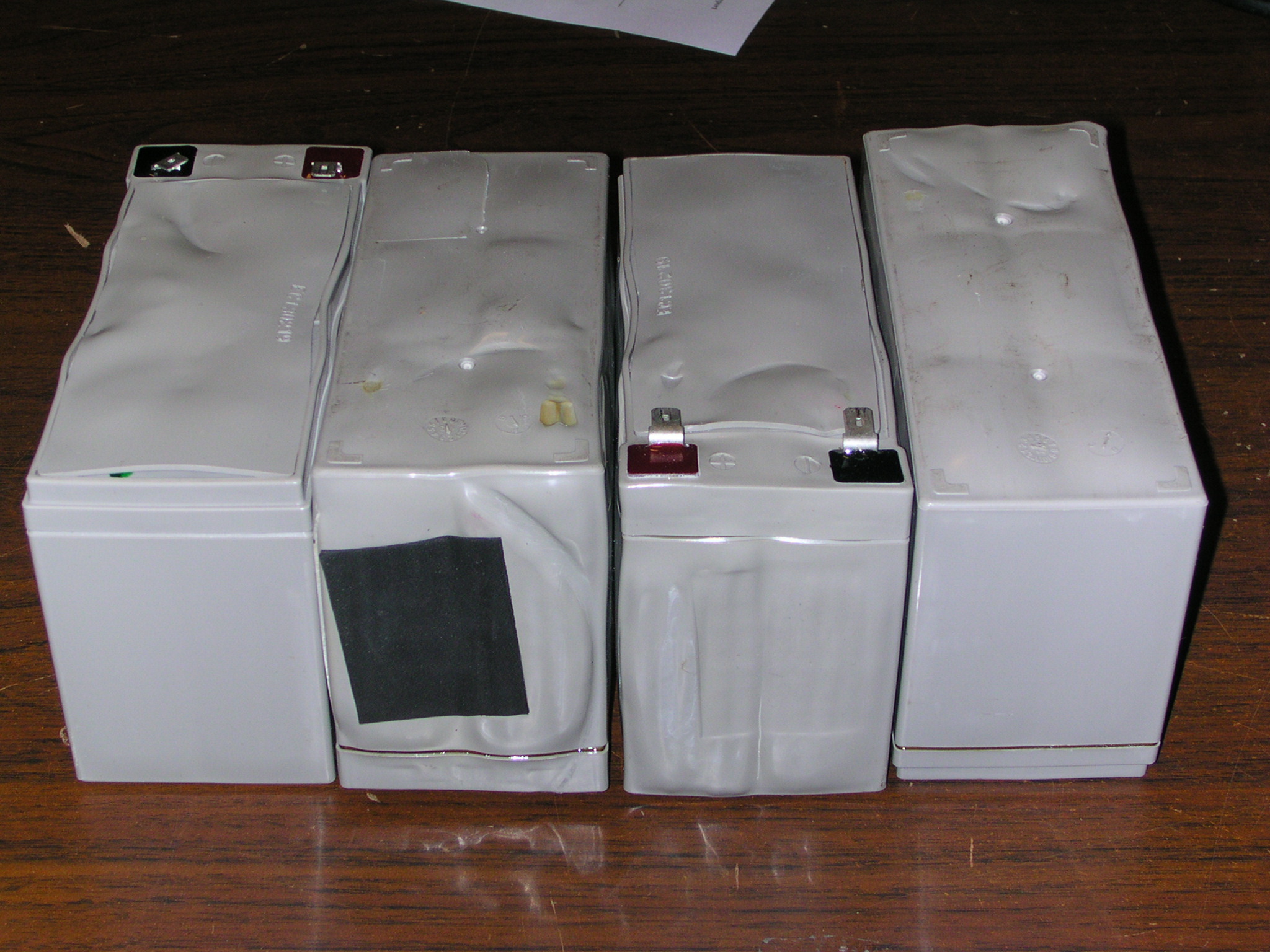

                        It sounds like the batteries is not taking the charge well. They are brand new batteries and was not sitting in the shelf for a long time before selling to you? May be you can look at the date code on the batteries.
                        You may be able to exercise batteries by running the UPS in BATT mode until it stops running, charge it over night and do it again a couple of times to see if it improved.
                        Most of the Low end UPS does not have smart charging circuit that when the batteries is fully charge it should then go into float charging mode.
                        As you can see what happen when one of the cell shorted out inside the batteries, the charge just keeps pumping in the charging current and get themal run away.
