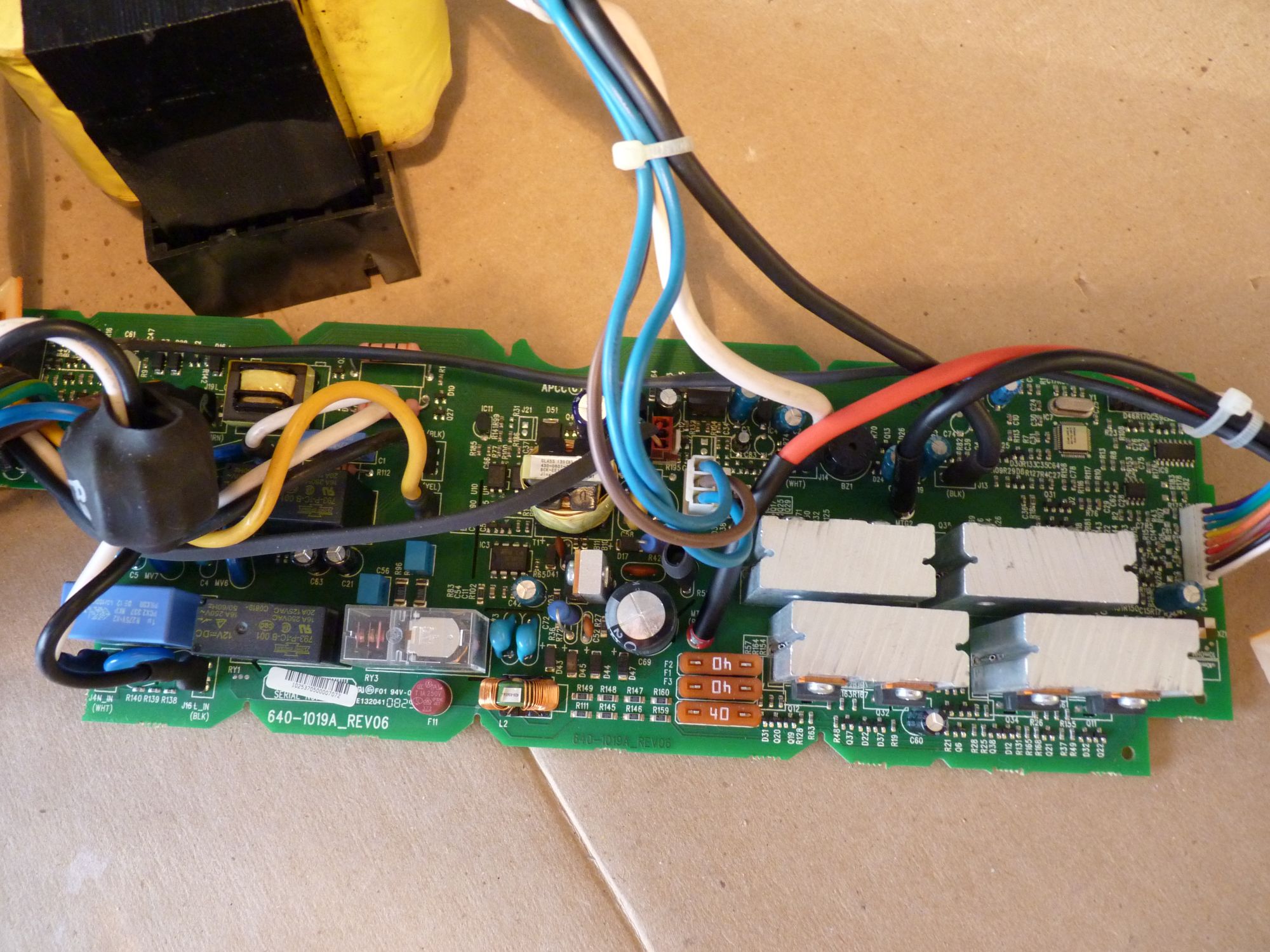

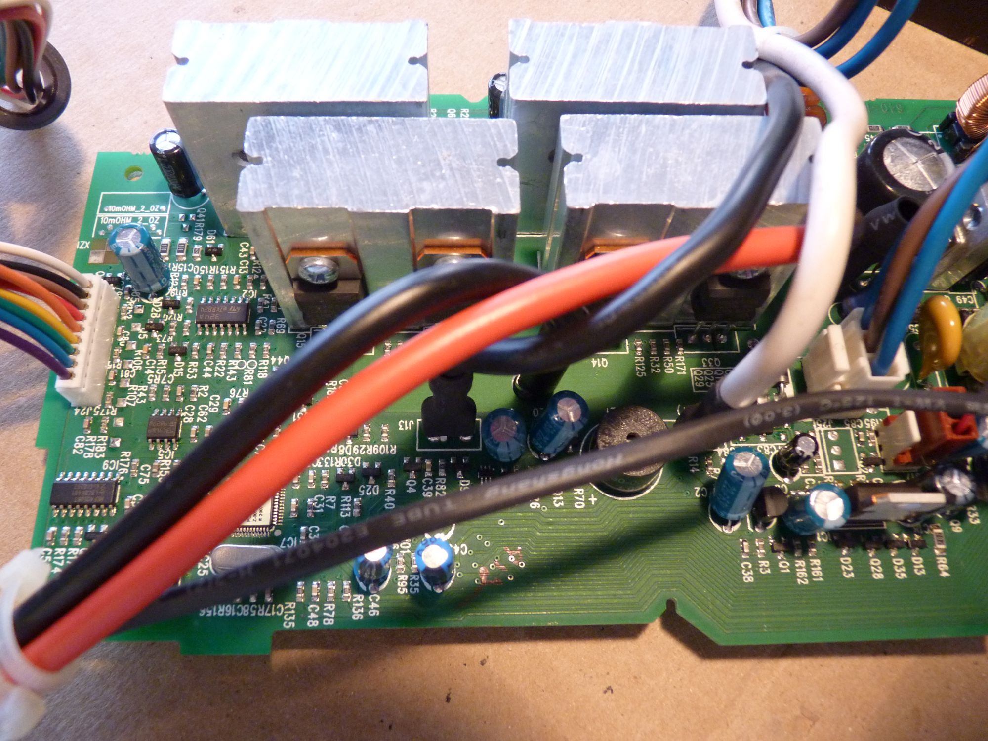

Re: APC Back-UPS 1300 not charging battery
One thing I wonder about your unit is that once the UPS passed the self test and is supplying the AC to the loads, then you disconnect the batteries to simulate open cell (High impedance) batteries failure mode or battery connector came off, what will you see on the LCD panel and what will the UPS do?
, bloated caps on output can disturb charging. And the small ones, well, I do quite a lot of APC units lately and there are ALWAYS some heavily out of spec.
