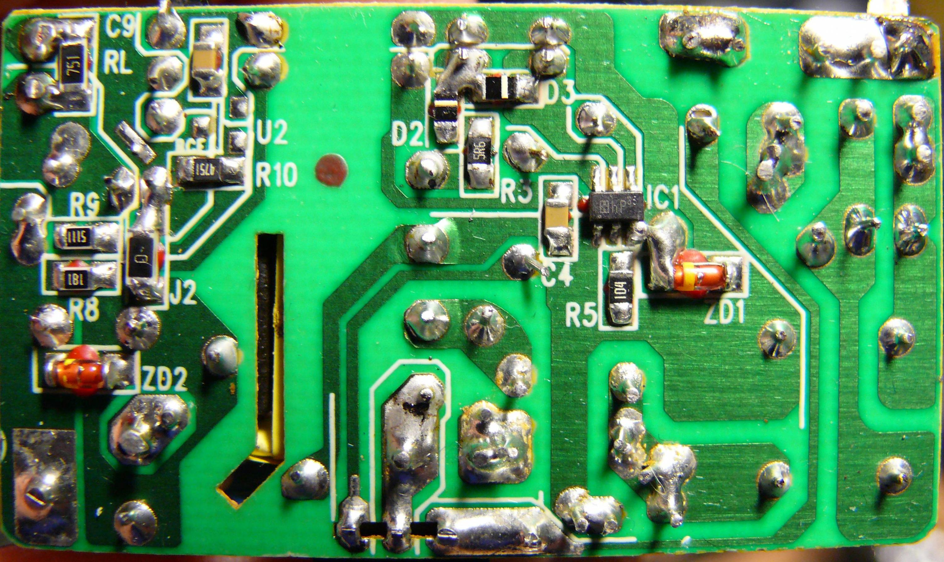

    This is a 5V / 2A PSU from a D-Link Switch. The outpult voltage is oscillating and causes only the switch power led to blink. The switch itself is fine since I tested with another PSU.
    A picture of the PSU can be found here
    All caps tested fine in terms of capacitance and ESR. I'm clueless - what could be the problem here?

          Also check primary side auxiliary rail diode - this is what gives power to the switch/PWM-FET/controller on the primary side. If not sure where that is, post pictures of the bottom side of the power supply. Please attache them to badcaps.net vs. going to off-site hosting service.

              Check the voltage on the cathode of D3 - does it oscillate too? (Also, keep in mind this is the primary side, so that voltage measurement will have to be done with respect to primary ground). If the voltage is oscillating there too, replace those two small caps by the optocoupler, regardless of what their ESR shows, especially if they are of some unknown or bad brand.
              Also check ZD1 and ZD2 are not shorted. And replace the 431 shunt if not - those are fairly common parts and should be easy to find.

                  Well, actually do it anyways. That voltage on the cathode of D3 needs to be stable for that small chip to function.
                  After that, you only have solder joints and that 431 shunt to worry about.
                  Perhaps also check the transformer windings. They will appear as a short circuit, but that's fine. We just want to check none are open. On the primary side of the traffo, there are two windings, but they should be separate from each other.

                    Is the primary controller a Fairchild PowerSwitch IC with integrated FET?
                    I had a power cycling PSU in a network switch, after checking *everything* else, it turned out the FPS IC was bad. Replacing it fixed the PSU. I had to use a newer, RoHS version as the original was EOL. Datasheets were practically identical otherwise.

                      That teeny IC, IC1, on the back of the board, is the SMPS controller. It's like a super-tiny 3842, but otherwise works/does the same.

                          If everyting else was checked or replaced, that really only leaves the driving IC or transformer.
