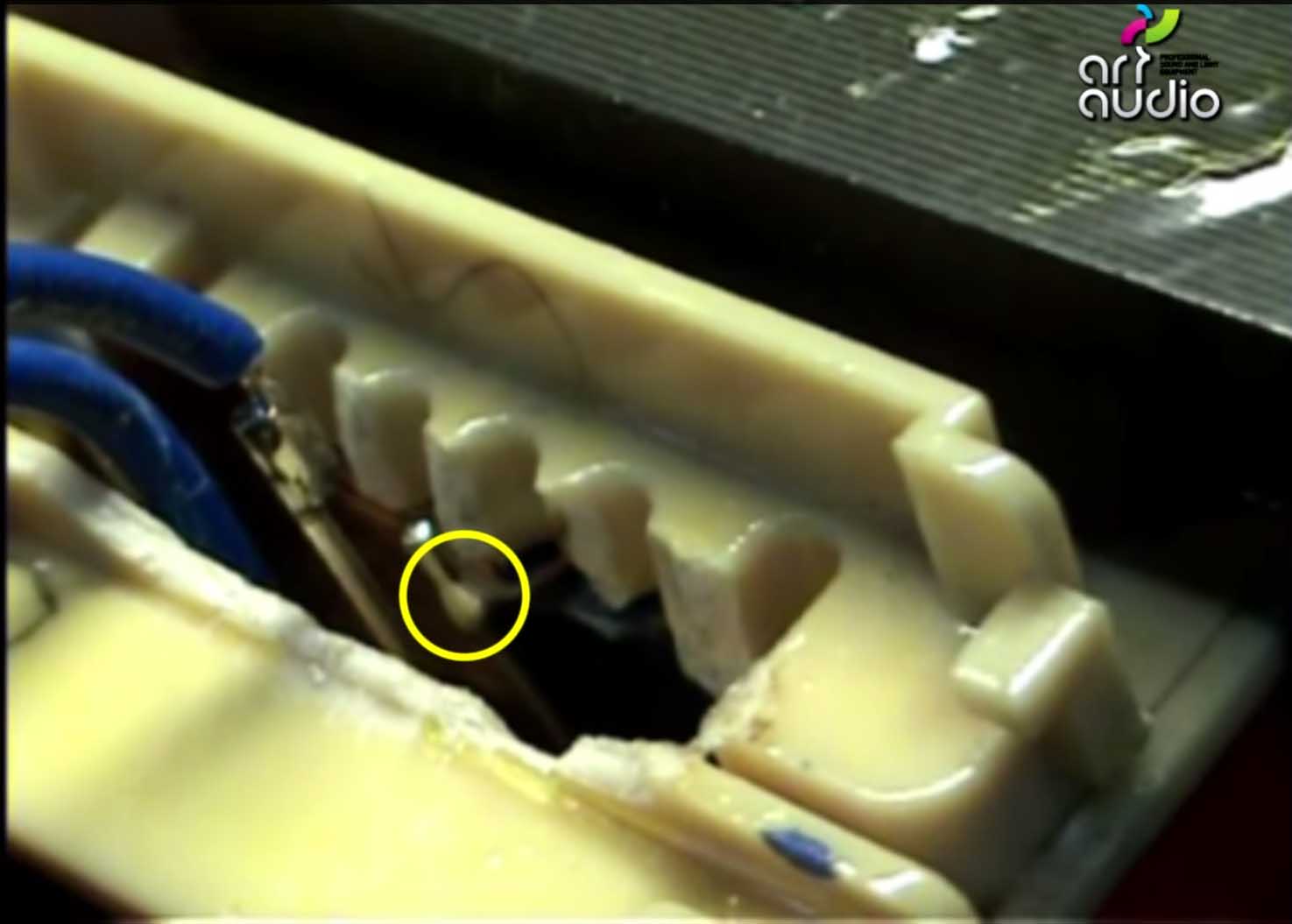

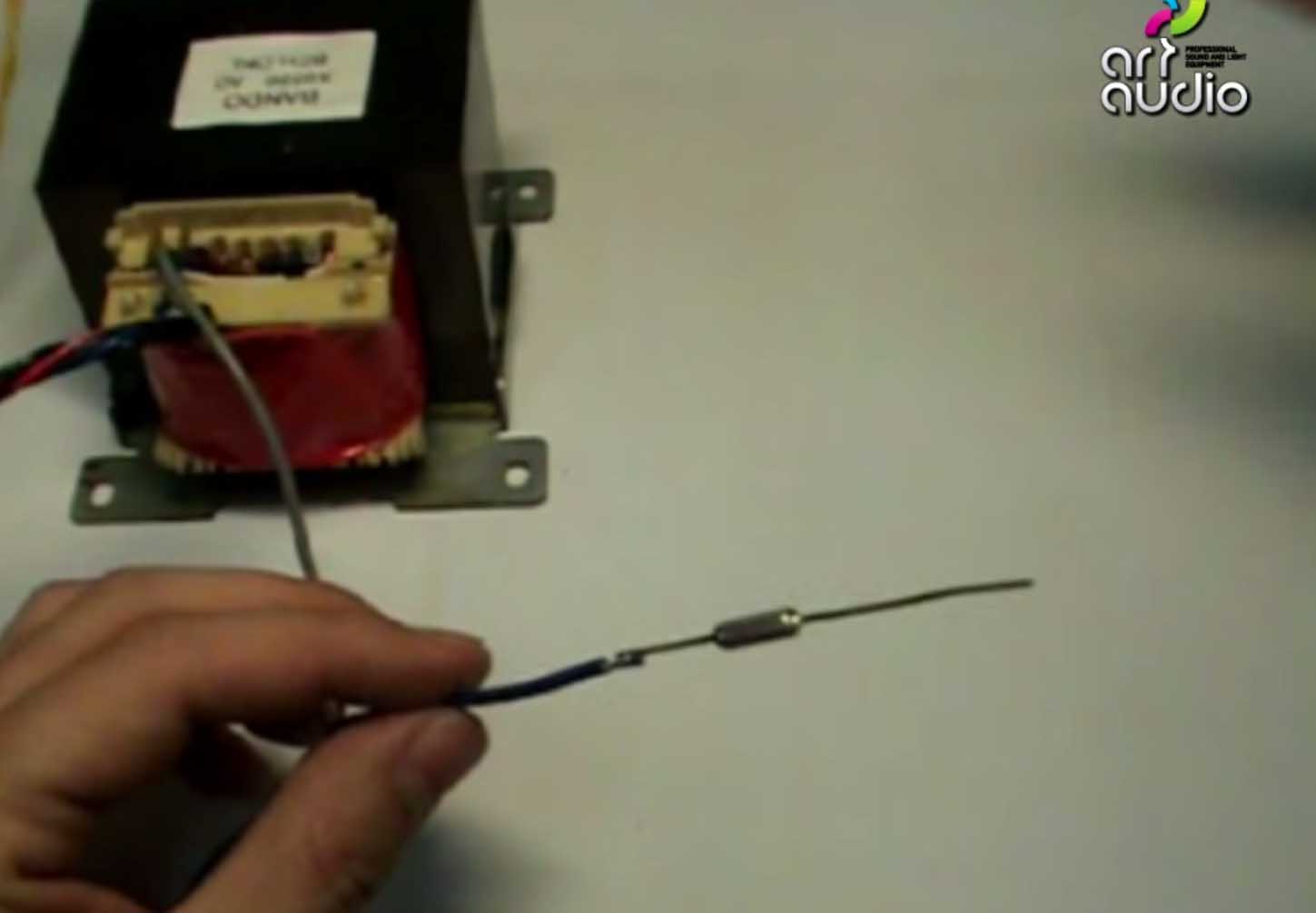

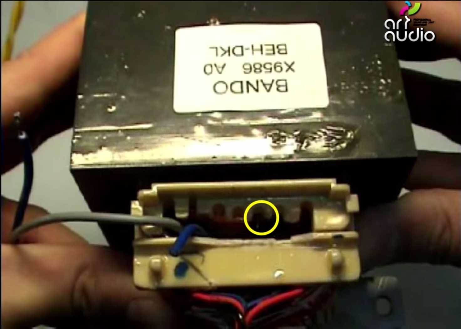

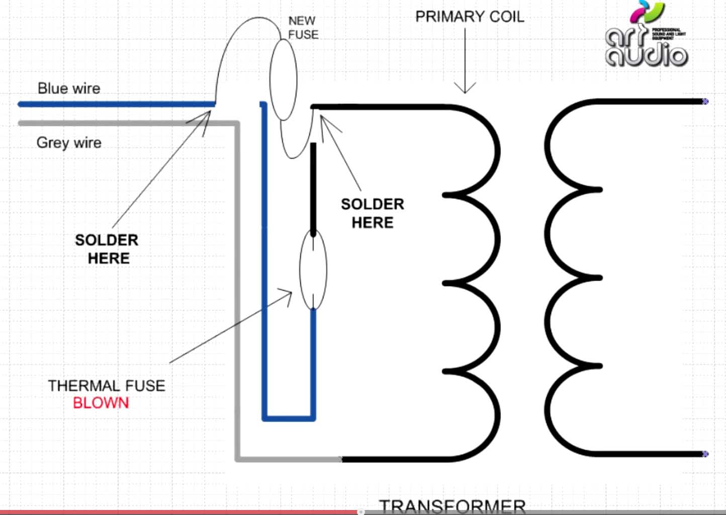

            This is from the youtube video:
            Set your DMM to ohms, and check the grey and blue wire, if there is no reading the primary coil could be damaged.
            Most likely it's the thermal fuse not the coil, although it is hidden in the transformer. You can bypass the blown thermal fuse, but you need to cut the wires as shown in image 2. You cut the blue wire just before it enters the transformer (circled in yellow).
            Solder a new thermal fuse, in the video he bends the thermal fuse and inserts it into the transformer shown in image 4.
            After you soldered the fuse, check the blue and grey wire with your dmm, it should show 6 Ohms.
