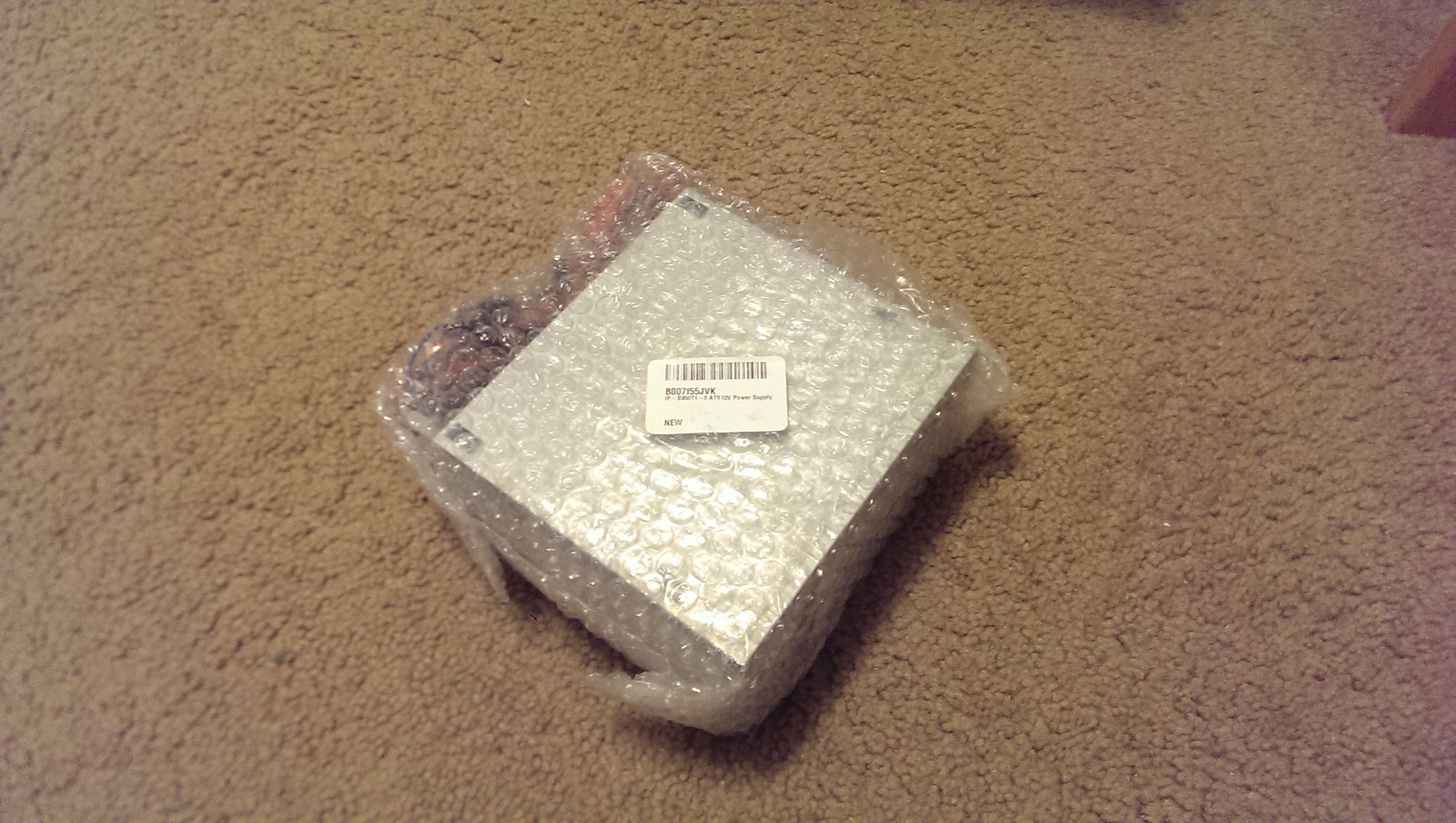

      Re: is this a good psu? for cheap...
      Bought one to autopsy to use or not... I thought in win made decent products just tough to see how it's possible to make a good $15 PSU. I'll report back!

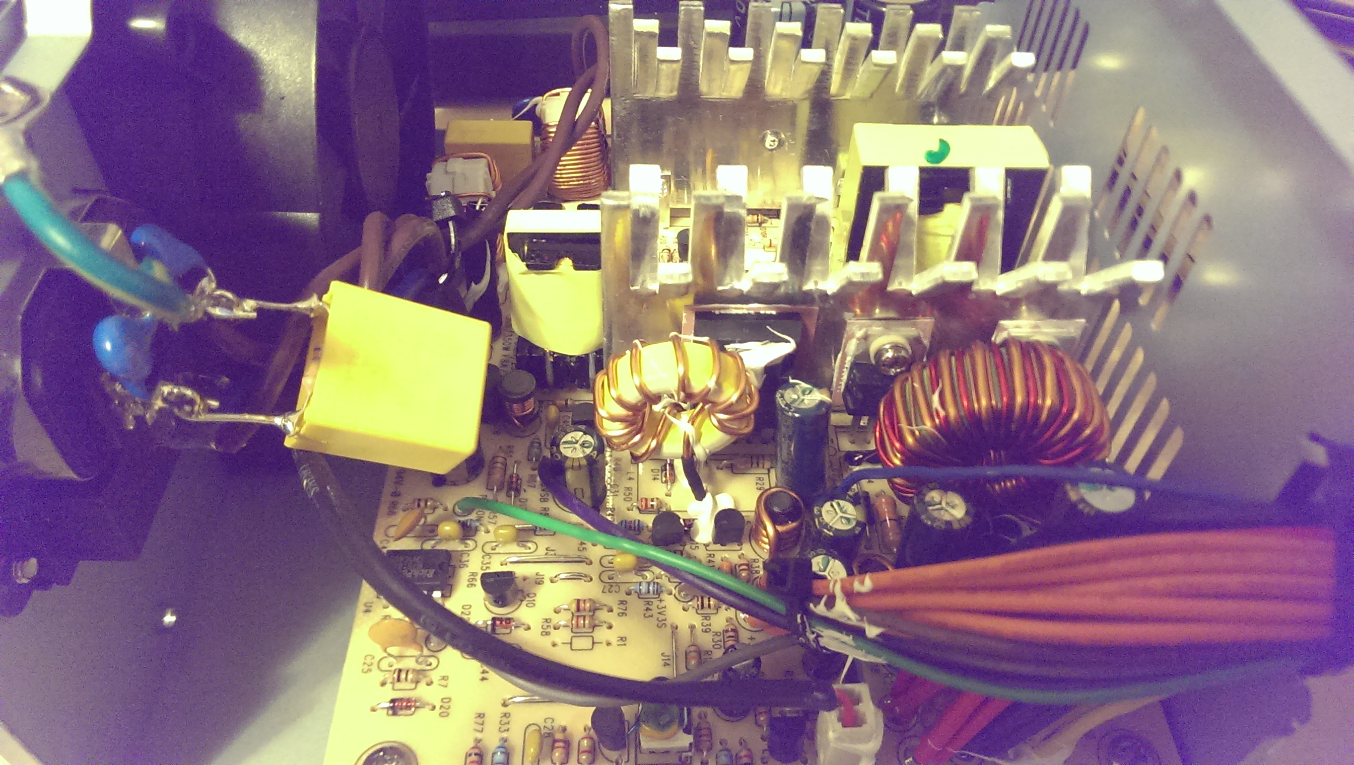

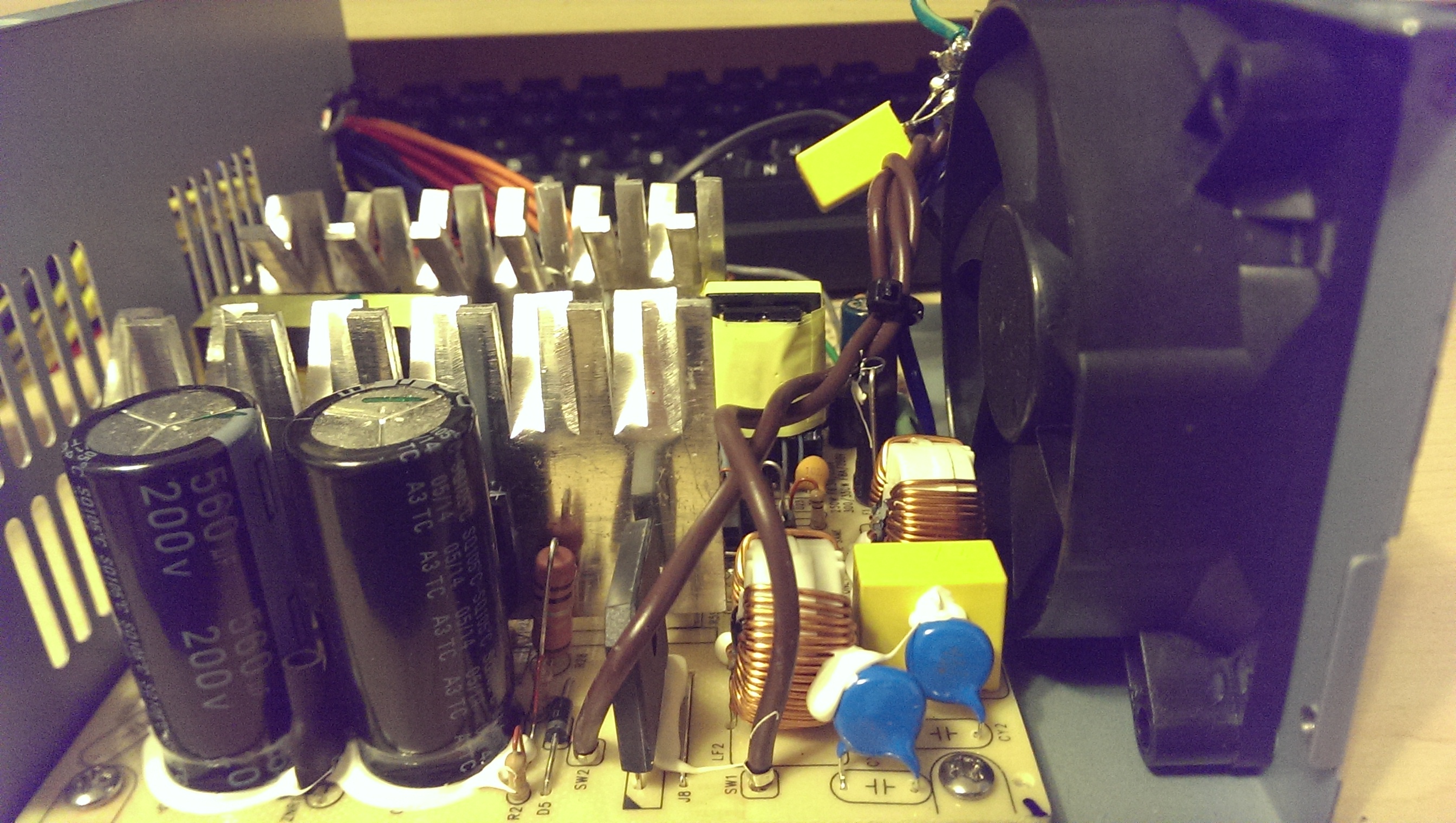

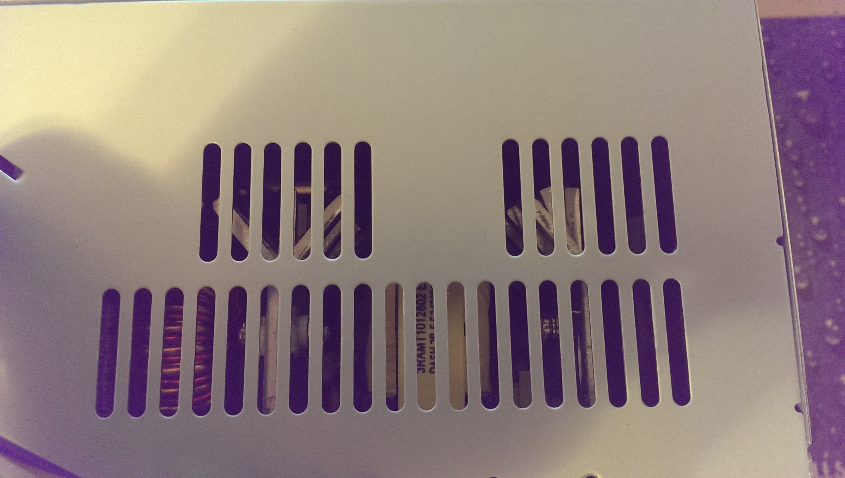

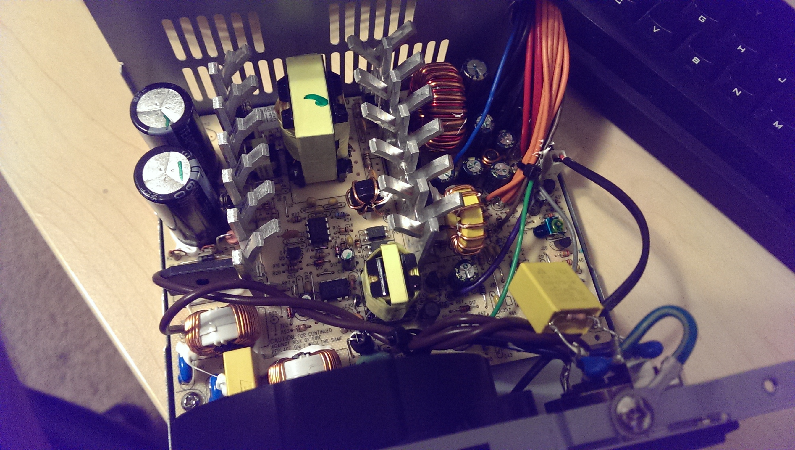

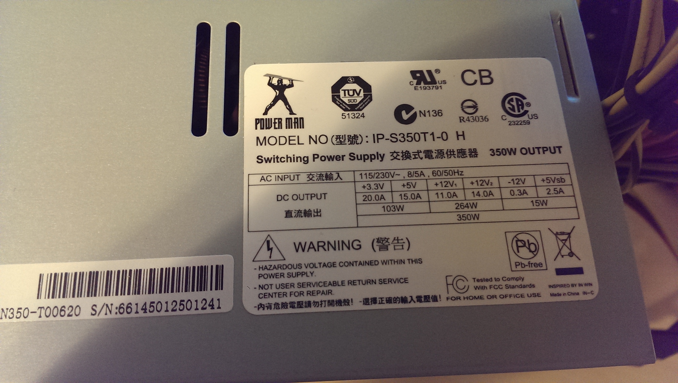

                                  Wow, this has got to be the best sub-$25 PSU on the market.
                                  Here's a Mini-Review of the IP-S350T1-0 ATX12V Power Supply
                                  First impression:
                                  While it doesn't weigh as much as a 1000W Power supply it's comparable in weight to most OEM power supplies. Definitely not a Logisys/Powmax sort of thing!
                                  The guts:
                                  Reasonable heatsinks (as seen through vent before disassembly), a thorough input filter, and Teapo capacitors make this a reasonable choice for a low-cost computer or server.

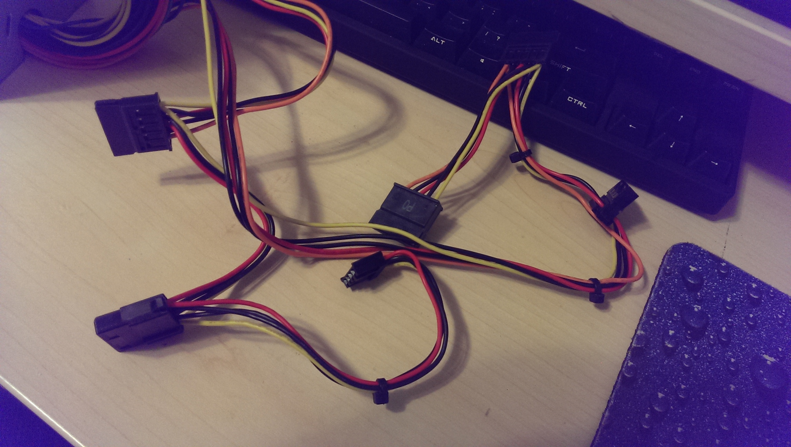

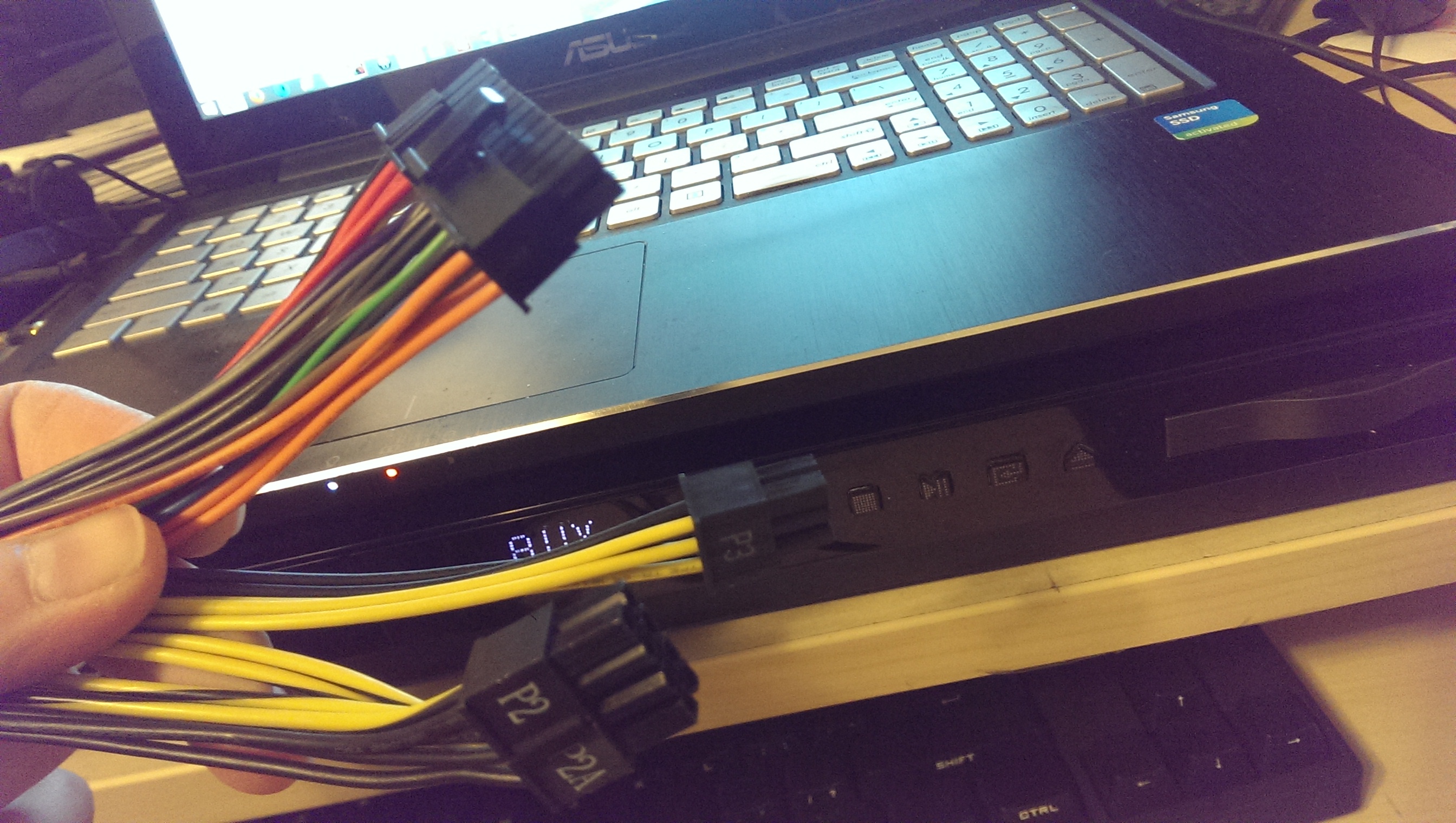

                                  Connectors:
                                  - 20+4Pin ATX Connector
                                  - 4+4Pin CPU Connector
                                  - 6Pin PCI-Express Connector
                                  - Strand1: Molex, SATA, SATA
                                  - Strand2: SATA, Molex, Floppy(Berg)
                                  Yes, that's 3x SATA, a 4+4Pin CPU, and a graphics card power connector, on a $13.99 PSU!
                                  Conclusion:
                                  Just ordered 5 more! I nope they never get out of stock because for $13.99 they are perfect! Beats any of those shitty PSUs included with inexpensive cases that local computer shops seem to love.
                                  TL;DR: BUY IT!

                                    It looks very similar to the IP-S400CQ2-0. It should have no problems delivering its rating in spec. Don't expect silence, though. I have known those 80mm fanned Power Men to get a little loud under load, especially when they are not 80plus certified.
