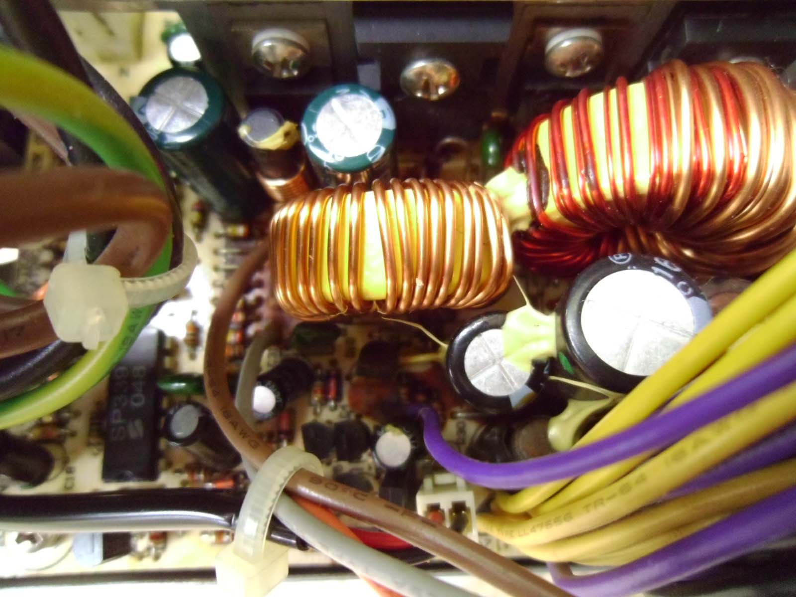

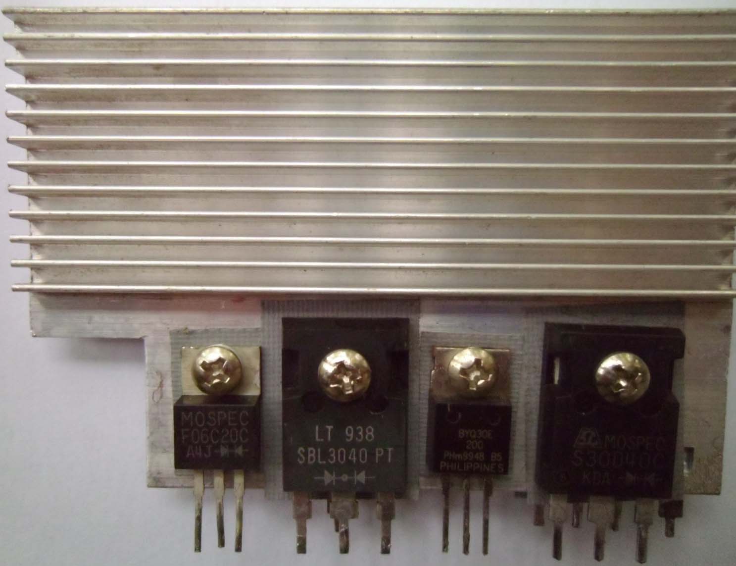

    I hear a brief tick from the Primary area when I try starting it, either connected up to motherboard, HDD, ODD etc., or stand-alone connected only to HDD and jumpering PSON
    AFAIK everything's original
    Help with hand-holding please

    sounds like it might have a shorted rectifier on the secondary bside

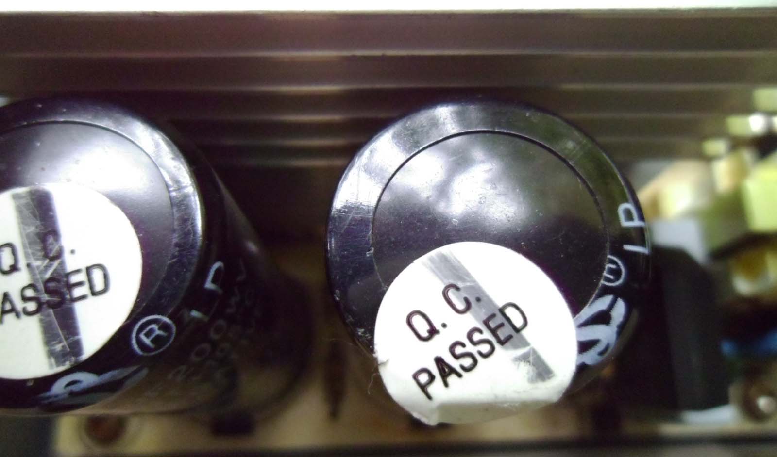

      Check solder joints too. When you push on the top of those primary caps, do the plastic discs go down or is there pressure directly under them?

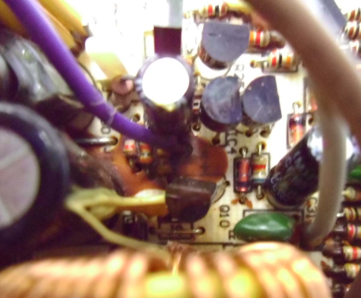

        Anyway, all ICs on attached pics tested with Diode Test/Continuity of Fluke 77 - with black probe on middle leg, all gave brief beep when red probe touched to either side leg
        No, plastic discs don't go down - I assumed primary caps were like Ol' Man River, but maybe not necessarily
            You might have bulging primary caps then. That could be the problem

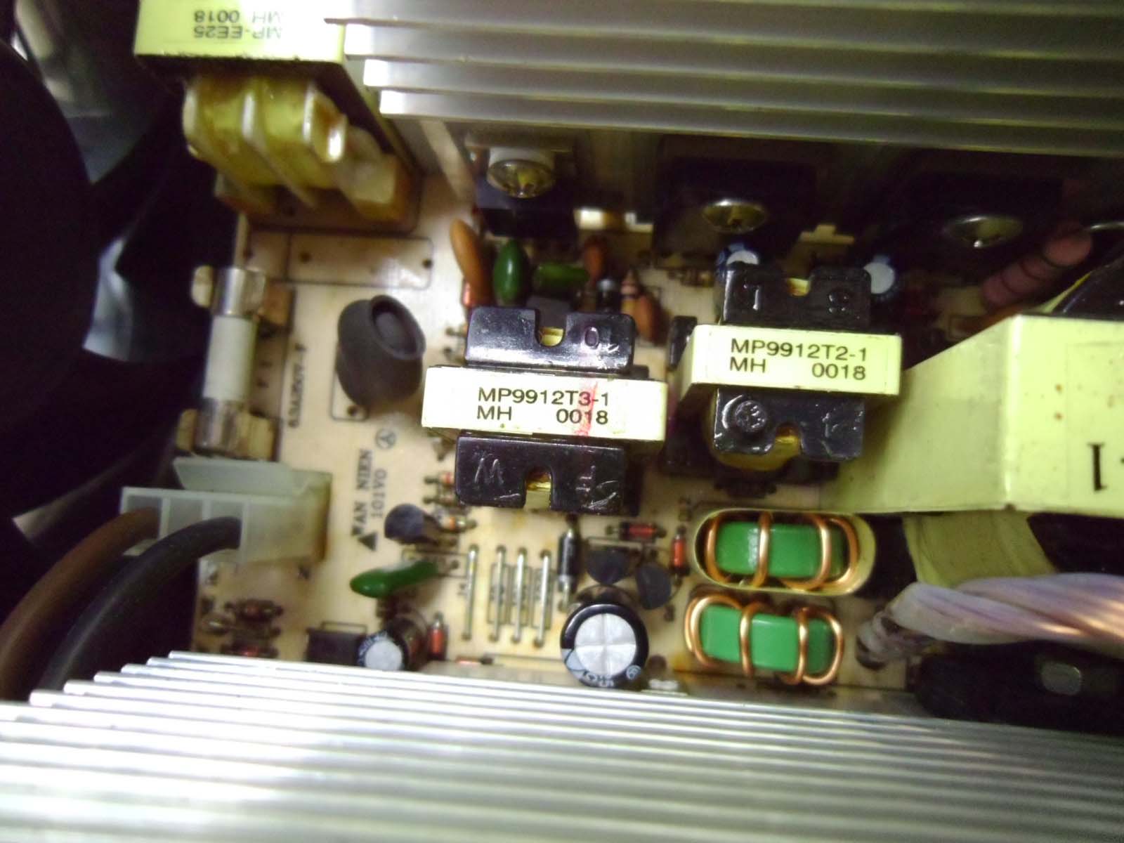

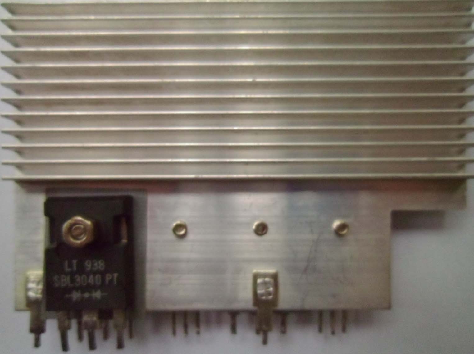

              Check the BYQ30E first, that's the +12V rectifier. Yeah, primary caps might be bad. It's pretty rare unless too much voltage goes through them.
                That IC was included in "all ICs on attached pics tested with Diode Test/Continuity of Fluke 77 - with black probe on middle leg, all gave brief beep when red probe touched to either side leg"
                Any other check I should be doing ?

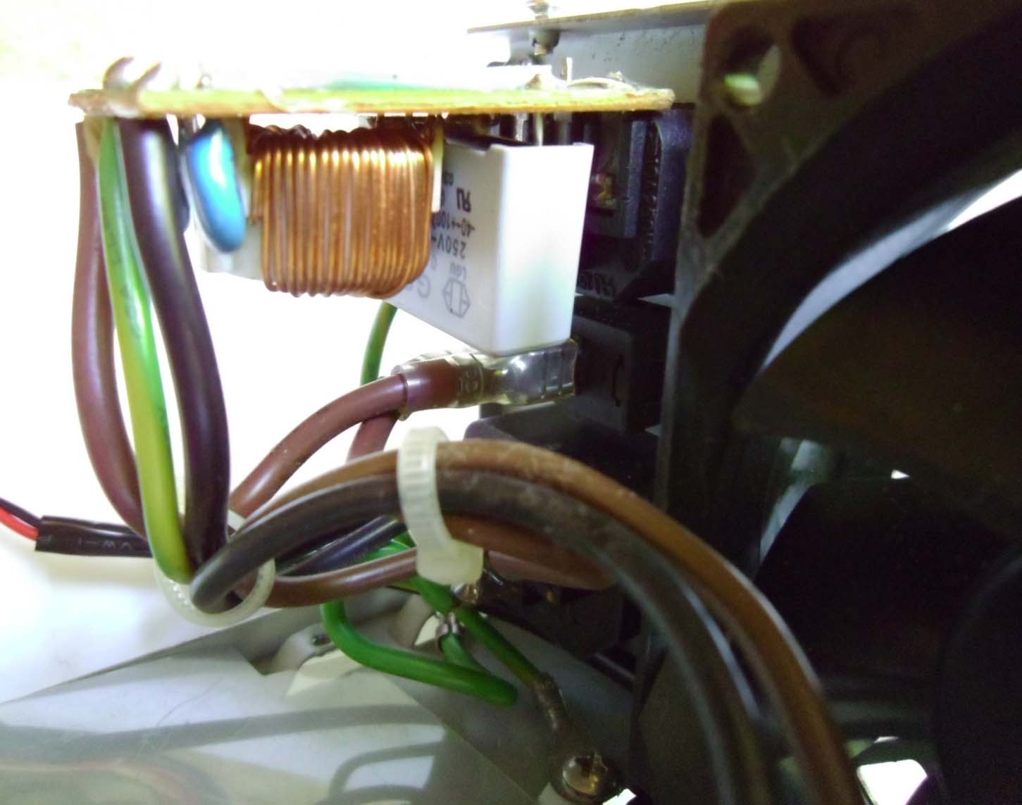

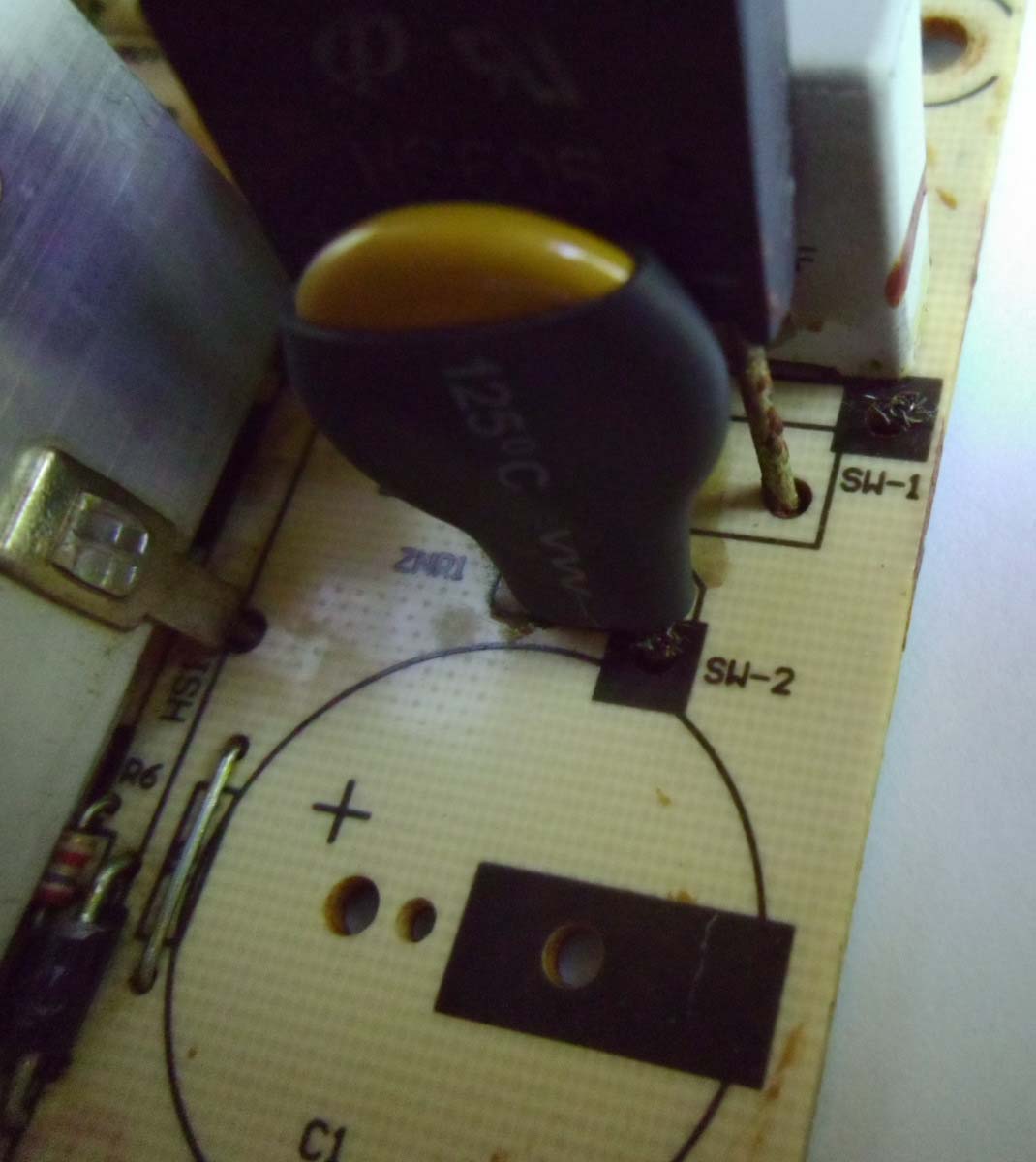

                          Maybe overlooking the forest for the trees, but other threads here about MPT-301s have shown two thick yellow wires from the power input area going to SW1 & SW2 near the primary caps
                          For example https://www.badcaps.net/forum/showpo...17&postcount=1
                          and https://www.badcaps.net/forum/showpo...37&postcount=1
                          But on mine there's just two stubs broken off on SW1 & SW2, and no loose wires coming from the power input area
                          Can anyone enlighten me please, or provide a clear pic where wires from SW1 & SW2 connect to the power input area
                          Is it something to do with 240V here versus 110V ?

                            They are probably for the voltage select switch, which is not included on your power supply
                              +1
                              Do NOT connect these, or you will blow your primary caps!
