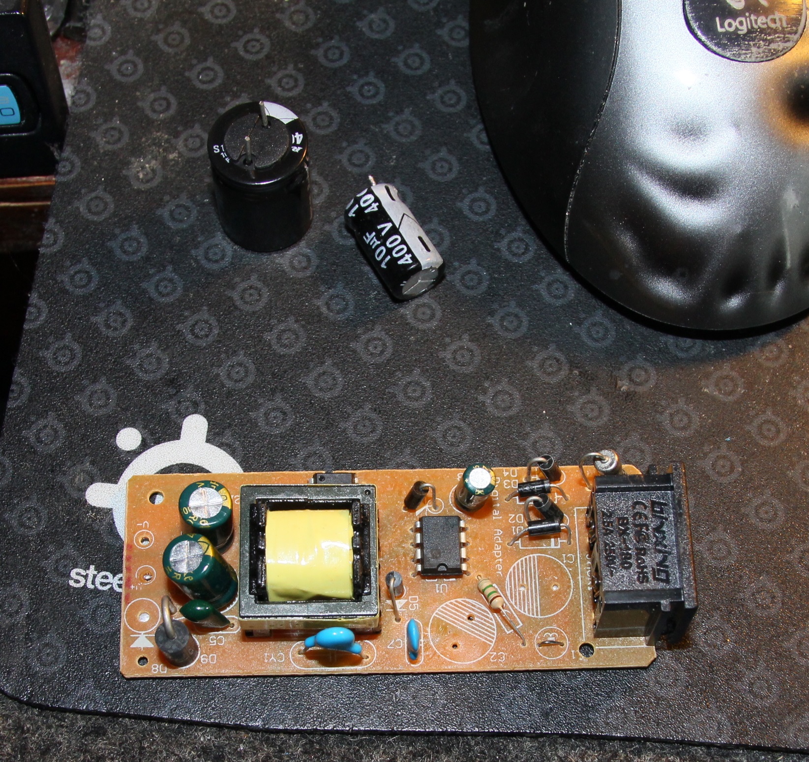

    I'm planning on recording the upcoming gig of the band i'm in with my Eos camera, without the worry of the battery crapping out. As such, i sprang for one of these, i guess, "generic" supplies that come with a "coupler" that fits into the battery compartment.
    I didn't manage to keep Dave's EEVblog motto "to the letter" (ie. "Don't turn it on - take it apaaaart!.."), and i did plug the bugger into the mains - works fine, 7.495v with no load.
    Next step - cracking it open. Your usual cheapo sealed casing (like you'd find on laptop power bricks), although fortunately, they hadn't gone crazy with the glue. Medium pressure every half-inch or so, along the seams, with a small flathead, and i could already hear the tell-tale "pop"s of glue giving in
    Photo 1: "before"
    Mildly impressive, i must admit - it COULD have been (much) worse.
    1A fuse, no NTC or any sort of noise filtering on the AC input. 4x 1N4007's doing the rectifying, 10u/400v "Chongx" cap (seen above the board, next to its "heir"). PWM chip is an SDC606 - never heard of'em before. Definitely an uber-cheapo - its built-in switching element is a 450v BJT
    Surprisingly enough, the primary-to-secondary noise-reduction cap (CY1, the "fatter" blue ceramic south of the transformer) ***IS*** in fact a mains-rated cap - go figure
    Secondary's quite simple - SDC5100 (5A 100v) schottky rectifier, a pair of Ketuo (R) 470u/16v caps, and that's about it. SOT23-cased TL431 on the bottom, with the associated passives, and PC817 knockoff photocoupler.

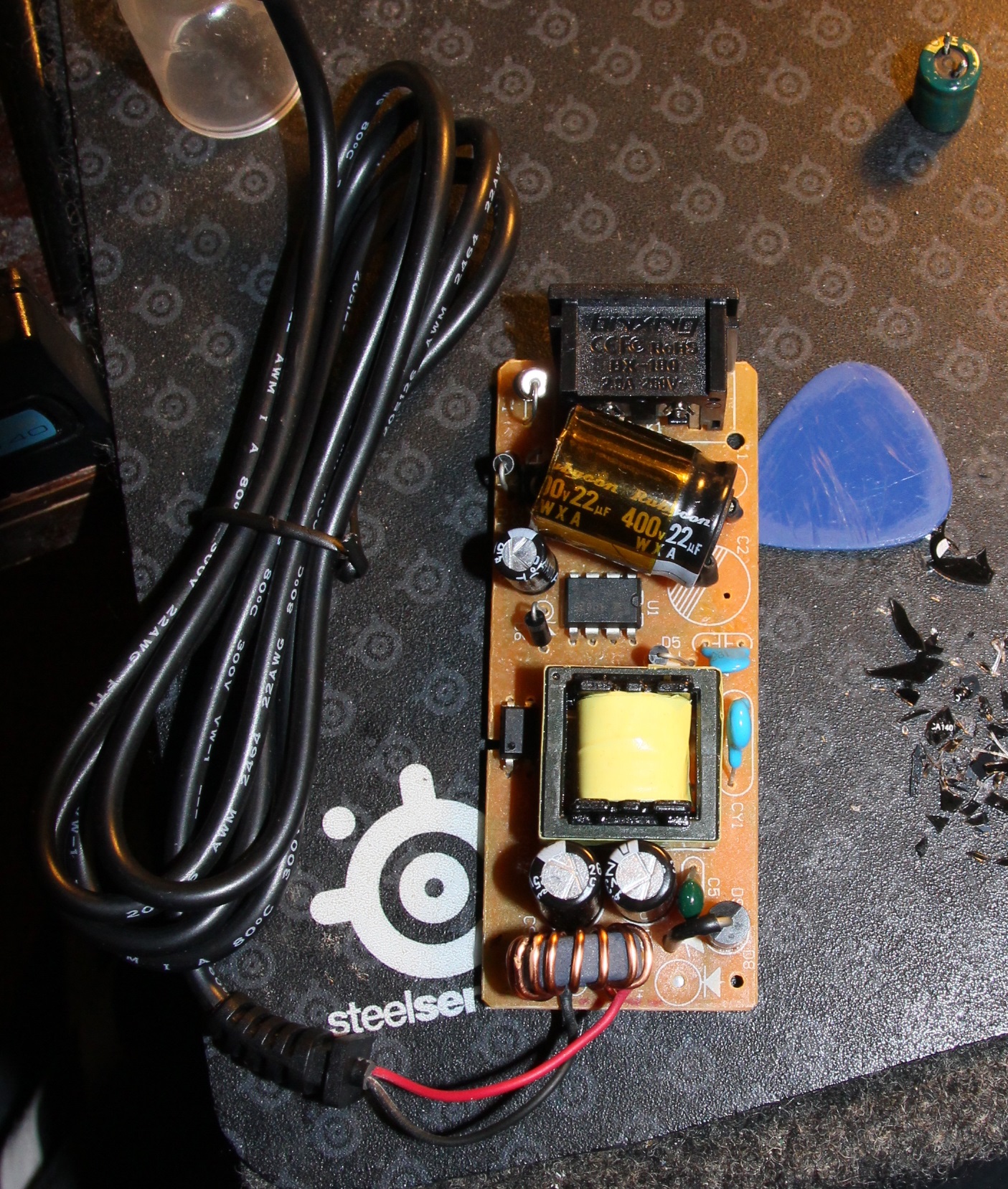

    Photo 2: "after"
    Couldn't help myself - i "had to" recap this thing, for peace of mind and longevity. 22u/400v Rubycon WXA after the rectifier bridge - this one needed a bit of creativity, to shoehorn it in there I figured i'd "do the right thing" and heatshrink the leg-extensions, and Kapton-tape the top of the cap, due to the proximity to the diodes.
    I had to relocate the far end of R6 (start-up resistor from the rectified mains into the PWM chip), but that was trivial. I might consider slipping in an inductor into the intended footprint, but i couldn't be bothered scrounging one up today. 47u/25v Ketuo Vcc cap (for the PWM chip) got replaced with a 47u/50v Rubycon YXF, for good measure.
    Secondary caps got replaced with a pair of Rubycon ZL 330u/25v, and i decided to also squeeze in an inductor. Found one in my "collection", measured in at 10uH - oughtta do the job. Had to drill an extra hole for is input; its output fit in perfectly in the hole where the V+ wire used to be. Drilled an extra hole for that too.
    Now, not wanting to upset the feedback circuitry, since that had a trace coming from right next to the output wire, i had to "jumper" that to where it used to be - before the inductor.

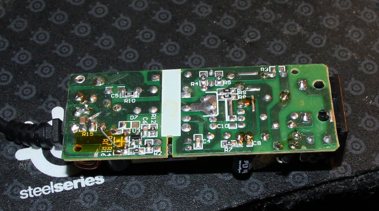

    Photo 3: "after", bottom side
    Just for good measure, i also tacked on a 4.7u/25v 1206 ceramic cap right at the (relocated) output wire. If something's worth doing, it's worth doing right, eh?
    You'll notice some scour grooves - one's under the inductor (the bigger one, near the axial center of the board), and one on the "southern" edge (voltage coming from the output, into the feedback circuitry).

    That CY cap is the X/Y SAFETY CAP, it is used to reduce the Conductive noise to pass compliance conductive noise test requirement, we had to do the same in our products, it is has to be safety rated because it is connected between the primary (hot) and the secondary (cold) side and the capacitance has to be low enough to not pass excessive leakage current.

        budm, my point was that 1) i was surprised it was installed in the first place, and 2) that it was indeed safety rated. Don't tell me you haven't seen teardowns of cheapo / fake phone chargers and such, that had plain 1-3kV ceramics straddling the isolation barrier
        In stuff like this, that's REALLY built down to a price (in China, "obviously"), seeing "proper" stuff is a bit of a surprise. I mean, this whole thing cost me a grand total of 16,80eu shipped (~22$ or so), so i wasn't expecting much, to begin with
