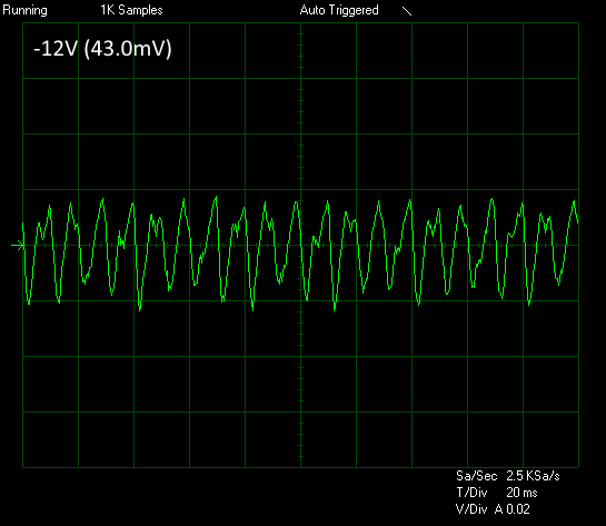

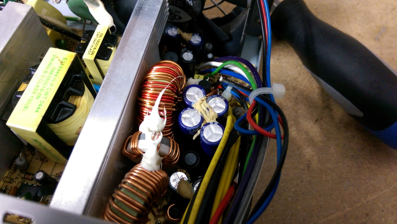

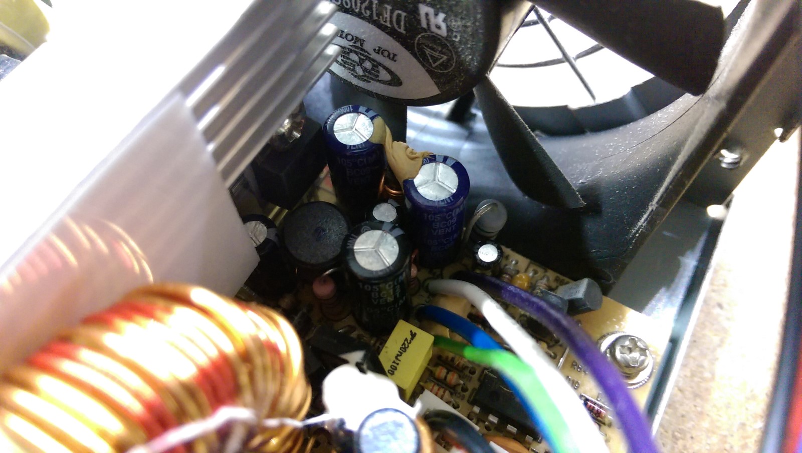

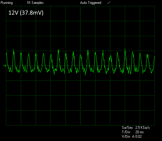

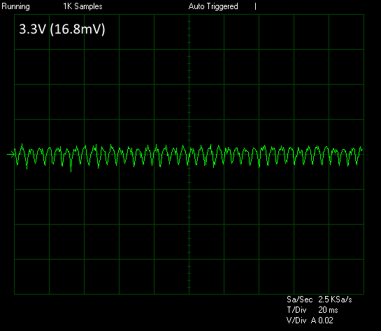

    A guy recently brought an old s478 PC in to work (which he was retiring) to transfer data to a new laptop. I noticed that it had an unmodified Antec SL350 PSU in it. I opened it up just for laughs, but I was in for a surprise. The caps looked fine (with the exception of one on the 3.3V rail which looks slightly bulged). Thinking that they must all be dried out and failed without bulging, I loaded it up to 350W on the tester. Surprise, surprise, everything is well and truly in spec. This thing must have only been plugged in once for a few hours per month or something (or he kept his PC in the fridge ).

    Wow, that's actually amazing. Must have got extremely lucky, because they'd fail from just sitting, and fail with lots of use too. So the slightly bulged cap is a Teapo and not a Fuhjyyu? How much load did you put on the 12V? Did it get really hot?

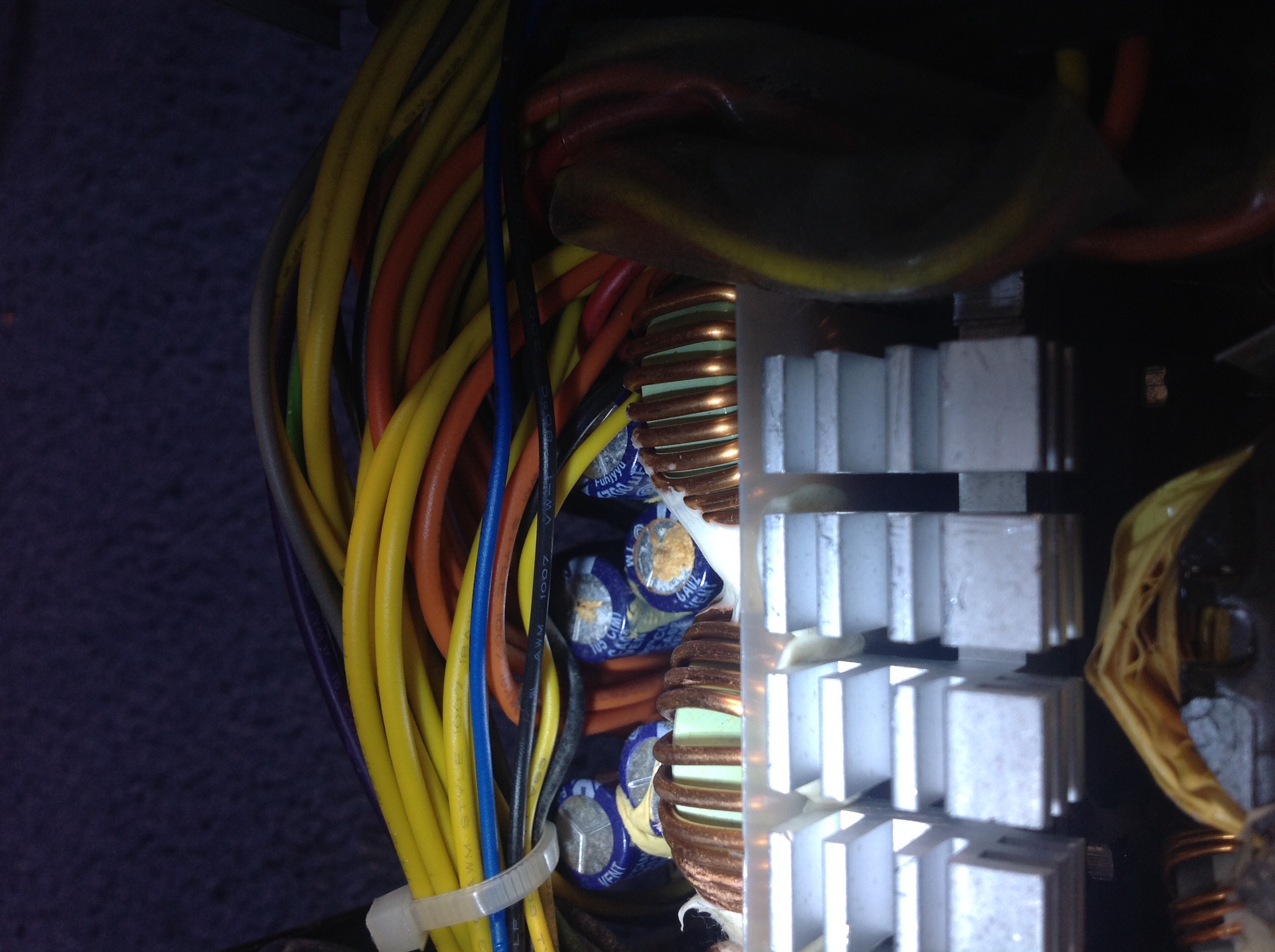

      Wow, almost every used antec psu I have come across a large majority of the fuhjyyus were blown even in a two year old neo :O
      Image showing that two year old neo that had moderate use, almost all the fuhjyyus were blown replaced with panny fr, samxon rs and ucc ky.

          It's a Fuhjyyu. I had about 20A (240W) on the 12V rail, 15A on the 5V, 10A on the 3.3V, 2A on the 5vsb, and 0.1A on the -12V. The heatsink did get hot. It was too hot to hold my finger on by the time I finished load testing. However, unlike on most other smartpower PSUs, the fans did actually rev up. They were probably at nearly full speed with said load on the PSU after a few minutes. That may just be why the caps held up better than usual on this particular unit.
