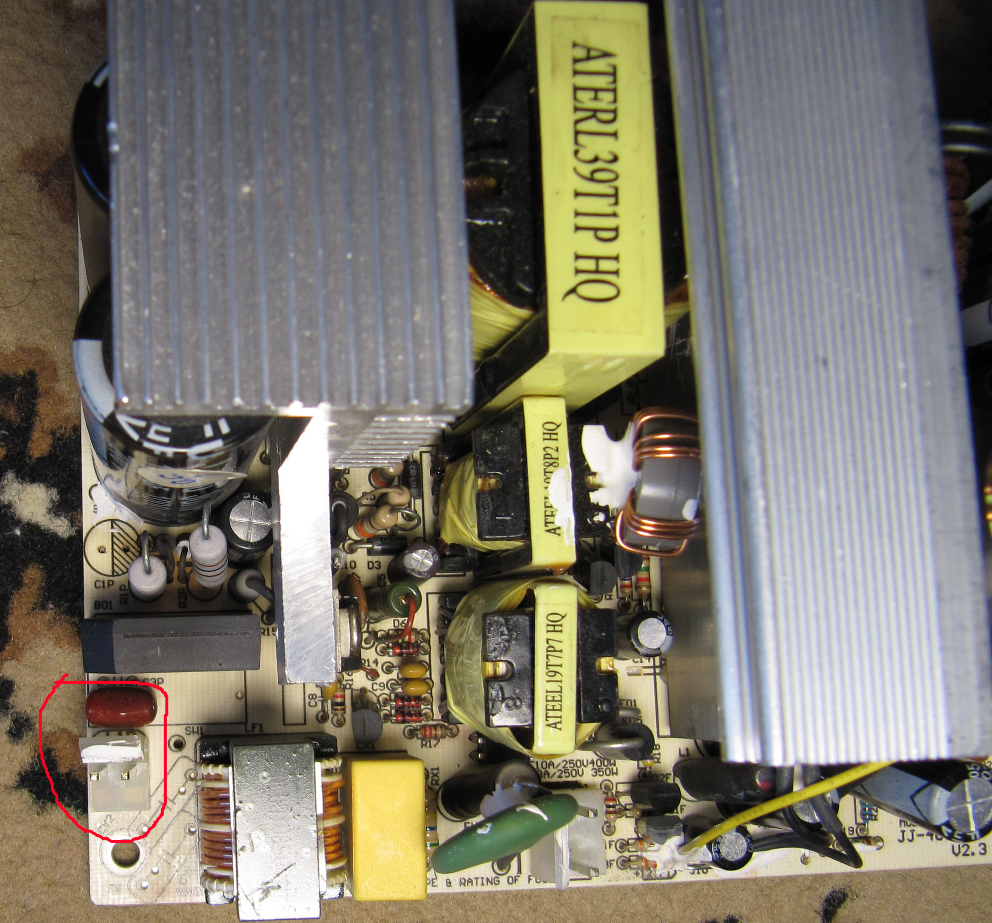

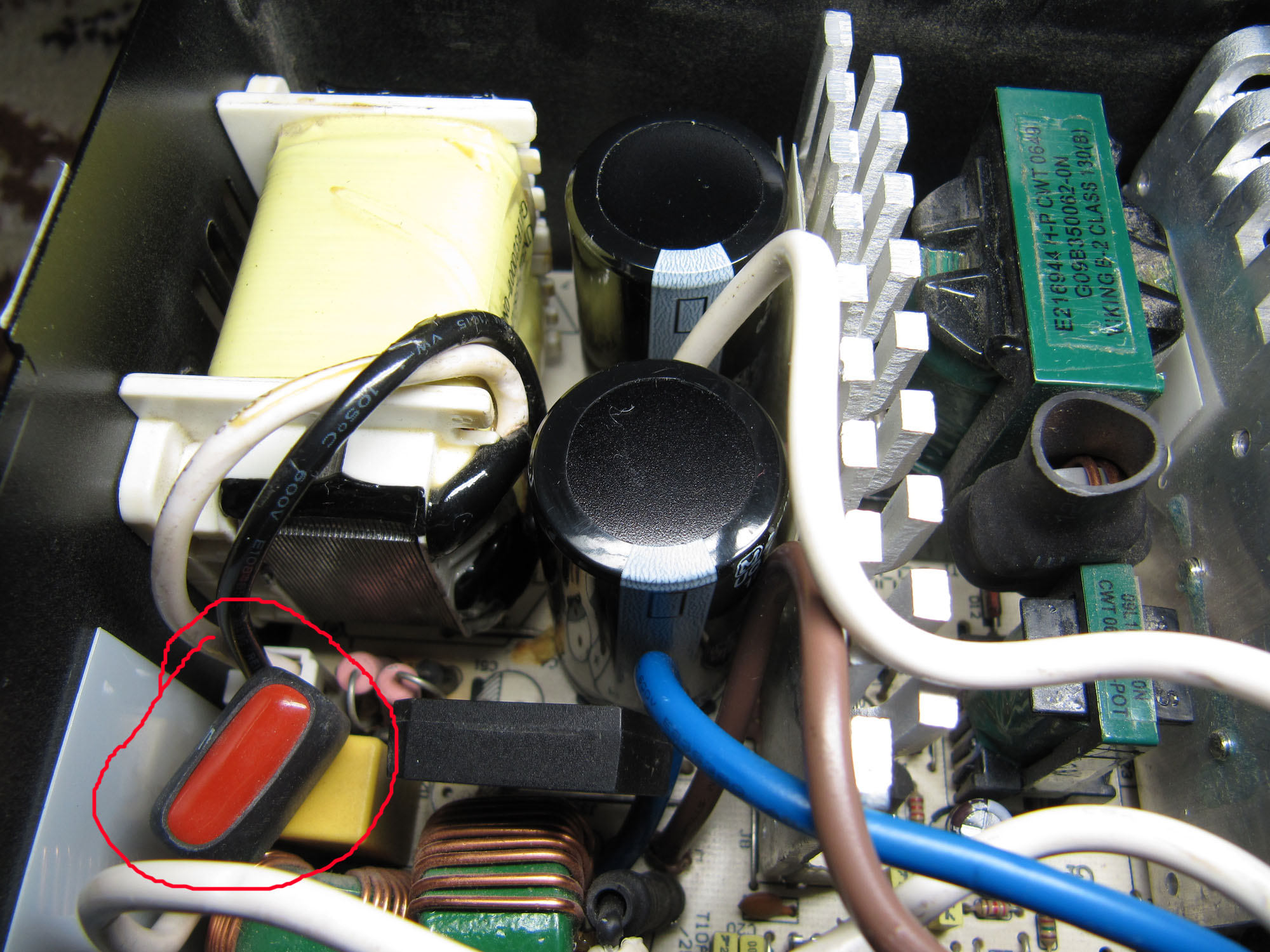

    What's the cap for?
    I am not sure what the red foil cap is in this PSU for.
    It is connected between phase and neutral in front of the bridge rectifier so it behaves like filtration cap continuously (like it's not part of the voltage doubler or something). So it should be safety X, shouldn't it?

    If it is connected across, then yes, it should be safety cap type. There is no X/Y printing on the body of the cap? What is the brand of this power supply, if it has CE then it is faked CE, no way it could have pass CE compliance, all the safety components have to be on the construction listing.

      Yeah it should be an X cap, seems to be 1uF maybe these diped film caps are cheaper than the X ones but im not sure I've never bought diped film caps or maybe they run out of X caps and just put whatever they had on hand, at least it seems to be sitting after the fuse so in the rare event that the cap shorts the fuse must blow. There is a thread on this topic somehow you missed that part

        What PSU is that? It looks like a Delta, but surely, Delta would know better than that?!

          They do make X cap in that type:

            It's Delta OEM design, GPS-400AB-C as Thermaltake Litepower 400 PP (W0161).

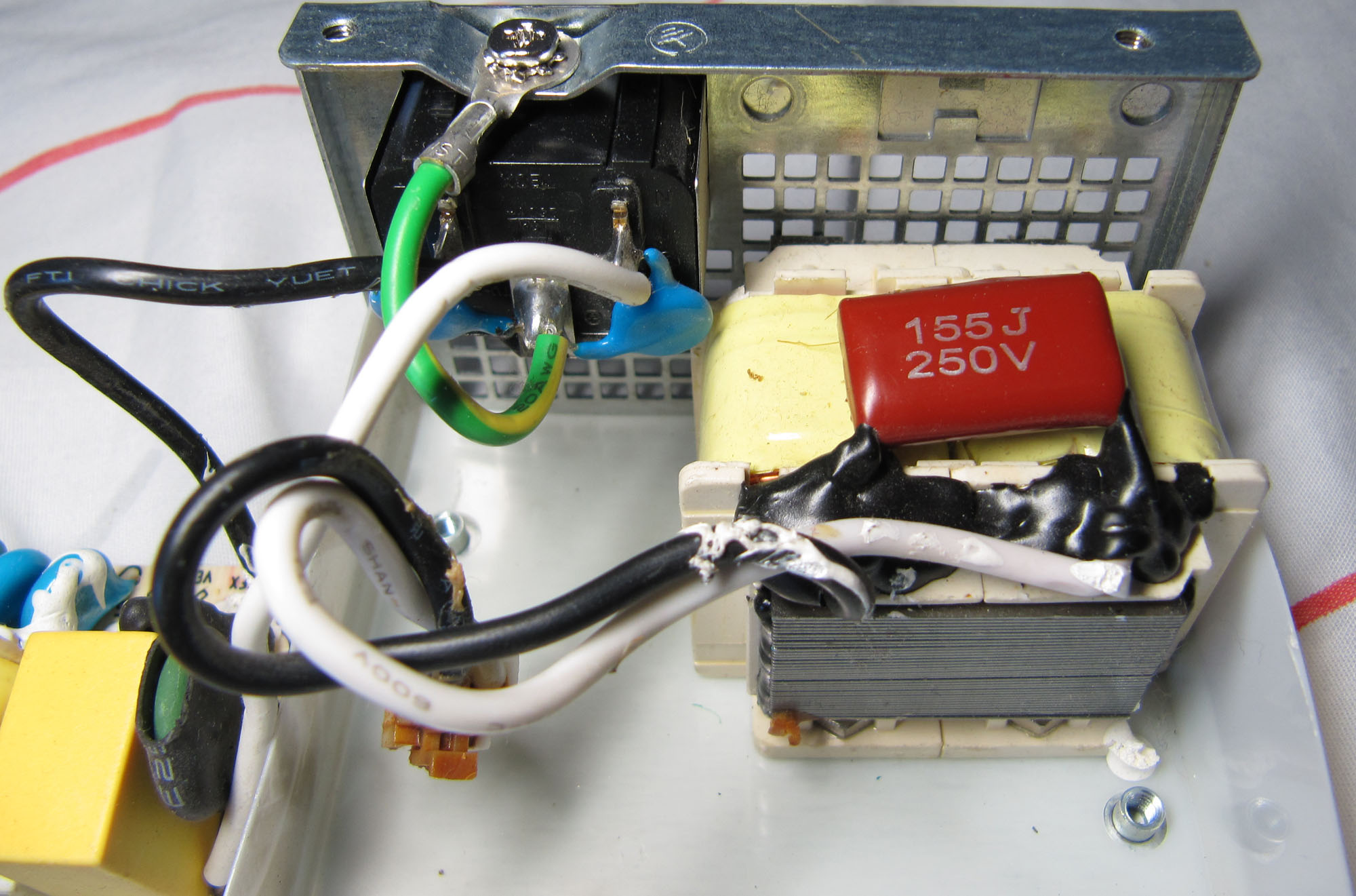

            Now I am looking at it, it is not between phase and neutral, it is on the phase only, in parallel with the passive PFC coil. So possibly it is to shift back the phase change the coil makes? Usually the caps is on the coil itself but not here. Than there is current at high voltage flowing through the cap, but if it fails shorted, the PFC will just not work, not supressing the harmonic distortion, that's all…

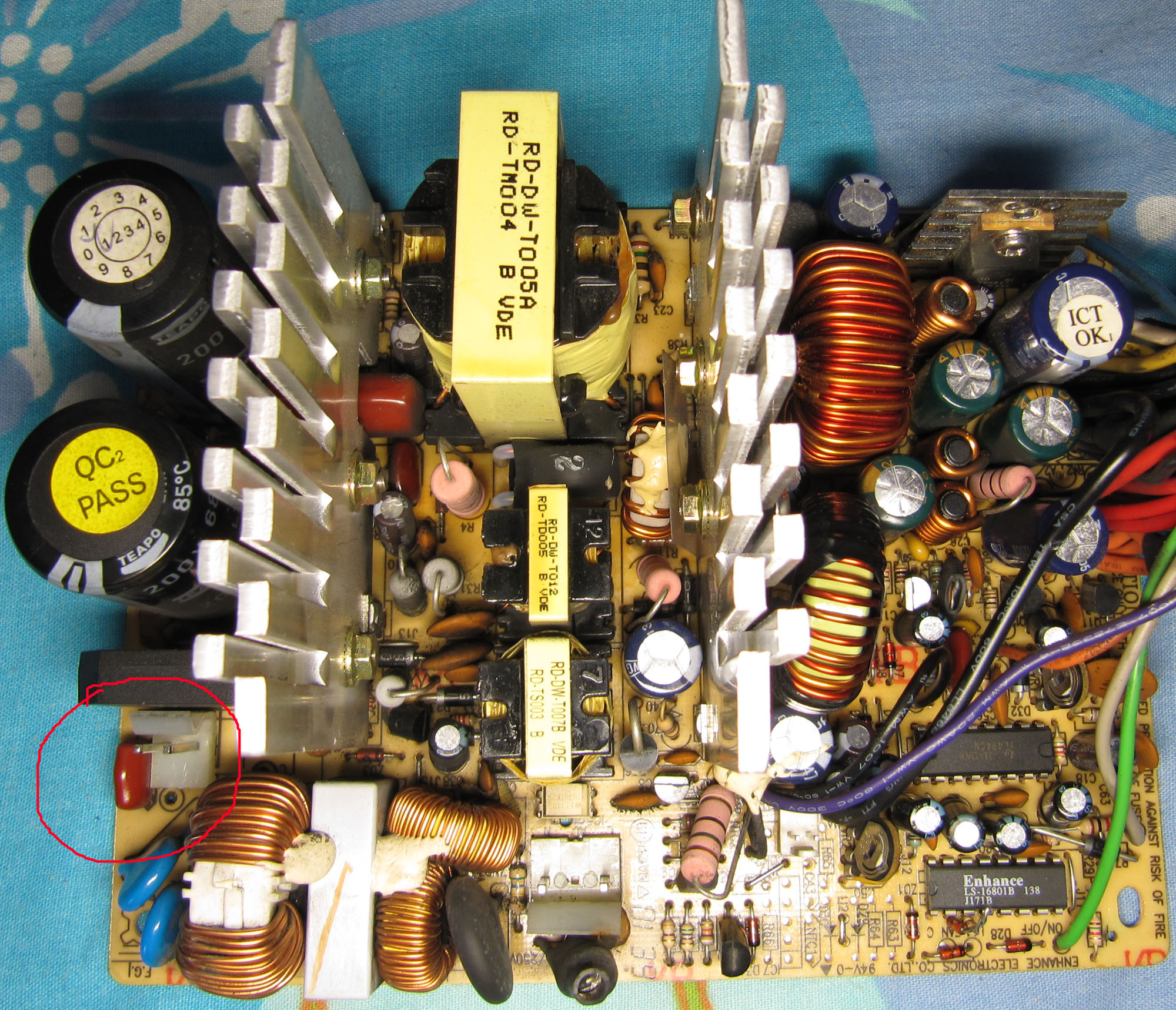

              Yeah, I have seen this several times, a non safety cap in parallel with PPFC coil.
              I attach 4 images with the model of the psu in filename.
