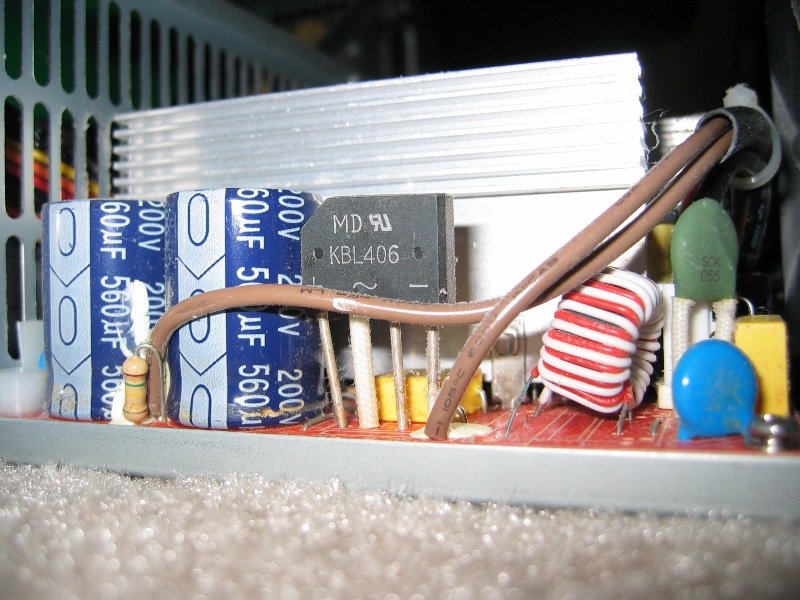

    I have this Mad Dog (SuperFlower) 350w, and I read it's a decent PSU albeit with mediocre caps. It's been fine so far, but once I added a new video card, the +12V goes out of spec under load - my DMM reads it dropping down to 11.25V.
    Would upgrading the caps keep this PSU in spec, or am I just asking too much of it? Primaries are 560uF with no visible branding, and the only 16V cap I saw next to the outputs was a 1000uF PCE-TUR.

    First check the +12V rating of your PS to make sure it can support the new graphics card. If OK replace the output caps. I can see six of them on the right side of top view. The originals show no sign of problem, but depends on brand. What is the brand?

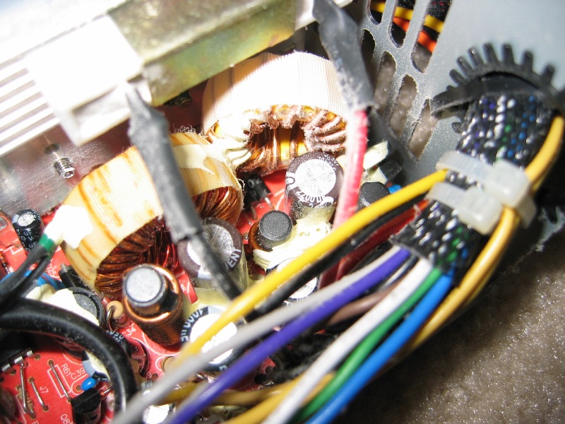

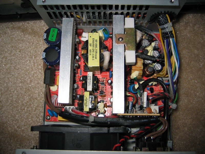

      The label says the +12V is rated for 20A, which matches the video card mfg's recommendation. All of the caps in there are PCE-TUR, except for the unbranded bulk caps.

        That PSU is not capable of 350W - it's probably more like 150-200W, with a max of 6-10 A on the +12v rail.
        The quick fixes you can do are to change the secondary rectifier on the +12v rail to at least 20A, and increase the capacitance on the secondary pi-filter for +12v to 2 x 1500uF, 16v. Also change the fan to a ball-bearing fan. You can make it more reliable with these fixes, but there's no way to increase the real power output except by major surgery. If it gets overloaded, it stays overloaded.

          Can you get a picture of the components on the secondary side heatsink?
          (that is the DC side, the larger of the two heatsinks)
          And yea, the design does look cheap, but atleast there is some input filters installed, actually all components seem to be installed so atleast as far as crap PSU's go it's on the upper end of the food chain

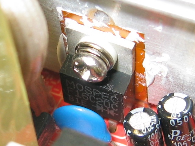

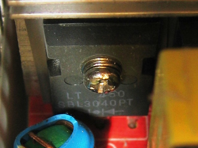

            Let's see... attached to the secondary heatsink are two SBL3040PT and one F16C020C. Not sure I know what that means, though.

              It means that your +3.3v and +5v have 30aH current each available
              And your +12v has only 16aH available
              That is of course not counting in any other components which way further reduce the total ampere rating
              If this PSU is not powering a computer that draws it's power mainly from +5v then it's no wonder things are not working out for you

                      Looks like you have a 16A rectifier for an O/P "rated" for 20A max. - not great. And then the 20A max. may be reduced by the combined power rating for the +3.3V, +5V and +12V. And those heatsinks ... as Clara Peller used to say, "Where's the beef?!" Either that fan is a mini helicopter or you've been fortunate.
