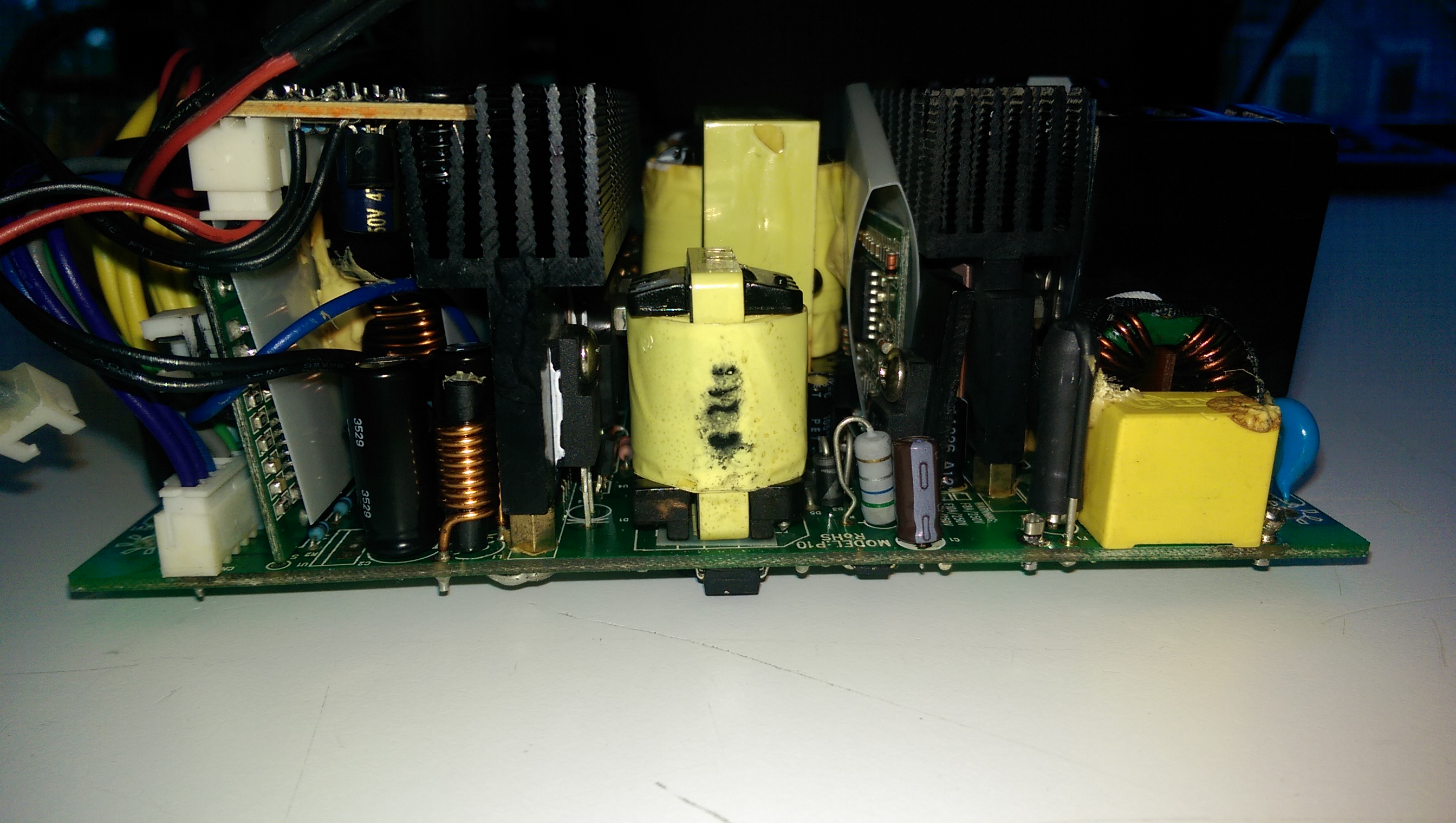

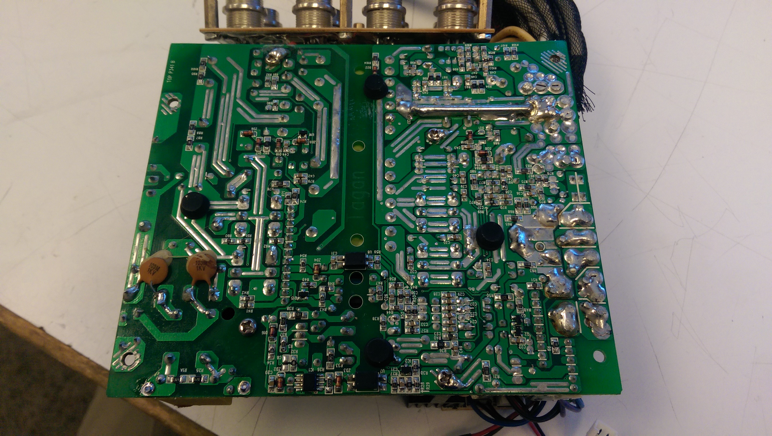

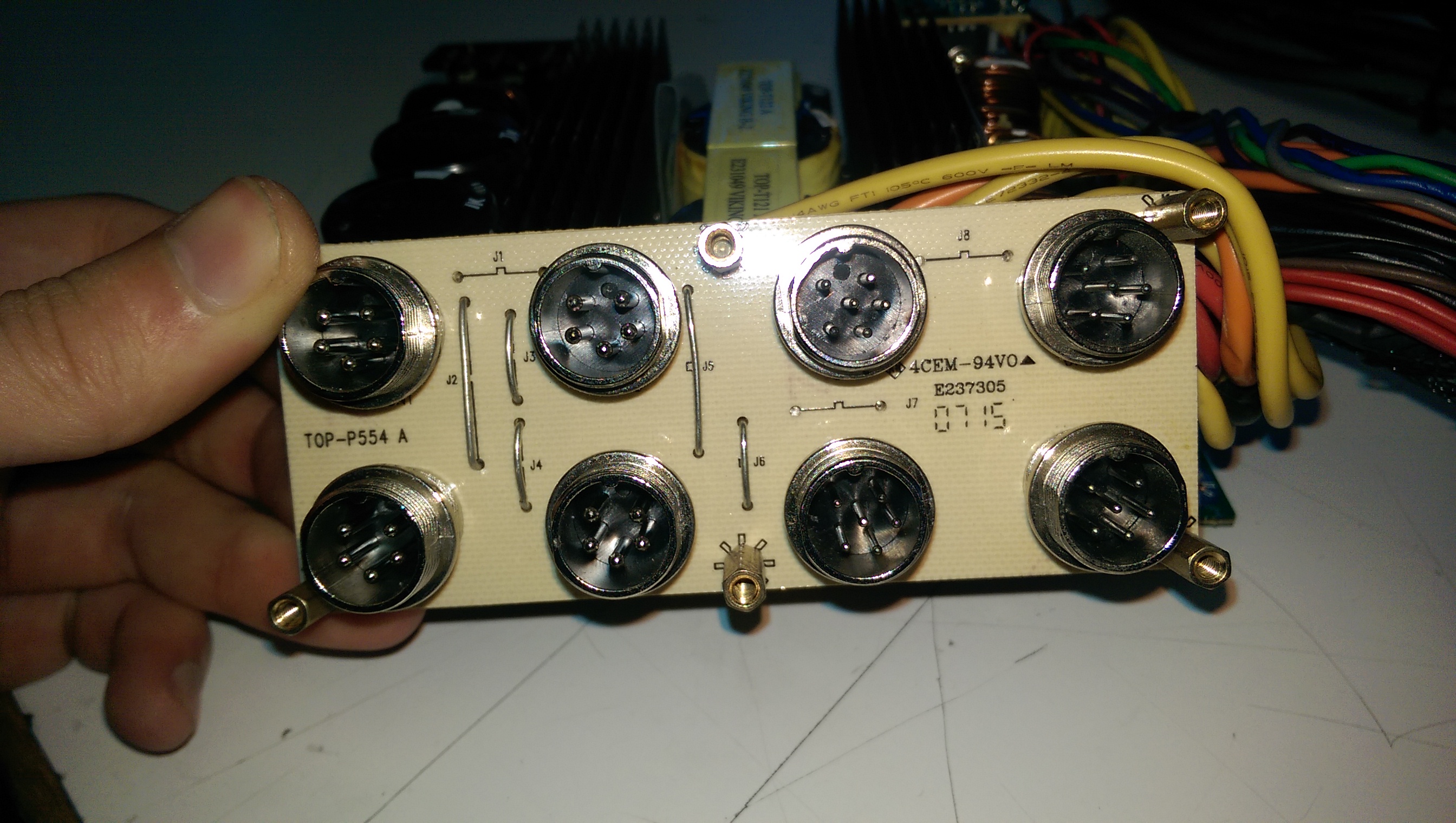

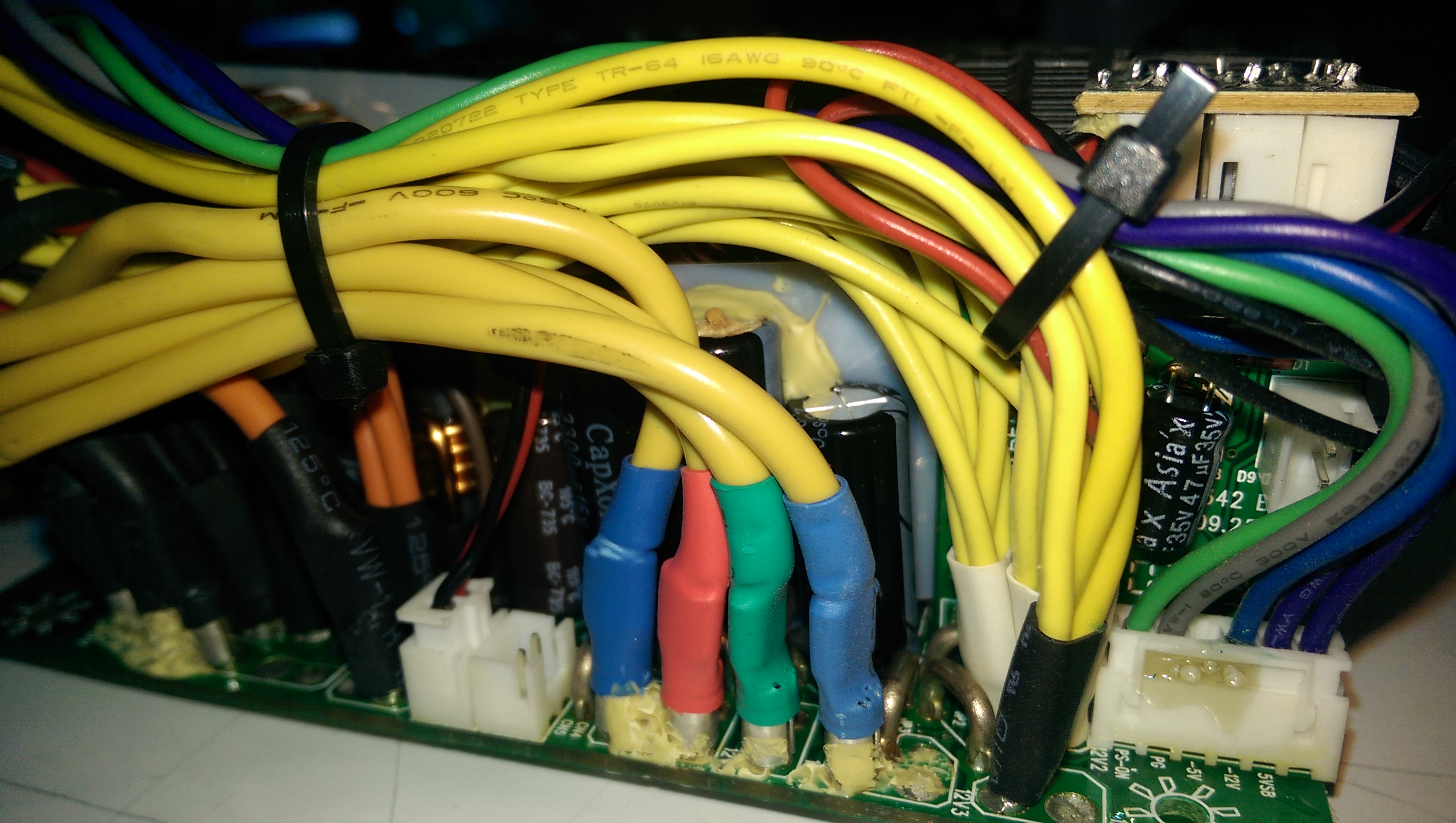

    Got this thing for $15...the dude said "it won't supply enough juice to the motherboard" What a steal! It gave 5VSB but wouldn't power on. Maybe those leaking CapXon had something to do with it?
    Well I recapped it and it fired right up. I'll admit it was pretty hard getting some of the caps out, especially the ones where the negative lead was directly adjacent to that HUGE ground wire, my iron barely had enough oomph to heat it up.

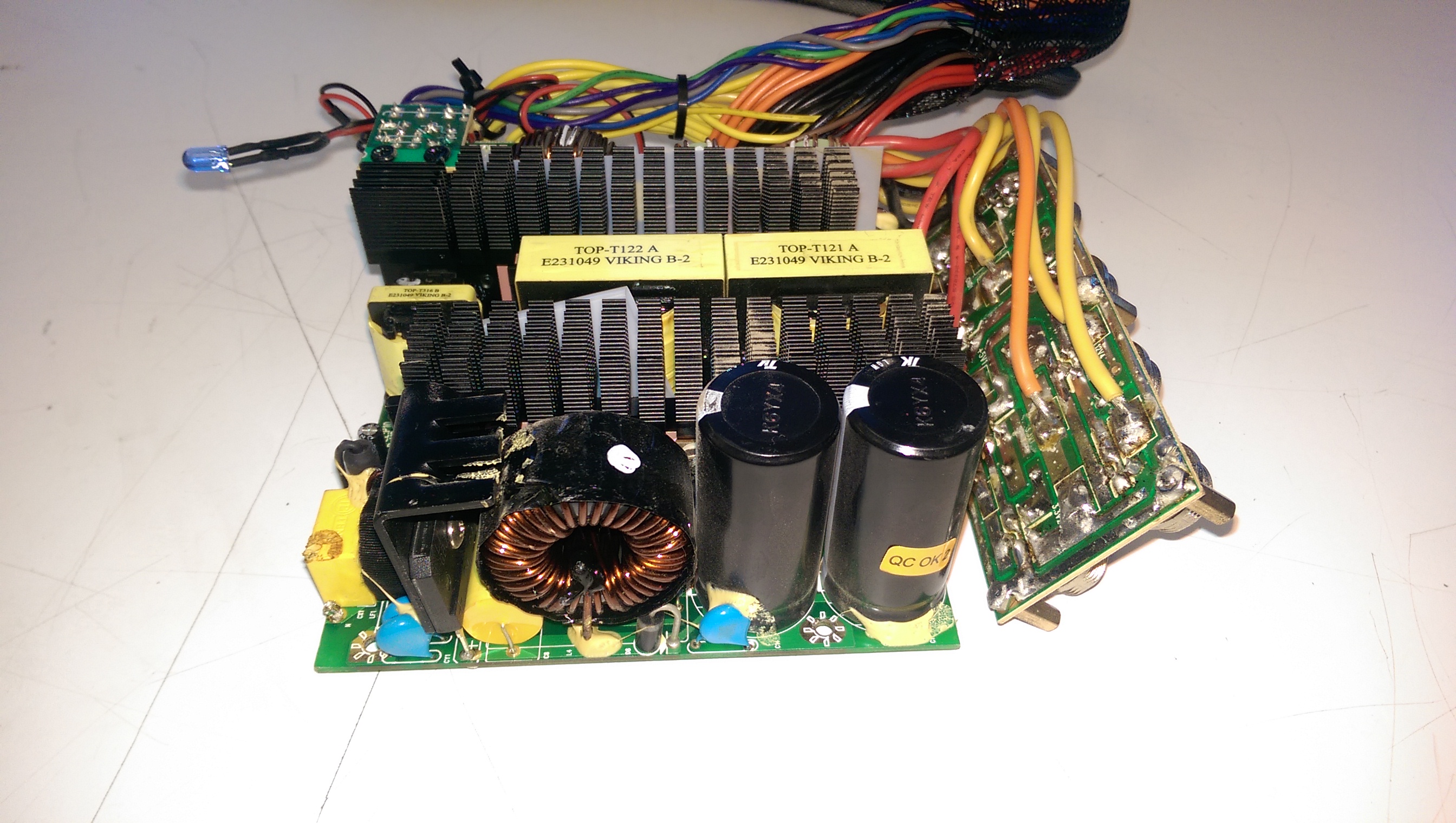

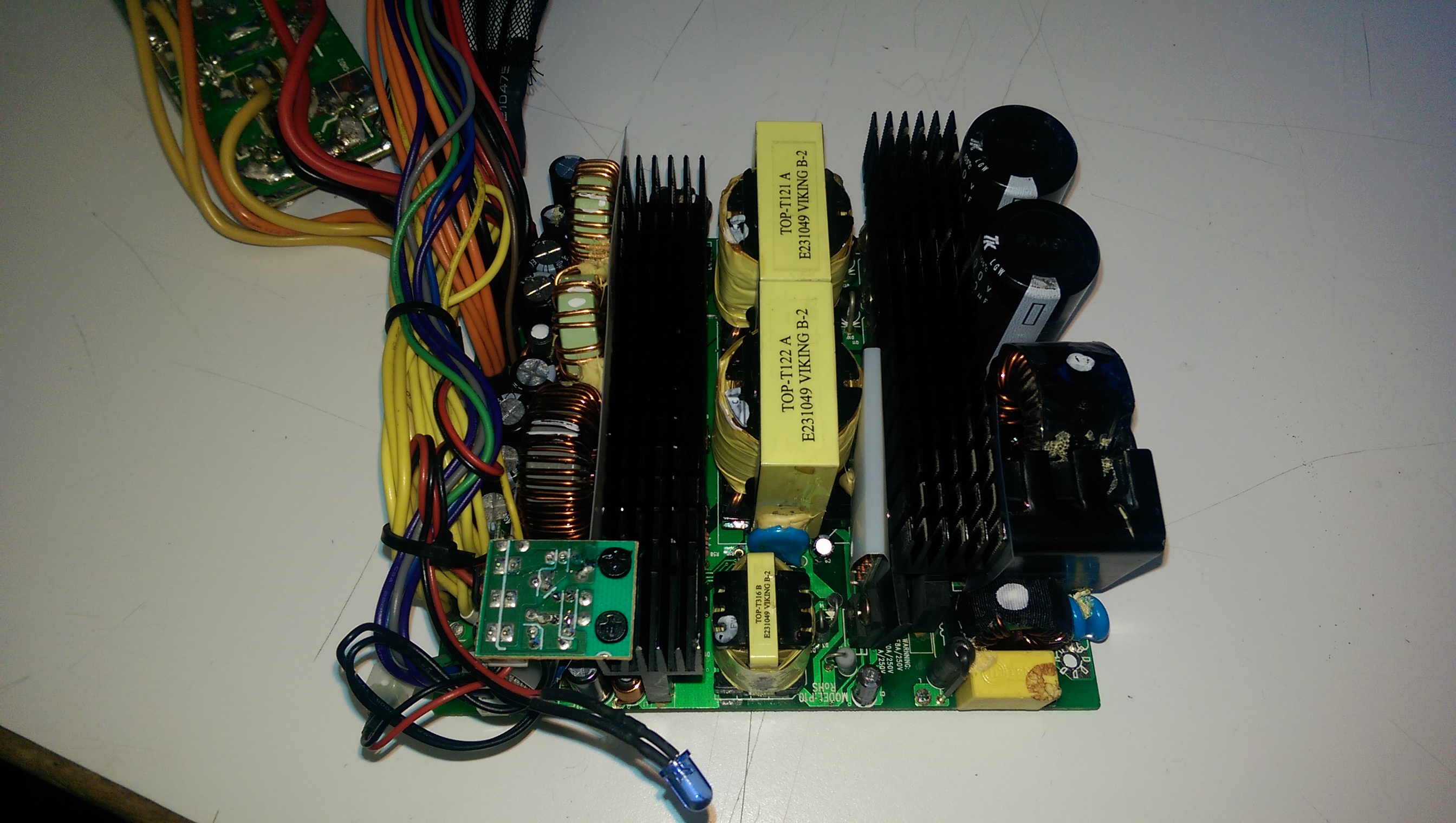

    So this thing uses a 25A bridge rectifier with a heatsink, and 1000uF 200V TK caps. How does it use APFC with two 200V caps? Does it act like a voltage doubler?
    For the APFC transistors it uses two of these: https://cdn.badcaps-static.com/pdfs/...ebf159ba50.pdf
    PFC Diodes: http://datasheetz.com/data/Discrete%...atasheetz.html
    Switchers (4 of them): https://cdn.badcaps-static.com/pdfs/...45d354599a.pdf
    It's got two of those huge transformers. It actually has six 12V rails! And they share 4 of these rectifiers: https://cdn.badcaps-static.com/pdfs/...3178bc3d3b.pdf

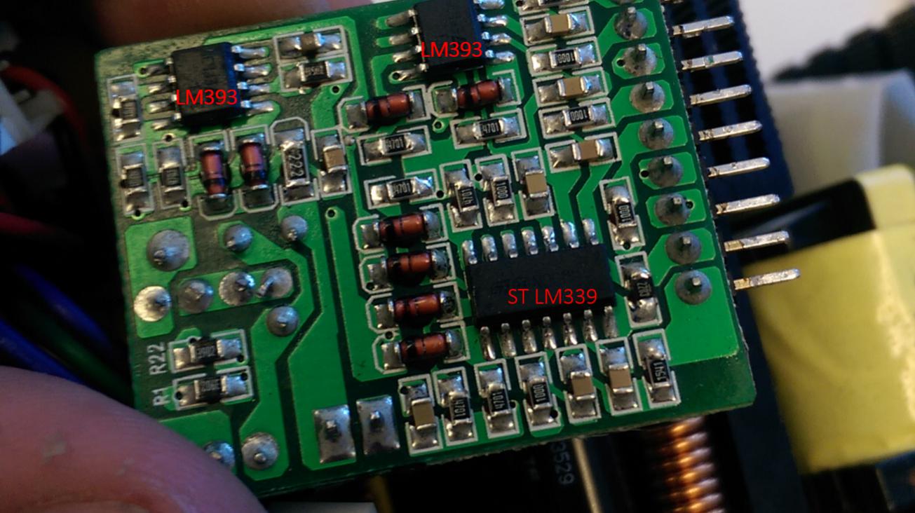

    5V and 3.3V use two of these each: https://cdn.badcaps-static.com/pdfs/...6d9e8256e1.pdf
    It's also the only 80 Plus approved ePower PSU, which means it can actually do 1,200W http://www.plugloadsolutions.com/80P...x?id=33&type=2

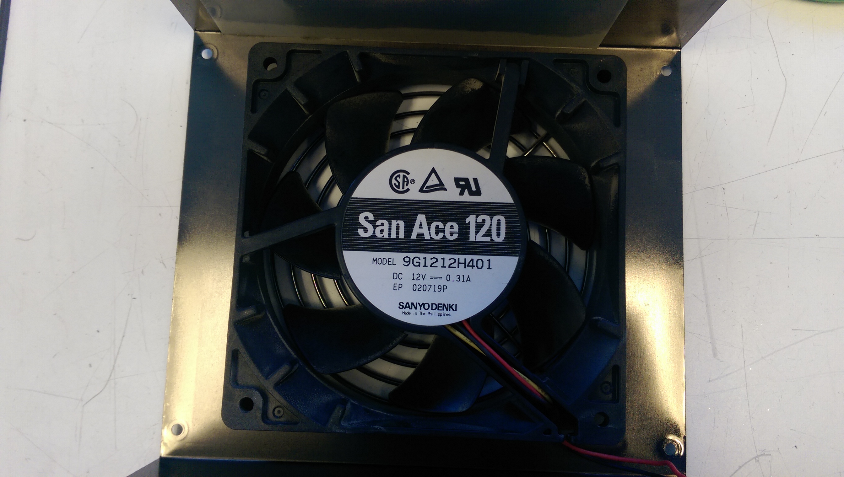

    Uses a nice fan too.

    WOW!!!
    And 16AWG wires!!!
    I need dis

      Haha Some are 14AWG too. it shows that Topower knows what they're doing when they try!

        Re: ePower EP-1200P10-T2
        Nice, nice, nice!
        CapXon caps are wonderful, aren't they?
        Can't say anything about the built quality, other than very good. The choice of fan is the best thing, though. In my experience, Sanyo Denki is hard to beat in terms of performance.
          • 31058

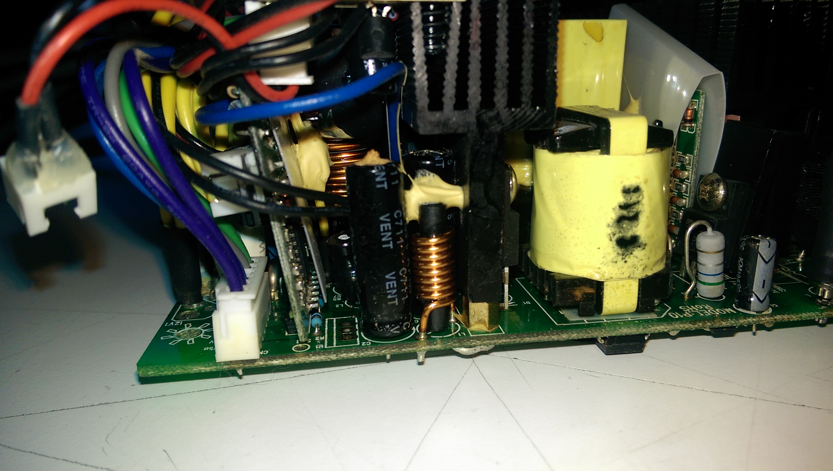

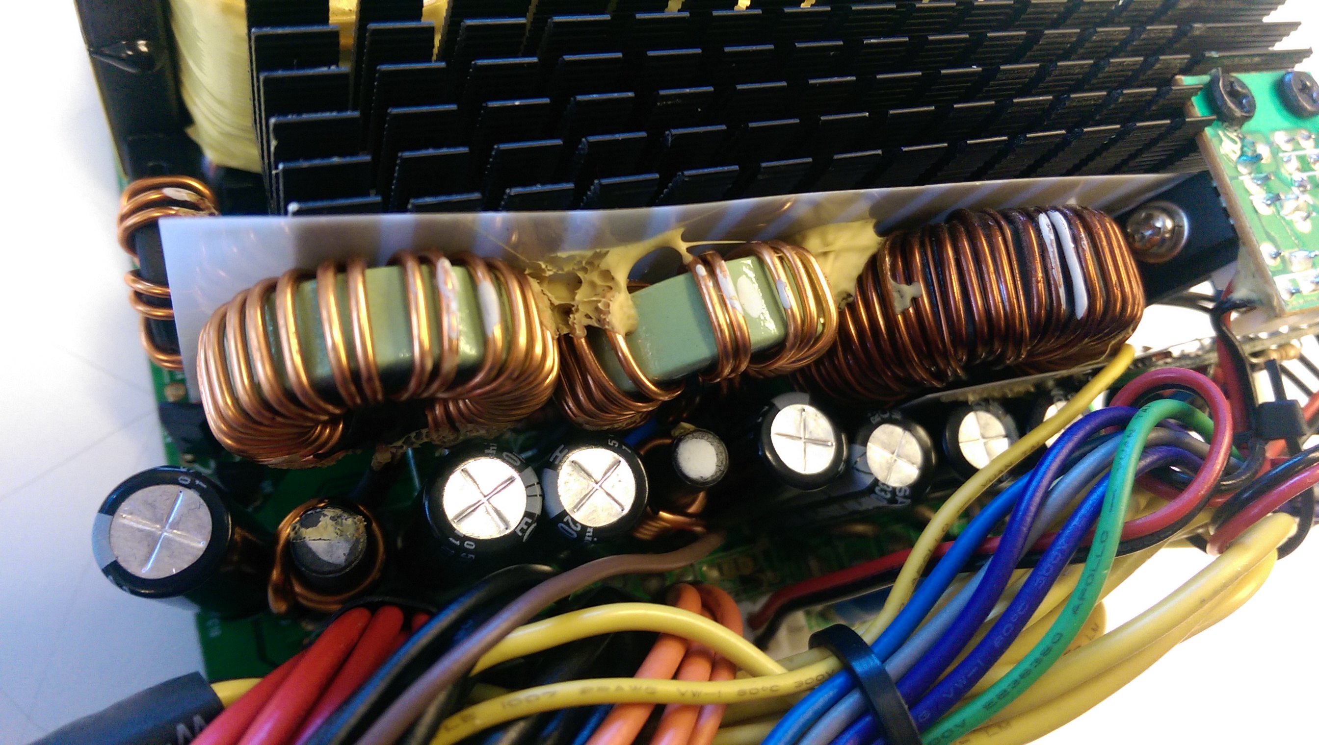

          too bad about the glue.
            They would just be in series with each other, which gives double the maximum voltage, but half the capacitance. It would be the same as using one 500uF 400V cap.
            The use of four switchers is unusual too. That means that it uses Full Bridge topology.

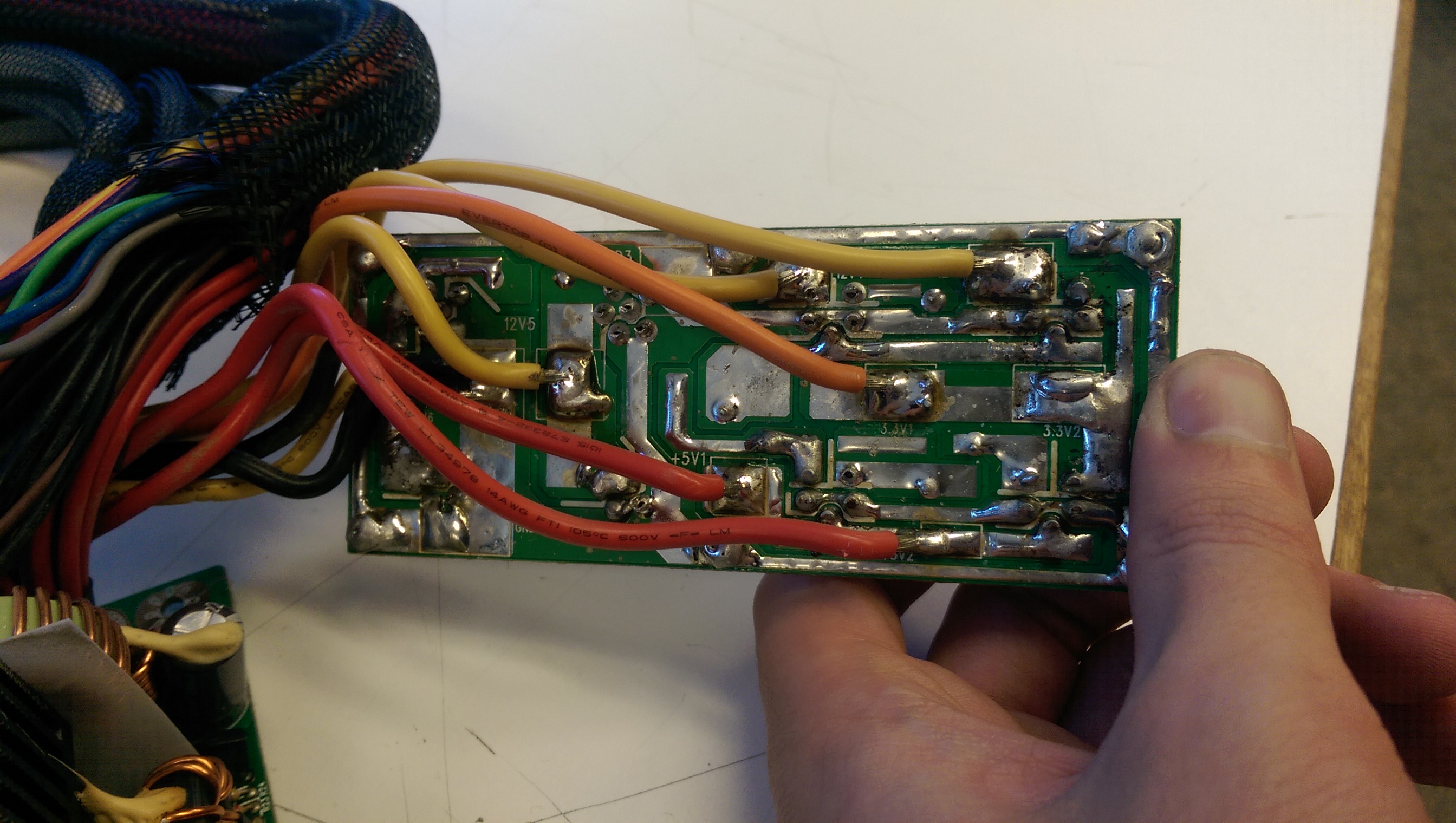

              Originally posted by momaka
              Nice, nice, nice!
              CapXon does have their niche
              Yeah the Sanyo fan spins beautifully. For the noise it makes, it moves a ton of air. It makes a strange sound at low RPM's though.

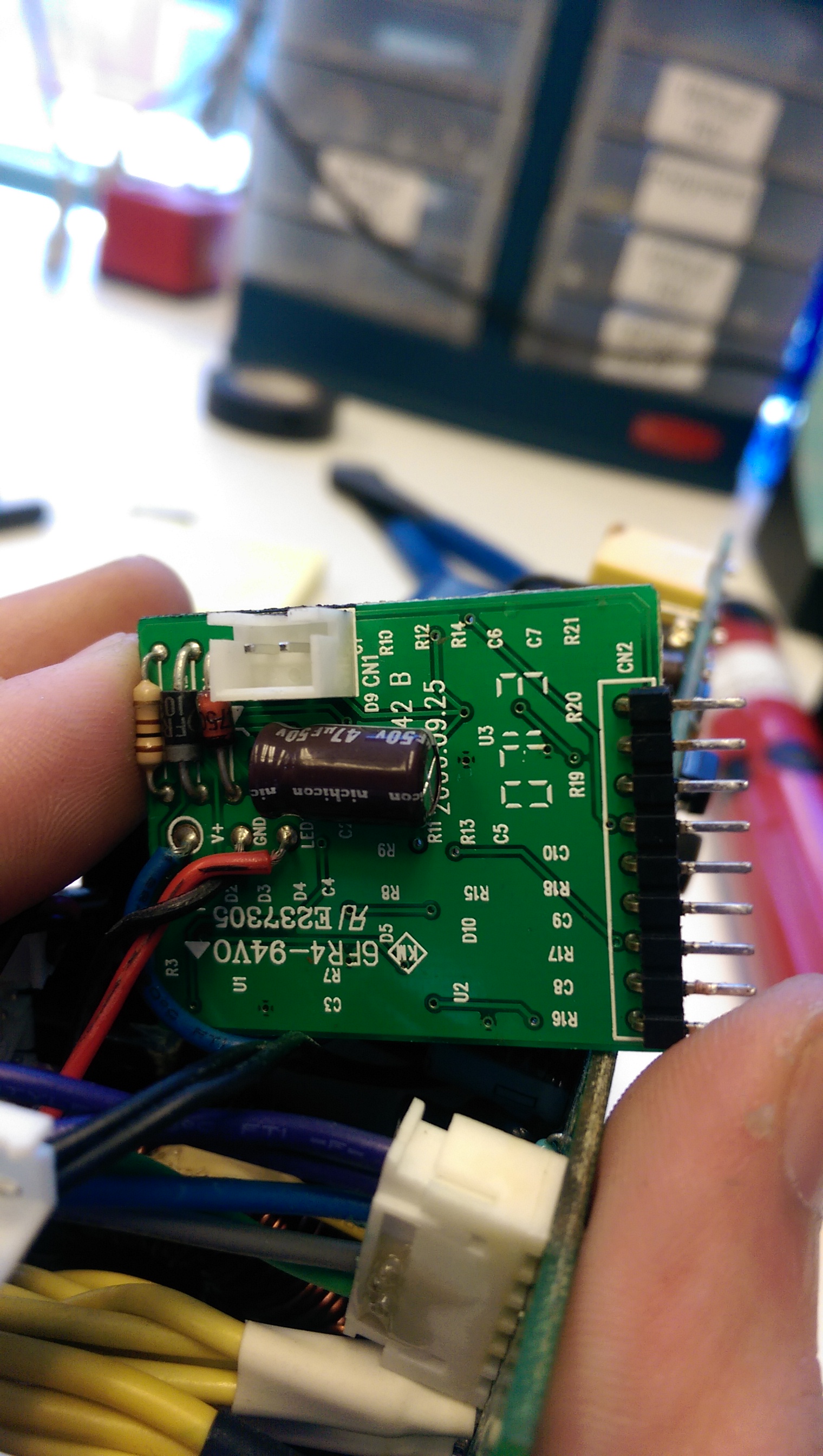

              Should I be concerned that there are no filtering capacitors on the modular board?
              I removed more after the pictures were taken, but couldn't get it all off.
              Full Bridge, is this why it has two transformers, literally doubling a half bridge design? Comparative to what the Pentium 4 was to Pentium D and/or Core 2 Duo to Core 2 Quad?
              Edit: I wonder if the 5VSB can do the rated 6A? The transformer is decent size. To give a comparison, that brown cap next to the 5VSB transformer in picture #9 is 11mm in height
                    I'm pretty sure that one handles the 12V output, while the other handles the 5V and 3.3V outputs. It's done to allow for more independent regulation. There are other Full Bridge PSUs (like the Be Quiet DarkPower Pro 10 850W - http://www.techpowerup.com/reviews/b...10_850W/4.html) that only use one transformer.
                      Really? They'd add that huge extra chunk of copper just for ~17% of its rated load? Maybe it does one or two of the 12V rails as well?
                        Possible, but unusual. You would have to trace out which transformer outputs go to which rectifier(s)
                                  Indeed. I have heatsink fans with Nidec and Delta fans, and for the same amount of air, the Sanyo Denki is always more quiet.
                                  Probably not. The way the PSU is built, I'm sure they didn't cut too many corners (CapXon caps aside).
                                  Very much possible, yes. Depends if the transformers have their primaries in parallel or series. With a full bridge, the primaries on the transformers can see up to 2x the main cap voltage - pretty cool, IMO.
