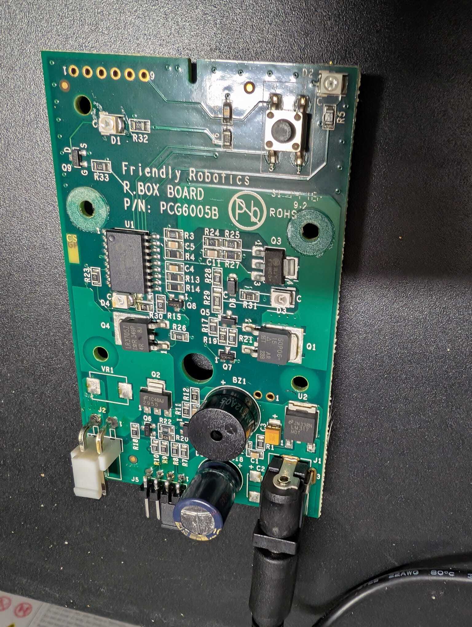

    i'm trying to repair my mowner's power supply unit which doesn't provide the 34VDC from the control electronic board. (PCG6005B)
    As i'm newbie in electronic repair ,i 'm seeking for advices.
    i can solder things and have some voltmeter
    here's a picture of the board .
    note : the input power is 34V DC and the output (white connector on the left) output 0V .
    when i turn on power , the status leds light up as normal (this board is measuring if the peripheral wire is cut , and can see when the robot is on it's base , all theses functions seems to work , except the charging)

    R20 bottom-center looksa bit strange.
    a fuse maybe?
    and check the all the transistors (marked Q) for shorts
