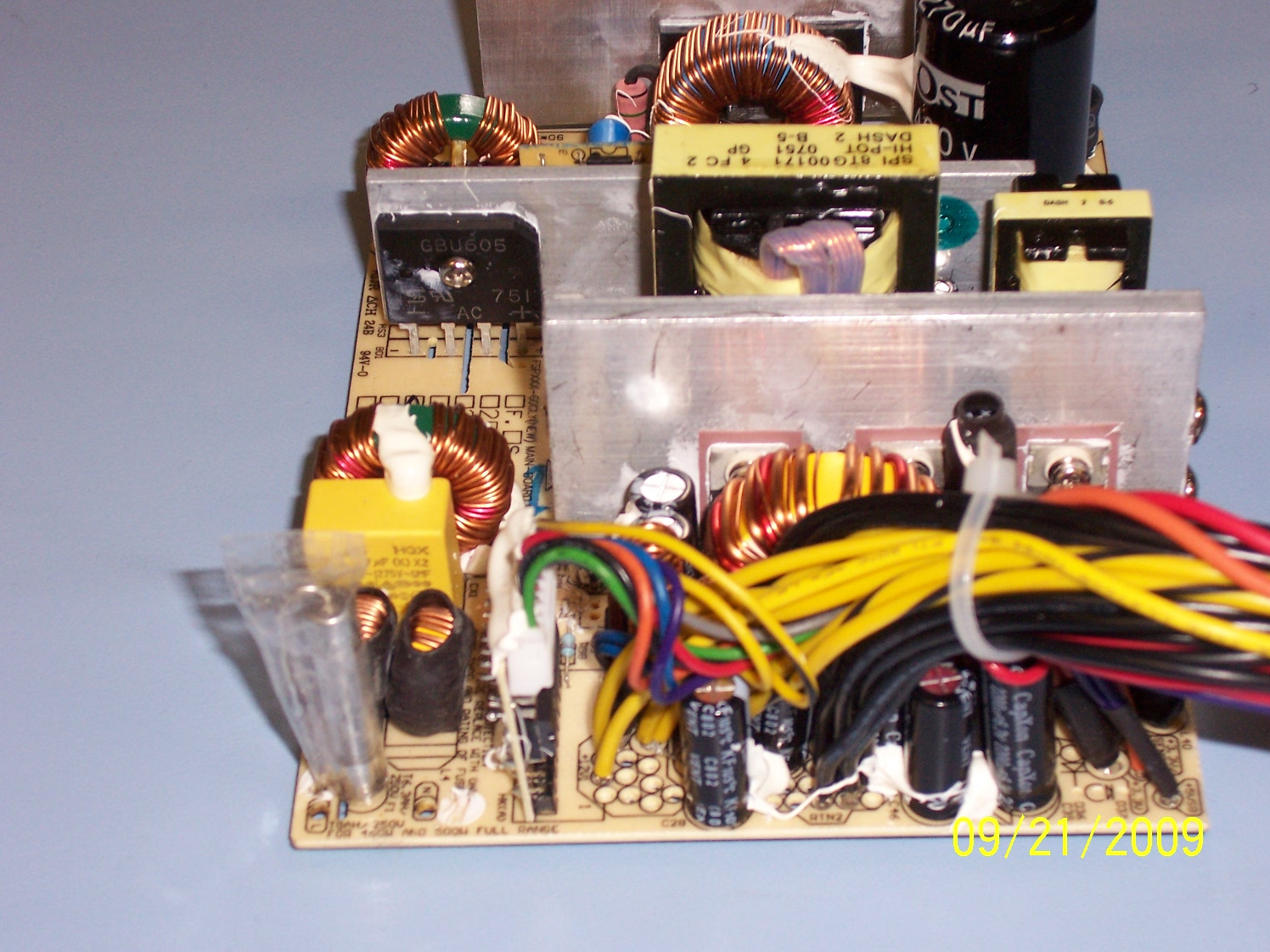

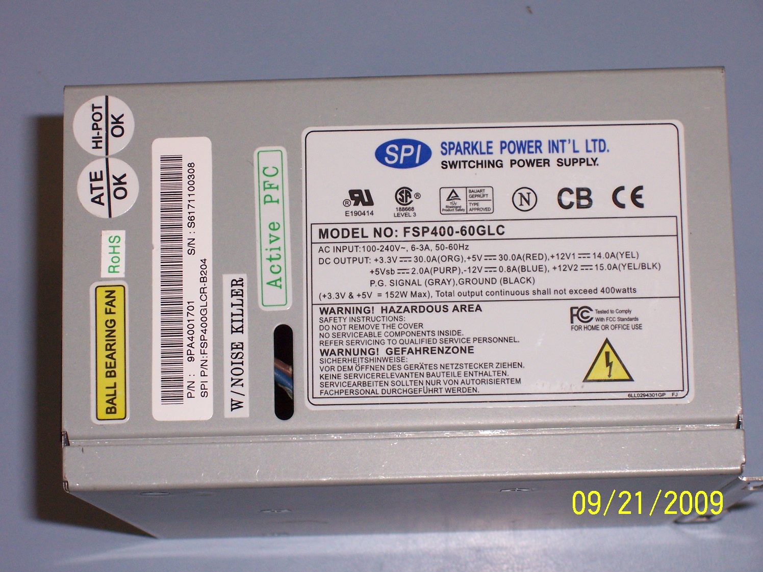

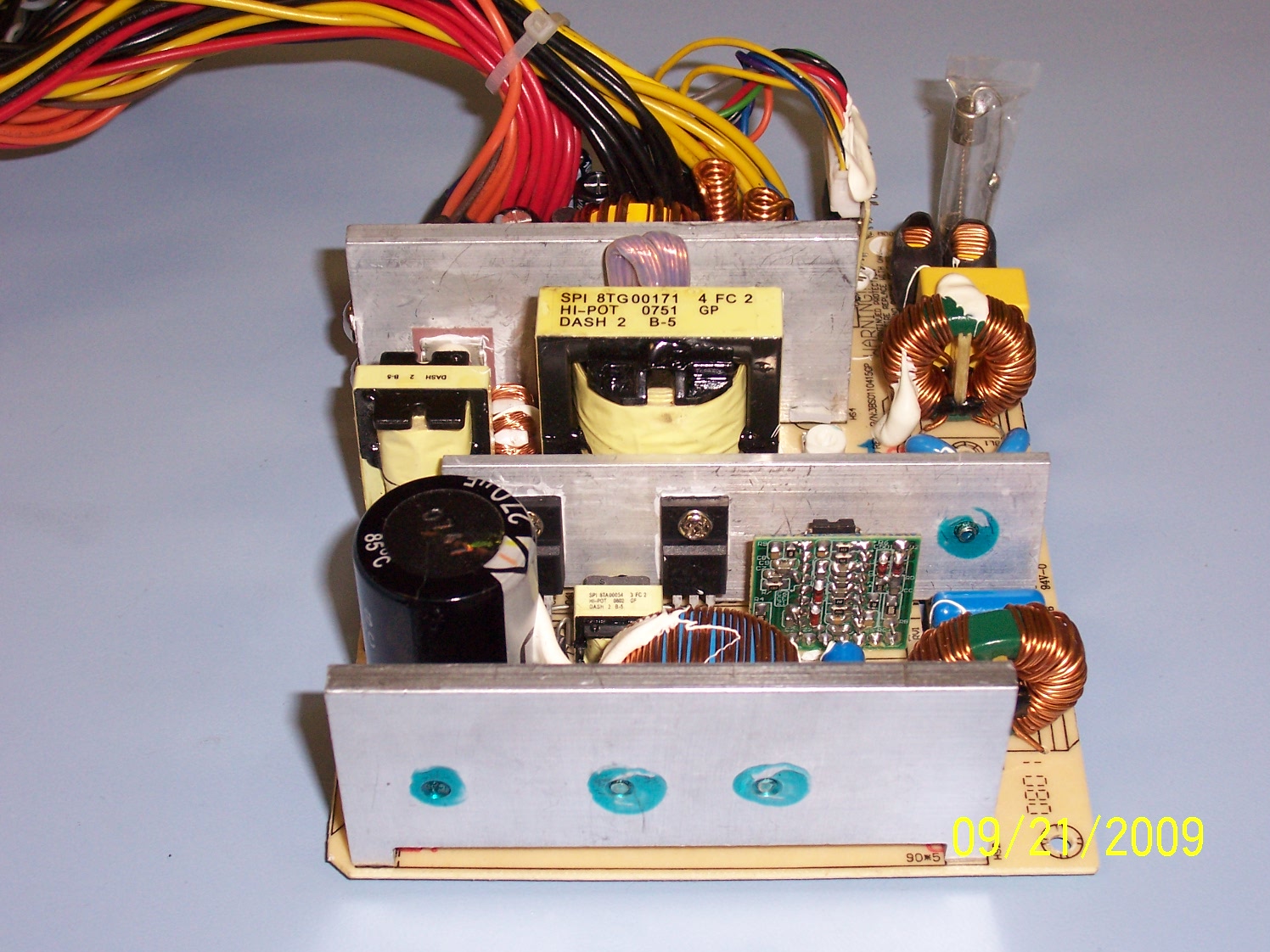

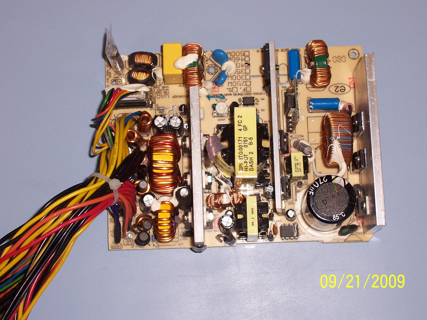

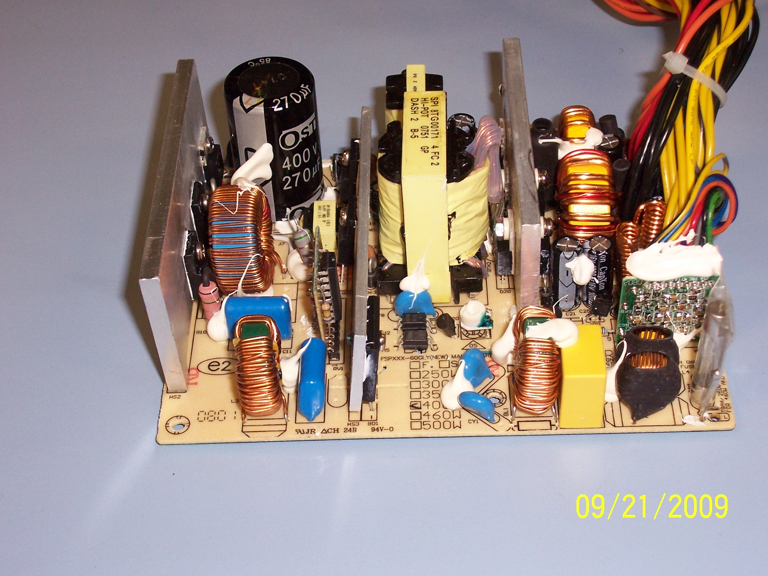

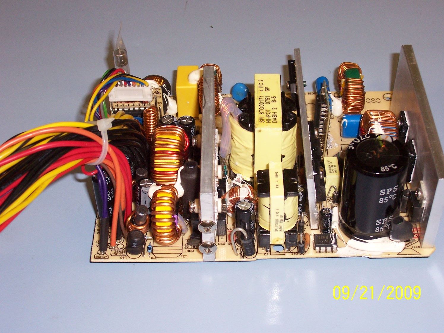

              I did a comprehansive study on this power supply board a few years ago. It is the same board under the Sparkle brand. I am including some photos of that power supply and the drawings I made. Hopefully they will help you to understand the circuits better.
