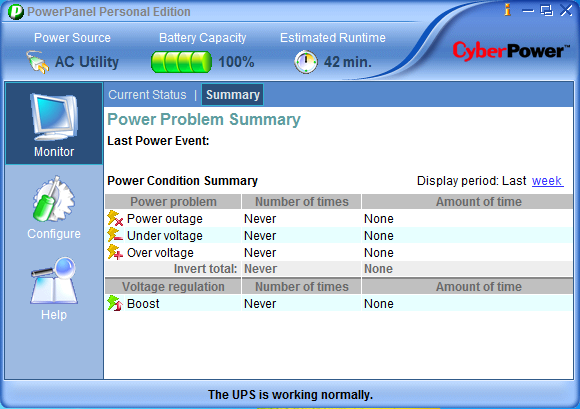

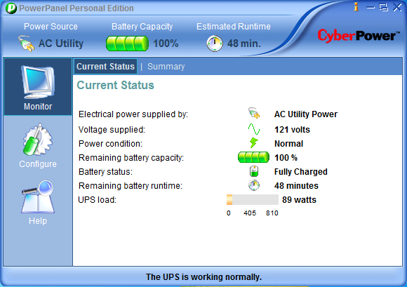

                      Guess I didn't knock on my desk hard enough - still having the problems.
                      The only thing hooked up the UPS on the battery ports, are my computer and the three monitors.
                      On the surge only ports, I've got my pair of computer speakers and a hard drive dock. That's it.
                      I'm definitely not overloading the unit. But it doesn't seem to notice the problems
                      The monitors only go out half as much as before, but it's still annoying! I kind of understand how you described the transformer taps, however I am not going to take a brand new, under warranty UPS apart to look at it, especially because there's no way I could fix it even if I did.

                          Re: CyberPower UPS
                          So from the screen shot, it looks like it did not detect any Power Outage/Under Voltage/Over Voltage/Boost mode at all, and yet the monitors still black out.
                          COSTCO has pretty good return policy.

                              Re: CyberPower UPS
                              Problem is if I exchange it for another one, I will have the same problem. And I do not want a refund because then I won't have a UPS!
