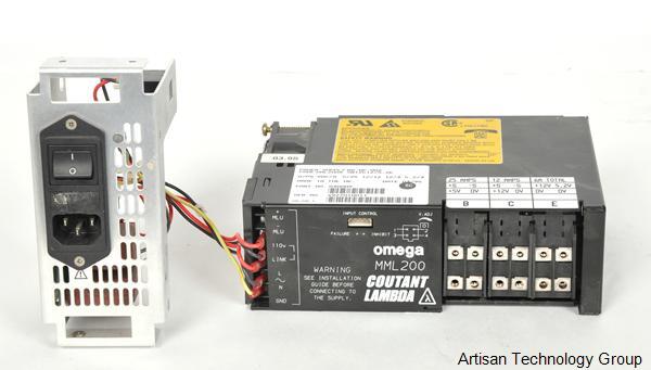

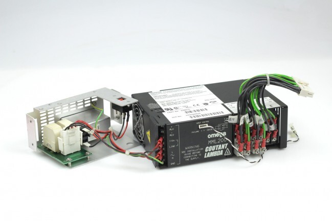

    Hi all.
    Recently I picked up a vintage HP 37717B communications analyzer which uses one of these MML200 Coutant power supplies. Needless to say the PSU is not working, and surprisingly there is apparently nothing available on the web regarding repairing one of these. No stories, no schematics, zilch!
    There are however many companies offering repair 'services', however I don't have the luxury of sending it off, so am intending to do the repair myself.
    I admit right now that I am no expert on smps repair, although I do have a grasp on the principle of the general design:- Filter, rectification, chopper, feedback etc.

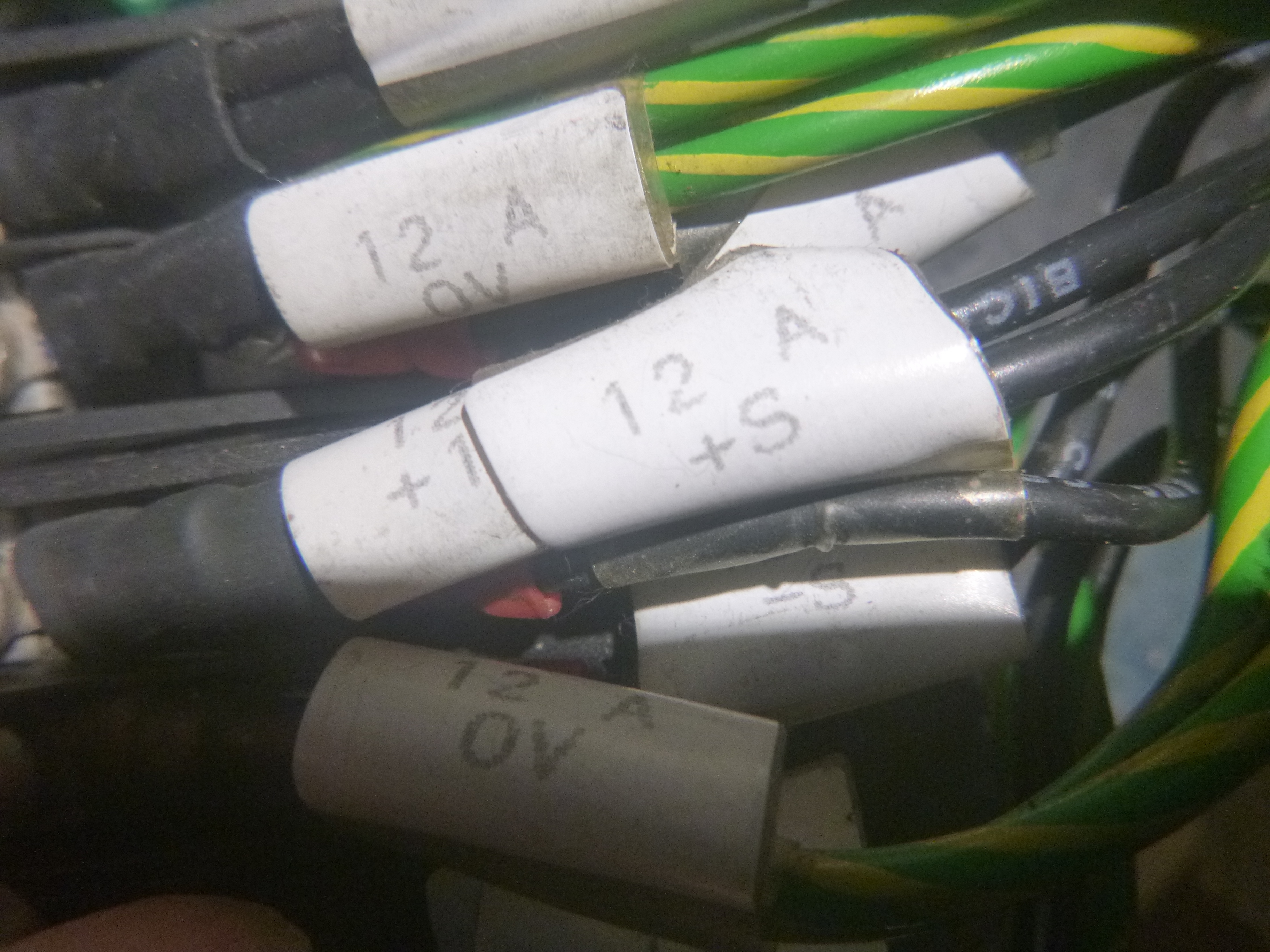

    The PSU was totally dead on all the outputs, so, when I first opened this PSU up I quickly located two RIFA caps and an BTA12-700B thyristor (crowbar protection?) which were bad. After replacing these there was somewhere around +6vDC on one of the outputs. I assumed that the unit was still bad (although perhaps this was perhaps a standby voltage?). The output comes from three separate modules which are labeled:
    6A - +12v, 0v and +5.2v, 0v.
    12A - +12v, 0v, +S and -S
    25A - +5v, +S, -S
    God only knows what the +S and -S are supposed to be?
    Anyway I thought it would help to see if we were getting any chopper signal on the gate of the single main 10A 900v 2SK1539 N-Channel FET.

        The +S and -S are the remote voltage sense lines

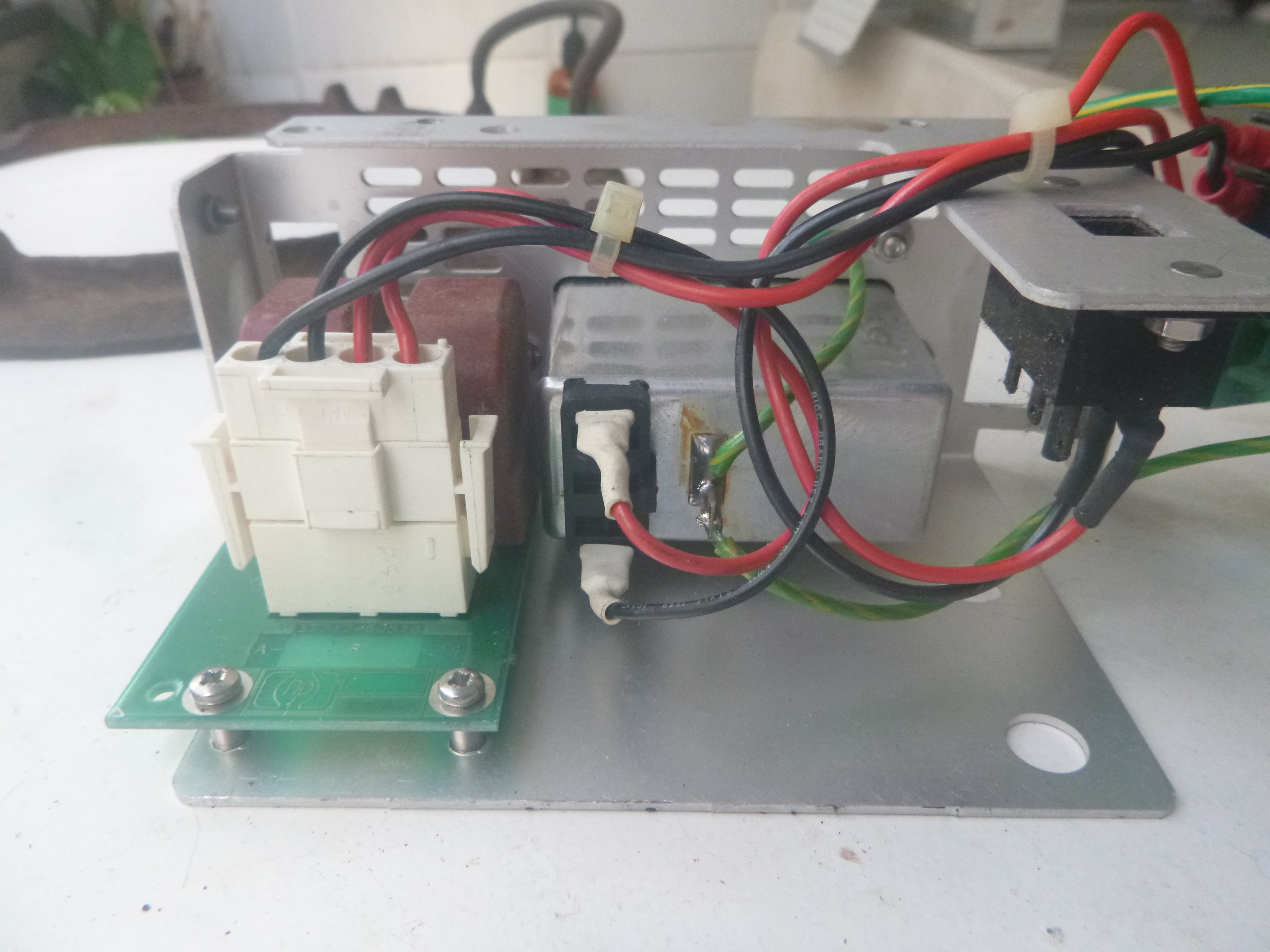

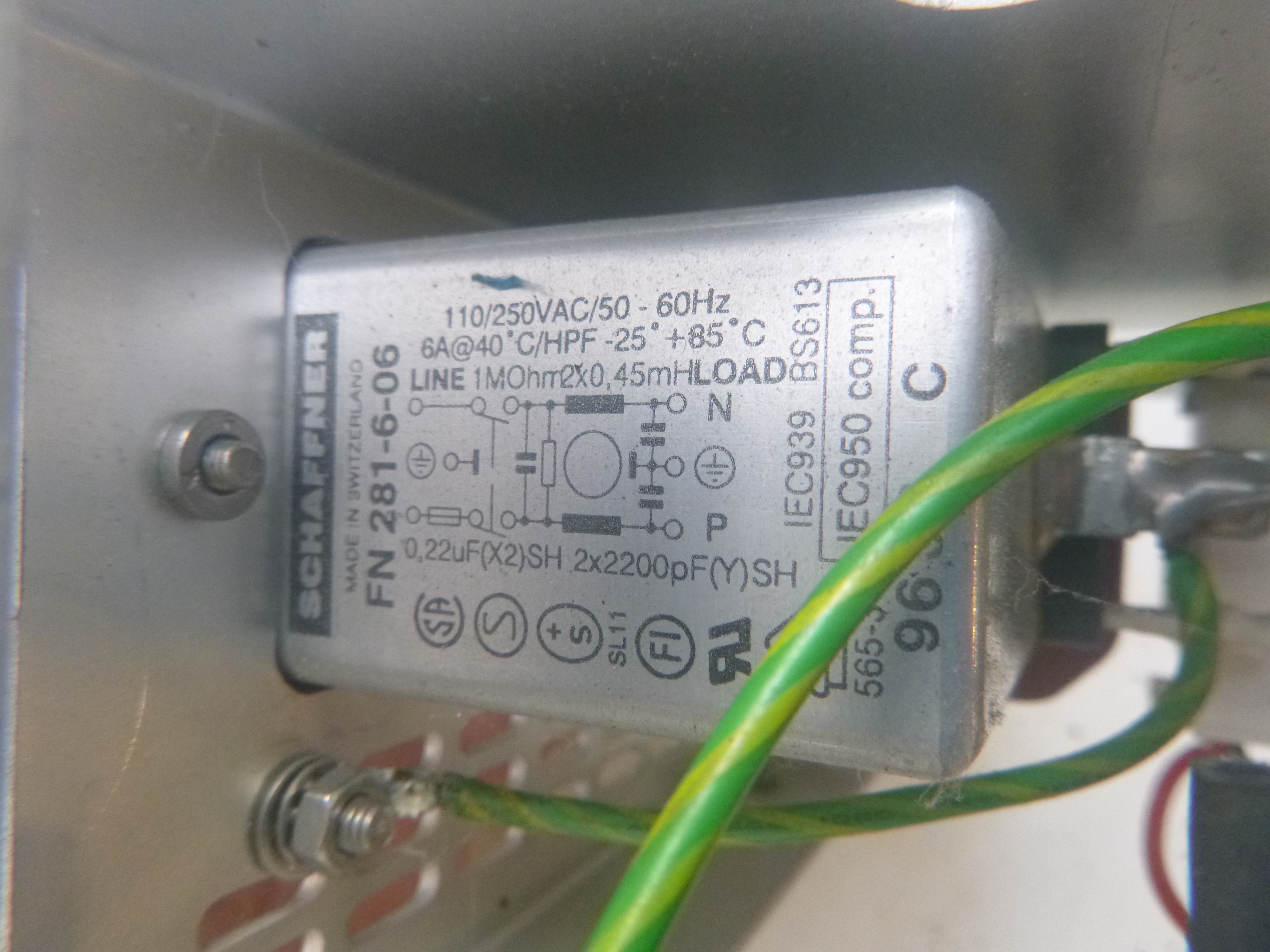

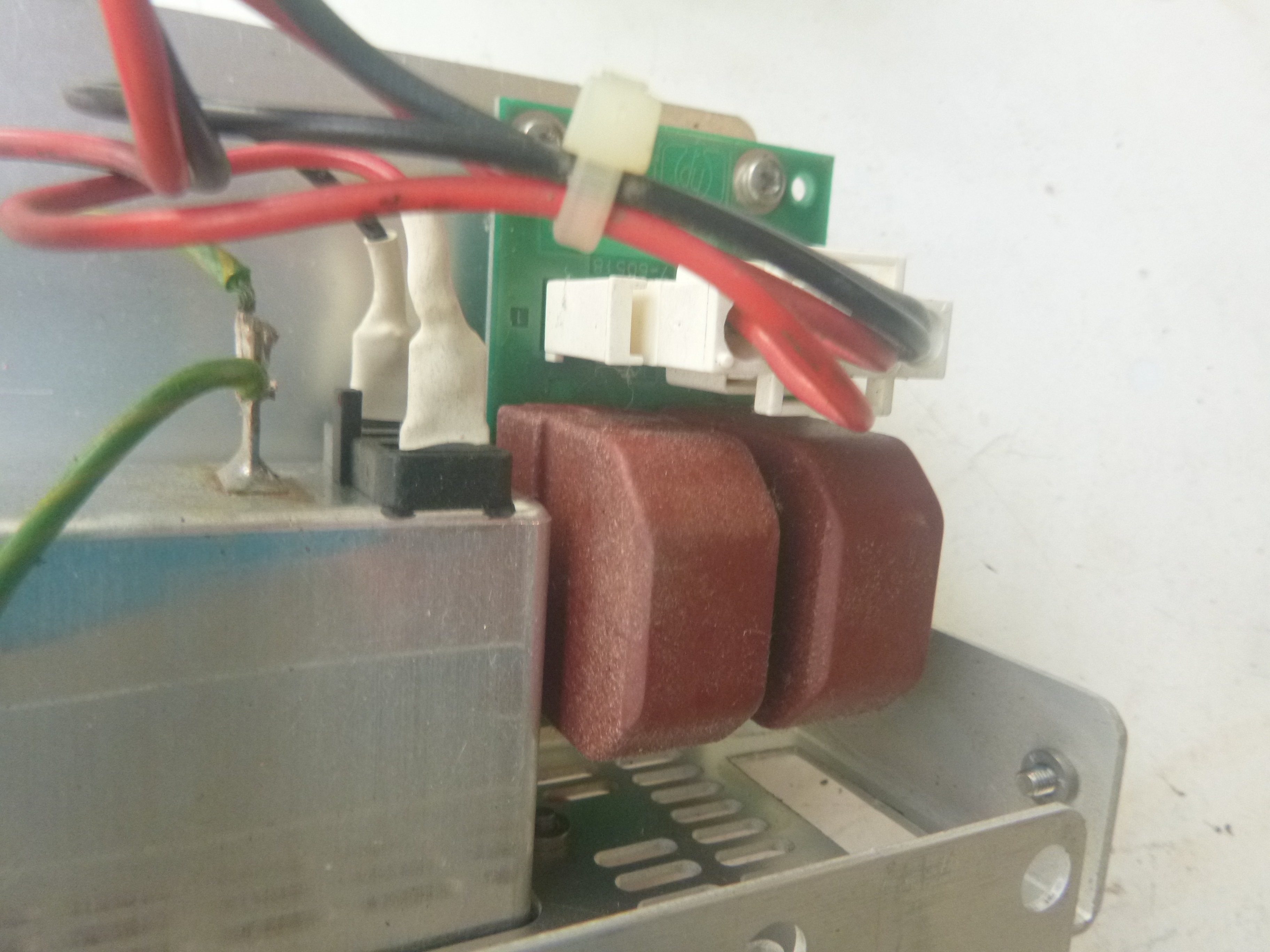

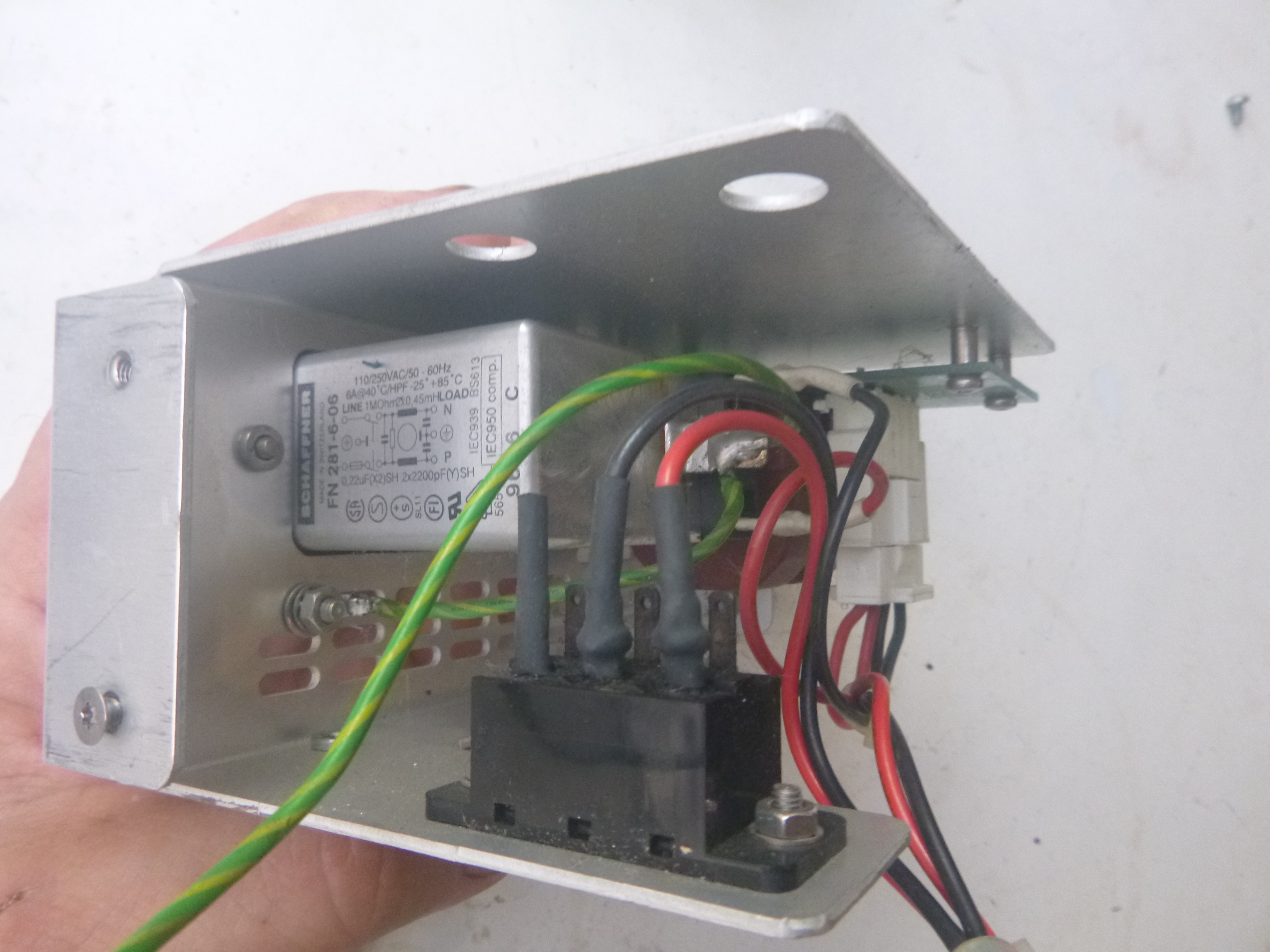

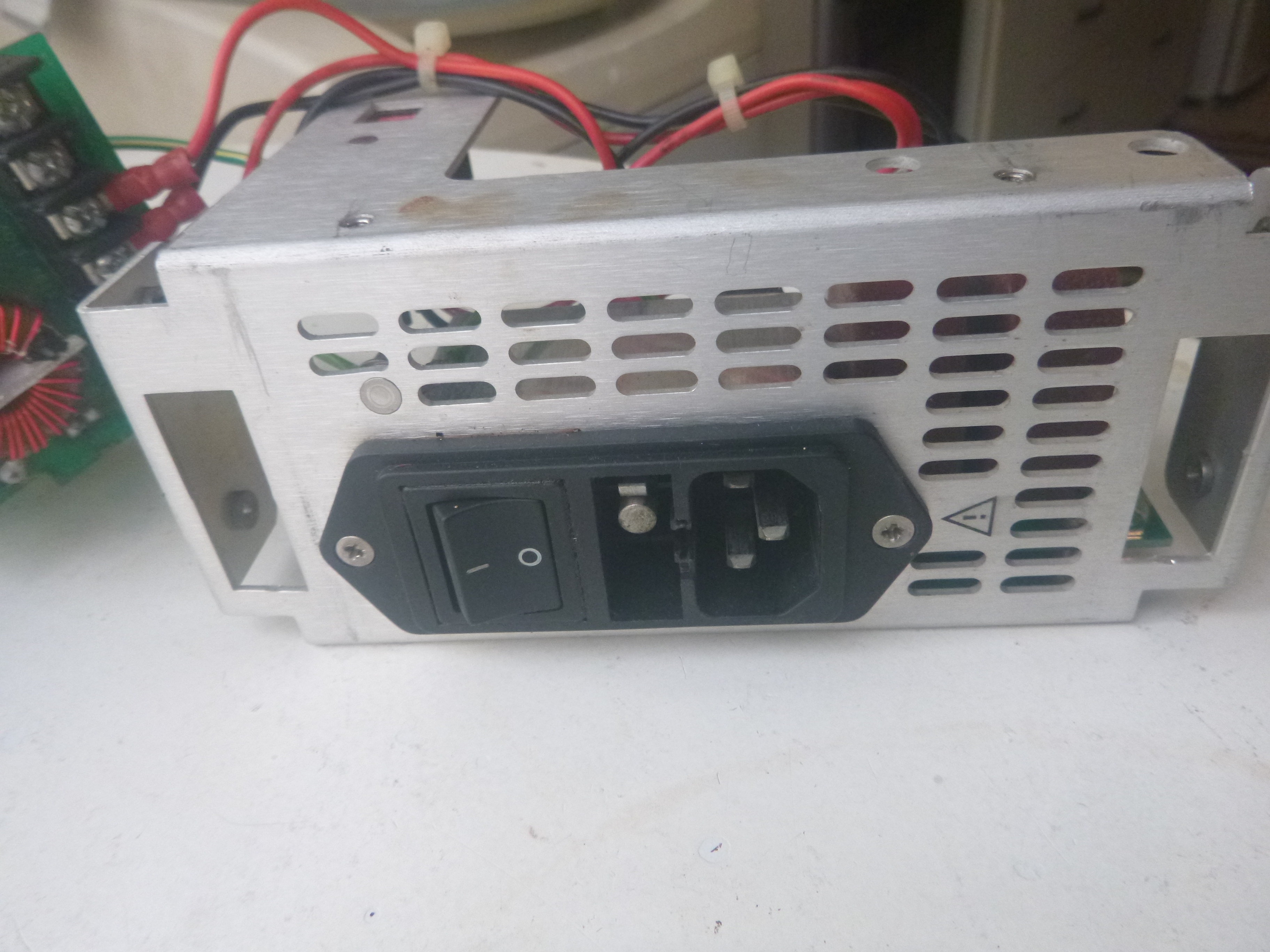

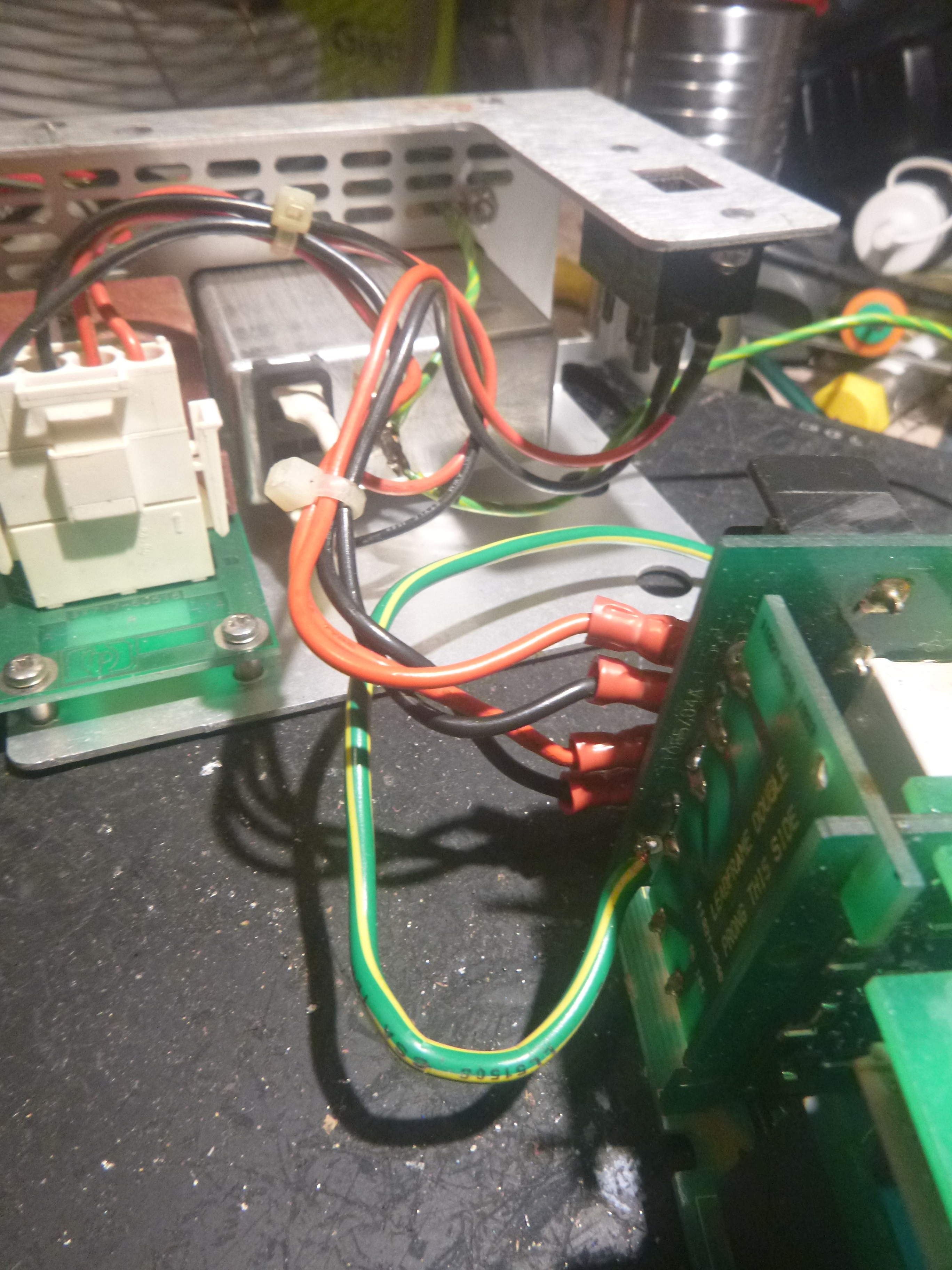

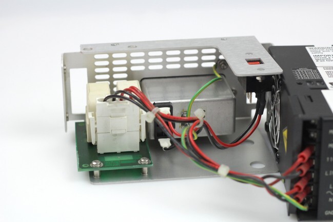

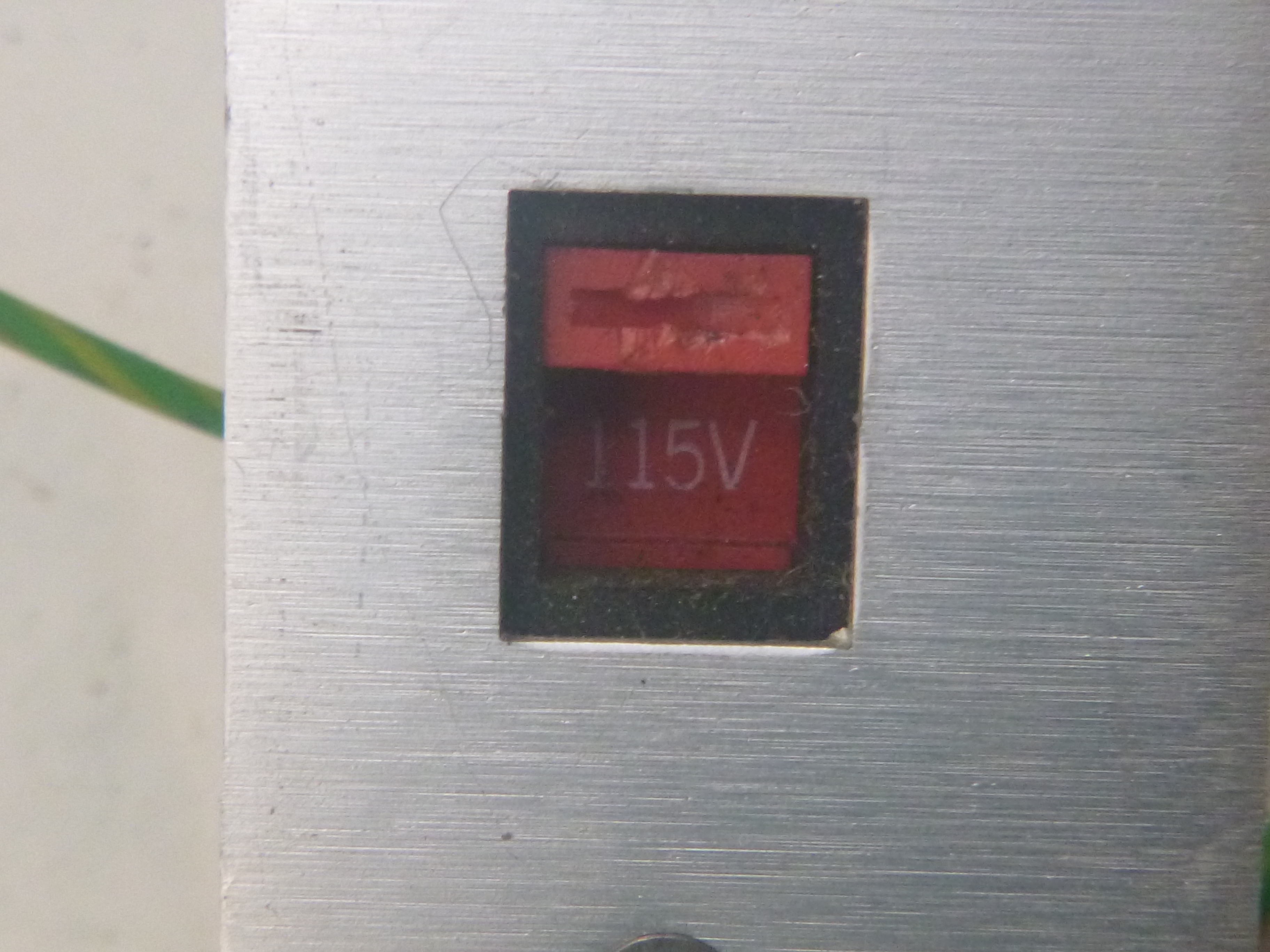

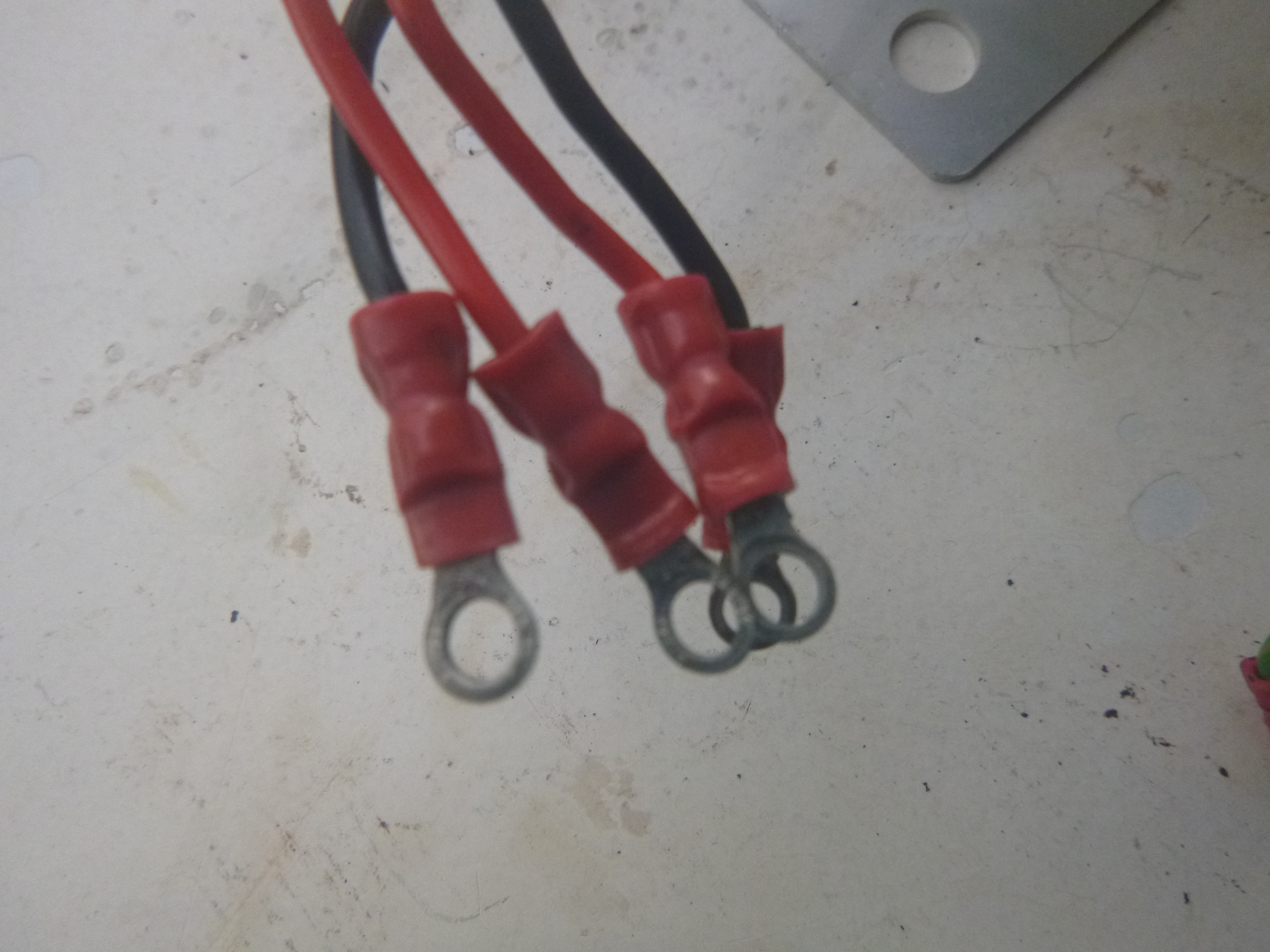

              When I collected the unit, the PSU was in two parts, as in the mains wires weren't connected. There are two red and two black, connecting to four pins. The only reference I could find was a photo online (see attachment), and I had taken it for granted that the two blacks and two lives were at the same potentials.
              After actually 'looking' at the wiring in the mains section today, it is clear that this is not the case, and it seems more than likely that some other damage was done to the input and filter section, but that is not such a major concern.
              It is really late here but I'll post some more pictures of the PSU mains input wiring tomorrow

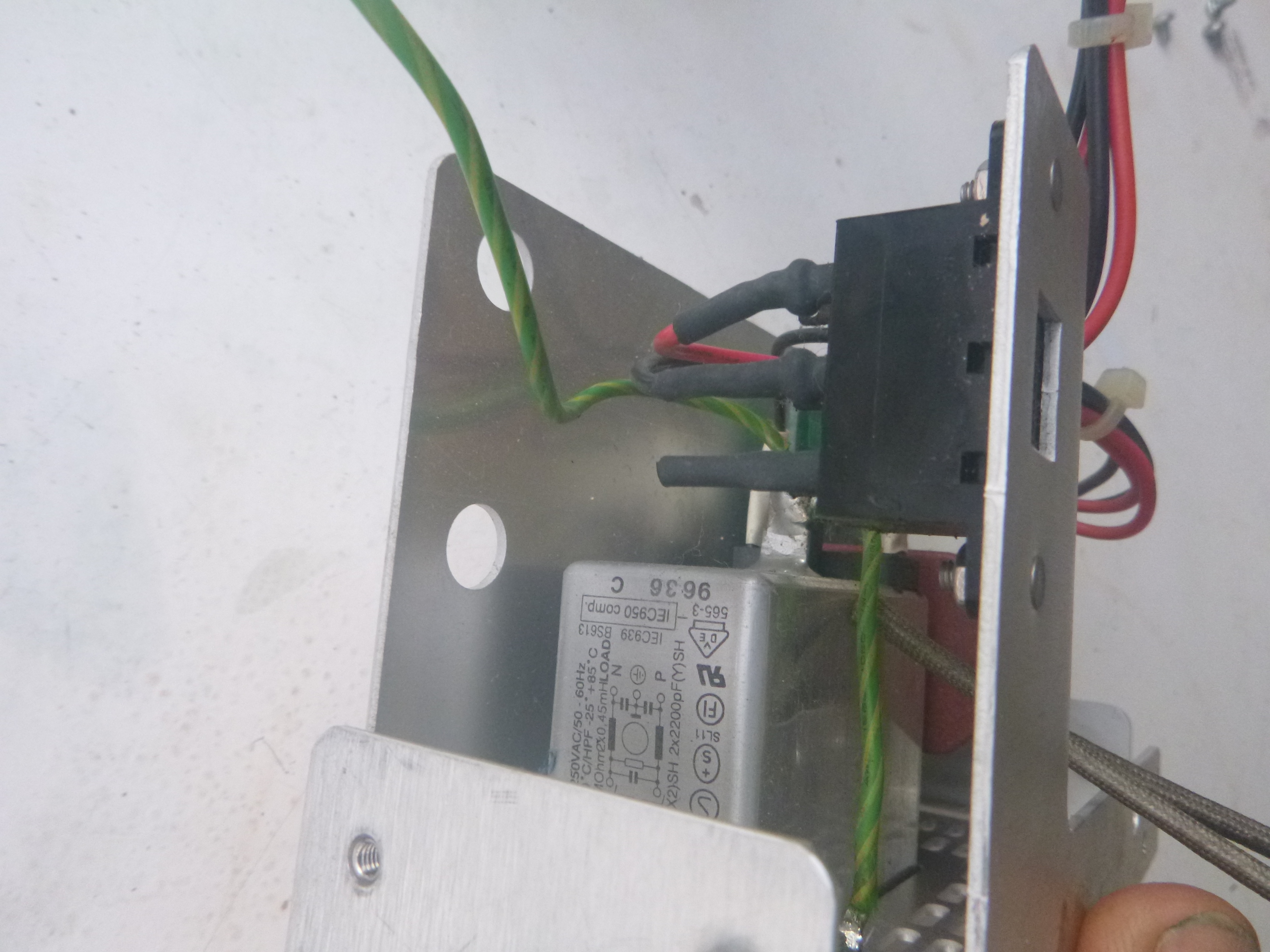

                The 110v and the Link terminals should connect to the 110/v220v slide switch, the ac line will connect to the L~N terminals The slide switch would be closed for 110vac operation and open for 220vac operation

                  Thank you R_J. This is info I could have done with last week.

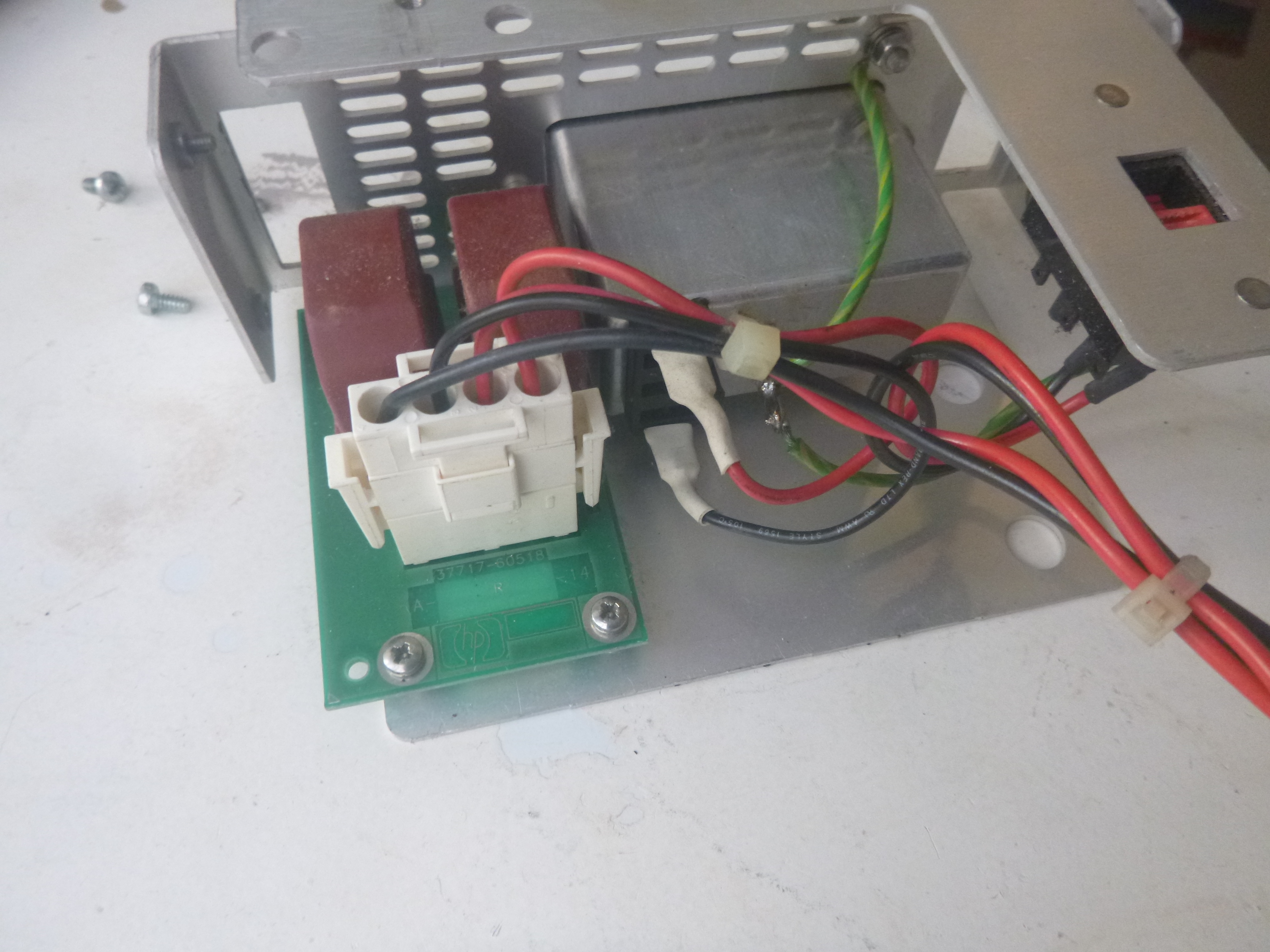

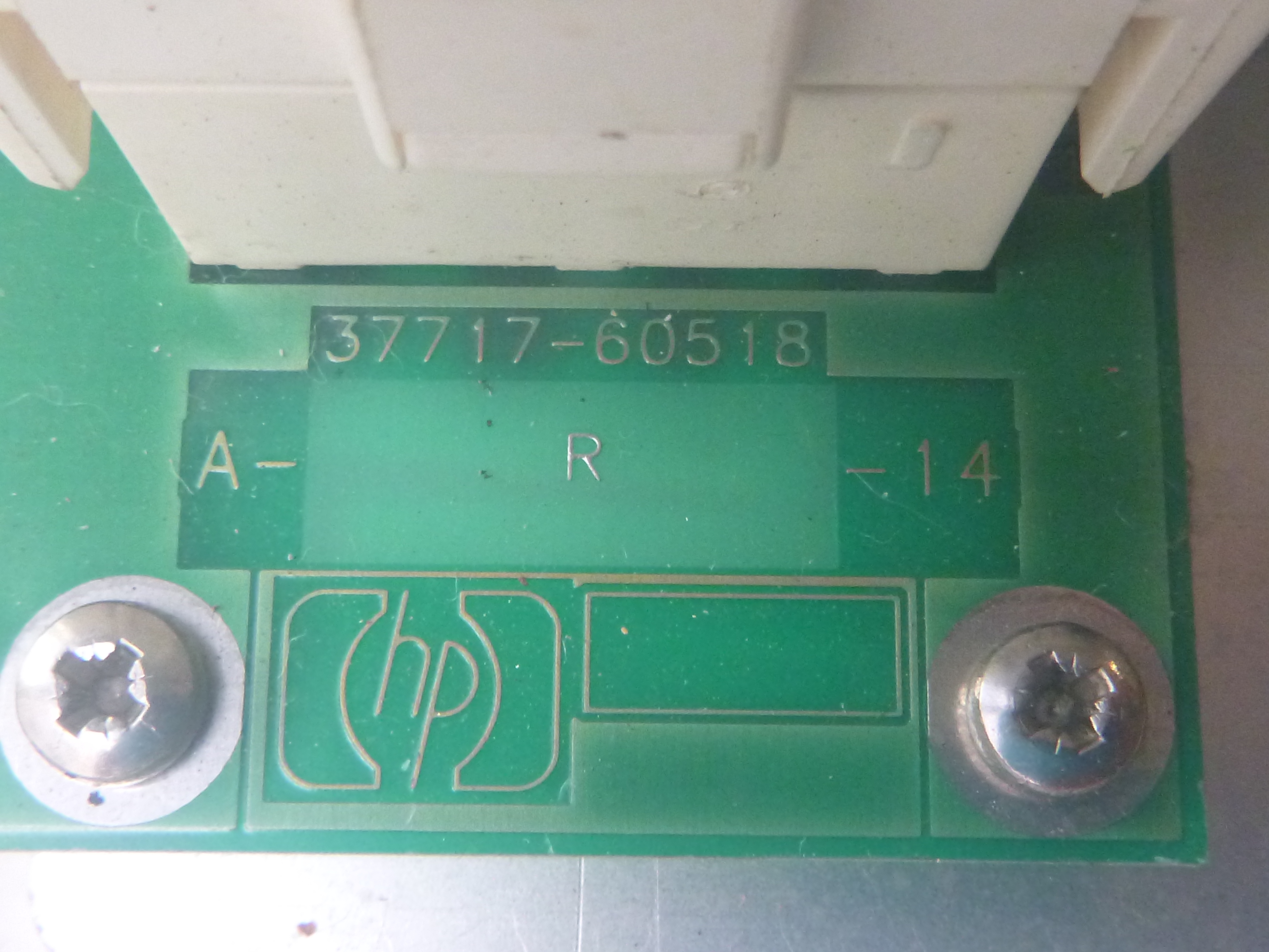

                  So, after taking a closer look, I can now see how it is supposed to be wired. Something I couldn't readily find when first searching for info, so hopefully this thread can serve as a reference to future techs.
                  It is as you mention above only there is no option for 220vac with this particular unit.
                  Pin 1. Earth
                  Pin 2. Neutral
                  Pin 3. Live
                  Pin 4. Link (connected directly to Pin 2 and wired to 115v voltage selector)
                  Pin 5. Link (return from voltage selector)
                  Pin 6. MLU - (I don't know what MLU is...? however neither are connected)
                  Pin 7. MLU +
                  I can also now see why I had trouble when I put it onto the bench as I didn't bother to bring the mains input section, only the smps section, which I connected it up incorrectly. Even though there are two red wires, one of them (Pin 5) is actually part of the Neutral line.
                  Without the AC input section, and with only a vague photo for reference, last week I assumed both reds in the photo were AC live and linked pin 3 to pin 5. This would explain why when I went back to the unit yesterday, there is no longer AC at the bridge rectifier.
                  But hey, we all live and learn, and with the unit only having been connected through a dimbulb, the damage should be minimal.
                  Below are some clearer photos of the AC input section, and I know I am no-one to tell Hewlett Packard how to make power supplies, although why they didn't use two wires of the same colour for the voltage selector 'Link' is beyond me...
                  Anyway, there is a week or more for the Fet to arrive so I'll get the SMPS input section back up and running and see where we are.
                    Yes there is, without the LINK connected it operates on 220v With the link connected it operates on 110v That is the poupous of that slide switch in picture 5. The two wires from the 115/230 slide switch connect directly to the LINK and 110v terminals In the 115v position it shorts 110v to link, in the 230v position the 110v and link terminals are not connected together
                    • Crystaleyes
                      • Sep 2021
                      • 493
                      • Brazil
                      They say that every day is a school day, and indeed you have just taught me something which I didn't know.
                      Thank you

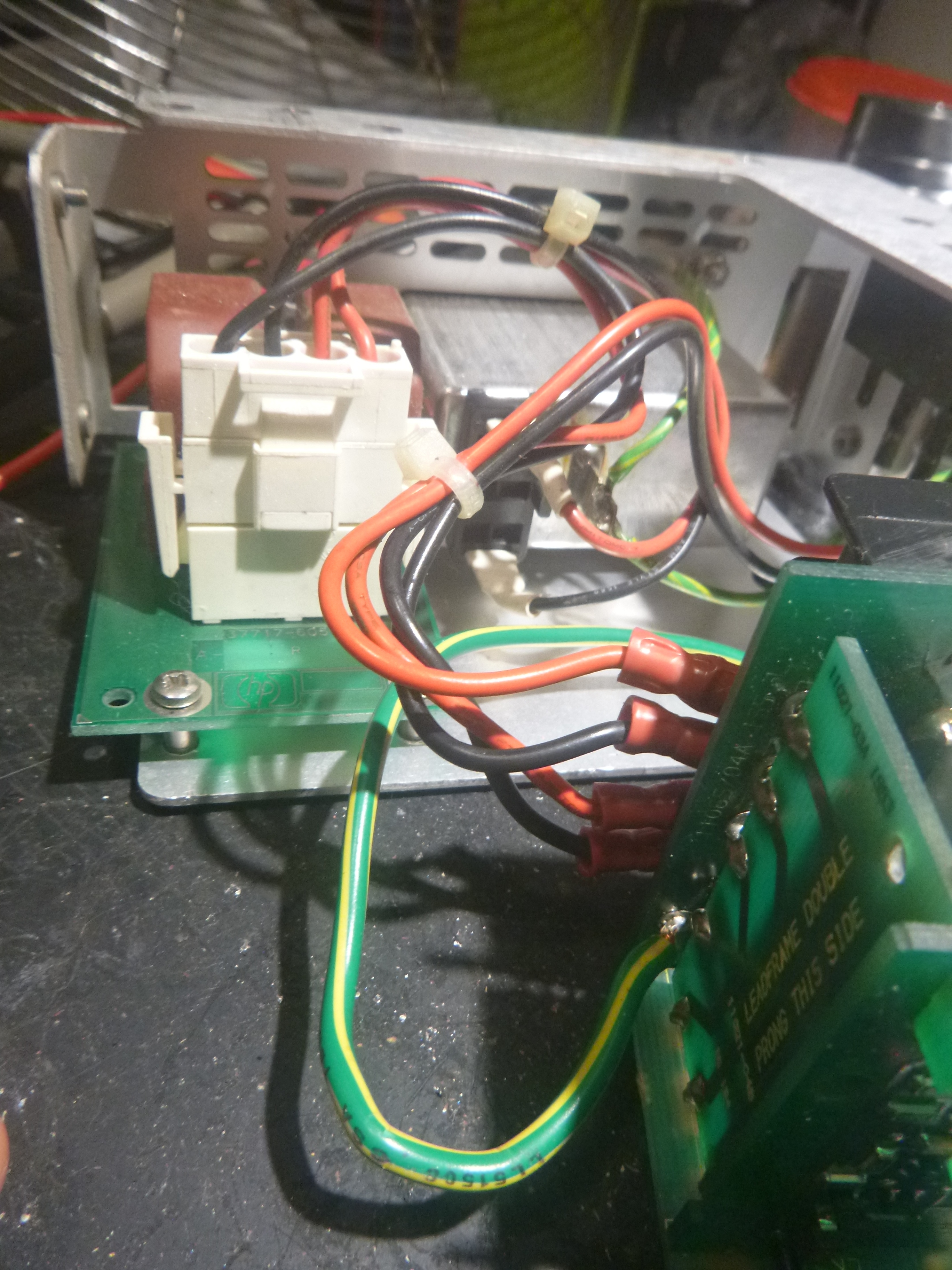

                        In the meantime, I got the input section sorted and once again have voltage on the Fet drain, but no trigger from the PWM onto the Gate.
                        As mentioned the two large filter caps don't allow access to the pwm controller so I'm thinking of when I next have a moment, connecting them off of the pcb via some long wires. Seems like the best option as I write this, and I do wanna see where the circuit is failing.

                                Regardless of dodgy agendas, the 1539 FET is now installed.
                                Considering that it is somewhat of a mission to reassemble all the PSU even before mounting it into the 37717B, does anyone have any suggestions as to how the PSU can be tested beforehand?
                                It's late here now but I'm thinking that there could/should be a standby circuit which will only activate the pwm chip with the correct signal.

                                    Good idea, athough unfortunately that didn't help in this case. No voltages are present on any of the ouput pins.
                                    A quick half-disassemble reveals that the Drain pin has voltage however nothing is triggering the Gate.
                                    This is half what I expected due to the unit needing to be 'switched on' although perhaps it is permanently on once the mains switch is closed?
                                    Someone with experience of these PSU's or some kind of schematic would be priceless here...
