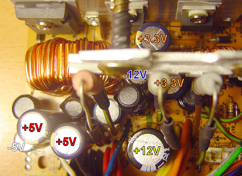

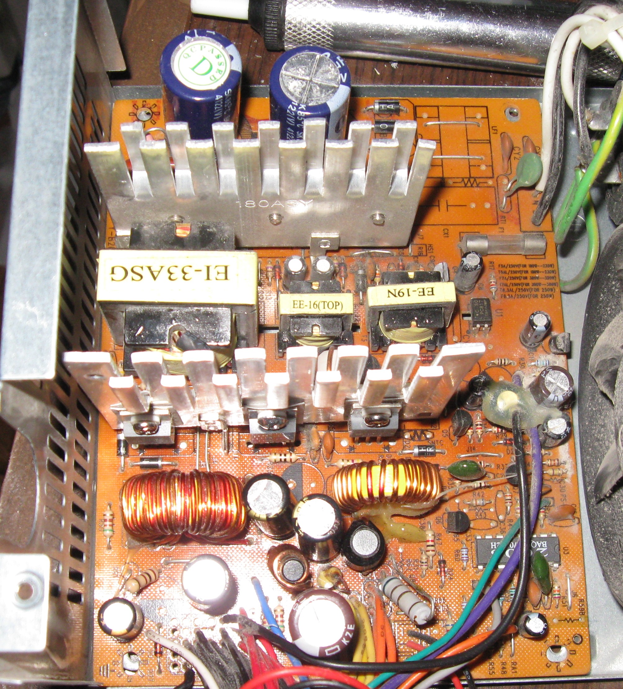

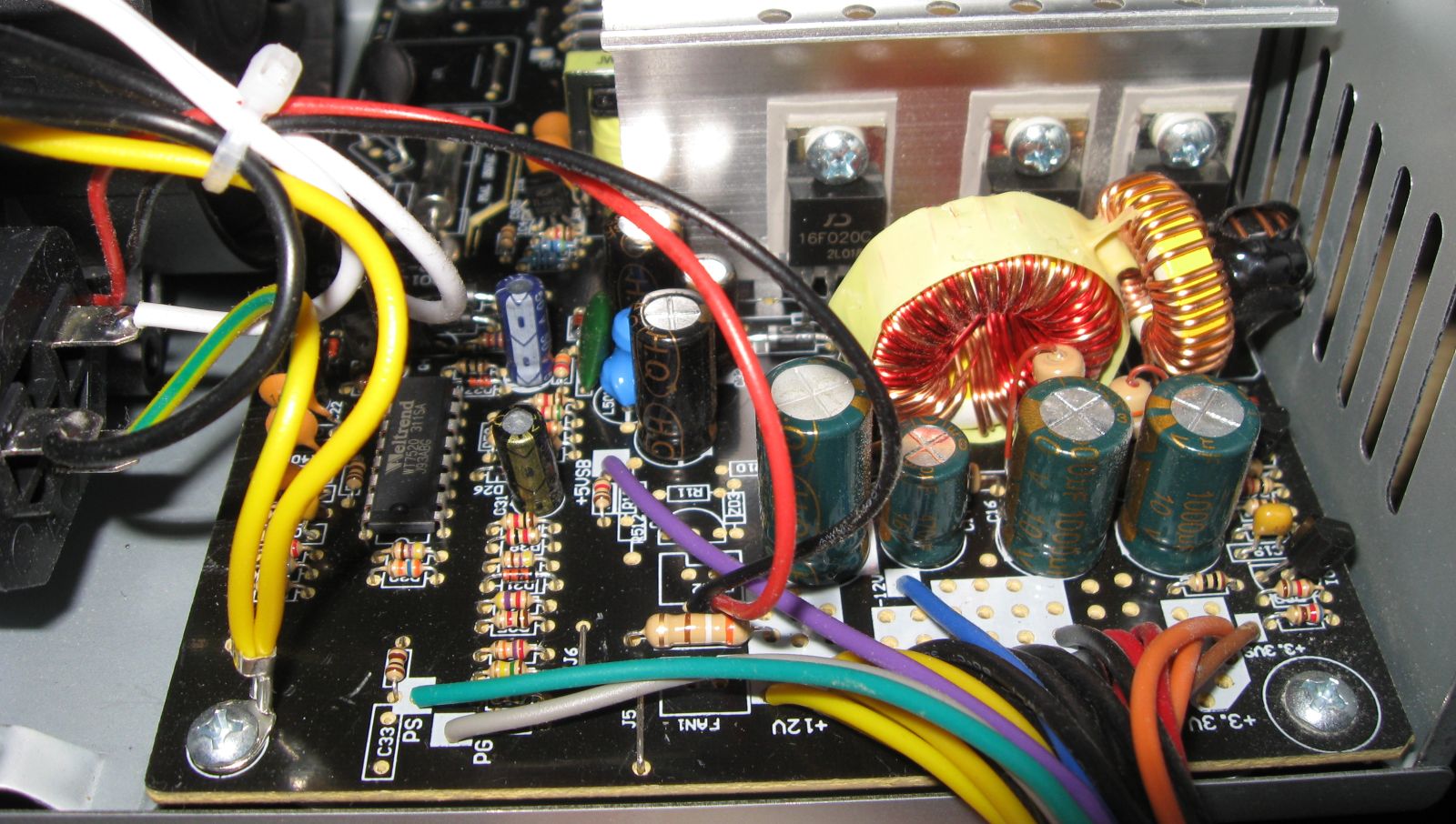

    Here's the deal.
    I posted this power supply in the psu discussion thread a while ago, it was in my sister's computer.. a Premier 400w psu:
    I realize it never will do 400w, maybe won't even do 200w as it is.
    It's currently sitting in my workbench pc, which is a cheap Sempron so it's unlikely it will even go over 100 watts.
    I'm thinking it could be decent 150-200w power supply if make some modifications to it.
    As it is right now, it has the two diode treatment for 12v, missing inductors for pi filter, small output capacitors, small input capacitors (fake uF value, only 220uF).

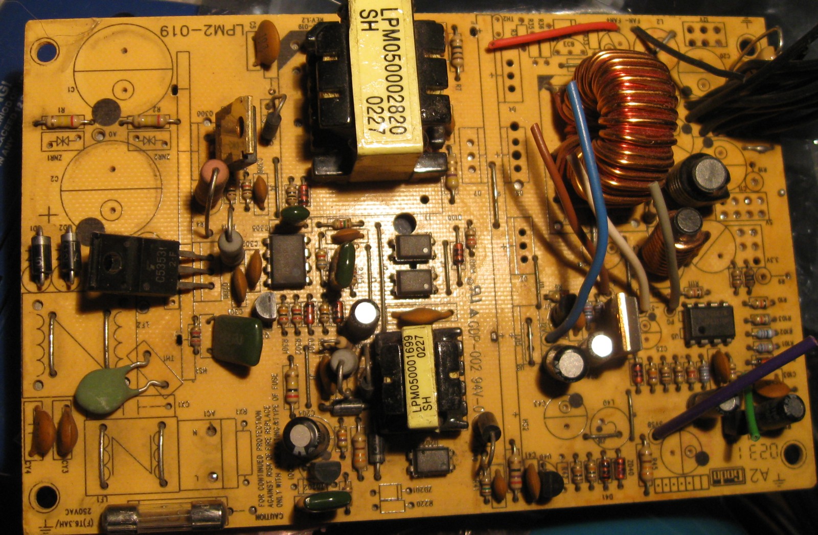

    I have the power supply that failed in my father's computer, which is this one presented here:
    https://www.badcaps.net/forum/showth...561#post400561
    If you don't feel like clicking on other pages, here's a summary:
    This one's even lousier, but I could transfer the input capacitors and replace the diodes on 12v with the actual diode pair chip (16a rated) and maybe also replace the diode pair for 3.3v (rated for 10a) with the second diode pair rated for 16a.
    So this would be a first.
    Now, I'd also like to add inductors and second capacitors just to smooth out the output a bit. Of course I'll increase the output capacitors a bit, maybe go with 1500-2200uF instead of 1000uF that's now installed.
    But I did some cleaning recently and trashed a lot of broken power supplies, so now the only donor boards I still have are some old AT ones that were rated for 150-250w :
    (continued in next post due to exceeding the image count)

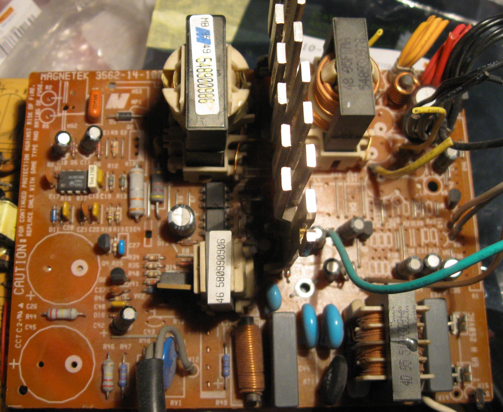

    Re: Improving a cheap, crappy power supply

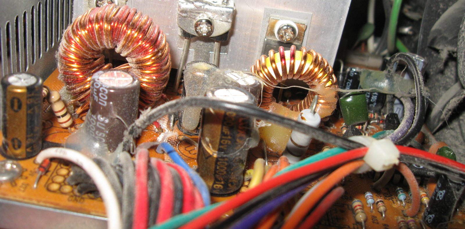

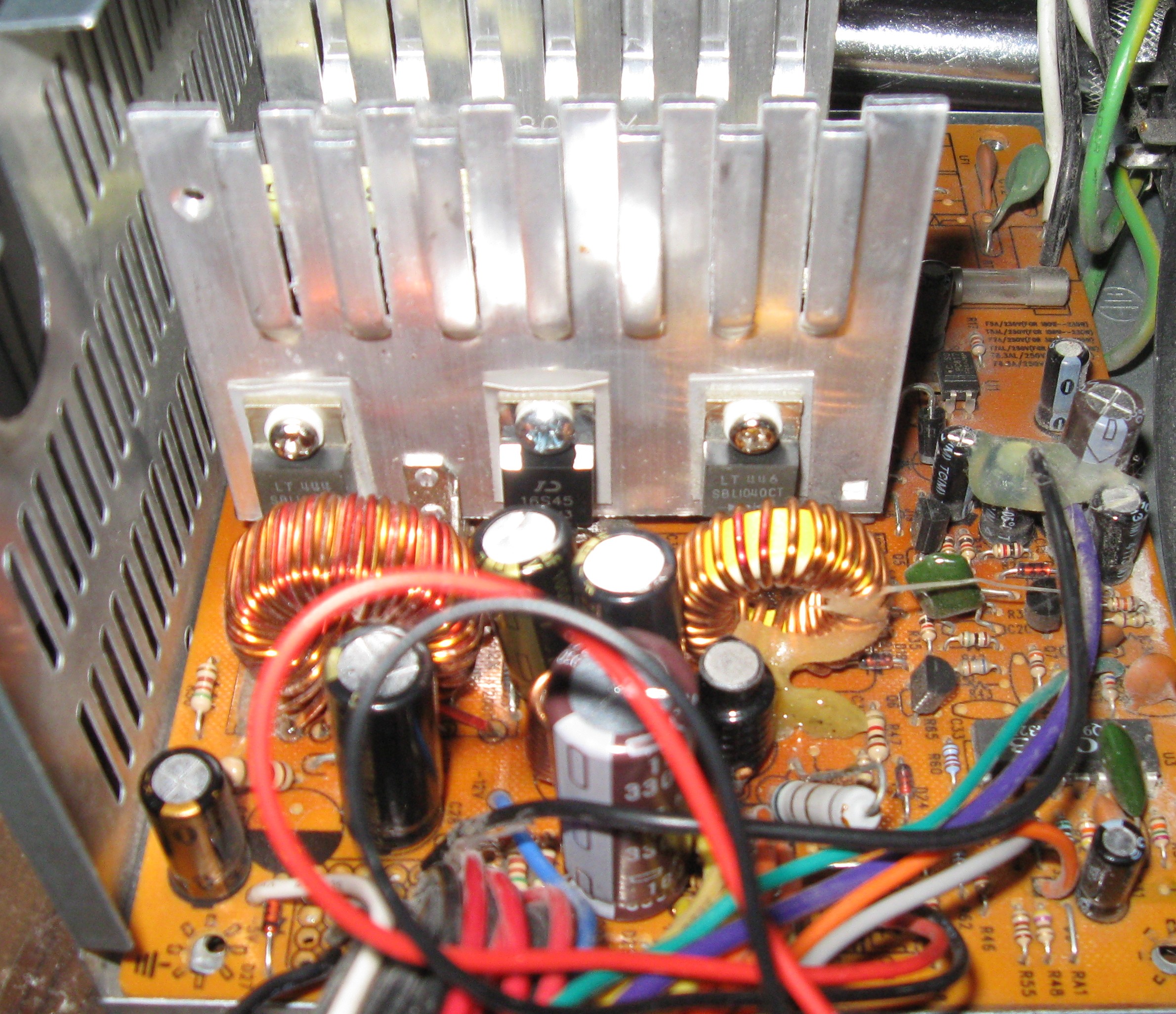

    This was an old 150-200w psu from a Siemens Nixdorf PC ( pentium 90, 16 edo ram etc) ... so about 1990 vintage.
    There's only one inductor and it's small so I don't think it would be suitable but I'm thinking if I should re-use the Cx and Cy capacitors. It's a really old power supply though, they could already be somewhat damaged... is it more dangerous than the benefits I wonder?
    This was from a 250w (on label) atx psu. Used the heatsinks for a project.
    This board has some inductors and they seem OK size wise, but I never really bothered to study how large inductors have to be, how much other parameters like resonance frequency, peak current etc matter...
    I'd like to ask, what are the risks if these inductors are undersized or in some ways not suitable for the power supply?
    If I get some improvements with the inductors and replacements I mentioned in previous post, I was thinking if it's worth replacing the primary rectifer diodes and maybe the 5vSB diode with some ultra fast 800v/3a UF3006 diodes.
    It's not like I'm going to use the power supply for anything serious, but hey, as long as I have it open...

      Except for the Magnetek, all that stuff's junk. Well, the Magnetek is too, since you "borrowed" its parts. That was the one you should've saved...
      No heatsinks to speak of. Tiny output wires, with voltage drop "compensated" by a 3.3 sense, isn't going to cut it. Nearly no output filtering, no line filter- enjoy the RFI wiping out your radios.
      The worst of your problems isn't the "four diode treatment."

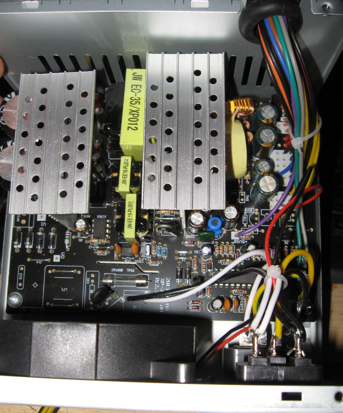

                Kudos for doing that. It isn't time or cost effective to improve these crap power supplies but it sure it fun! and they can become plenty reliable, more so than a modern design that uses Asia X/CapXon caps, etc. (In my opinion...) I did one this week that I might make a thread on.
                The one that was in yours dad's computer has potential. It has IC for 5VSB, and the main toroid is better than most of the PSU's in its category. The transformer looks small but I bet it'd do 250W since you're on 230V, not that I'd trust those heatsinks for that continuously though.

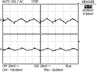

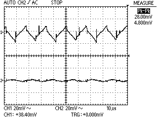

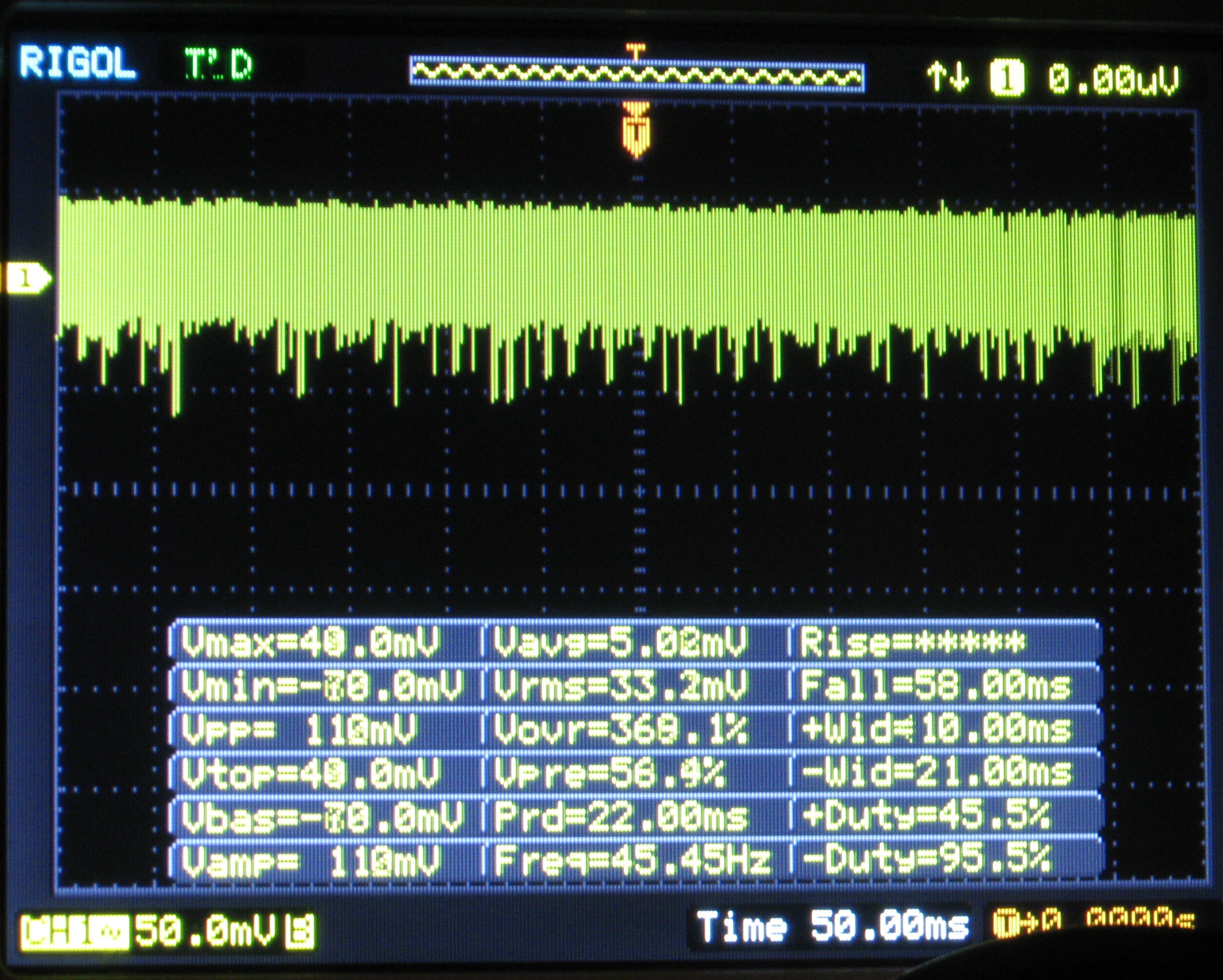

                    I had some spare time today to make some preliminary tests.
                    Put the constant current load on 5v to about 0.8 amps and a 20w lightbulb on 12v and tested the output with the oscilloscope:
                    3.3v no load (3.347v), 5v @ ~0.8a (5.085v), 12v @ ~ 20w (12.076 at start, 12.085v as it warmed up, after about 20 minutes)
                    Now keep in mind this is by no means scientific as in I didn't try to minimize as most as possible the ground lead on the probe, no 10uF at the tip of the probe, atx case open etc so yeah, doesn't matter that much.
                    The voltage ripple is reasonable, once there's some load. Without load on 12v, the 12v went up to 12.35v

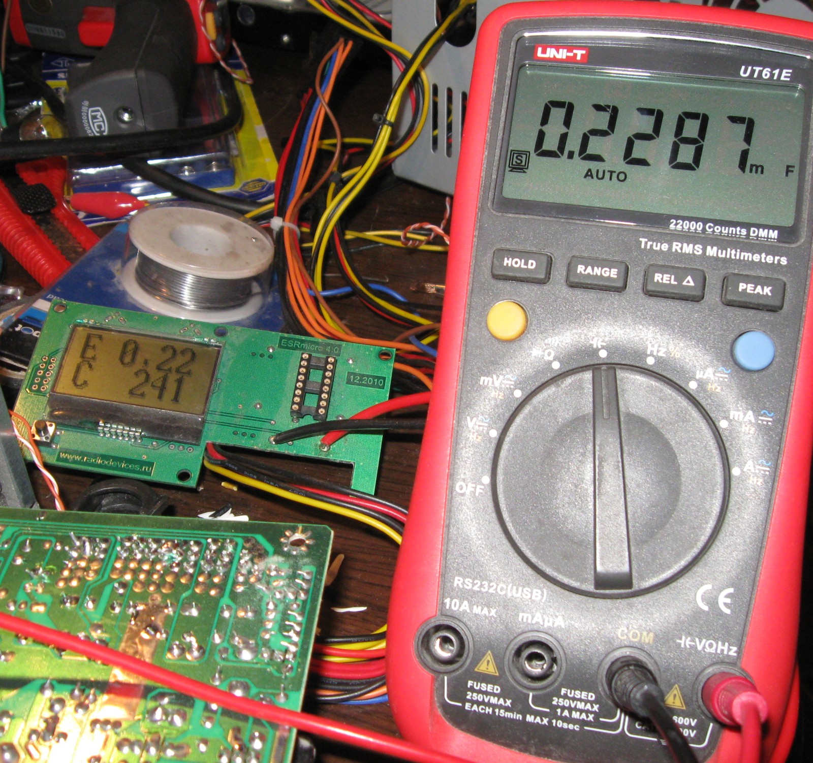

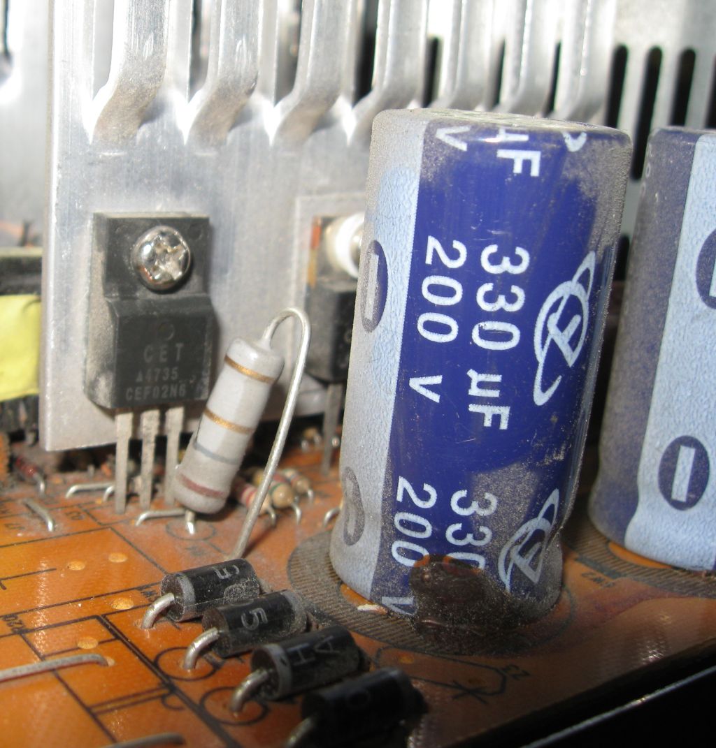

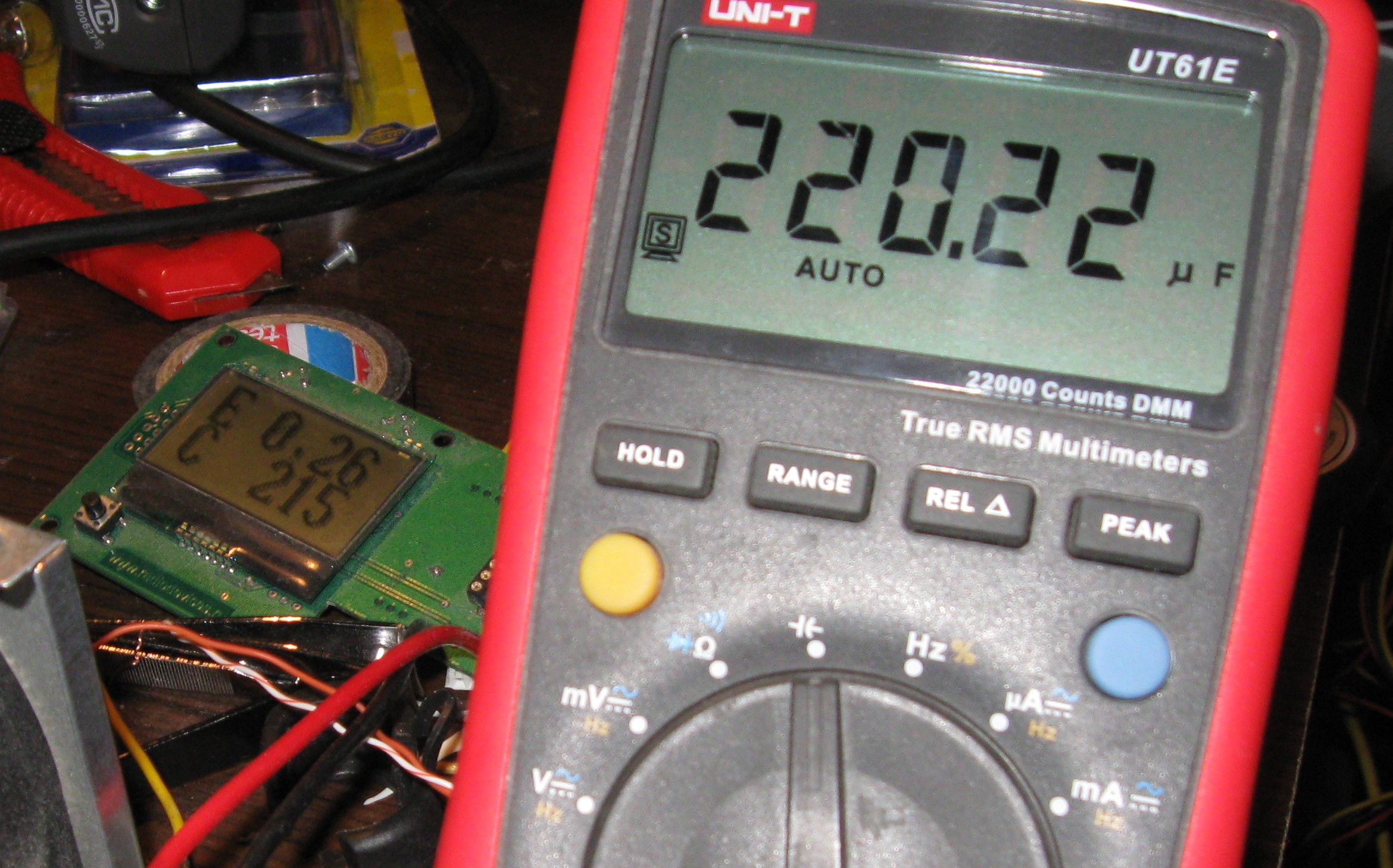

                    The primary capacitors on both power supply are fake, both say 330uF but they're actually 220uF.
                    The ones on this psu I want to improve are the YC brand, and the capacitance is about the same on both, with ESR also good on both:
                    The ones on the "donor" power supply are larger in diameter and they're rated for 105c compared to the 85c YC capacitors, but one shows as 247uF and the other at 228uF.
                    Honestly, I "trust" the YC capacitors more than these TS ones and I'll probably leave them in the original power supply.

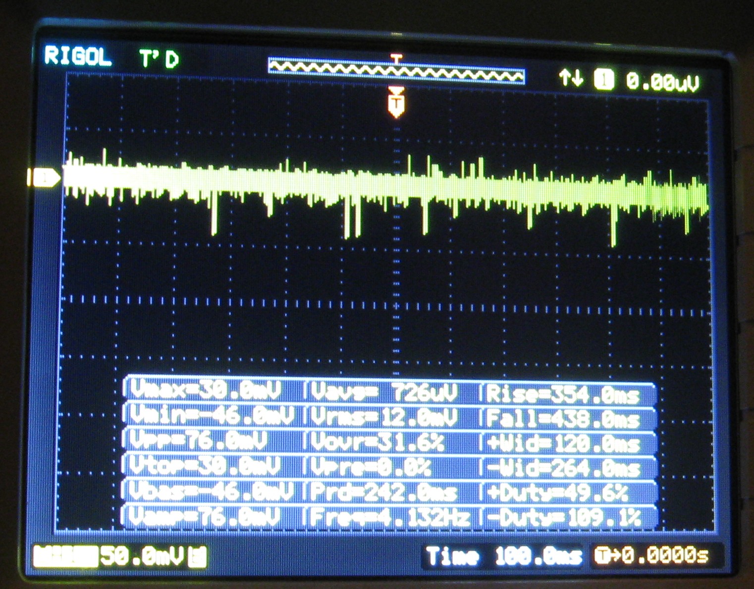

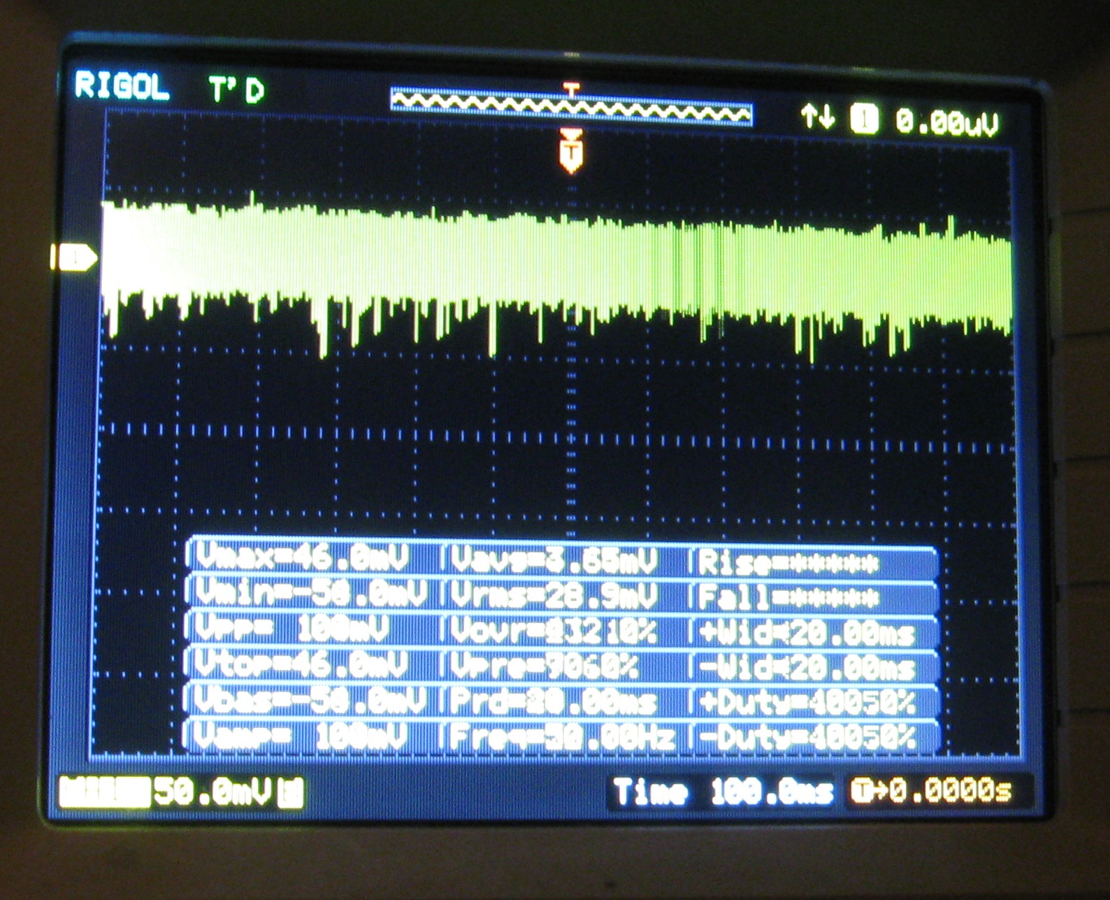

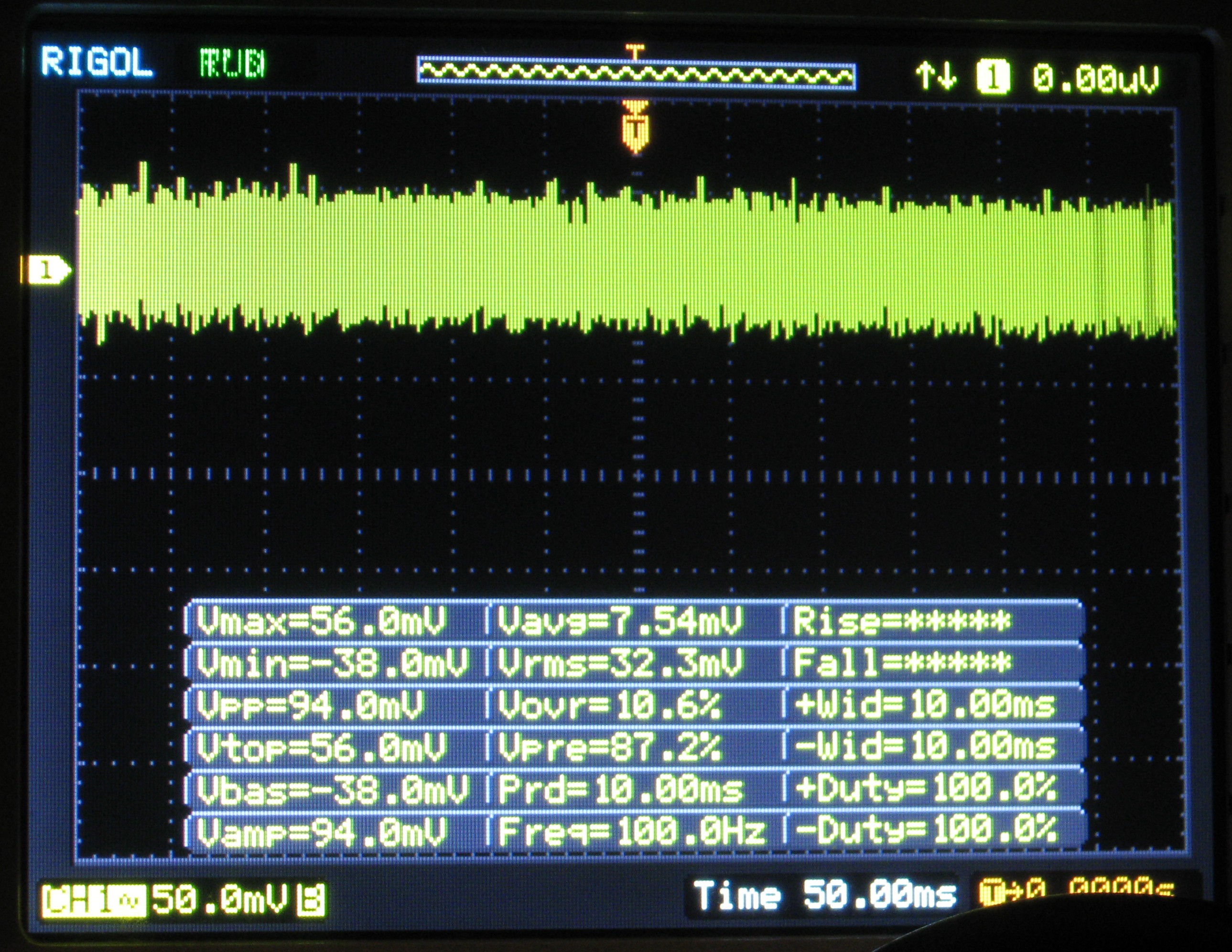

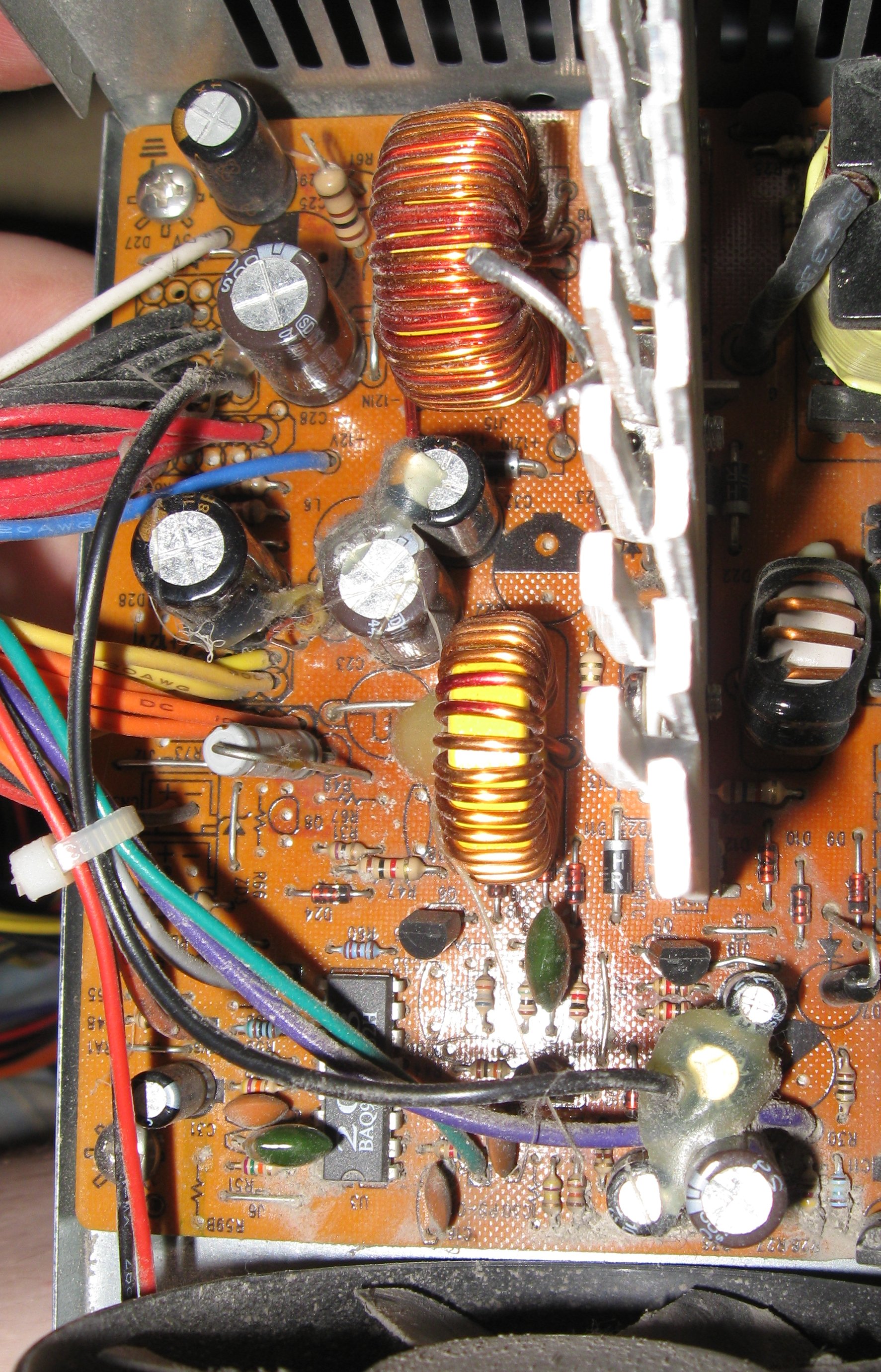

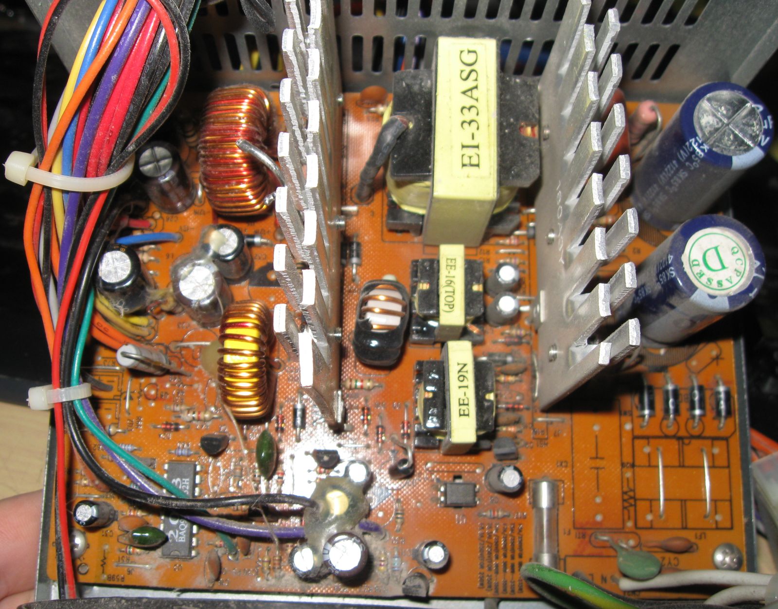

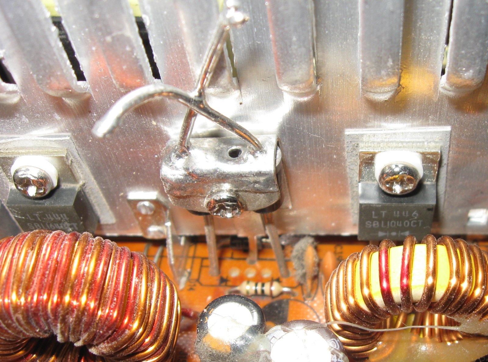

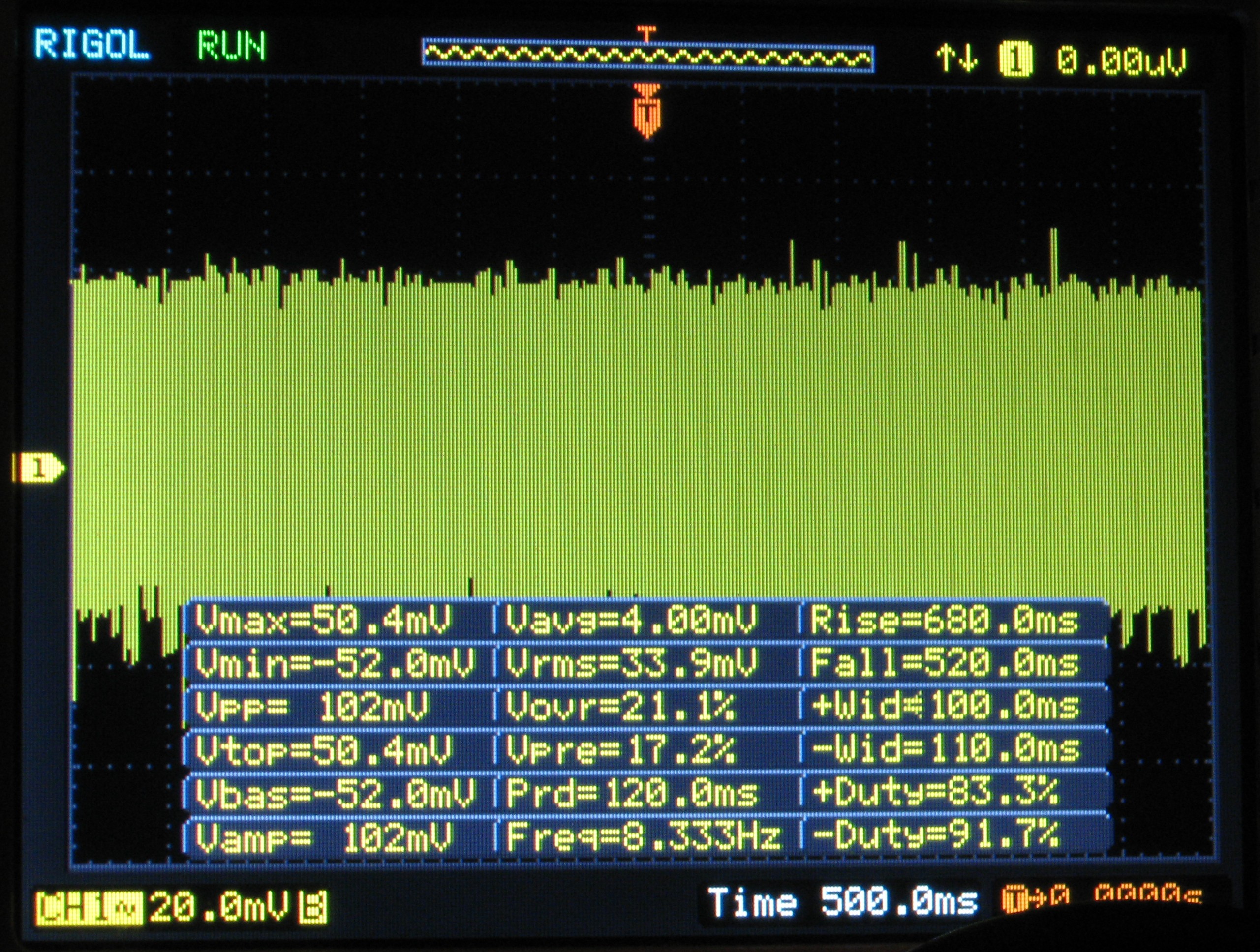

                              Another update.
                              Here's how the power supply looks now:
                              Top view:
                              Side view:
                              Measured the two inductors and they're both around 12-15uH. Had to use the dremel to thin the leads a bit but they eventually got in. They're on the 5v and 12v rails.
                              Replaced the two diodes (FR302, 3A each, 70v max, fast recovery) that were driving the 12v with the 16s45 recovered from the psu that died in my father's computer. That one's 16a 45v and so on. Originally the diodes weren't insulated from the heatsink, but I insulated the to-220 package just because I could.
                              470uF 16c Yc capacitor (TK) changed to 1000uF 16v Panasonic FM (12v rail, before inductor, stuck to 1000uF due to diameter and because it's probably more than enough already)
                              1000uF 16v G-LUXON LG changed to 3300uF 16v NCC KZE series (12v rail, after inductor)
                              2 x Su'scon 1000uF 10v changed to 2 x 2200uF 6.3v Panasonic FM (5v rail, before and after inductor)
                              Left the 470uF 10v capacitor where it is, it's for the -5v rail.. Not important enough to care.
                              Empty capacitor space by the 12v to-220 diode is probably for the 3.3v. Wasn't populated, probably going to put a 470-1000uF 10-16v on it.
                              3.357v, 5.095v, 12.179v <- no load
                              3.351v, 5.005v, 12.574v <- just 5v @ 0.8a load
                              3.351v, 5.037v, 12.379v <-5v @ 0.8a , 20w light bulb on 12v

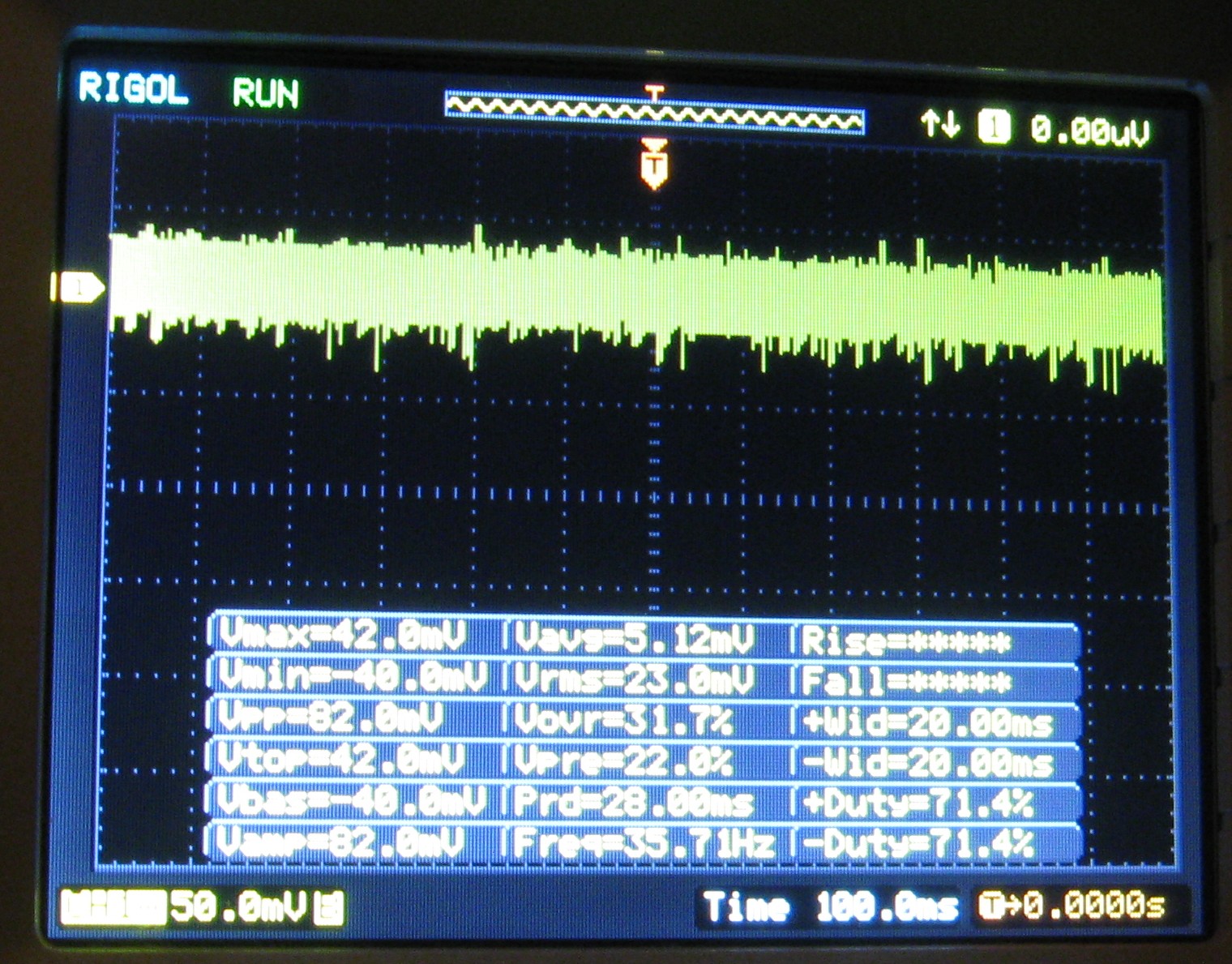

                              scope pictures with both 5v and 12v loaded as above (same as test in previous post for consistency).
                              3.3v / 5v / 12v
                              Picture quality kinda sucks because i turned off lights near the desk so that transformer in the lamp won't affect the scope.
                              Anyway, quite an improvement as you can see from the scope pictures. Now of course, the load i tested with is very small but it should be better at higher loads compared to how it was before.

                                As you say a noticeable improvement @ low loads, that should get even better @ higher loads .
                                Seems the output cap distribution in your PCB is different from my LC.
