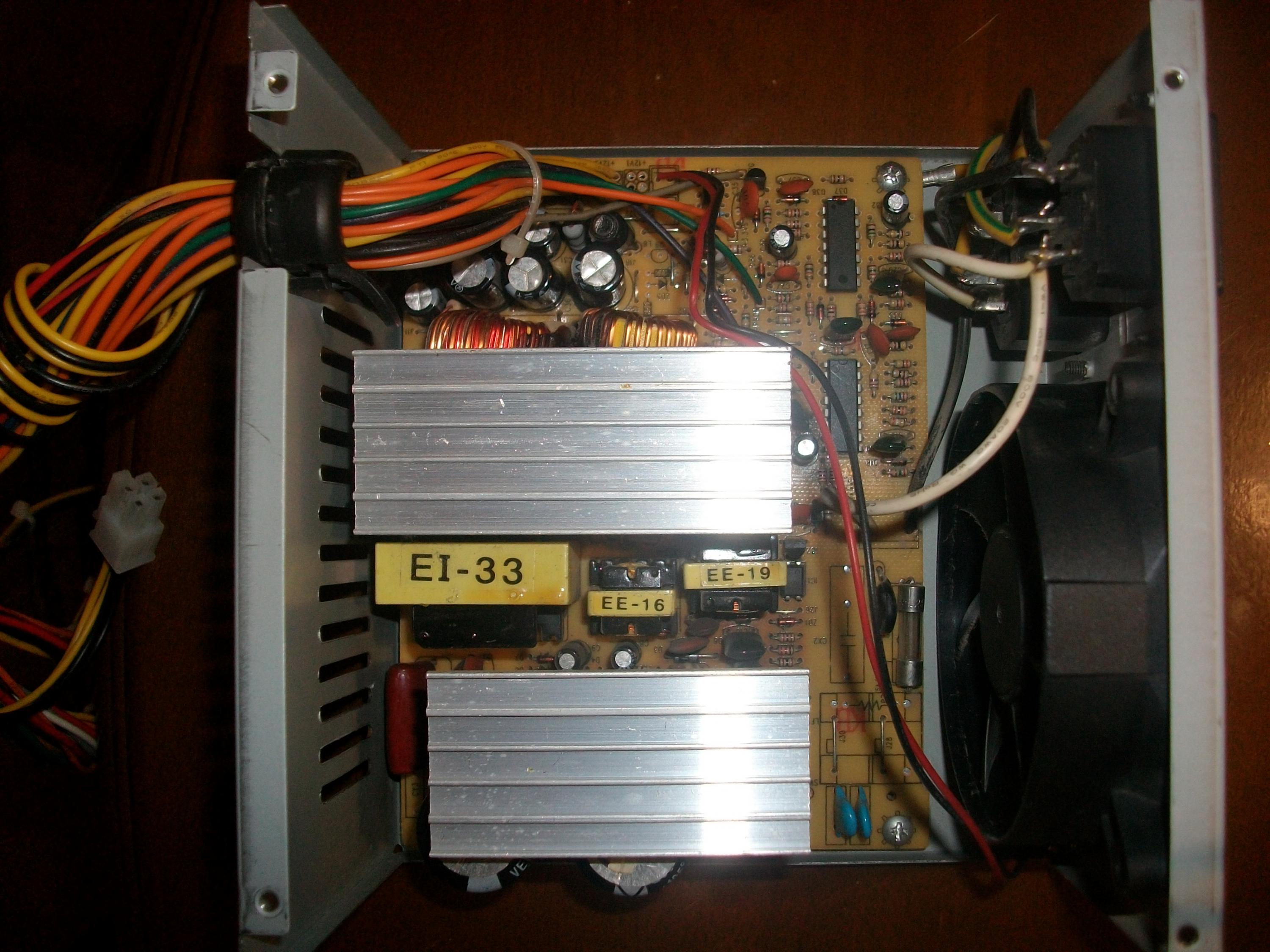

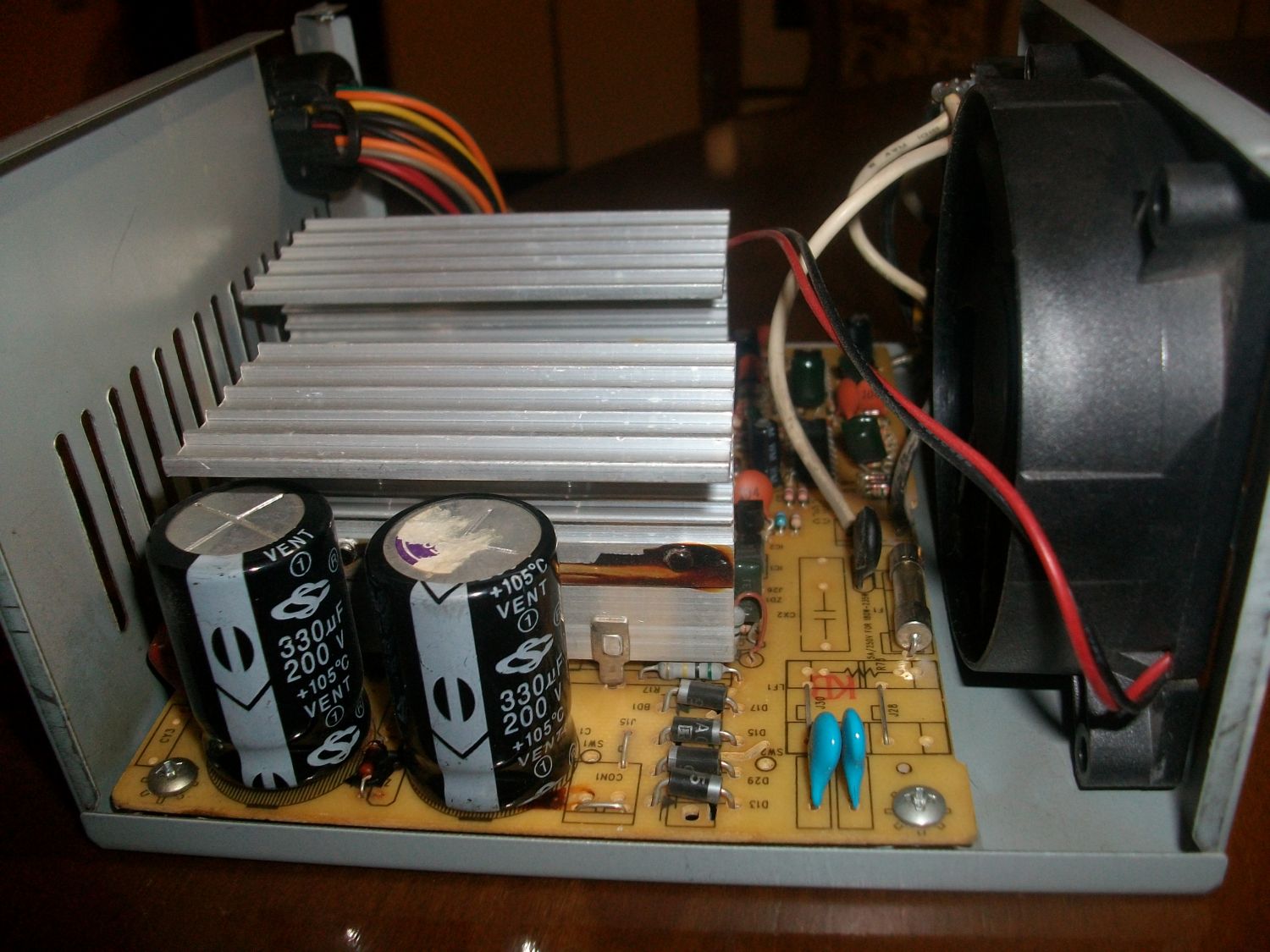

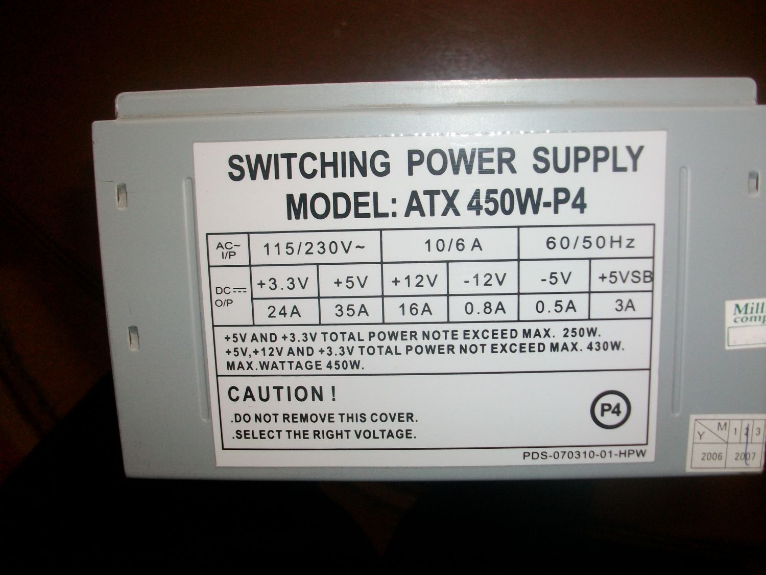

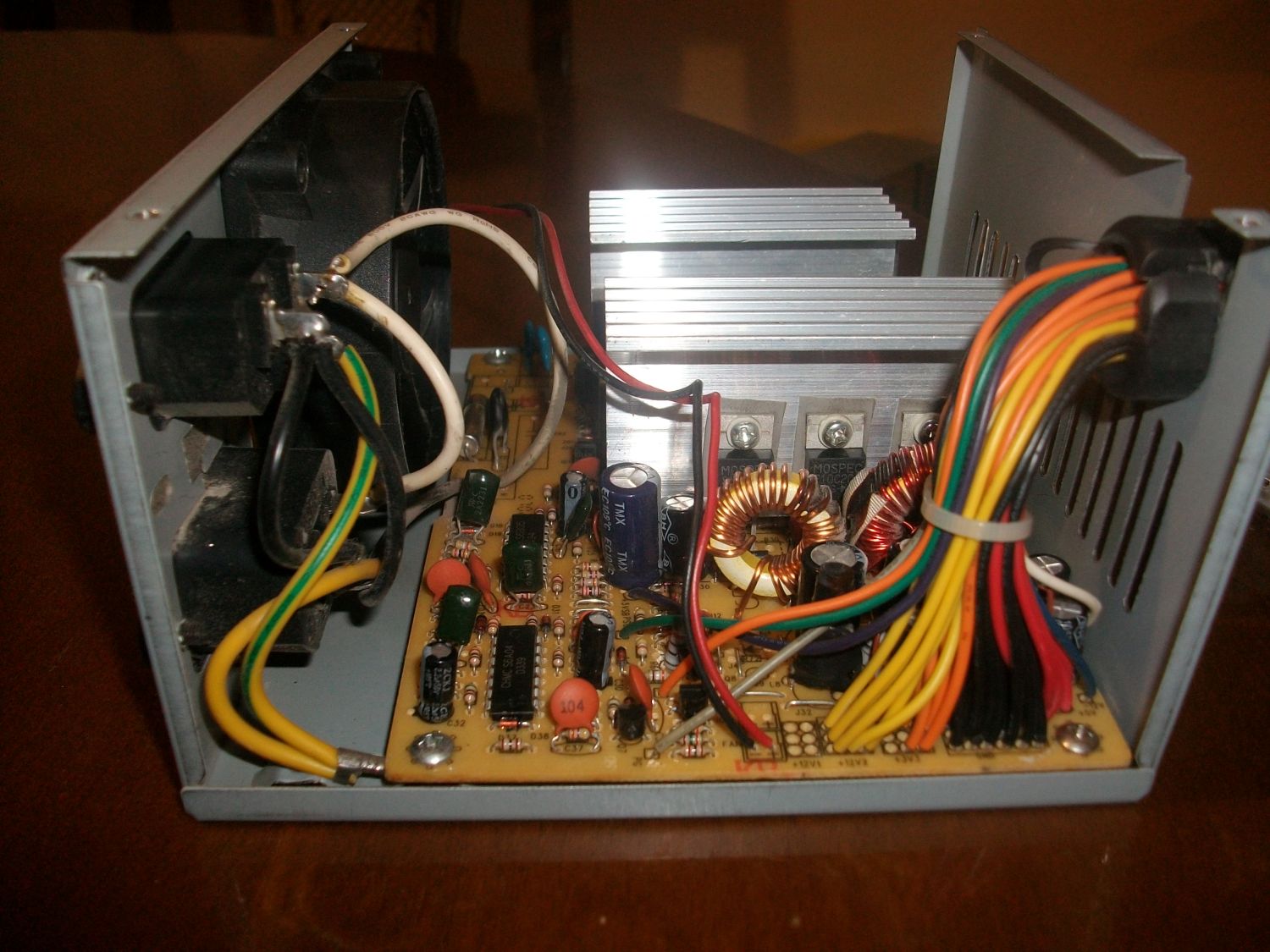

            First I have to apologize that I gave You wrong brand name.
            It is not Blueberry 500W ( I mixed up this PSU and Blueberry 500 W PSU, which is not working at all - doesnt have burned parts, just fuse burnes, when I replace fuse, it burnes again )
            This problematic psu has no name, and I think, it is custom ordered PSU.
            Images are attached and You can also see part number of controller IC.

                Instead of "custom ordered", I would venture "crap ordered". Wel, the others may expain better than me, but it seems to be an old design, suited for P3s, early p4s, AMD Athlon XPs, etc. From the looks of it, something about 200 to 250W tops.
                As you say it worked ok in a P3, and didn´t power in the MSI, I believe it is just a case of psu not being able ( by design ) to supply the necessary currents for the motherboard ( you didn´t state the exact model of MSI motherboard, but I suppose it is for some fairly recent cpu ( core quads, i3, i5, etc... )
                Basically, I would suggest you to install it in the p3 machine, and find a good , reputable brand for the newer machine.

                  Yes, this PSU is old, built in 2007 ( see first image )
                  But, last three years this PSU powered Athlon 3000+ on AM2 motherboard, with 2 GB ram and one hard drive and one DVDRW drive, without any problems
                  Because of that fact, I think this PSU is not suited just for P3, early P4, Athlon XPs, like You wrote, but it can power some modern systems
                  I think that problem is in one/some psu component/s that are failing under heavy load, like I wrote in first post, I just dont know which one/s

                      It is suited for weak things. With due respect, an Athlon 3000+ ( runs at 2.5 - 2.7Mhz, if I remember right ) is not a modern system.
                      And it has a weak 12V current rating. Considering the age of the thing, and some lies from the manufacturer in the label, we could stipulate that it is able to give about 10A in the 12V line. That would be too weak for most modern systems.

                        This thing lacks a proper input filter and has 330uF input caps. It i definitely a bad psu.

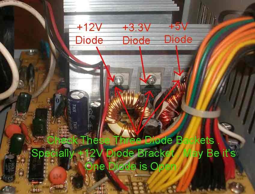

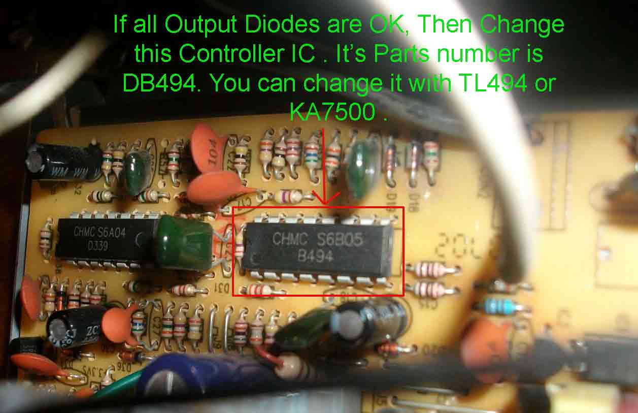

                          OK! Here we go ....... As you said when you are connecting 4 Pin Connectors that means +12V connector, then it is Load failing . I think, most probably +12V Diode bracket's one side is open . A diode bracket is consists of two diodes . One of the two diodes may be open . This is why +12V Diode bracket is failing to supply adequate Power when you are connecting 4 Pin Connector . Firstly Check that +12V Diode Bracket very carefully by removing from the PCB and be sure - Is it's one side is open or not . Then give a quick check to other +5V and +3.3V Brackets also .
                          If you found all outputs Diode Brackets are OK, then do this second job . In the controller section you have B494 Controller IC . If all outputs Diode Brackets are OK, then you have to change this B494 IC . You can use DB494/TL494/UV494/UVX494 anyone of these . You can use KA7500/KA7500B in substitute of B494 . Because TL494 and KA7500 are same .
                          Both steps Images are attached below . And show us what is the result ......

                                    In addition to the above: the other IC is a LM339. The combination TL494/LM339 was widely used in AT PSU's. They each cost just peanuts.
