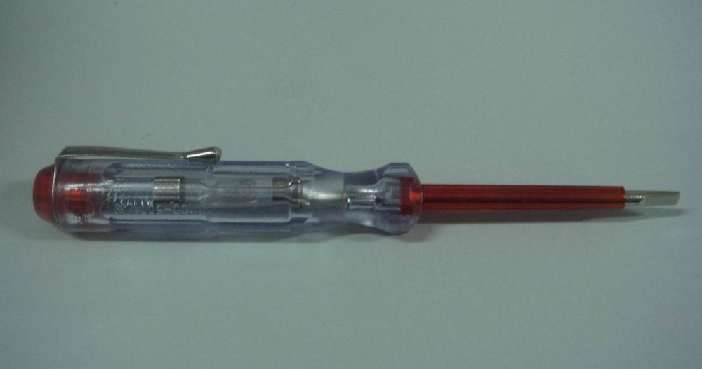

              #46
              Re: PSU works, but connected to motherboard does not
              Originally posted by ciki022
              Yes, my house installations have proper grounding, and I am using proper cords with ground connector ( PC power cords have the ground )
              But I dont know which one is live and which one neutral, and Schuko sockets can be inserted both ways ( probably the same is in Czech Republic )
              buy this pen if your town available sell it. when the lamp lit, there is LIVE.
              people surrounding my town use this to know where is the LIVE line to avoid shocked.

                #47
                Oh you are using the damned Schuko? We have grounding pin as frenchs have so you cannot plug that the other way around. It will work either way but you want to turn the phase on and off, otherwise there would be voltage all the way up to the system, only curret won't flow because of neutal turned off, but you may close the circuit if you touch something.
