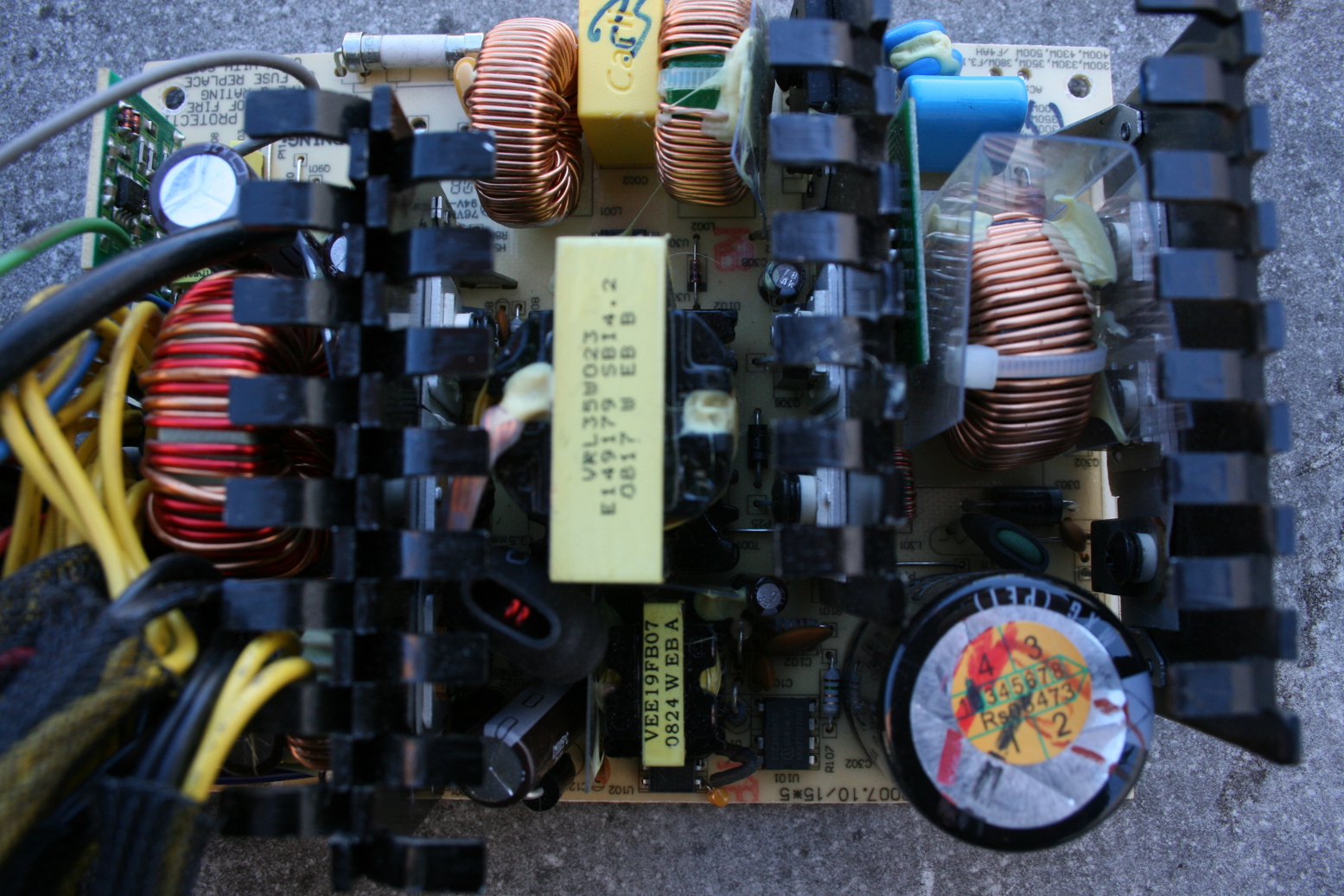

    Last night I noticed this SS-500GB started making a ticking sound. I made sure it wasn't the fan, then opened it up. I put a tube to my ear (aka redneck stethescope) and the sound appears to be coming from near the toroid by the primary cap. The caps all look OK to the eye. The primary is a Rubycon CE 330uF 450V. Most everything else is United Chemicon KZE series.
    The more load is on the power supply the faster the ticking. When I start the power supply with no load it ticks maybe two or three times per second, but it ticks much faster when the entire system is running.
    Any clues? Schematics? Advice? Thanks.

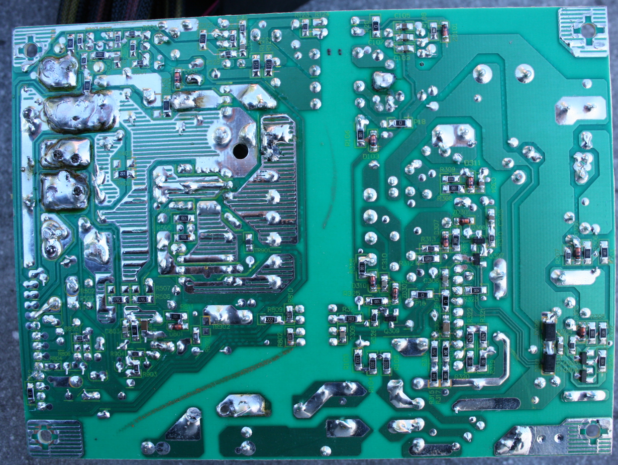

            I reflowed a few solder joints that looked iffy, and the ticking has stopped.
            Rather than risk the motherboard again I just put 2 old DVD-RW drives on the supply for a light load. The voltages look OK on my DMM (best one I have here today is a Fluke 117). And checking for ripple with the meter set to AC volts gives about 25 mV. But the scope shows horrible noise bursts about every 13 uS (76.9 kHz) of almost 10V peak to peak but very short duration. A pretty good supply set up with the same load shows less than 90 mV peak to peak. Note to self: you can't check SMPS ripple with a Fluke 117 [edit: I just checked the Fluke site and AC V & mV accuracy is only specified to 1 kHz].
            So is that most likely just output filtering on the SS-500GB? I will try to check all the caps, as usual...

                          I tested a bunch of parts in-circuit, and wound up pulling some to test out-of-circuit and didn't find anything bad. Ripple meets the ATX V2.2 specs if tested right at the PSU board with a short ground lead.
                          When I put everything back together and ran an AM2 vintage board running MEMTEST86+ for a couple days I found the power supply was ticking again. My redneck stethoscope said that the source of the noise was the inductor used for the PFC boost converter. I pushed the inductor around with the plastic tube while the supply was running and found a position where it has apparently stopped arcing.

                            It's ticking again. Again, moving the inductor stopped it. I pulled the inductor and don't see any burn marks. The glue that was supposed to be holding it in place was clearly not working. Do you think the problem is the inductor itself? The PFC/PWM chip is a CM6800G on a separate little board with a bunch of support components (mainly resistors and caps plus a few diodes). I don't have an LCR meter.

                              Given that you said it was arcing and that moving the inductor stopped it, it's probably the inductor itself.

                                      On close examination of the inductor in question I have noticed some blackening between two windings. It is really hard to tell if this is due to arcing, but it is about 120 degrees around from where the leads come off the coil, so I don't see why it would be a purposeful marking. What do you think are the chances of stopping the arcing by re-enameling the wire in this section?
                                      Measuring the inductor using the technique in the link of my prior post I came up with 306 uH (frequency was 14.9 kHz). I counted 69 turns on the toroidal core. Going through Digi-Key fixed inductors I selected a through-hole toroid with 300 uH and radial leads. At that point powdered iron was the only core type I could specify. Selecting by dimensions (I measure about 30mm diameter by 15mm width) and availability I came up with 732-2281-ND. It has a current rating of 3A, but the operating temperature is only -25C to 85C. Does this sound right for an 80% efficient 500 watt power supply? Anybody got a better choice that I could actually buy? Or do I have this all wrong?
