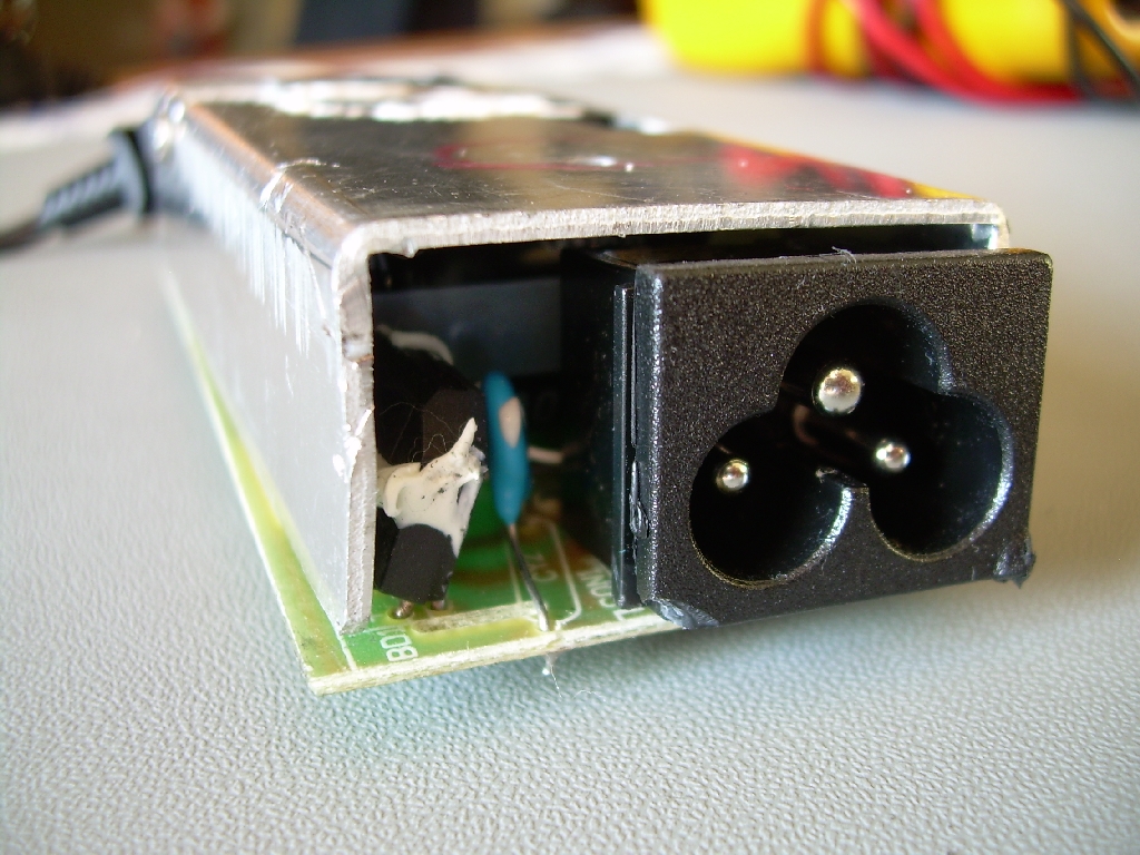

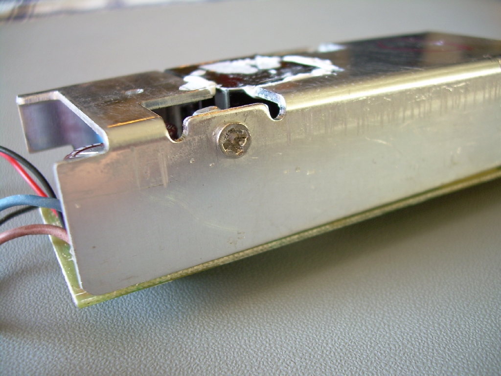

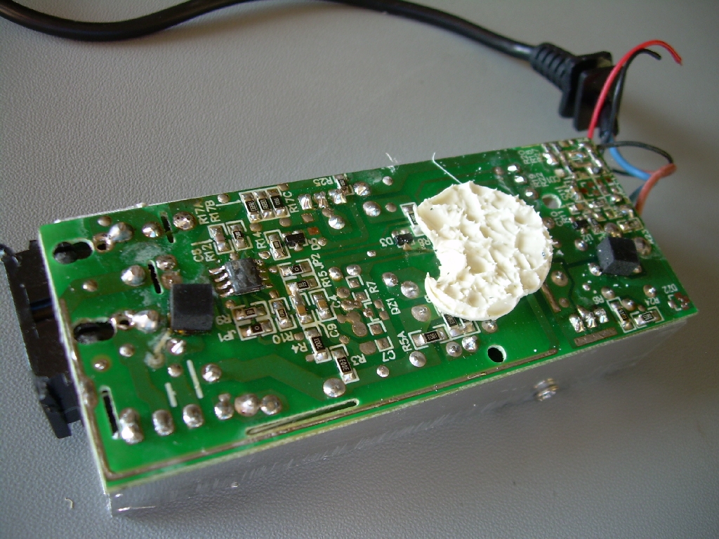

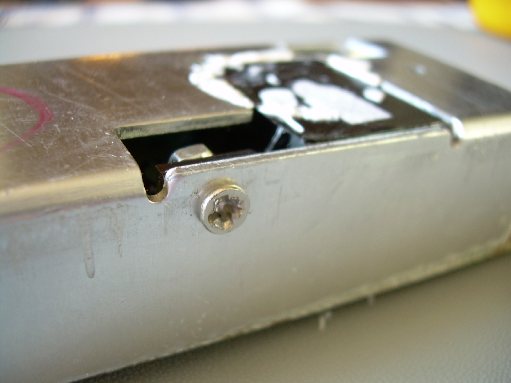

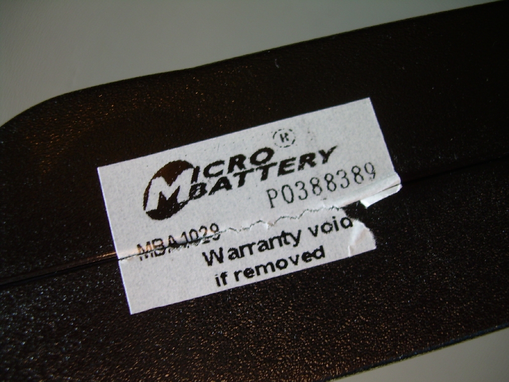

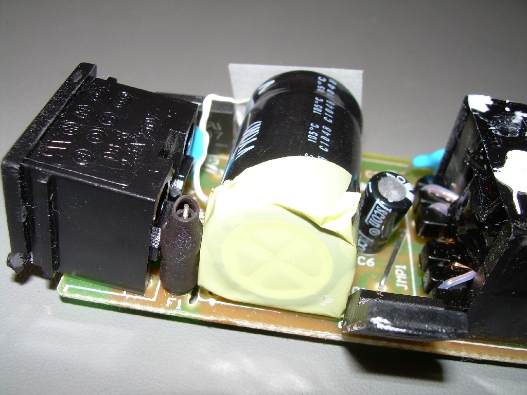

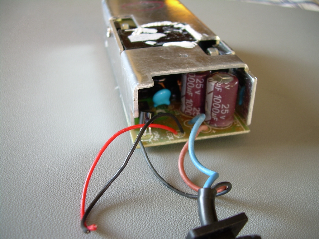

    Ok, this is for Dell laptops - sold by MicroBattery, was surprised when I open it and saw cb.
    Is this worth saving ? 3.34A really ?
    Build quality seems low for me,both screws looks used, thin wires and dirty cb with what looks like dry flux.
    Tell me what you think and please give comments based on pictures.

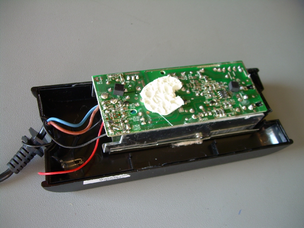

    Re: Worth saving ? analyze this psu for me please

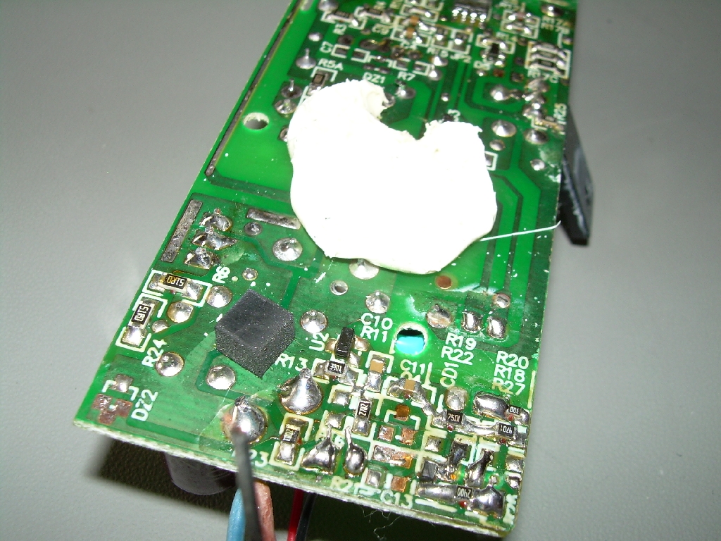

    Rest of the pictures.

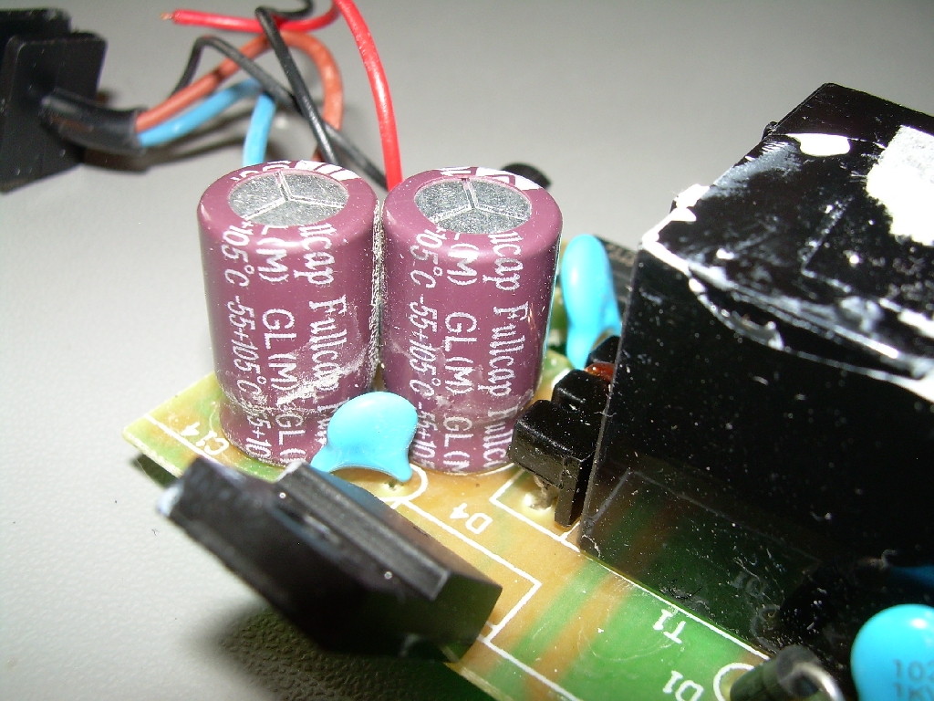

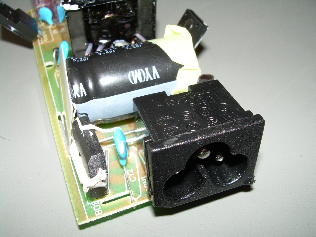

      Absolute junk, and check out that counterfeit input primary cap. Toss it in the rubbish bin.

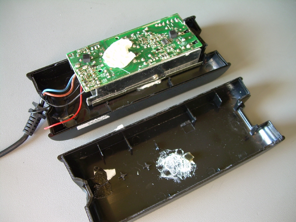

          Holy crap, we must have a hundred of these at work. Just found this in the garbage bin and decided to take a look inside.
          I always thought MicroBattery was quality stuff !

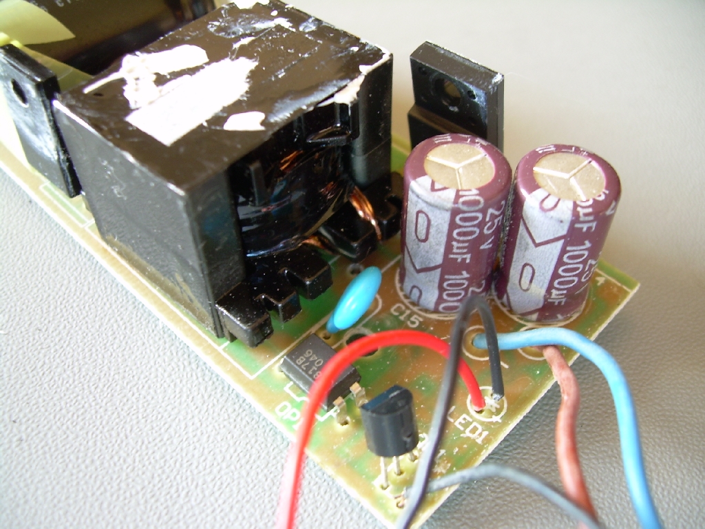

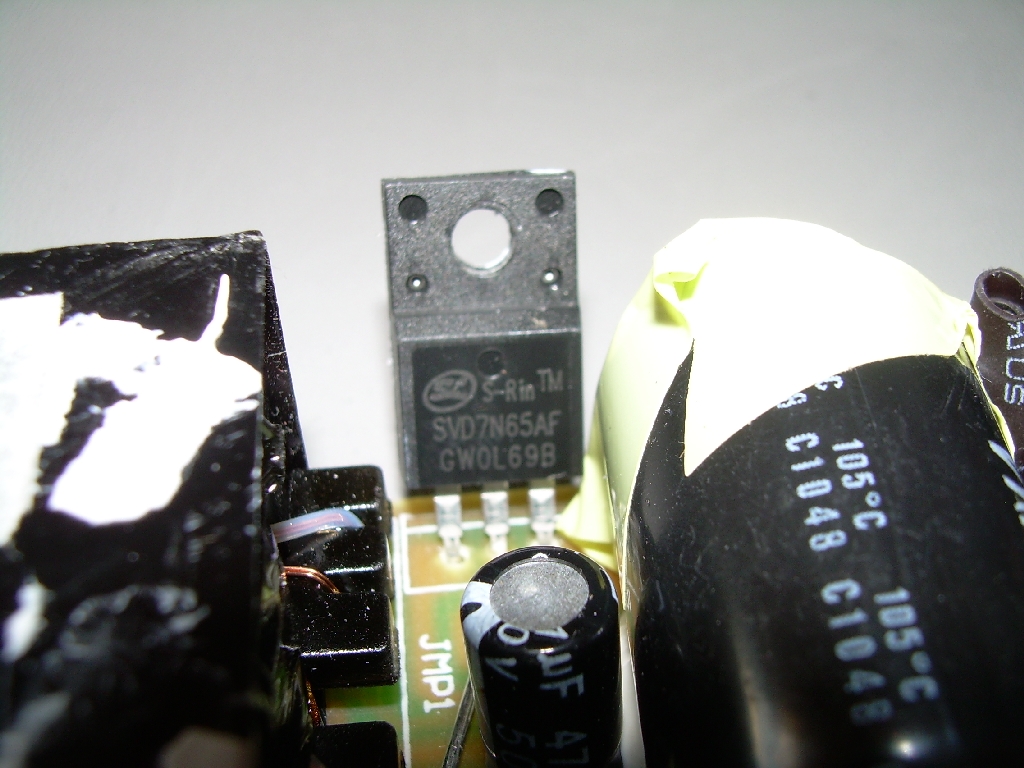

                For starters, the fact that this underrated junk pile is sold under "circumstances" alleging it's "equivalence" to the genuine PS is reason enough.
                Undersized wiring
                Undersized traces
                Questionable isolation- looks like line side traces are a little close to the secondary
                Cans of shit that "look like" caps
                Nichicon VYs haven't been made for years, so the input cap is basically an "F-you"
                Components with long leads, etc.
                And most obviously, the board is too small for the case, indicating they were trying to "get rid of" their junk in something else...

                  You are giving me the impression that you might not like what you see hehe - the sticker on the housing is actually quite good, I still have glue on my fingers.

                      Who knows if those caps are even low ESR. On Fullcap's datasheet it says they are, but in the specs they only list dimensions! No impedance or ripple current info... And the soldering on that thing is horrid
                        To even trust such datasheets is like trusting ASUS stuff, without redundancy, on the space shuttle!
                        For me, "funny caps" simply count as "missing components" from the board.

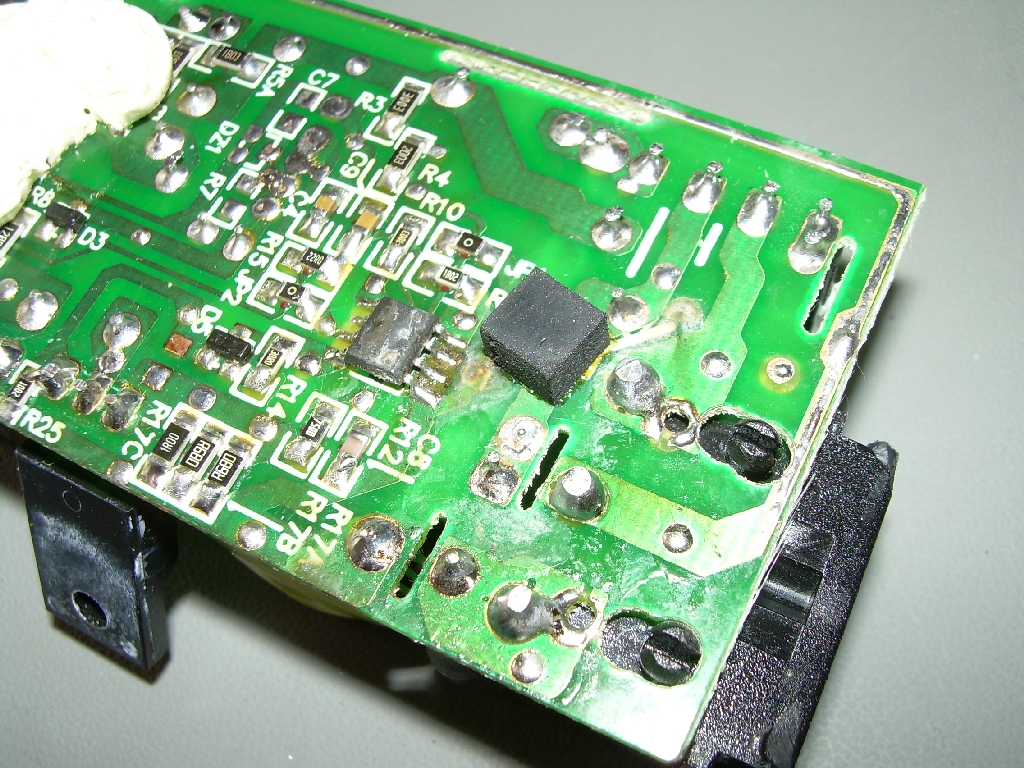

                            I'm sure someone smarter than us on this forum could give a thorough explanation, but off the top of my head, the brick has insufficient input protection, and what input protection exists is undersized. The output circuits are underdeveloped and insufficient. The capacitors are sorely lacking and probably don't even meet their stated spec.
                            I should also point out that the circuit board is not filling the entire case for a reason - they use the same PCB on all their adapters and simply mold different sized cases for different laptop models in order to "match" - at least visually - the original adapter.
                            These adapters are actual fire hazards, and I have personally seen one after it had been severely burned.

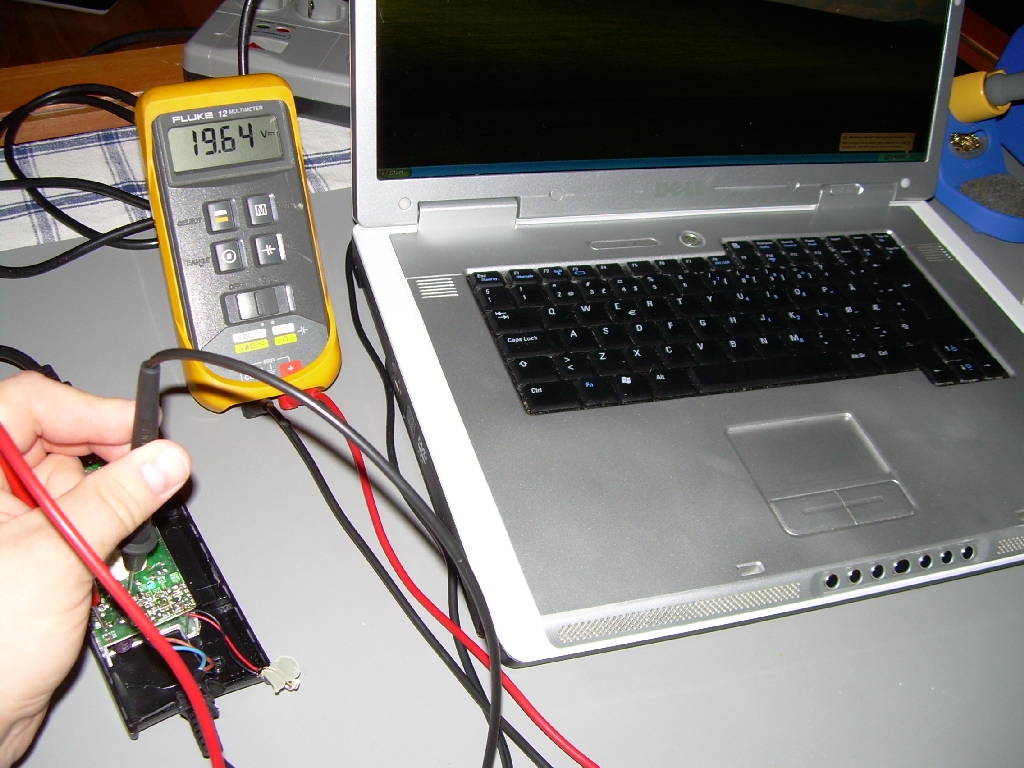

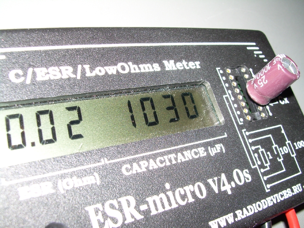

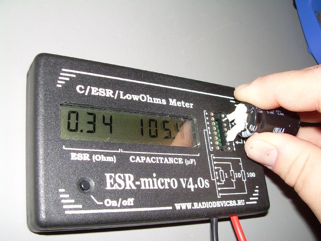

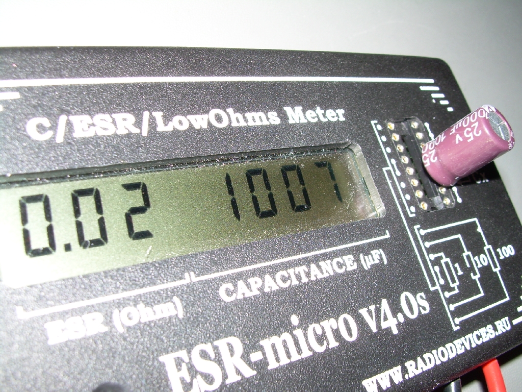

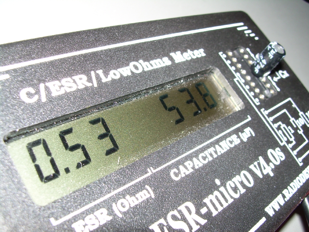

                              Don't know how to, have a few multimeters,esr meter and a dso but is far far away from any knowledge on things like this.

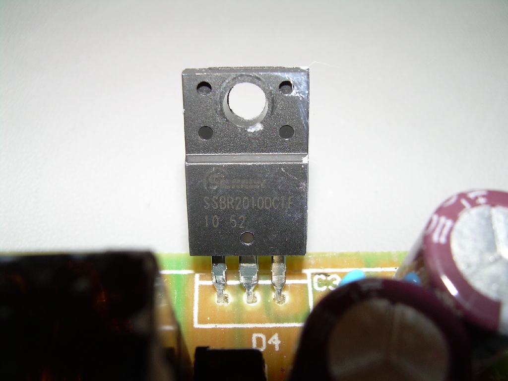

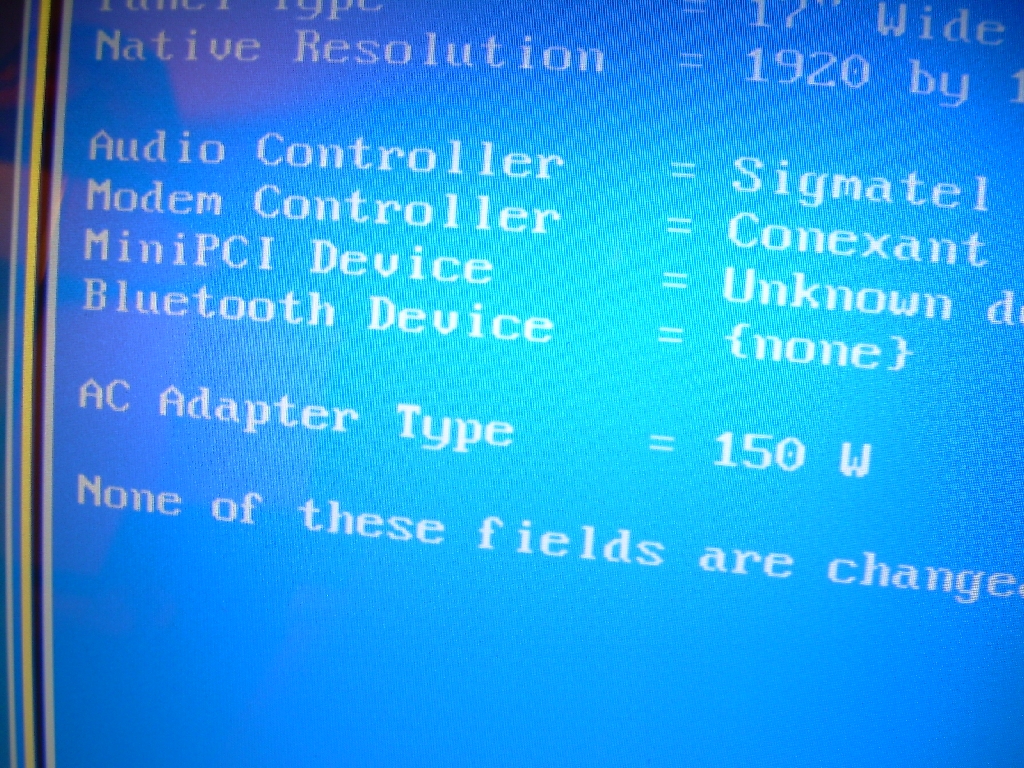

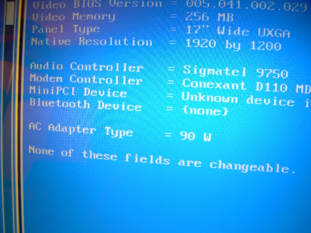

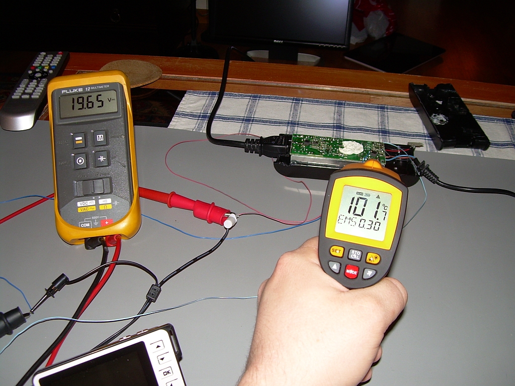

                              Ok, had to measure these caps and try to start it up - was surprised that it managed to power my old inspiron.
                              With my oem Dell 90W powersupply bios reports 90W psu used, with this MicroBattery psu bios reports psu is a 150W model

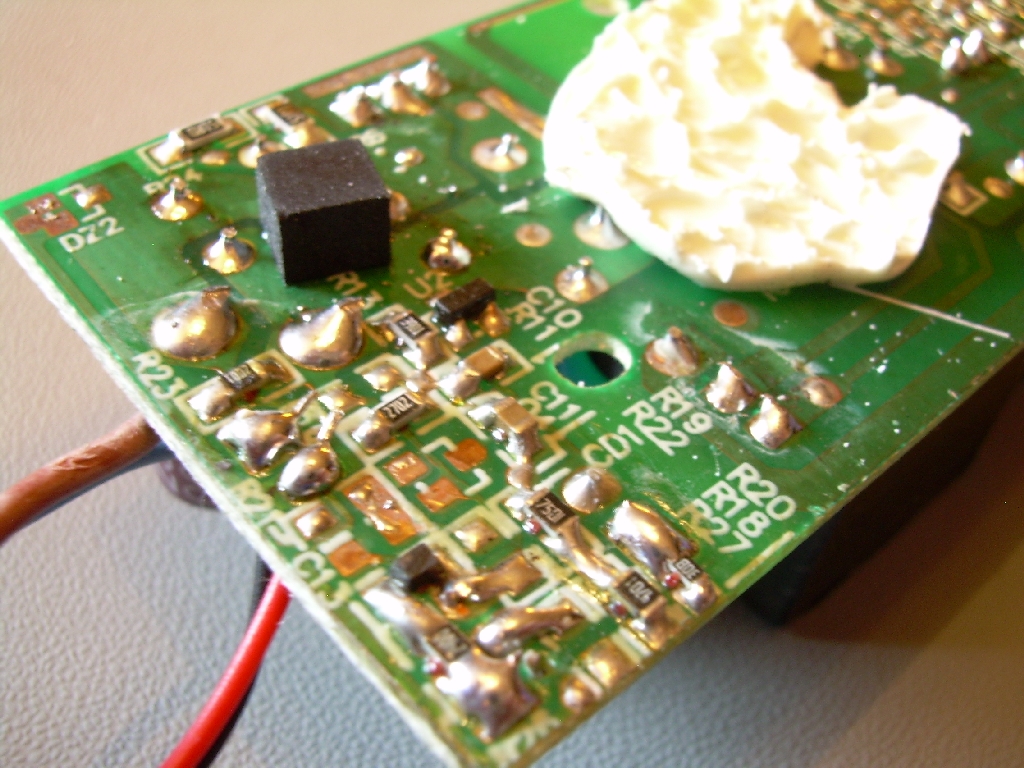

                              Had to take a close up of the output section - lovely soldering job.

                                Wow, impressed with the Fullcap specs, at least they are low ESR. How much use has this thing seen?
                                    Perhaps they meant 15W??
                                      Getting hot running p95.
