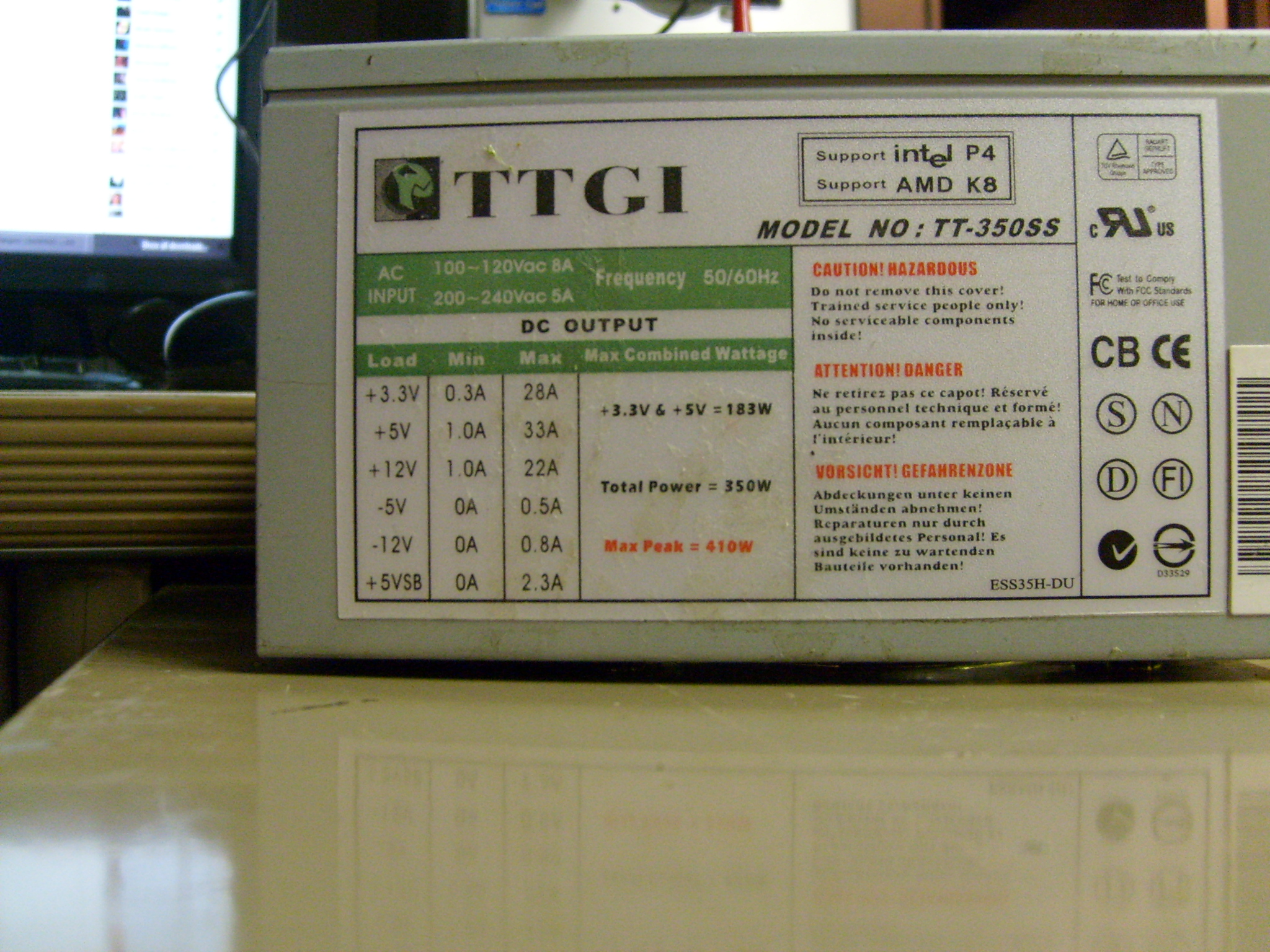

    Found this PSU at a Goodwill for $4:
    This PSU is WEIRD. In some ways it seems junk, in some ways it seems built for royalty.
    Like for instance, it's clearly a non-12v design be marked as a P4 PSU, yet they actually listed both a peak and continous wattage... and the model numer isn't the peak number!
    Another sticker:
    Hmm, Ok...

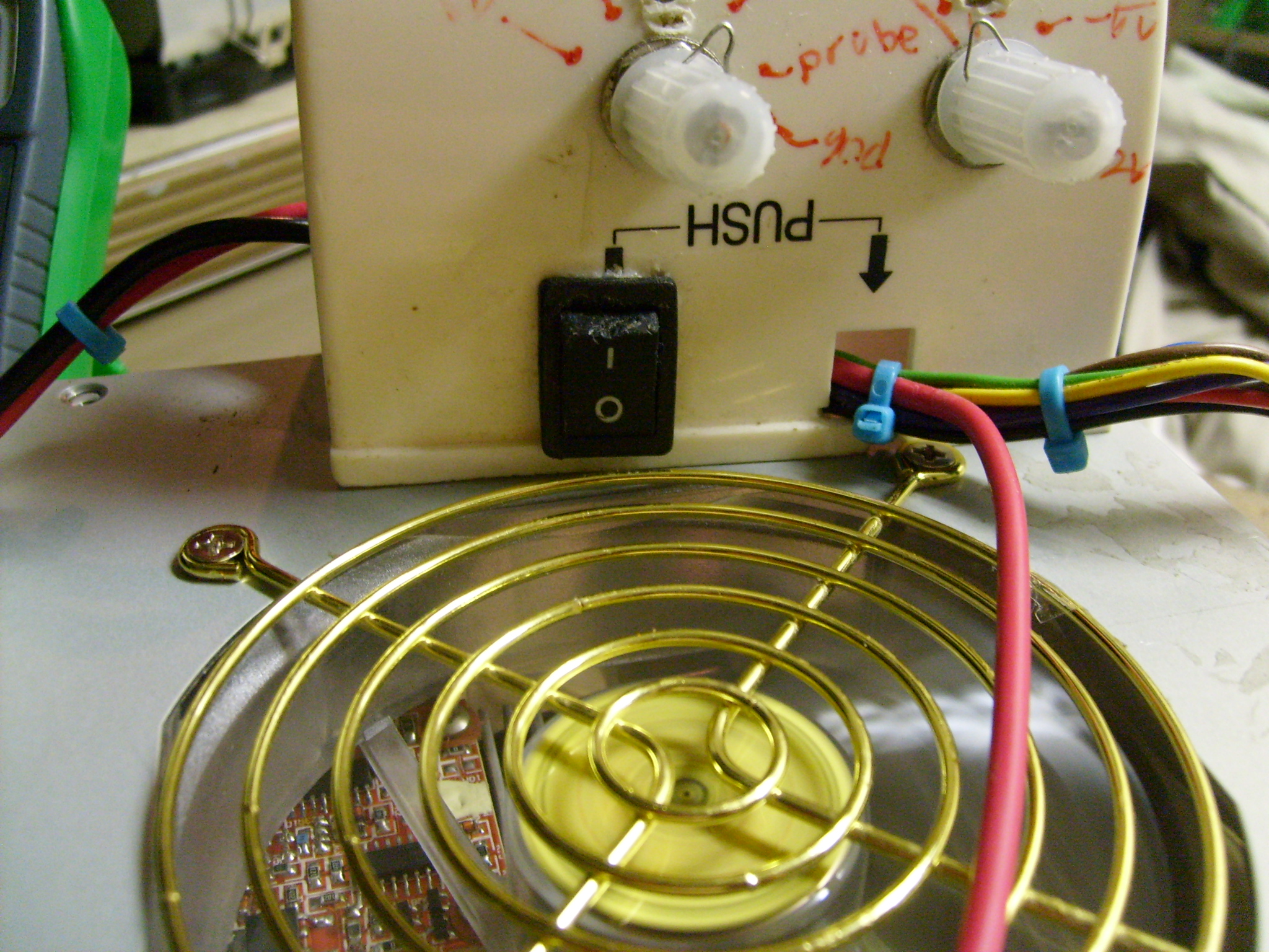

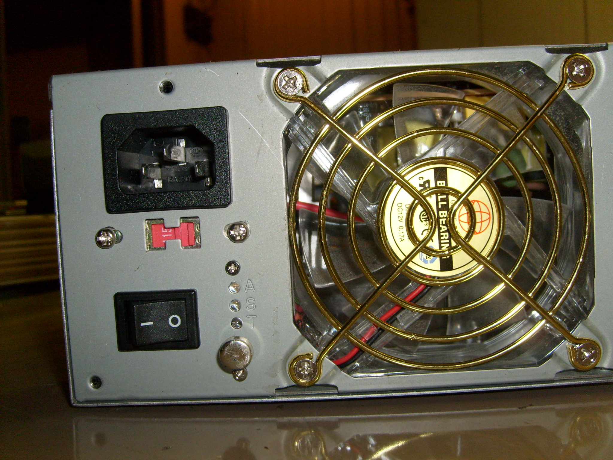

    The back adds more mystery:

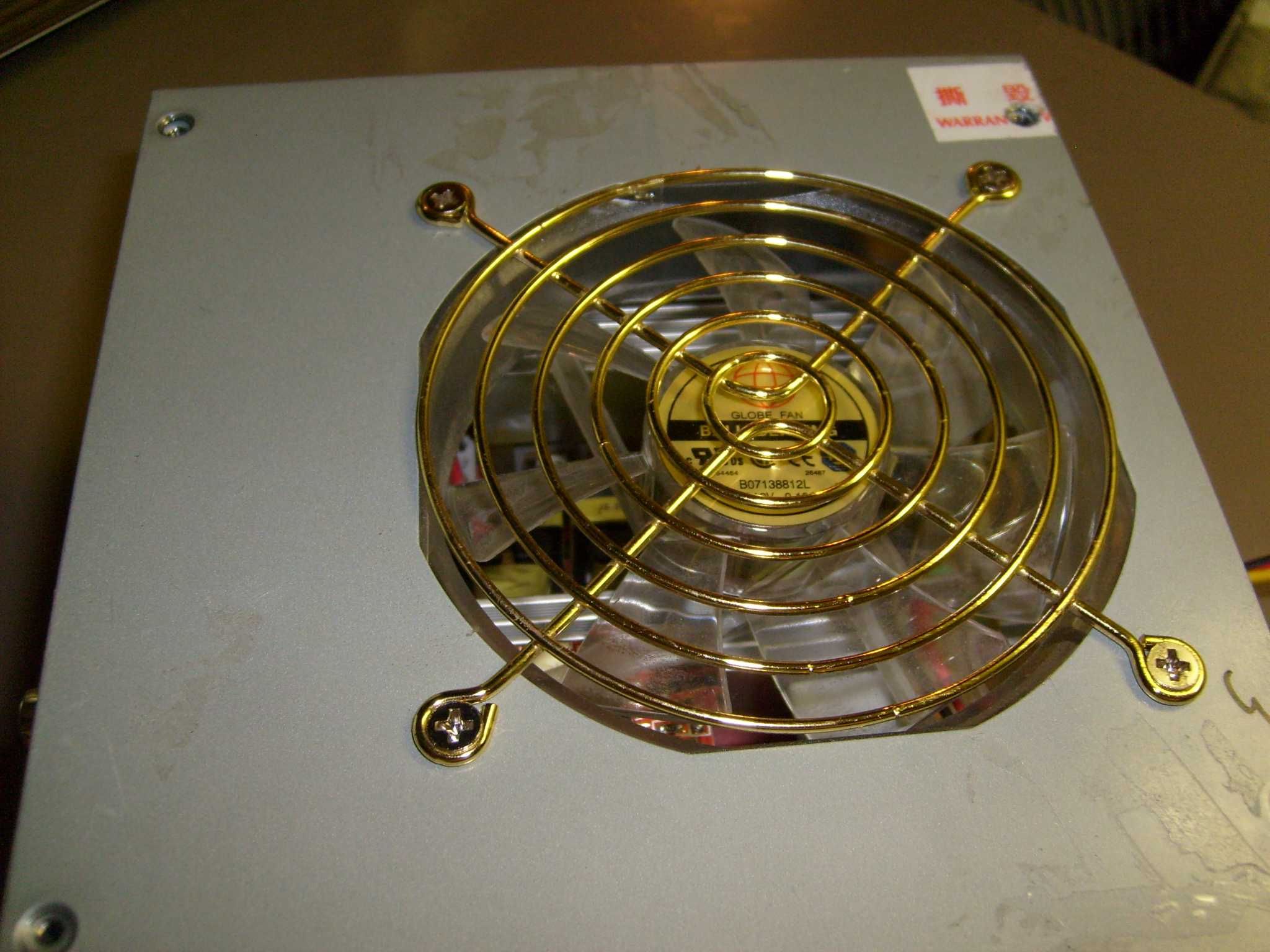

    The switch and 3 LEDs (I could only make two of them come on) are actually to select different fan speed profiles... When none are on, it's slowest, middle makes the S led light up green, and high speed lights the T LED red. The LEDs are solid when the PSU on and blinking when it's off (more on why later).
    And the fan... it's a legit Ball bearing fan... no sleeve bearing horseshit, as I once took apart a globe BB fan and it indeed had two BBs.
    The top adds another fan, same model only 92mm, to the mix:

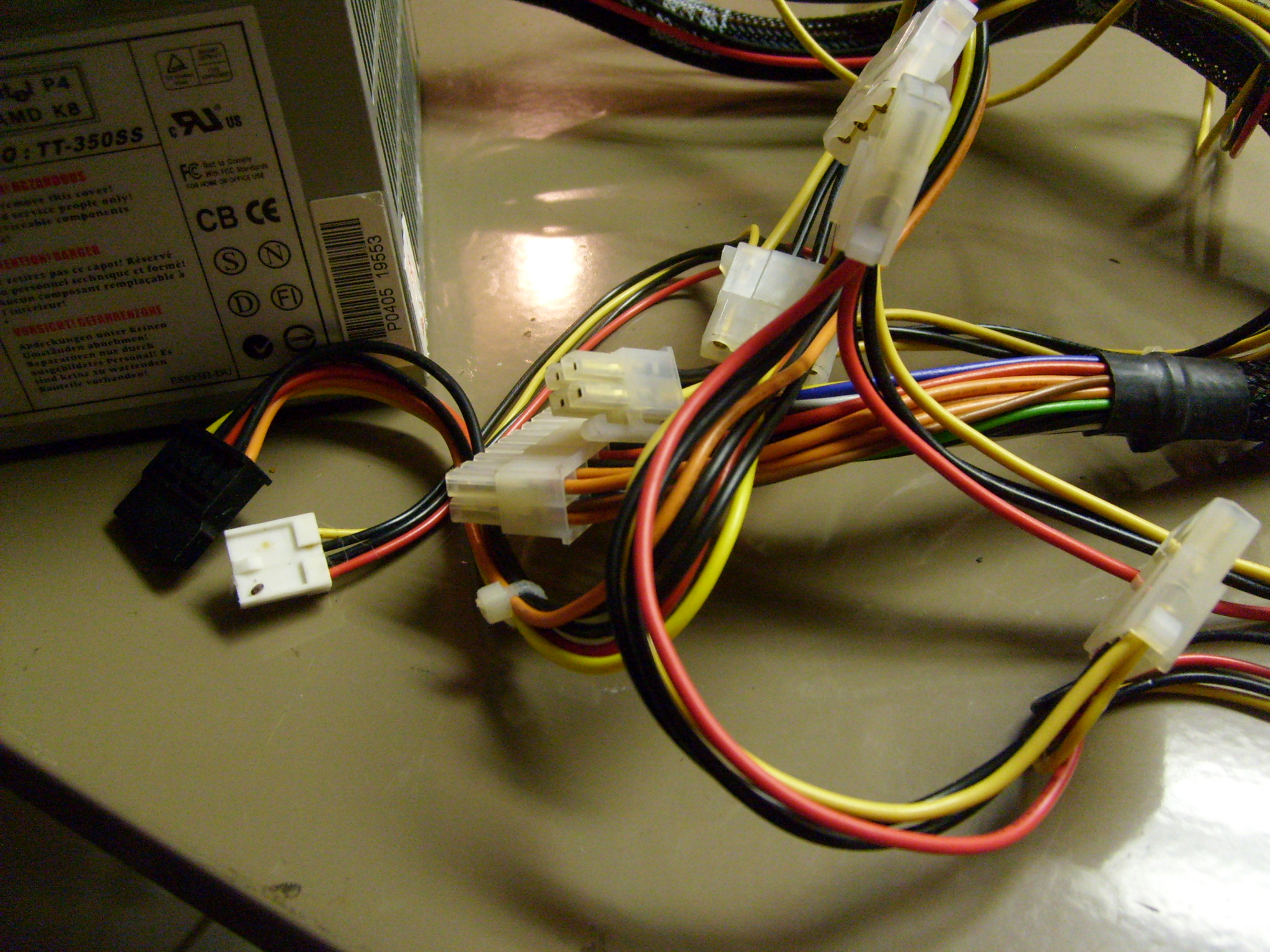

    It has an older set of plugs, mostly moxlex/berg, but with a single SATA:

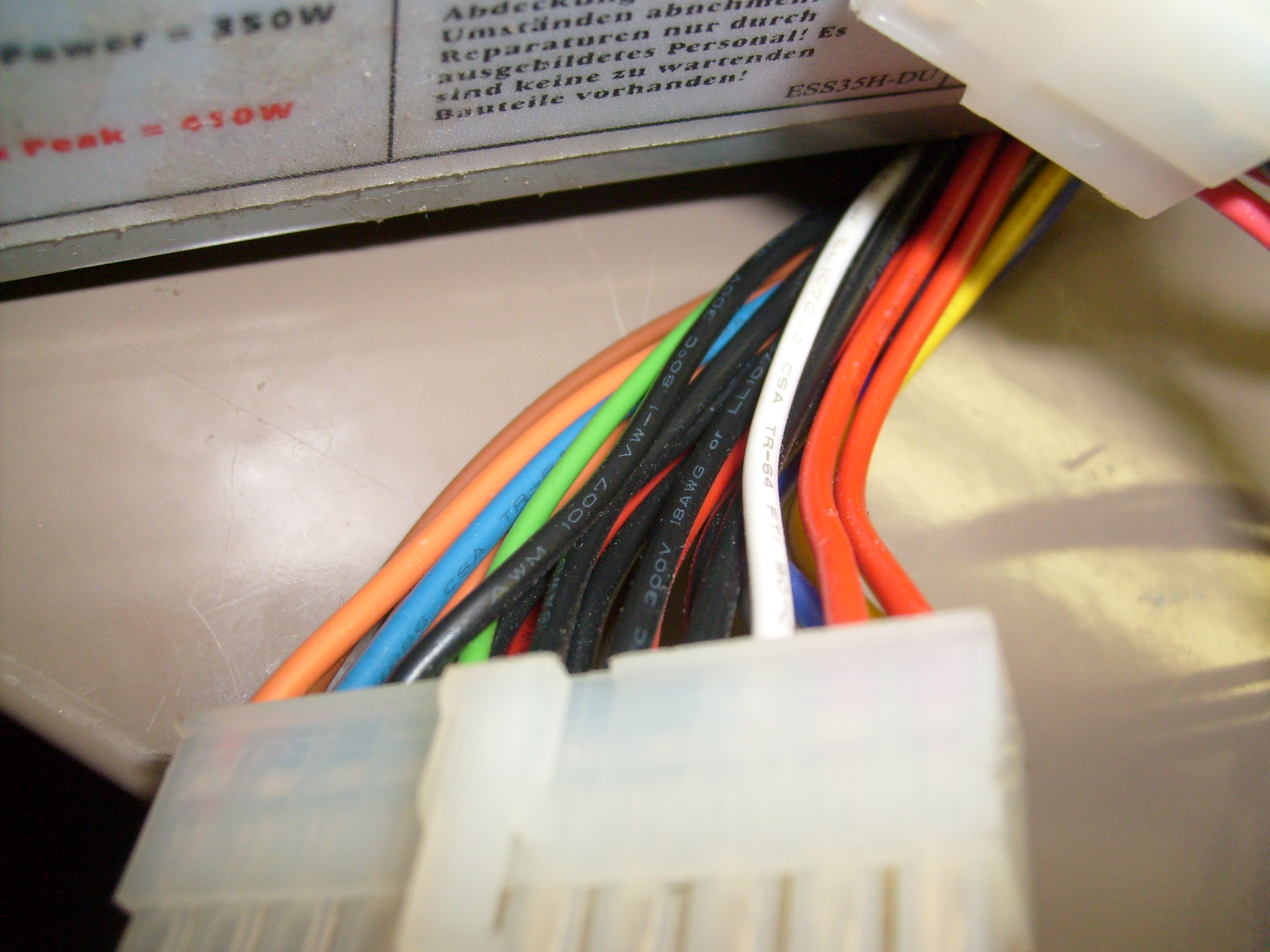

    The wires are nice and thick too... none of that super thin shit.
    The ATX does indeed have -5V present:

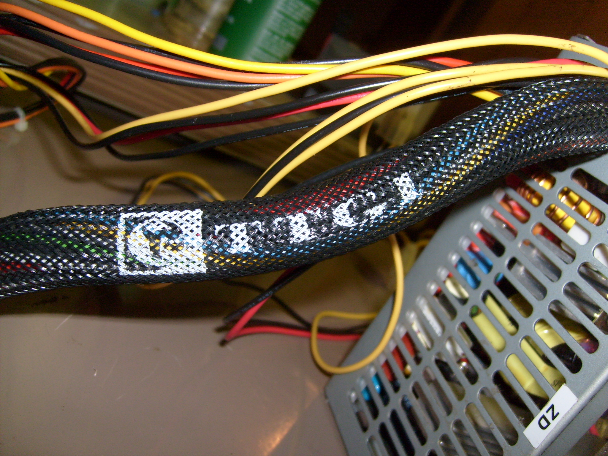

    And they even silkscreened the ATX sleeve:

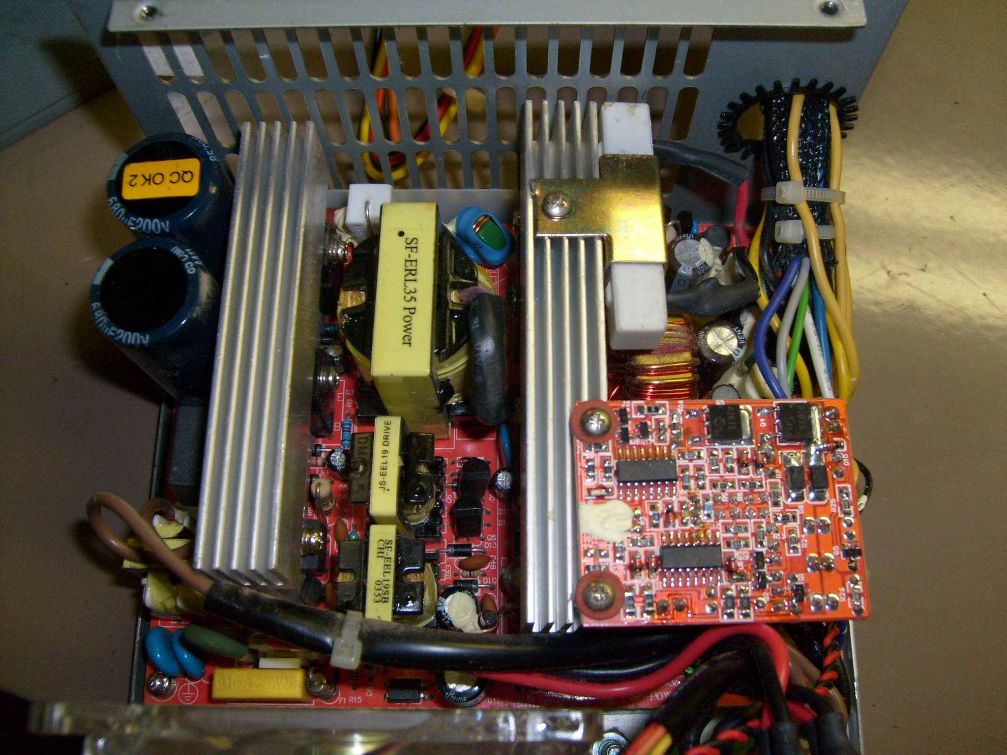

    An overview of the guts:
    Look at those massive load resistors and fan controller... more on the latter in a bit.

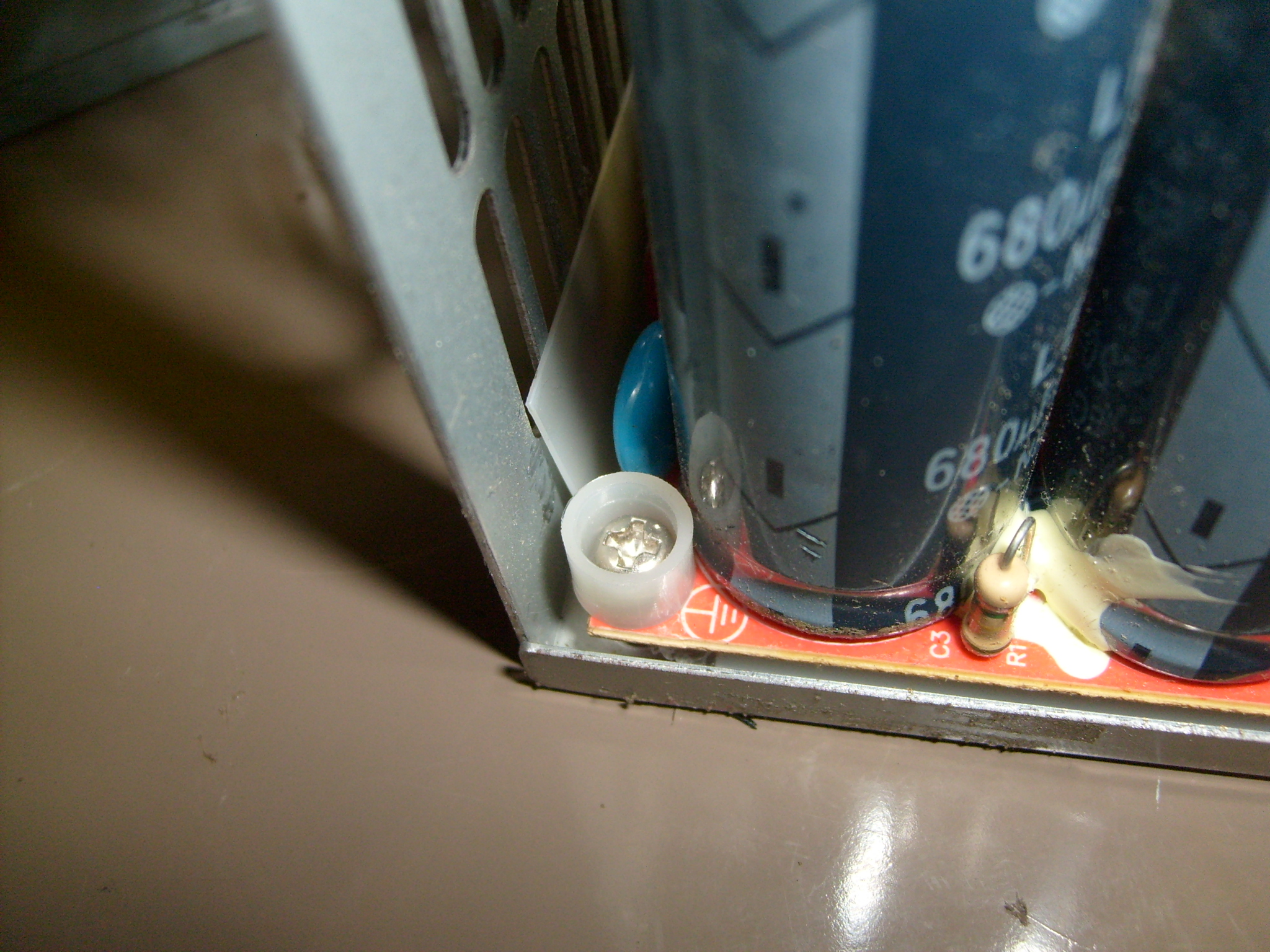

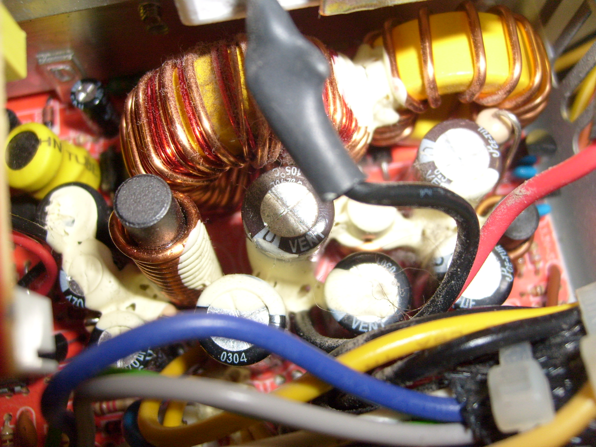

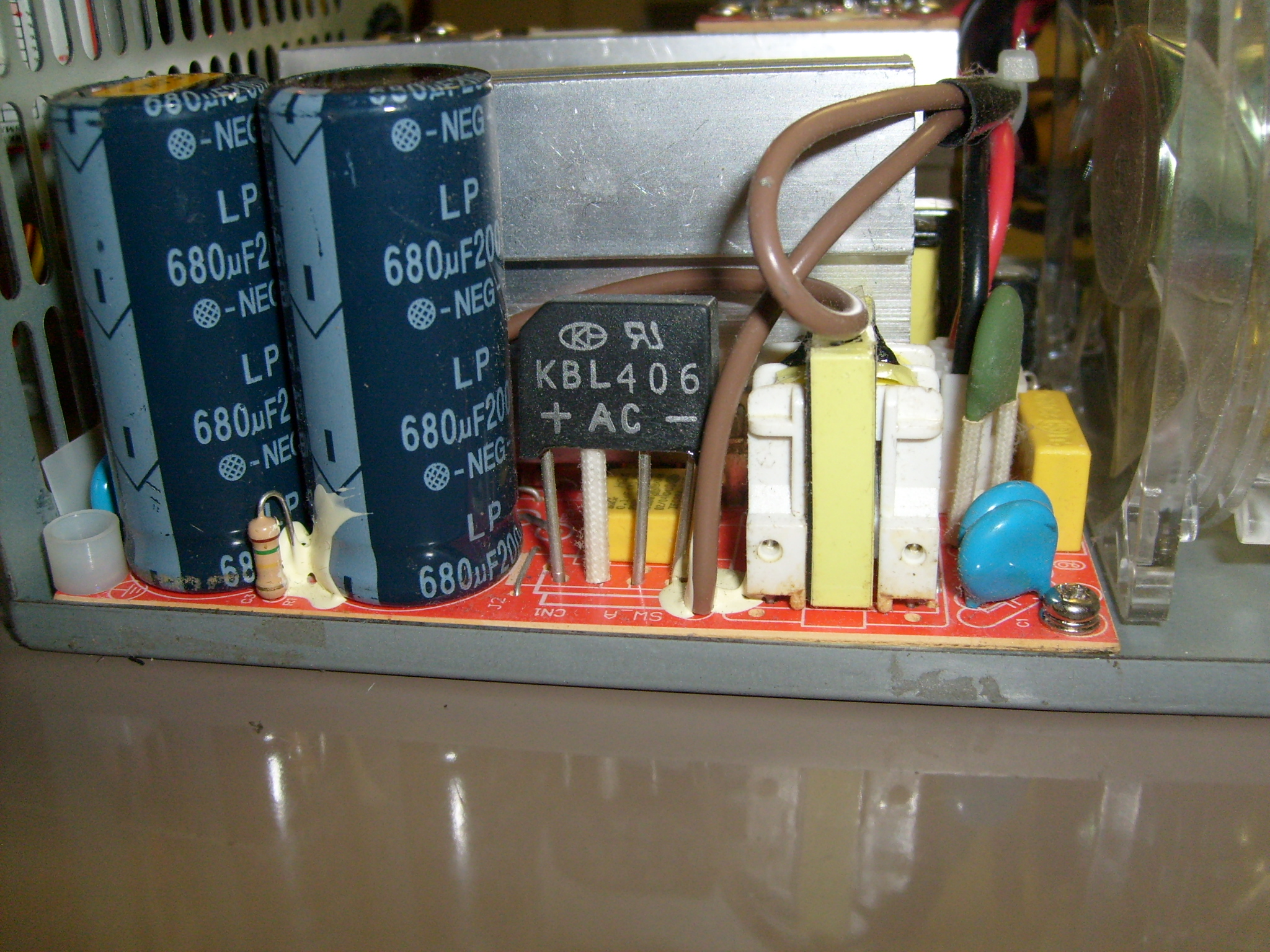

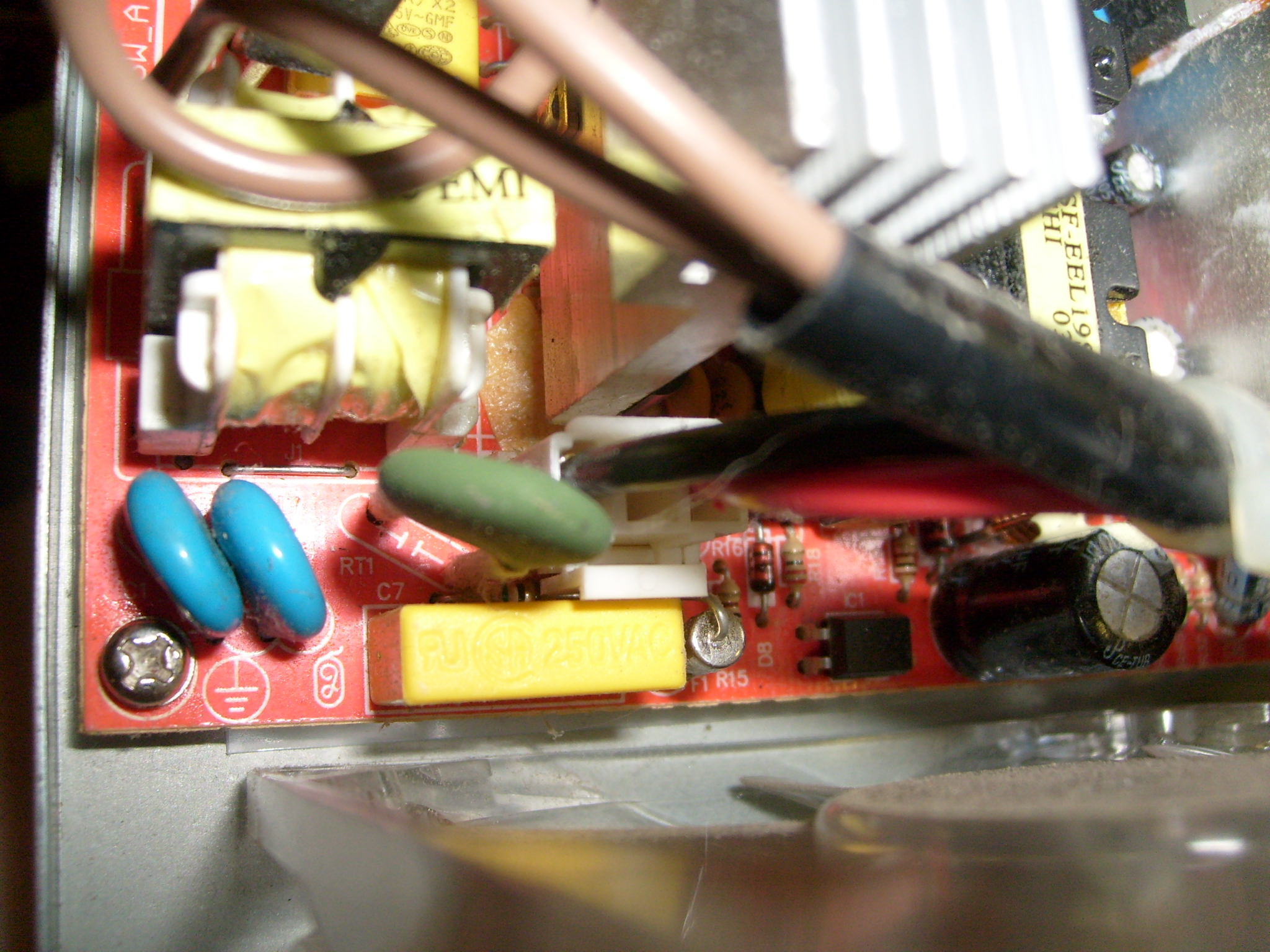

    The Primary:
    Looks good, minus the noname primary caps. The even put an isolation cover on one of the screws:
    That's it for this post... in the next one, pics of the secondary and some other goodies.

    Those aren't noname primary capacitors. "LP" is a series of capacitors from CapXon. That sleeve looks exactly like all the other CapXon LP capacitors I've seen, except it looks a bit more blue than black. Not to say CapXon capacitors are much better than noname brands... unless those are fake CapXons (but to fake CapXon out of all the brands...). 350W seems about right for it depending on what the bipolar switchers are (it seems to be a half bridge unit). They're in TO-3P so they might be good for 350W.
      I see.

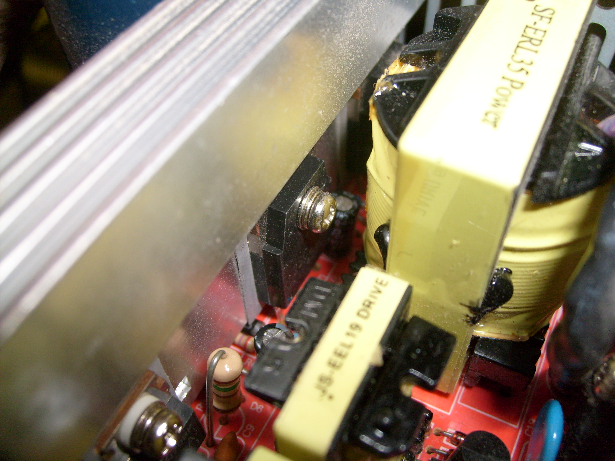

      Here's some pics of the switchers:
      While I was shooting those, I noticed something I like:
      They actually used a connector for the AC!

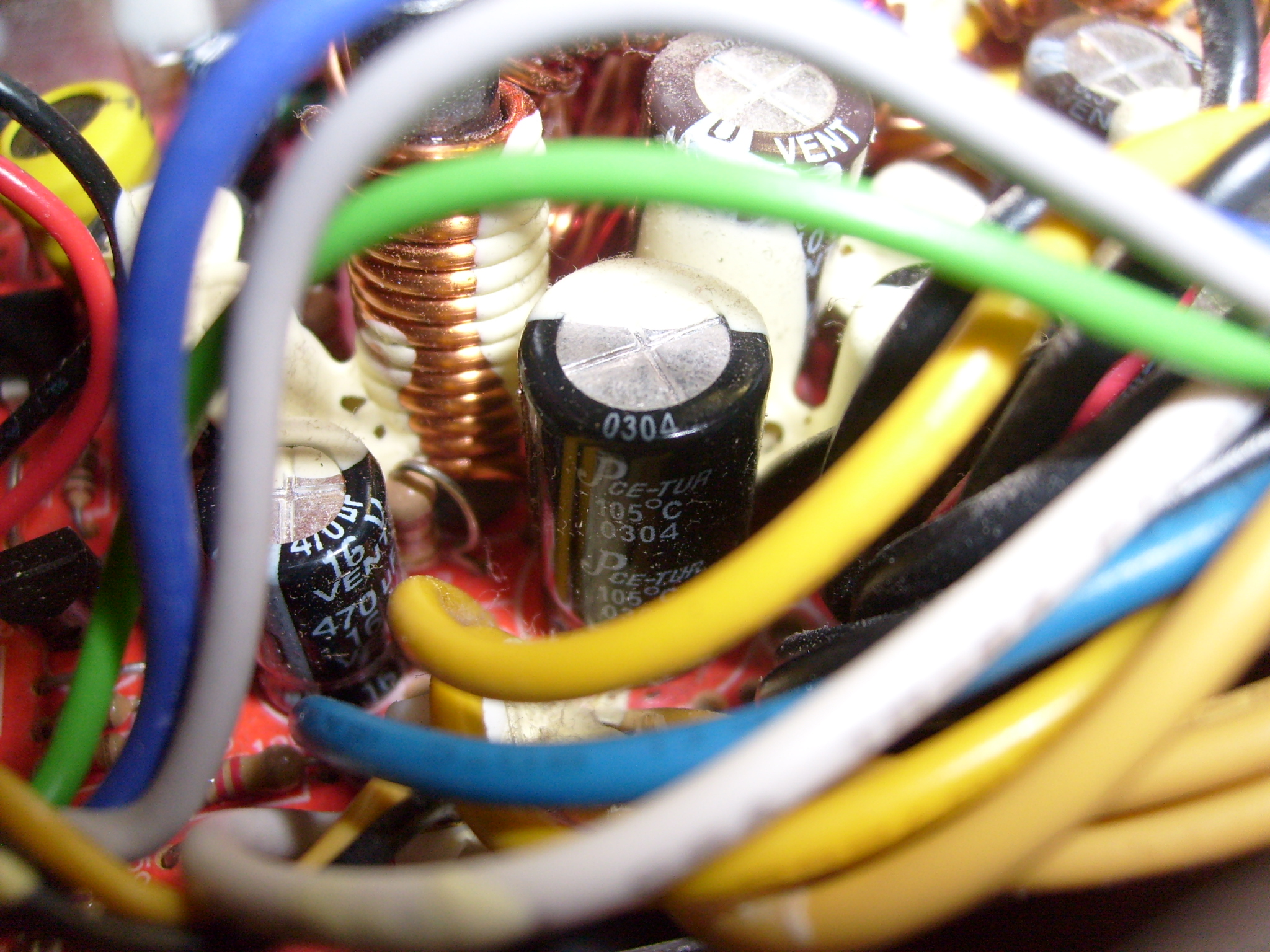

      Here's a pic of the secondary:
      For 350W, it looks a bit skimpy... but maybe it's just me.
      The caps are PCE-TUR:
      None bloated... but they're probably dried up. If I use this PSU, I'll recap it.

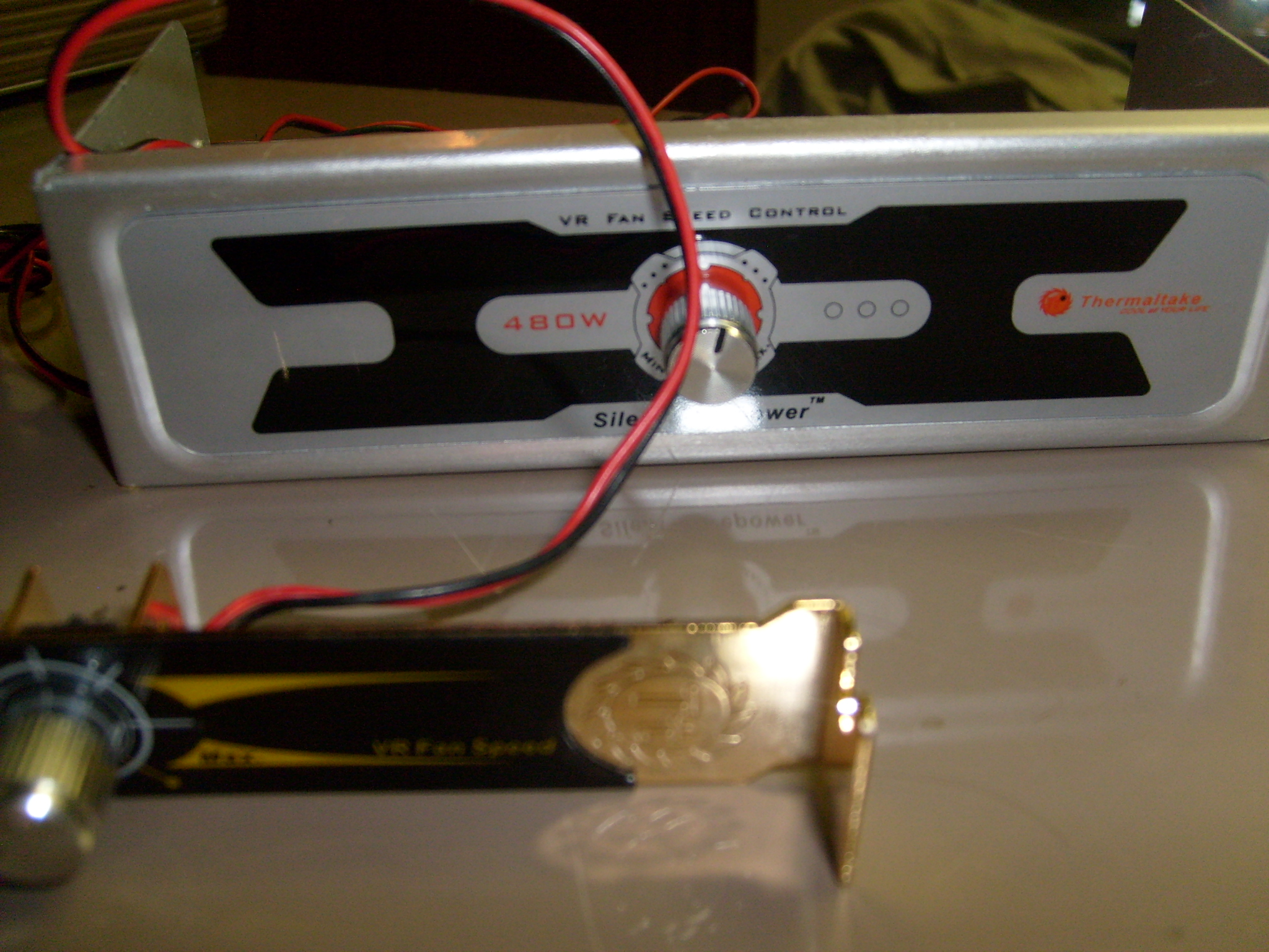

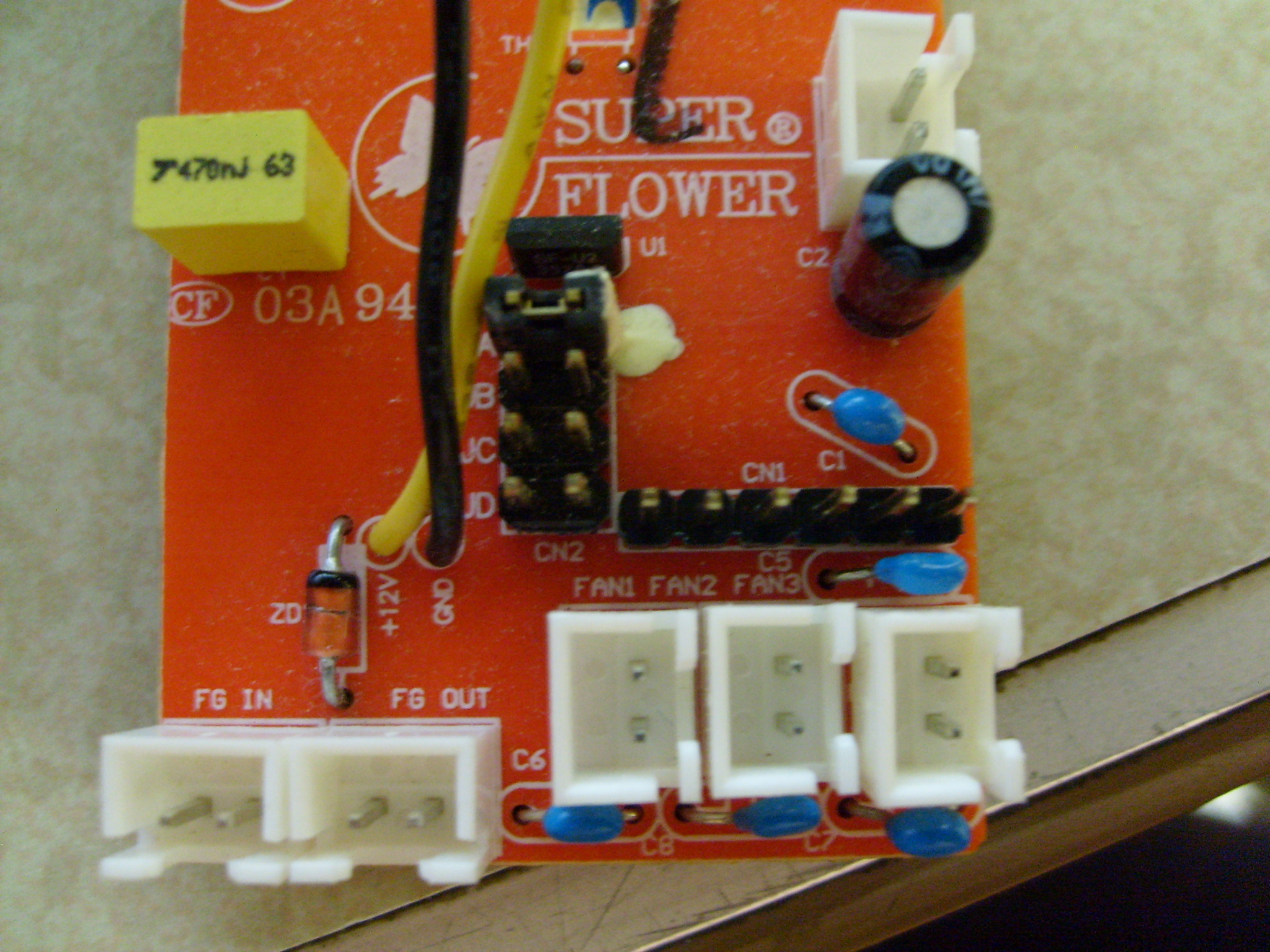

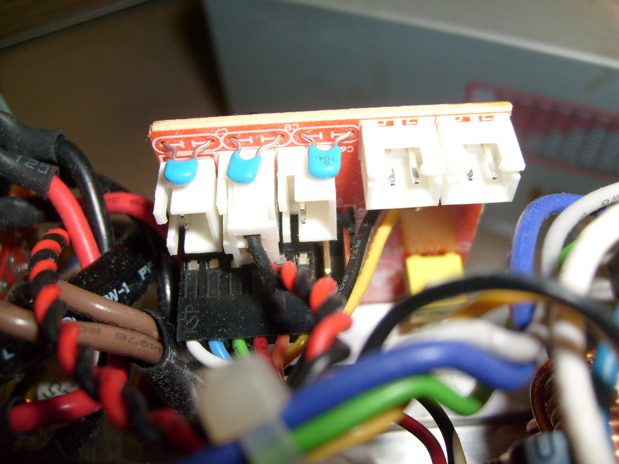

      A few shots of the fan controller daughterboard:
      The three connectors with the blue caps are clearly fan outputs (in parallel), whole the other two are a mystery... these were bundled with the PSU:
      While they were made for a 480W Thermaltake, the ends match the connectors:
      May explain why the warranty seal was broken (before I bought it, that is).

          Nice grab RD! That's actually a nice PSU, I was pleasantly surprised. It's got ball bearing fans and a connector for the AC like you mentioned which makes me so happy I think that's an old Super Flower unit.
          I'm surprised they used CEC holdings for the caps, I expected total junk like HEC, Fuhjyyu, etc. I think this would have no problem doing 350W. Those switchers look like Fuji Electric, do they say 2SC2625? If so then they're good for 350w especially with the good cooling and nice heatsinks.
          What are the model numbers of the secondary rectifiers?
          If possible I would replace the 4A bridge with a 6A bridge

                  I think it's good that the fans run all the time, because it looks to use a 2 transistor circuit for 5VSB, which will be fine once you recap it but they tend to create a lot of heat in standby mode

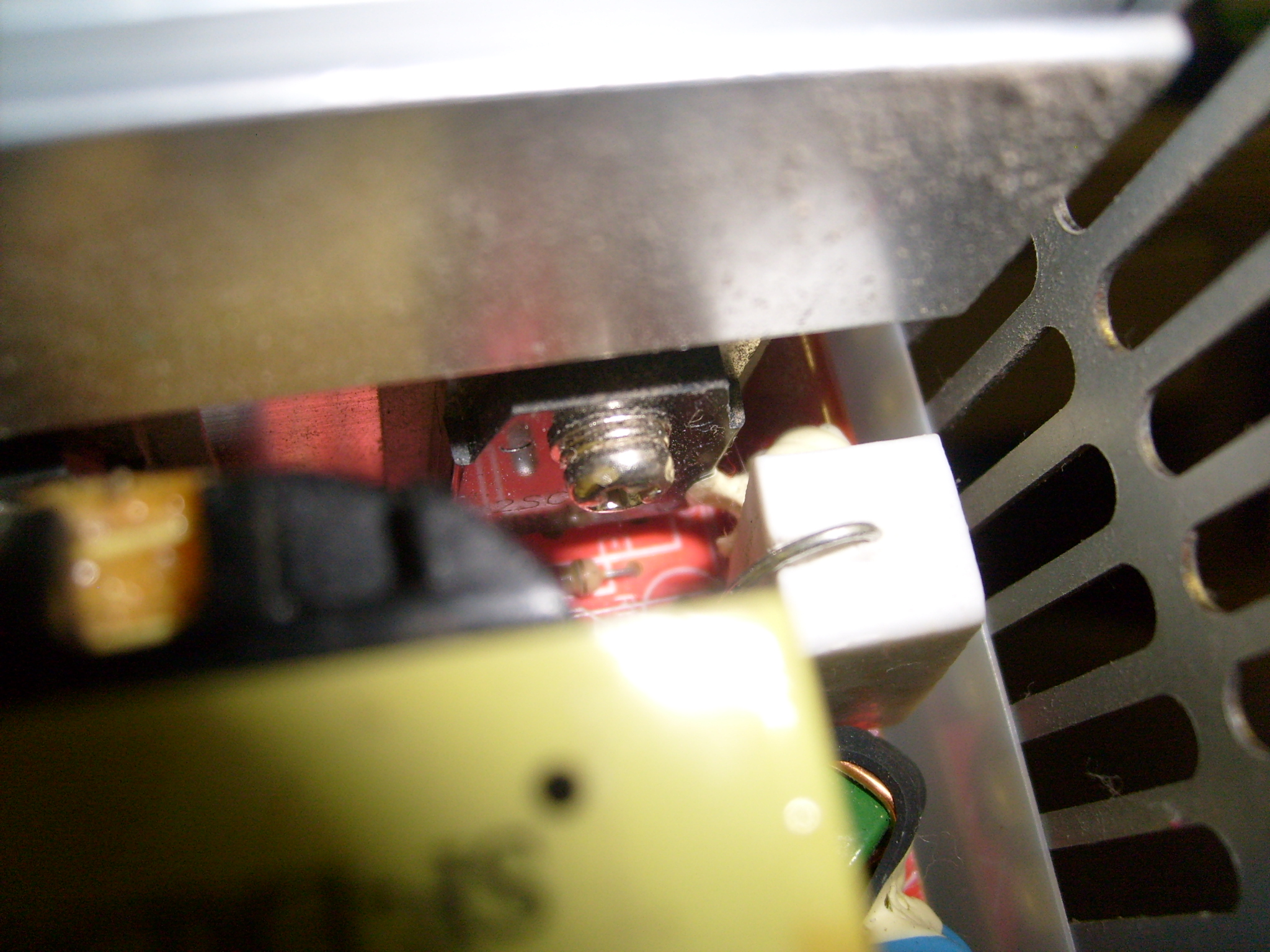

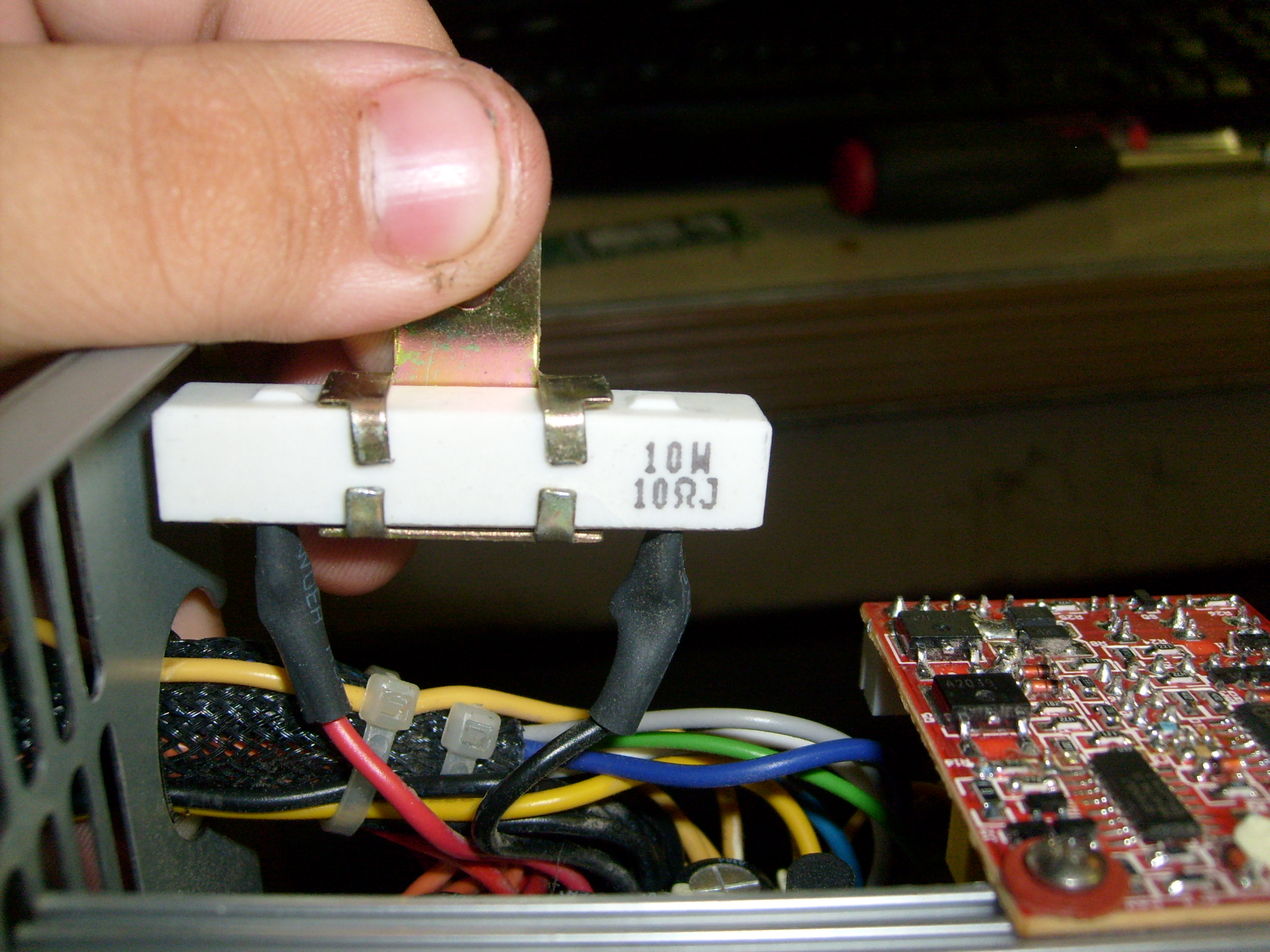

                    Massive resistor.

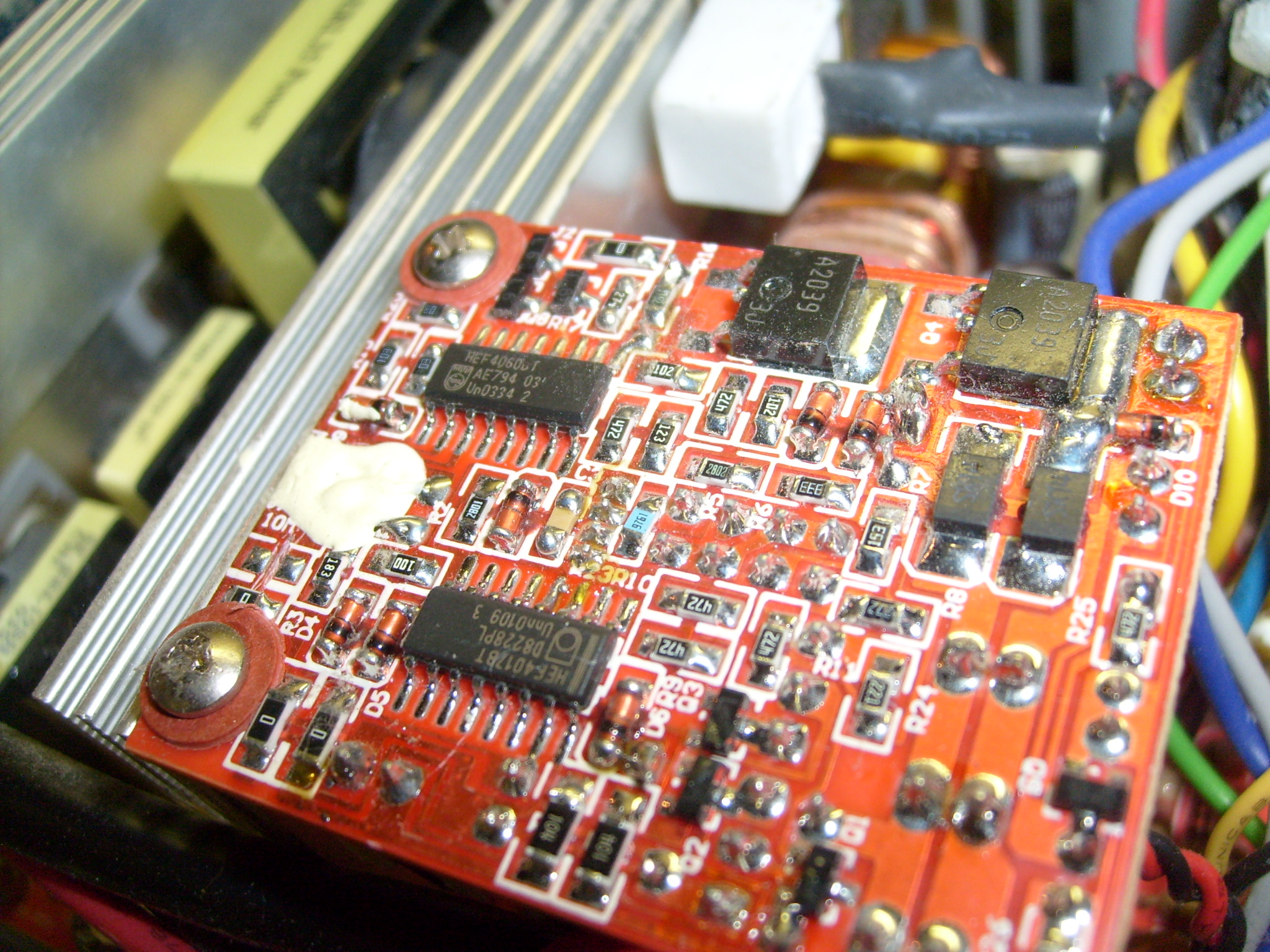

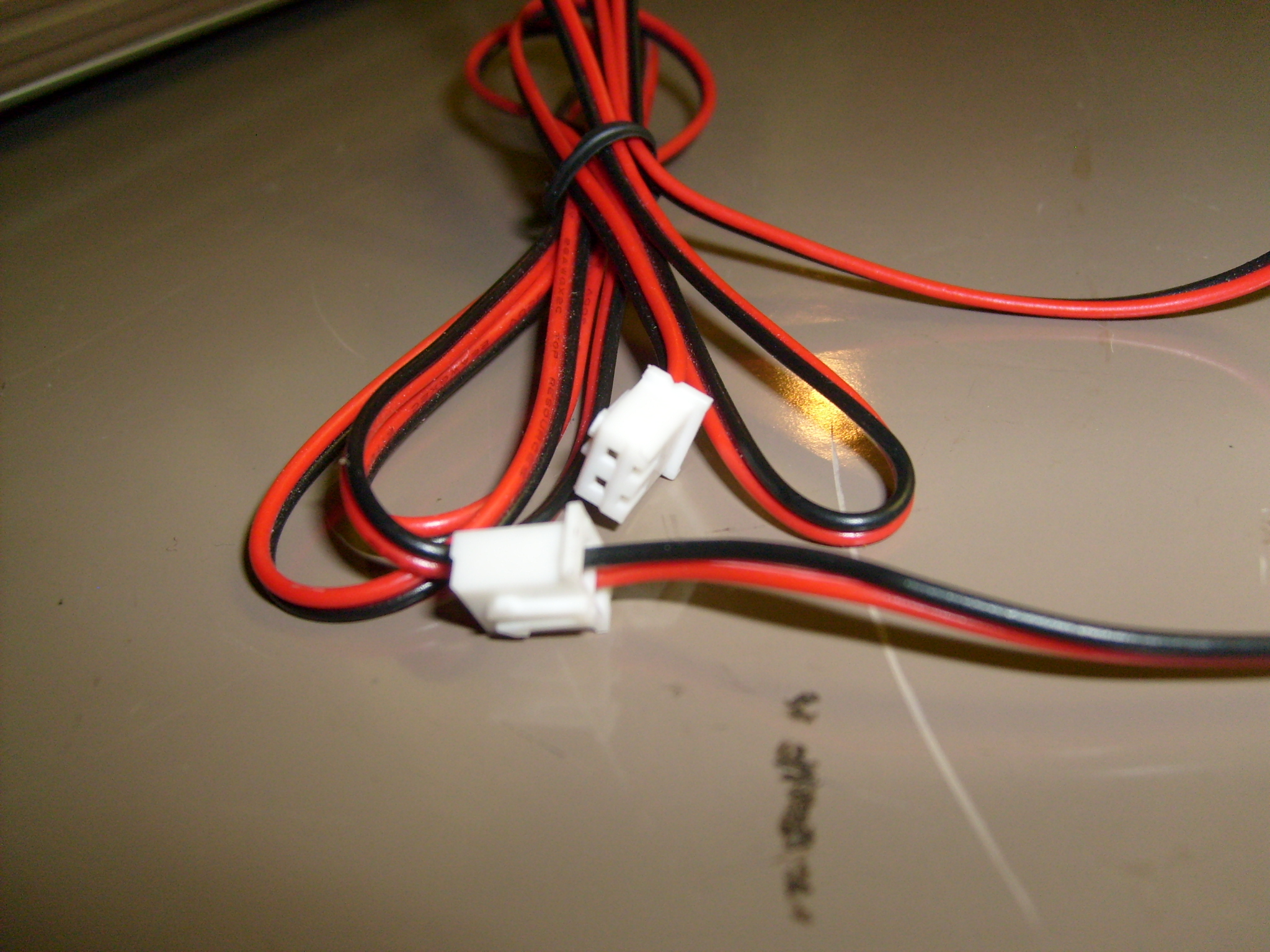

                    I think you deserve an award... look what I found on the daugherboard:
                    Yes, it's a super flower...
                    Also note the markings on the two mystery connectors... I guess those fan controller leads were bundled in error...
                    Also note that thermistor at the top... that's right above the heastisink... that must be how temp is being measured.

                      Nope, both were on. Notice that all 3 fan connectors are in parallel... when one is on, they're all on.

                          More on that Resistor:

                                That's not a resistor... It's a heating element! lol
                                (we do actually use physically similar size ceramic wire-wound resistors @ 240v as heaters in camera housings)

                                  That there could be the reason why the fan runs in standby... Where is it connected?

                                    The huge load resistor is probably fine because it's far from the caps and the board, so it's not cooking anything. Looks like it's on the 5V rail. Being a 10 Ohm, it's dissipating 2.5W. A bit on the high side, but probably there to make the 5V rail happy with a heavy 12V load.
