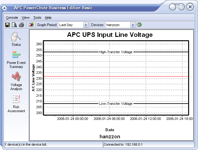

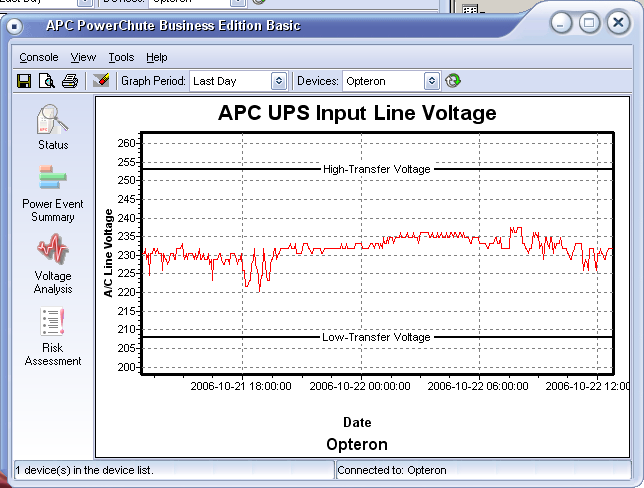

    The design of the UPS is also really good, it runs the inverter constantly (double-online power conversion) which means that I always get a constant voltage out of it, no matter the input voltage... There is also no cut off delay before the batteries kick in if there is a brownout since the UPS is already running from the inverter...
    See these two pics, they are of an APC Smart-UPS 1500, a pretty highend UPS yet it is not a double-online power conversion design like the Riello but a line-interactive design... The first picture shows it running from the power the Riello Power Dialog supplied, the second shows the power it is getting now that the Riello is not online anymore...
    APC Smart-UPS 1500 running from the Riello Power Dialog 600:
    APC Smart-UPS 1500 running from line voltage:

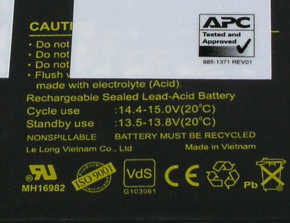

                  Regarding the batteries used in the UPS, they are ABS batteries (Absorbed Glass Mat) I.e. you neither should nor can fill them... They do have release valves but every battery has those, otherwise the battery would explode if it the charger broke down and started charging too much... I've got that "leak proof" yadda yadda battery from the APC UPS here... It has been cracked open and has had stuff coming out if it... The metal in the chassi was white from the stuff inside...
                  I also found out something very fun; the APC batteries are sticked together with tape so as to not reveal the real manufacturer... Forced them apart, one of my old APC UPSes came with a CSB GP 1272 which has Made in China all over it... That is a über cheap battery that they put their logo and then mark up about 500%...
                  In their defense though I also found a Panasonic LC-R127R2P1 Made in USA from another APC UPS... All these batteries are old and dead...
