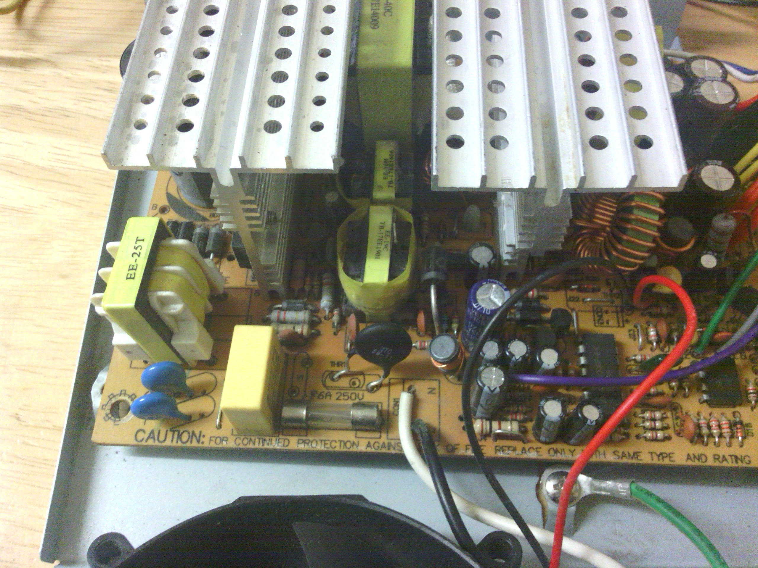

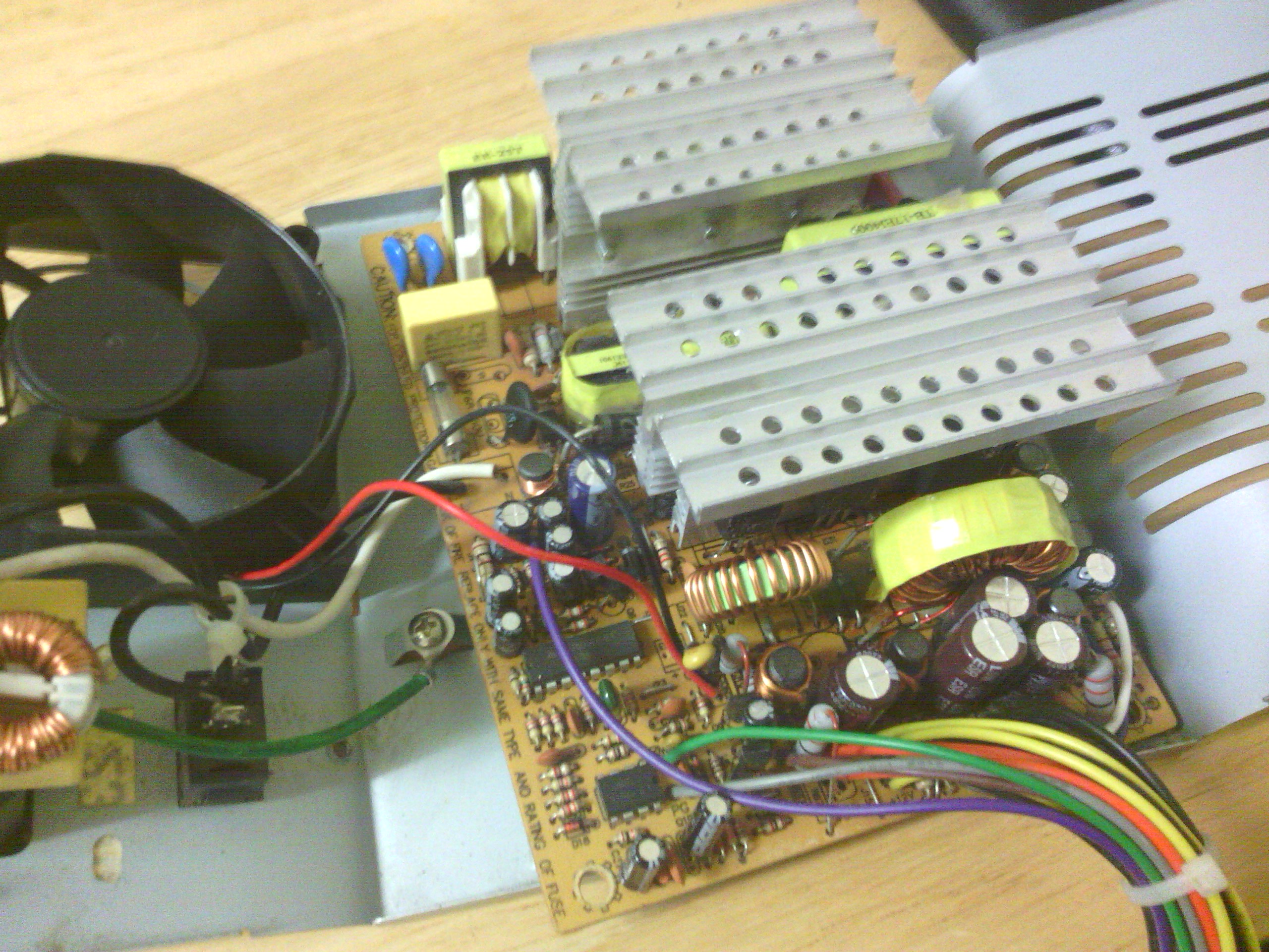

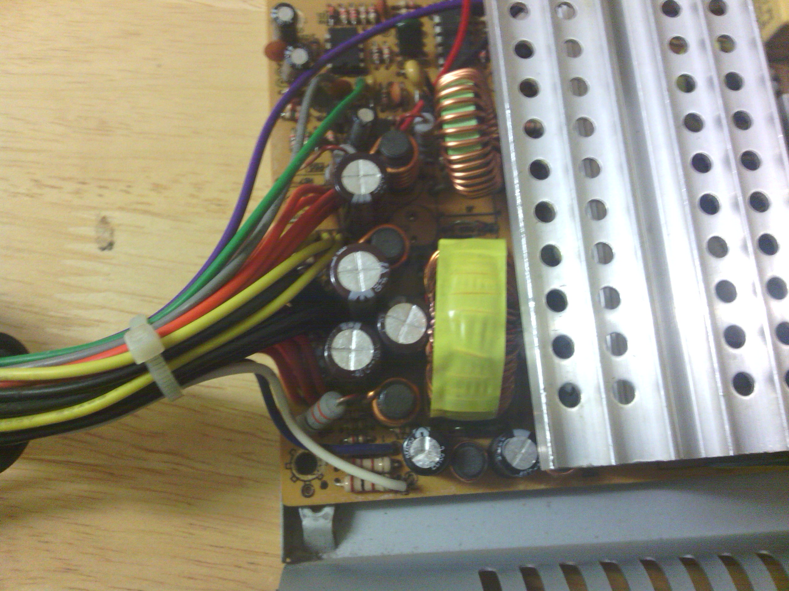

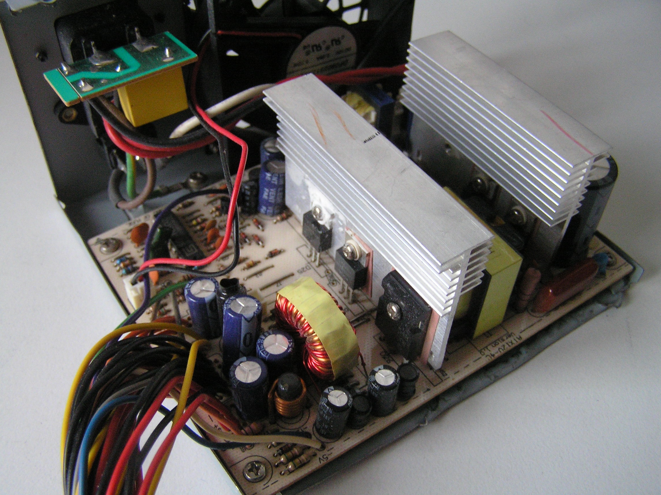

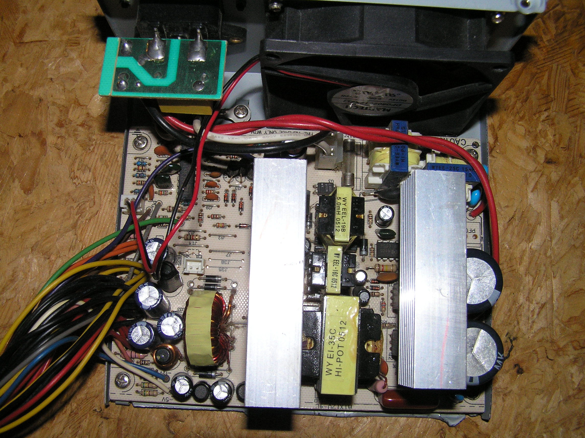

    Hello All members of badcaps,
    I got this PSU with a modded PC, so some parts of the metal case are removed.
    I know it is from A Olidata computer. And it had two fans.
    The Capacitors are from MK, FULLTEC (some L.ESR series, lol) and Fuhjyyu.
    Can someone please give my more information about the wattage, brand, quality etc. ?
  • mariushm
    • May 2011
    • 3799
    Re: Unknown PSU
    Well, it looks quite nice for an old design power supply - the -12v and -5v rails tell you that it's old design. But it has good input filtering, it has connector on pcb for passive pfc, it has actual sockets for fans and not just wires soldered directly on board, it even has inductors for filtering -5v and -12v which are often removed to saved money by other manufacturers, so it's not bad.
    Should be quite capable of 200-250w continuously, maybe even 300w.. but it depends on the chips on the heatsinks.
    If you tell us what's written on those chips, we may be able to give you more details.

      Thank you for the quick reply
      On the big heatsink in the middle are the next chips (from left to right): 40N03GP, STPR1620CT, SB3040PT
      The other heatsink has two 13007 chips
      • mariushm
        • May 2011
        • 3799
        Re: Unknown PSU
        The 40N03GP is probably used for 5v standby or to create 3.3v out of 5v (using a switching controller)
        STPR1620CT is a 16A ultra fast recovery rectifier, probably for 12v rail. But this could also be for 3.3v and the 12v rectifier could be on the other side of the heatsink.
        SB3040PT is a 30A schottky rectifier, probably for 5v
        These are Ok parts for the power supply design, cheaper power supplies use worse components.
        The two 13007 are old chips, classics, and can do 250-300w like I said, provided they're cooled adequately and the circuitry around them is well made.

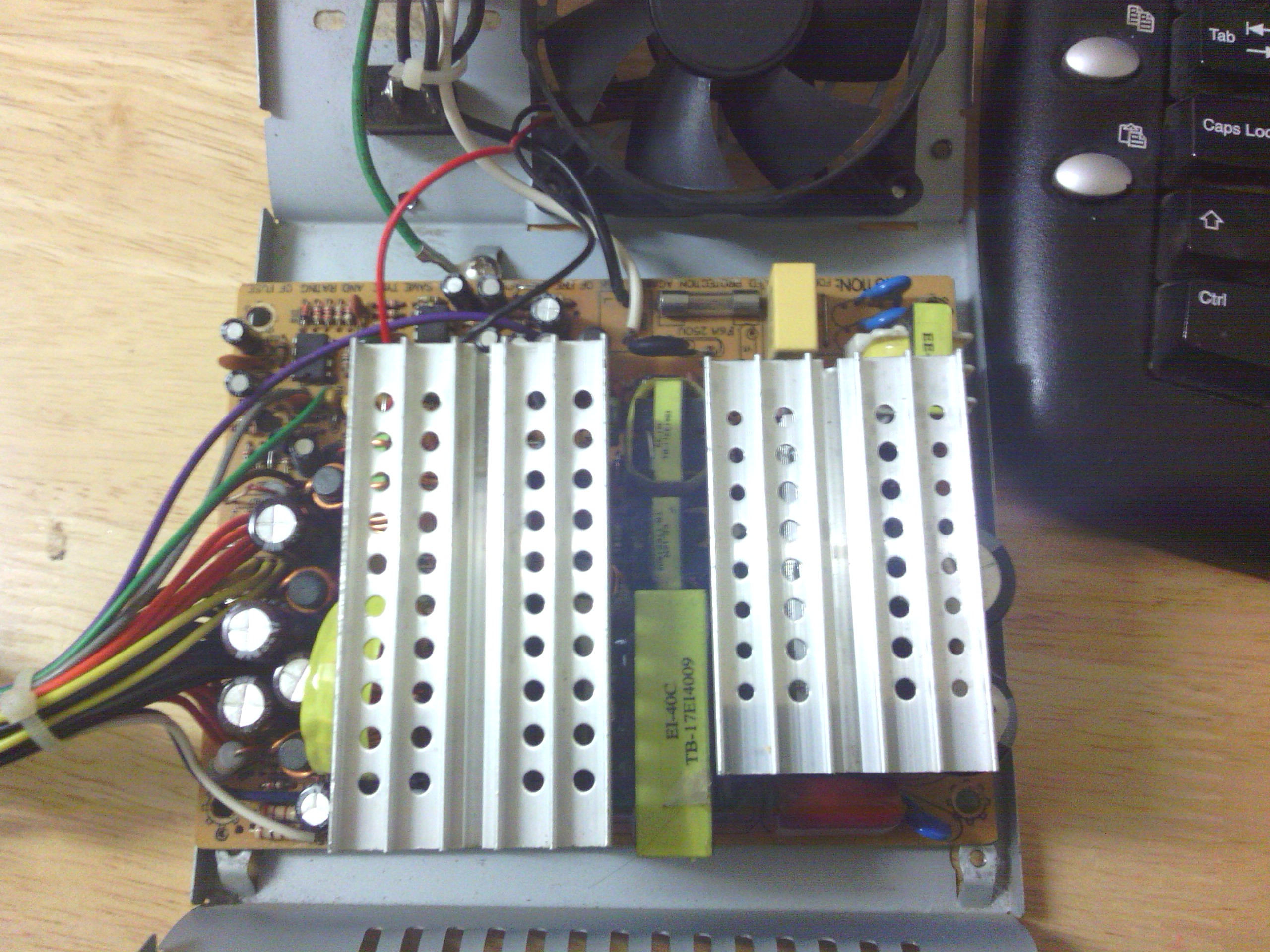

        • jm20101
          • Sep 2012
          • 51
          • Netherlands
          Re: Unknown PSU
          There are no more resistors on the back of the heatsink, so yes its probably for the 12v rail. I'm still learning more and more from this useful, great forum.
          I will take a look to a second fan, and maybe give it a recap (the cap brands aren't good I think)
          Anyway, this PSU have lots of working hours, i'm sure it was at least 5 years old
          One more question: wich capacitors do you advise to replace?

            The date code on the transformers indicate those transformers were made in the first half of 2005. I'd expect the power supply was built around the same time.

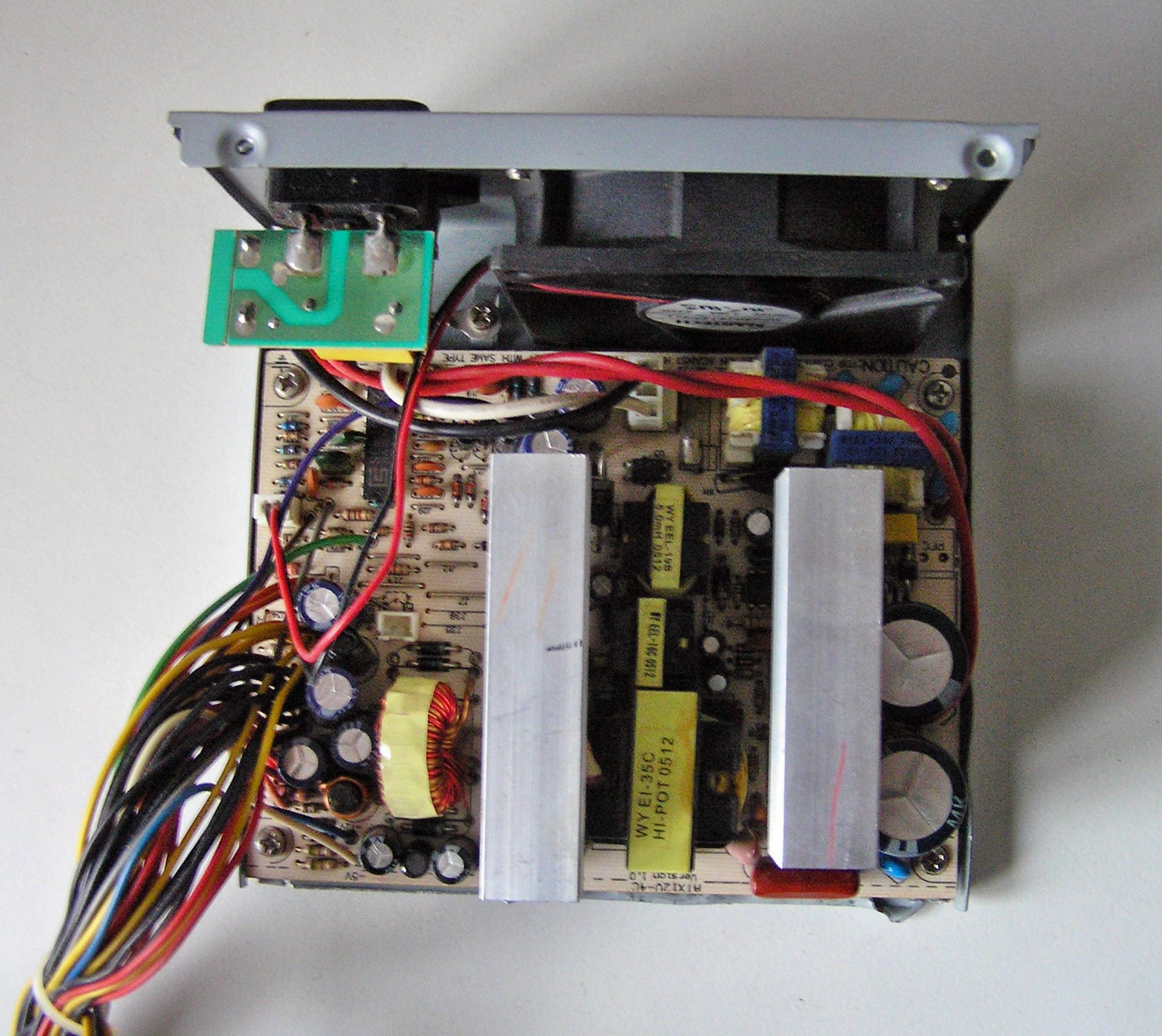

              Very similar to the one that died on me the other week.
              Here is some pics.
              It was an EZcool ATX-500 JSP
              500w
              Do NOT touch heatsinks when testing for voltages as they may be LIVE!

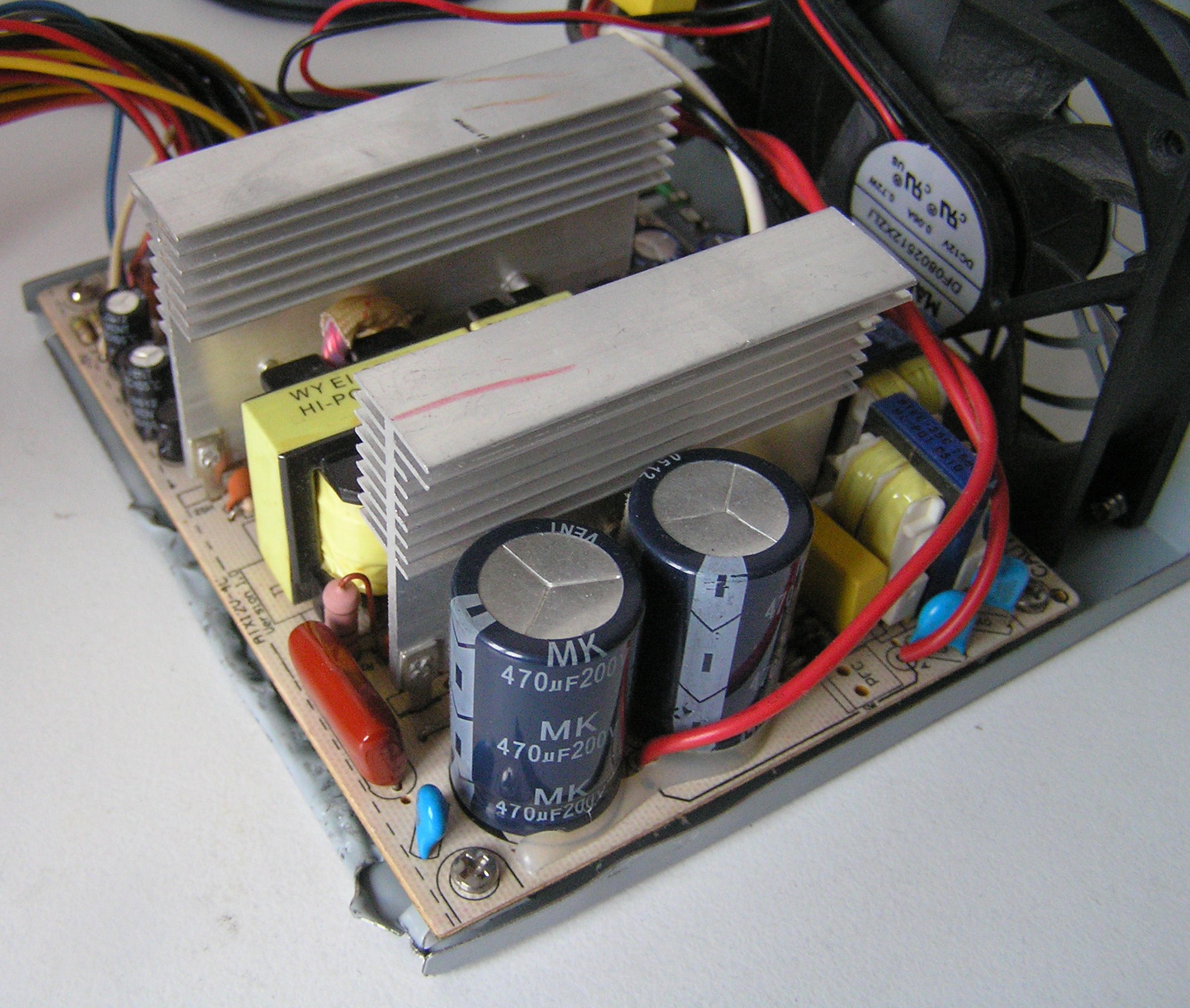

                Re: Unknown PSU
                Looks like that could do 300W, maybe, with a headwind.
                What's the capacitance of the main 200V capacitors, out of interest?

                  Re: Unknown PSU
                  Here is some pics.
                  500w
                  Really? I don't think they look anything like each other.

                    Re: Unknown PSU
                    His are 470uf as in pic?
                    Mine was 820uf.

                      Heatsinks a little different but the layout look similar to me.

                        Re: Unknown PSU
                        820uF puts it at high 350W to low 400W on a good day, the ripple will go through the roof much higher than that, which will probably lead to other failures.
                          Here is some pics.
                          500w
                          That one looks like a Sun Pro built unit. Quite different from what the OP has IMO.
