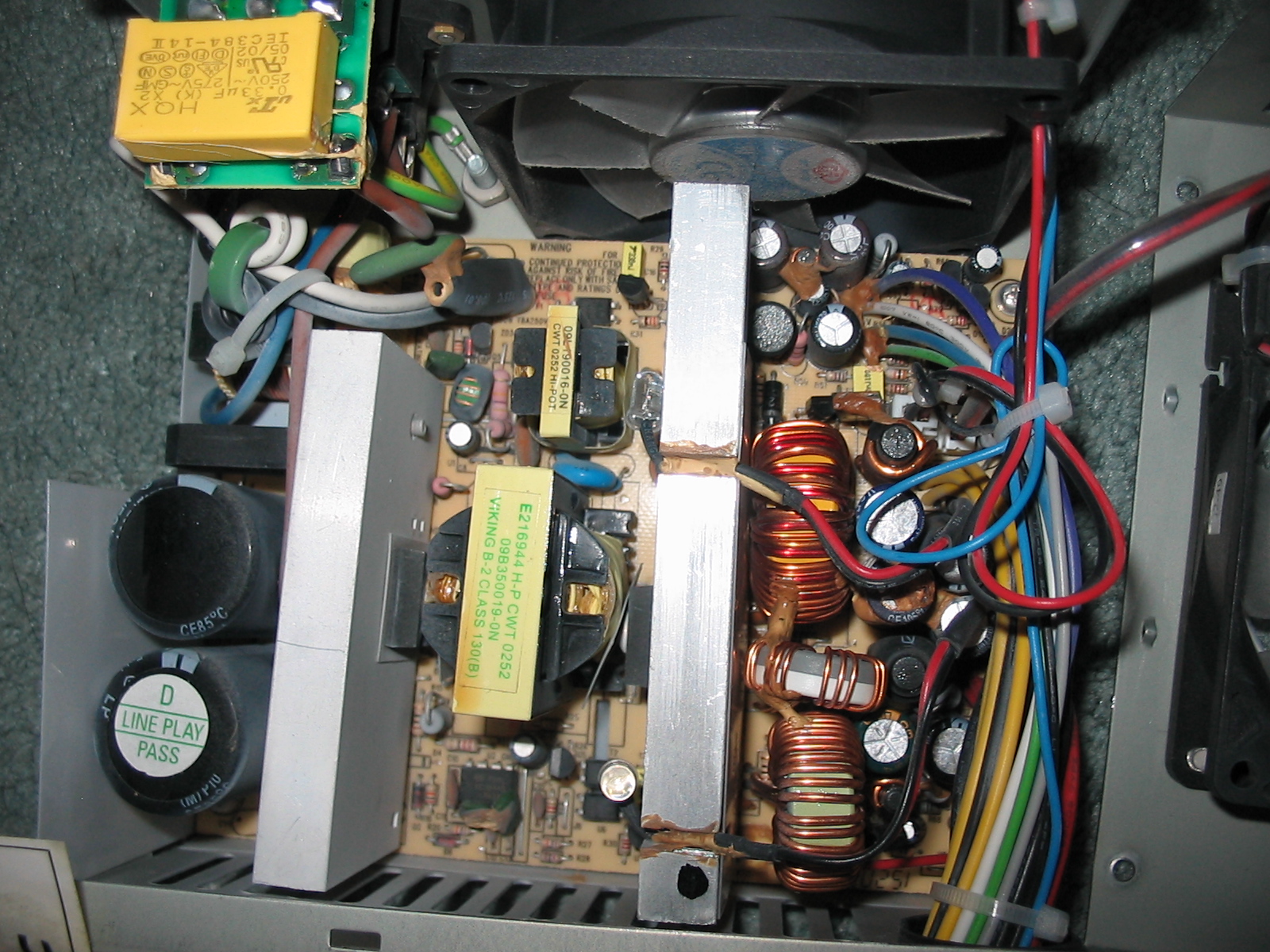

                        Well I finally got around to taking the Smartblue out and to my surprise this is an SL350. And it uses a UC3844 controller, not a KA7500C -- so it's related to the SP300 not the SP400 that I thought!!! However the 5VSB is the same as pretty much all the CWT's...
                        Bad Capacitor hunting time... and it's still full of fuhjyyu's. And one Teapo. And two Capxon's...
                        Just the Fuhjyyus appear to have pressurized and leaking...
                        And a new observation: Yay I get 6.2V out of 5VSB from this PSU... Hello motherboard killer!

                          Replaced C8 (47uF 25V) and +5VSB is now back down to 5VDC.
                          C8's ESR was pretty bad.
                          I'll have to replace the output caps some other time but for now they'll have to do. The ripple on the +12V line is also really bad... but it'll have to wait...

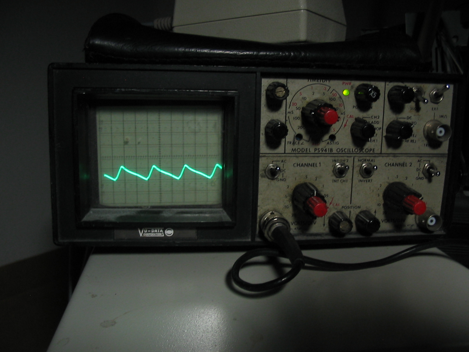

                          Attached is a picture of my 'scope and time for you all to say *ouch* ... Yes that's like 0.7V ripple at about 70KHz is it? That's weird, didn't think these UC3844's go that fast...
