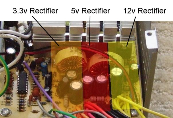

Upgrade a 300watt noname power supply
  • TELVM
    • Oct 2012
    • 547
    • Spain
    Re: Upgrade a 300watt noname power supply
    Originally posted by bauto601
    ... I don't know which rectifier is what so i don't know which is the the 3,3, 5 and 12v rectifier. Can you tell me which rectifier is what? ...
    The color of the output wires can give you a clue:
    Often the +3.3V rectifier is aligned with the orange wires, the +5V with the reds, the +12V with the yellows.
    To be sure test for continuity between the center leg of each rectifer and the orange/red/yellow wires.
    Last edited by TELVM; 12-16-2012, 08:37 AM.
    • c_hegge
      • Sep 2009
      • 5219
      Re: Upgrade a 300watt noname power supply
      On your PSU, the BYQ28E is for the 12V, the STPS2045CT is for the 5V rail, and the STPS1545CT is for the 3.3V.
      EDIT, you could use those other heat sinks, but maybe bend the fins outwards, that way, you will get some airflow between them
      • everell
        • Jan 2009
        • 1514
        Re: Upgrade a 300watt noname power supply
        Originally posted by c_hegge
        The OEM for this PSU is Channel Well (CWT).
        How can you tell that this is Channel Well and not Solytec/L&C?
        Old proverb say.........If you shoot at nothing, you will hit nothing (George Henry 10-14-11)
        • c_hegge
          • Sep 2009
          • 5219
          Re: Upgrade a 300watt noname power supply
          The part numbers on the transformers don't looks like L&C, neither do the heat sinks, and L&C have never used Fuhjyyu caps (whereas CWT love them).
          The PSU in post #20 is an L&C, though
          EDIT: Maybe I should add that the OP's PSU looks like it is from their ISO division, and so it lacks some of the usual CWT features, like green tape and CWT markings on the transformers.
          • bauto601
            • Sep 2012
            • 102
            • Netherlands
            Re: Upgrade a 300watt noname power supply
            I am very busy with school and other computer things at the moment so i will work on it in the weekend but not on school days. So it can take a little longer before i will respond to your post.
