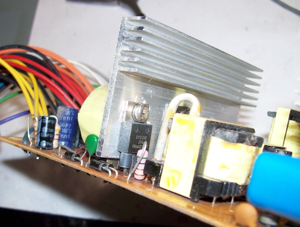

    I have a generic 300watt power supply. The type of the power supply is: Model: ATX-300.
    Here are some pictures of the power supply:
    The overview of the power supply. It looks better than a lc 300watt psu.
    The secondary side of this power supply:
    And some information of the psu:
    STPS2045CT
    STPS1545CT
    BYQ28E
    The filtering stage and the 2 big capacitors:
    I think the diodes are 4Amps and the big capacitors are 470UF 200V
    How can i upgrade this power supply? I want to upgrade it because i want to learn something about power supply's and i like to solder. I was thinking to upgrade the rectifiers at the secondary part of this power supply, but what do you think guys?

    Yes, I'd make sure the rectifiers are all rated for at least 30A. Also, it looks like that PSU used fuhjyyu capacitors. Replace them with Japanese counterparts. It looks like there's ample room for larger capacitors too, so beef the ones after all of the coils up to 2200 or 3300uF.
    The OEM for this PSU is Channel Well (CWT).
    EDIT: You could also improve the primary side. Replace the diodes (those are 3A, not 4) with a 6A rectifier, and the primary caps with 680uF or better.

      Nice to hear that my english is not so bad at all! So larger primary caps, bigger rectifiers at the secondary, bigger caps at the secondary and replace the diodes for a 6A rectifier. And how much can the power supply deliver after changing all the components?

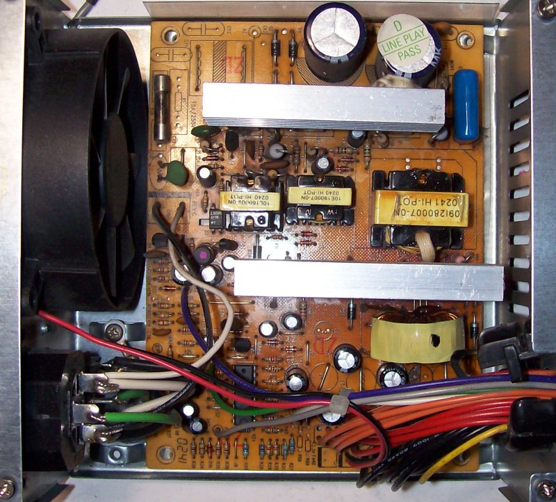

                                    Here a pictures of the power supply now:
                                    All the parts i use in this power supply come from other (broken) power supply's. So i found this heatsink on a old broken power supply:
                                    The red line on the big heatsink is the line that i am going to follow if i am sawing the heatsink in the right shape (is that good english )
                                    I am going to place a fan at the front of the power supply and at the back of the power supply.
                                    Here a picture of the new (ehhh.. from a old psu) rectifiers:
                                    I can't find anything of the 1st rectifier.
                                    Are these rectifiers good ones? And how can i replace the diodes with a rectifier? I also hear that i have to replace almost whole the power supply so this is going to be a job for the whole week

                                      Those rectifiers are fine. Use the BYV42E on the 12V rail, the MBR4045 on the 5V rail and the SBL4040 on the 3.3V Rail. Sometimes, if you unsolder the 4 diodes, the PCB will be screened for a rectifier as well. Do that and post a shot of what's under there.
                                      Your new heat sink looks nice and chunky, although you may have to drill a couple of extra screw holes for the rectifiers. I'd install it with the overhang over the toroid coils and caps, not over the transformer. The other consideration is that you don't want the primary heat sink to be much smaller than the secondary one if the fans will have a speed controller, because the secondary heat sink (which controls the fans) could stay cool, while the primary heat sink is red hot, and the fans won't speed up.

                                        To begin:
                                        I don't know which rectifier is what so i don't know which is the the 3,3, 5 and 12v rectifier. Can you tell me which rectifier is what? The big heatsink is made of too thick material so it wil short some components on the pcb.. But from another psu i have these heatsinks:
                                        Are these big enough?
                                        Also, this psu has no fan control so it is making terrible noise when it's on. After replacing the rectifiers i am going to test the unit and a.fter the testing i am going to unsolder the diodes.
