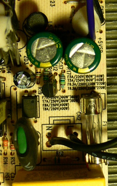

    This one had a post-it on it saying "Dead". Visual inspection through the rear grille - fuse blown to smithereens This, disregarding the fact the silkscreen only specs the platform up to 400w (despite it being marketed as a 500w unit)

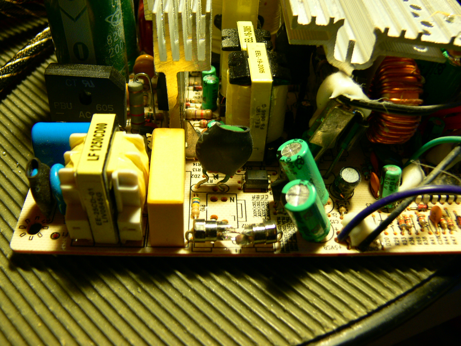

    After removing the board from the casing, first step was removing the fuse (see picture no.1), and soldering in a pair of those metallic fuse holders. Popped in a 6.3A fuse, and hooked up the whole thing through a bulb-tester. No flash, no nothing; measured the 5Vsb, meter said 1.8v
    Moment of revelation - with the passive PFC coil removed, there was only a 1.8u film cap in series, supplying AC to the rectifier bridge Soldered in a jumper. Result = 5Vsb = 5.063v, but bulb is lit quite strongly, and flashes at some frequency (~50Hz-ish or so). Voltage across the pair of main caps is around 250v DC, which is on the worryingly low side (should be around 320v or so).

    Any thoughts?

    Same "flashy" behaviour even with all three primary transistors out...
    Yep, primary silicon (on the extracted heatsink) checks out just fine.
    Culprit: one shorted diode in the 6A 600v bridge (1,6mV drop, as opposed to ~550mV for the other three healthy ones)
    Popped another PBU605 (6A 600v) bridge in, normal "single flash" upon plug-in
    Primary silicon/heatsink back in, no lit bulb, 5Vsb = 5,063v
    Plugged in a fan, shorted green to ground, et voila, it lives once again 5.17v, 3.335v, 12.325 (with only a fan loading the 12v).
    Recap coming up Some Panasonic FK's on the 12v, and i'll see what i can scrounge up for the 5v & 3.3v rails :P:

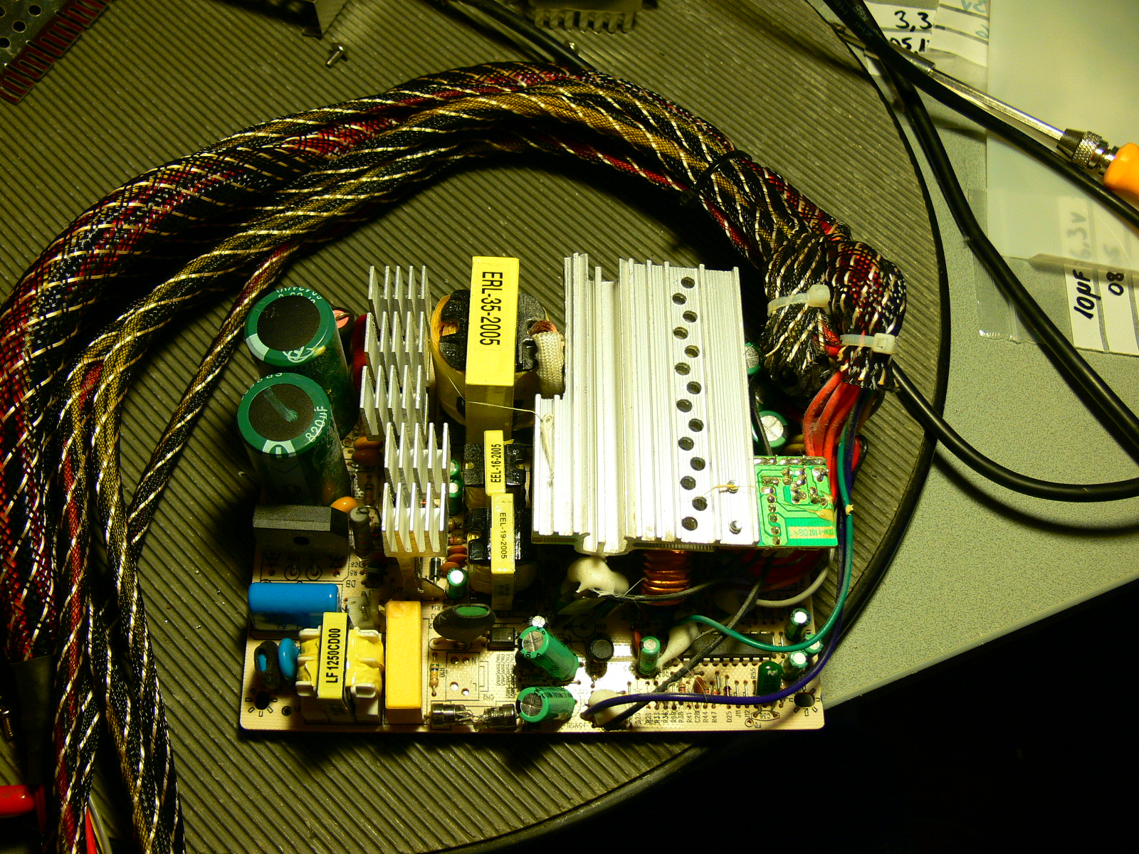

          Re: Job lot PSU no.3: SolyTech SL-8500BTX
          Yep, slapped that pair of Sanyos on the 5Vsb, a couple of Panny FK's on the 12v, and a pair of Ruby MBZ's on the inputs of the 3.3v and 5v pi-filters, and another pair of Sanyos on the outputs. I know, i know, MBZ's might be a bit too low-ESR, but i didn't have anything else low-ESR at 2200u in 10mm cans (and i figured going down to 1500u wouldn't have been too good, for the pi filter inputs)...
          Slipped in a Panny FR to replace the -12v cap, although i skipped a few of the tiniest caps (3x 0.1u near the 2008Z, the pair of 2.2u in the bases of the main switchers, and one or two more i couldn't see the value of, in the middle of the PCB)
