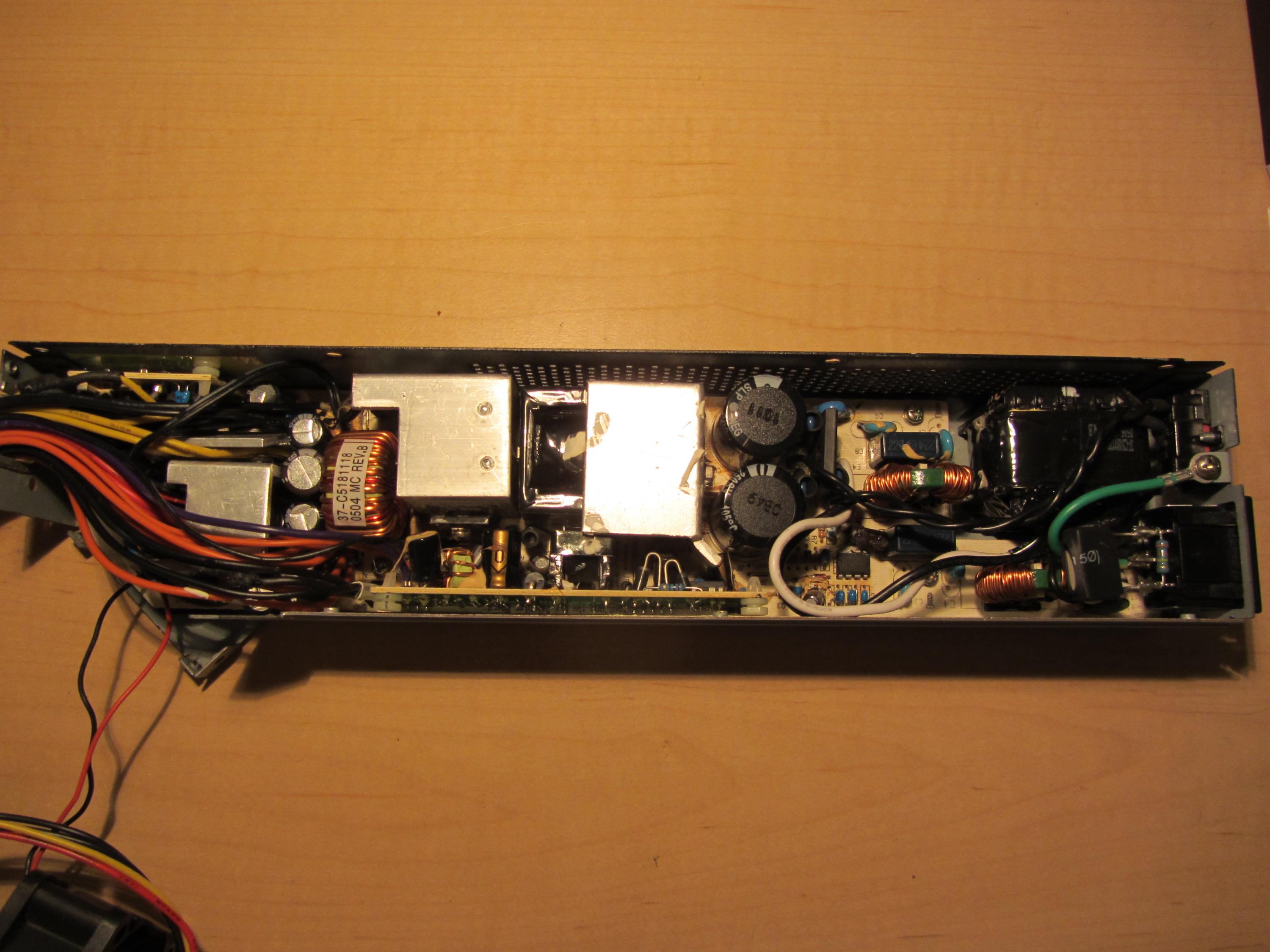

    I have a HP/Compaq DC5000 SFF pc, that uses a proprietary PSU that runs HOT!! It runs so hot that I have had to recap it twice. It even managed to bloat some Panasonic FC capacitors after about 4 years of 24/7 use. I tried connecting the fan directly to 12v, but found that it was very noisy and not very effective. I have also removed the brown glue that goes conductive over time.
    Anyway, I was wondering if it would be possible to increase the efficiency of the supply, and reduce the heat output, by replacing the primary side mosfet, which is a single Fairchild 9N90C 900v 9A part with a RDS of 1.4 ohms with a part with a much lower RDS. I was thinking something along the lines of a Fairchild FCPF22N60N, which has a RDS of 0.165 ohms and a better (22A) current rating. However, the voltage rating is lower, only 600v, and I was wondering if that would cause a problem.
    I was also thinking of replacing the secondary side rectifiers with parts with a lower forward voltage drop. I assume as long as the voltage and current ratings are the same or better, that I should have no problem there.

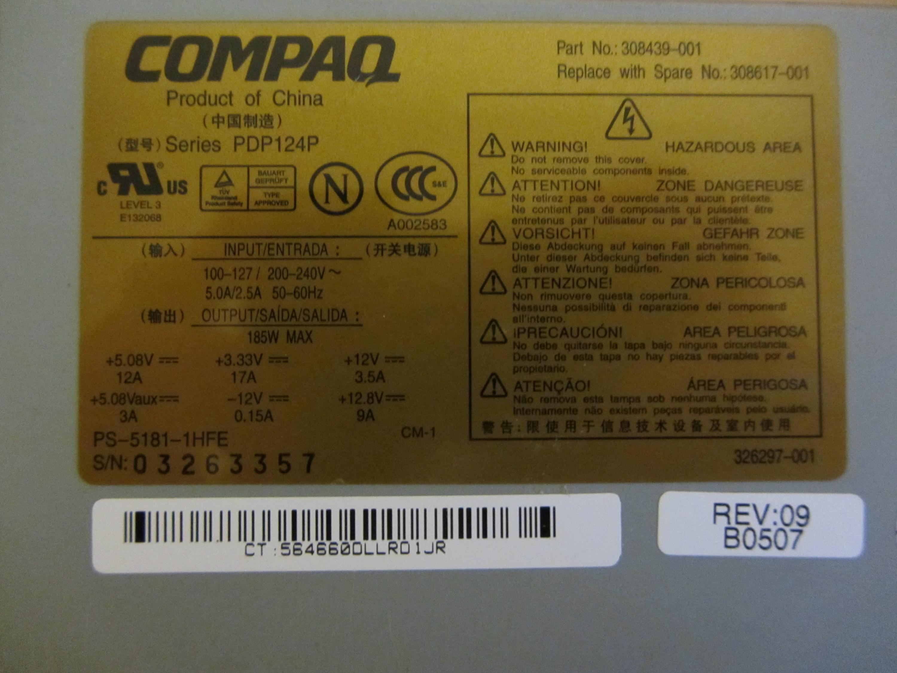

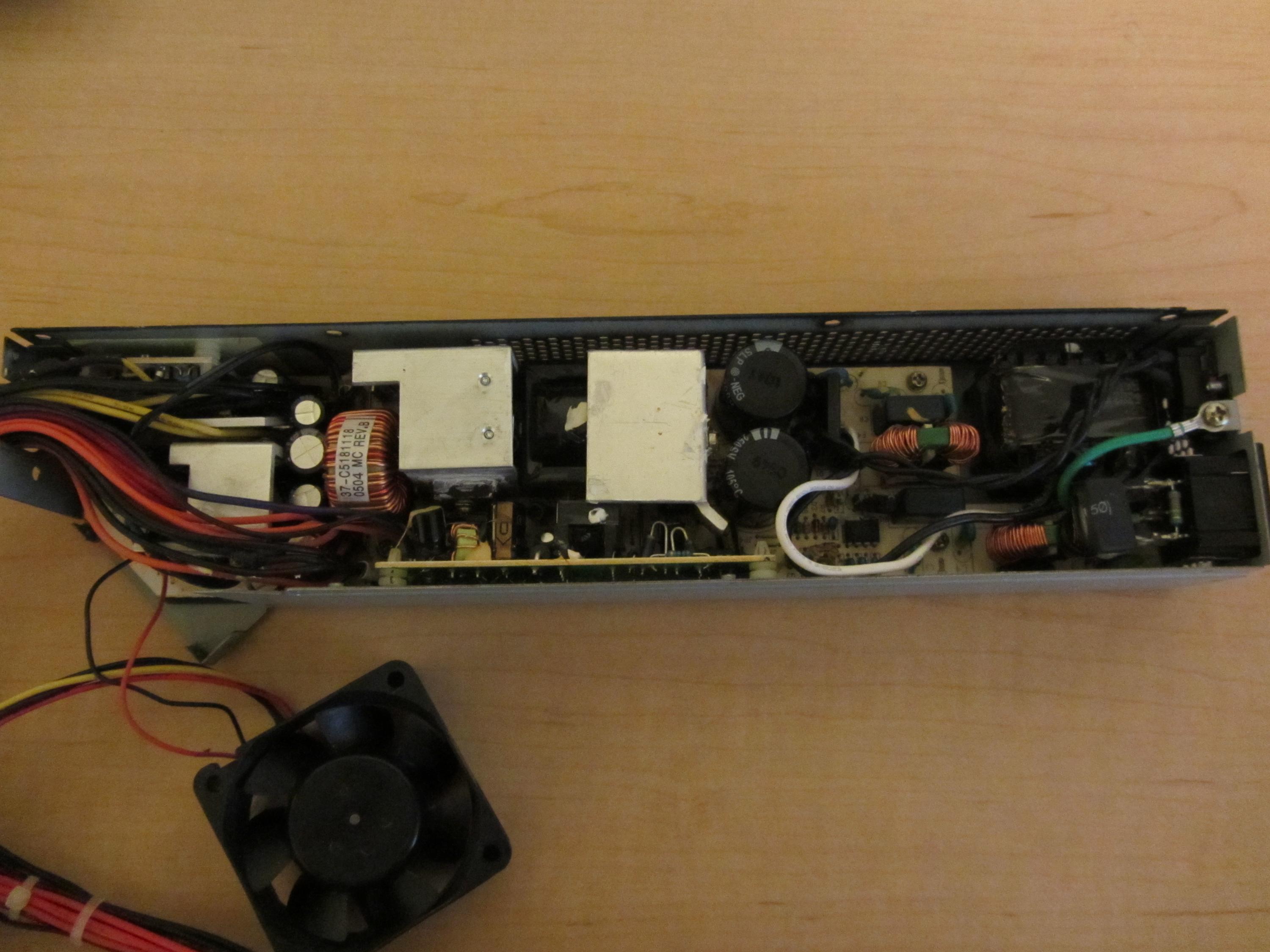

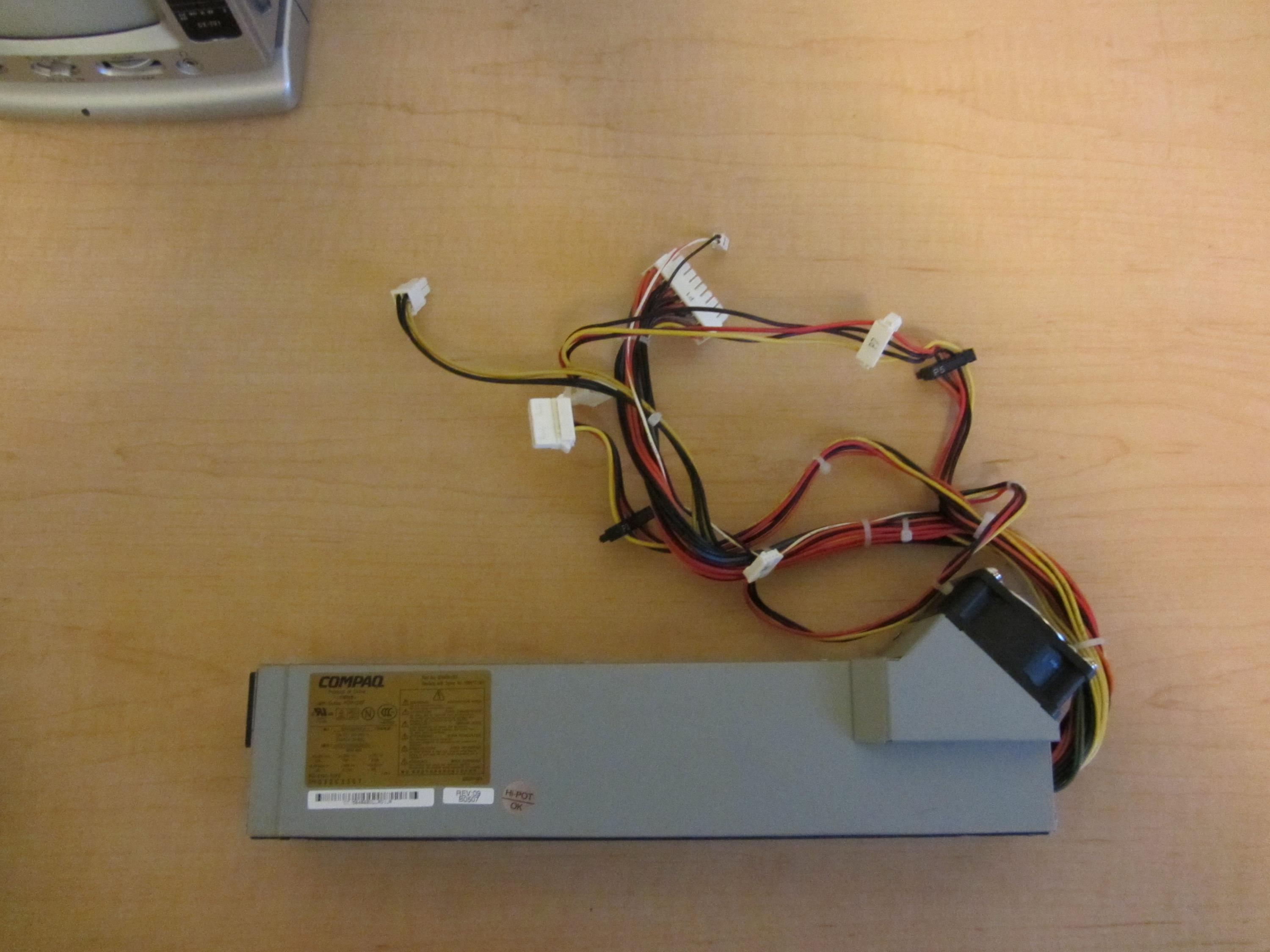

                        I have ordered the STP21N90K5 along with some other parts, from mouser and I will report back on how it goes once the order arrives. Hopefully, it won't .
                        Here are some pictures of this psu.

                          Joke-type fan? You can try to tie the wires together inside, may get a small bit of airflow.

                            HP did a very good job with these DC5000 SFF computers in terms of planed obsolescence. We have about 50 of them at work, 30 stacked and waiting for a motherboard recap. Guess who's in charge of that task? .... yup . I have done 7 so far. YAY!
                            As far as the power supplies go in these: at least the ones I opened from the 7 machines I recapped, only one had bad caps in the power supply and that's because that one had the fan not working. The other PSUs seem fine (these PSUs usually use Ost or Samxon, and occasionally United Chemicon - depending if Lite-On, Delta, or Chicony/HiPro made them).
                            Funny thing is, there's actually about 20x3x5 cm of extra space in the case above the power supply. So HP could have actually designed those PSUs to be a little larger and use a larger fan. But I guess they didn't want it to last. Also, the D530 SFF shares the same case as the DC5000, but the D530 has an AGP slot and 2x extra full-height PCI slots via an add-on PCI card that positions these full PCI slots perpendicular to the motherboard and right above the PSU free area - so that's most likely another (dumb IMO) reason why HP made the PSUs so small.

                                I just got around to recapping my DC5000 and replacing the mosfet + rectlifier and now it is running much cooler. Instead of scorching hot, it is now only barely warn to the touch. I would call this experiment a success!
