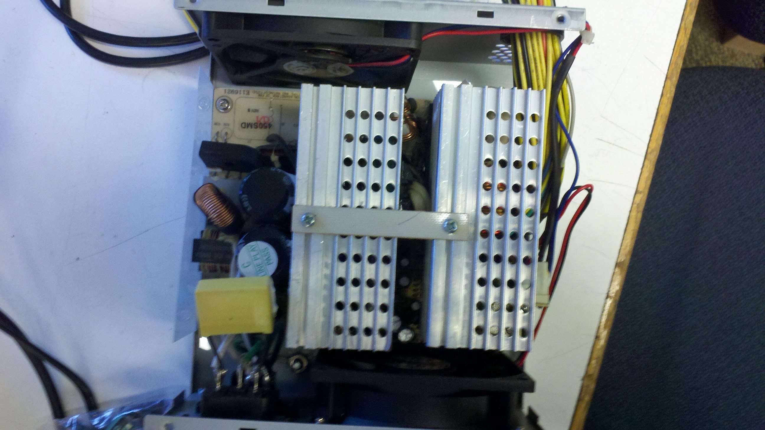

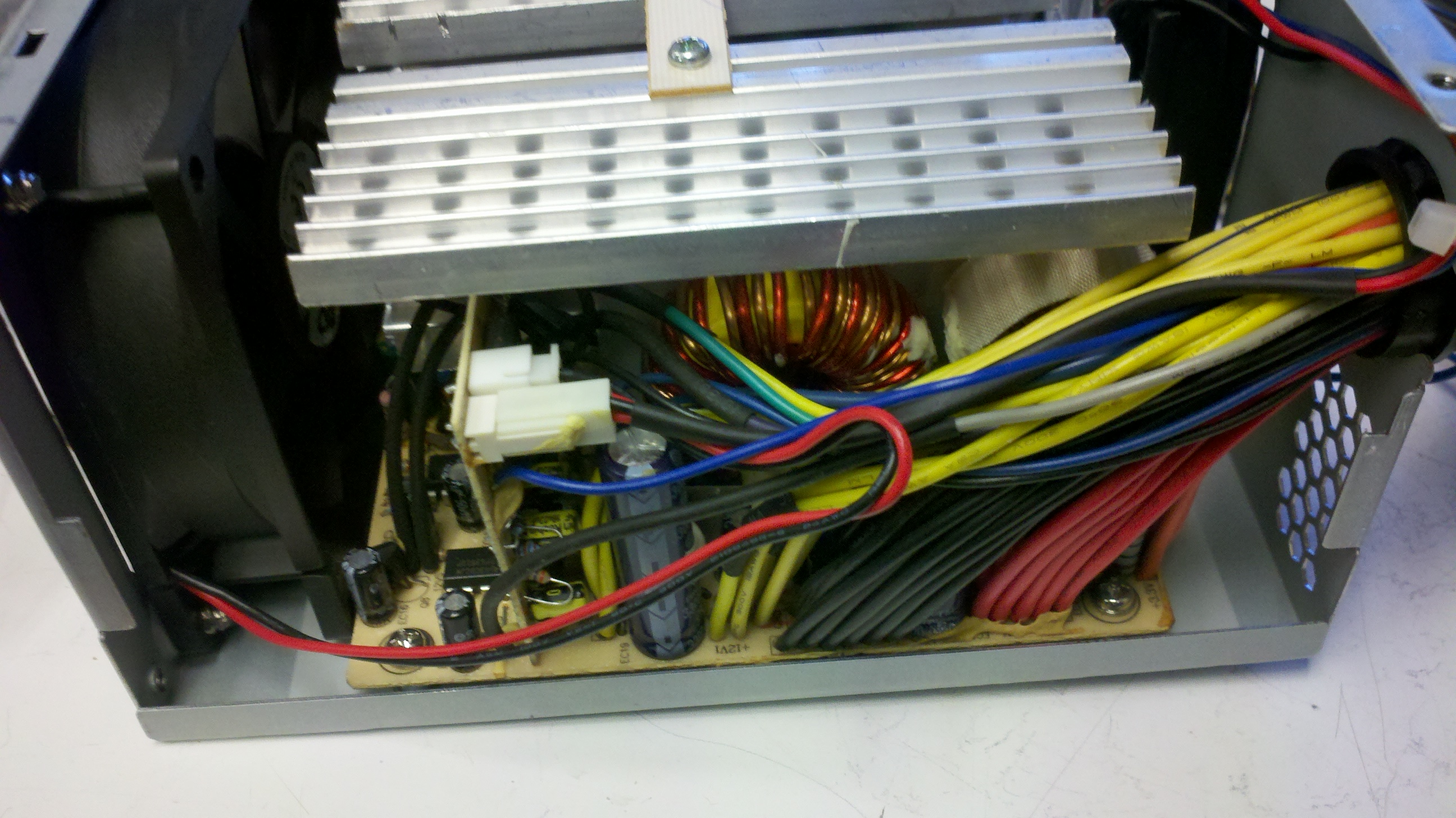

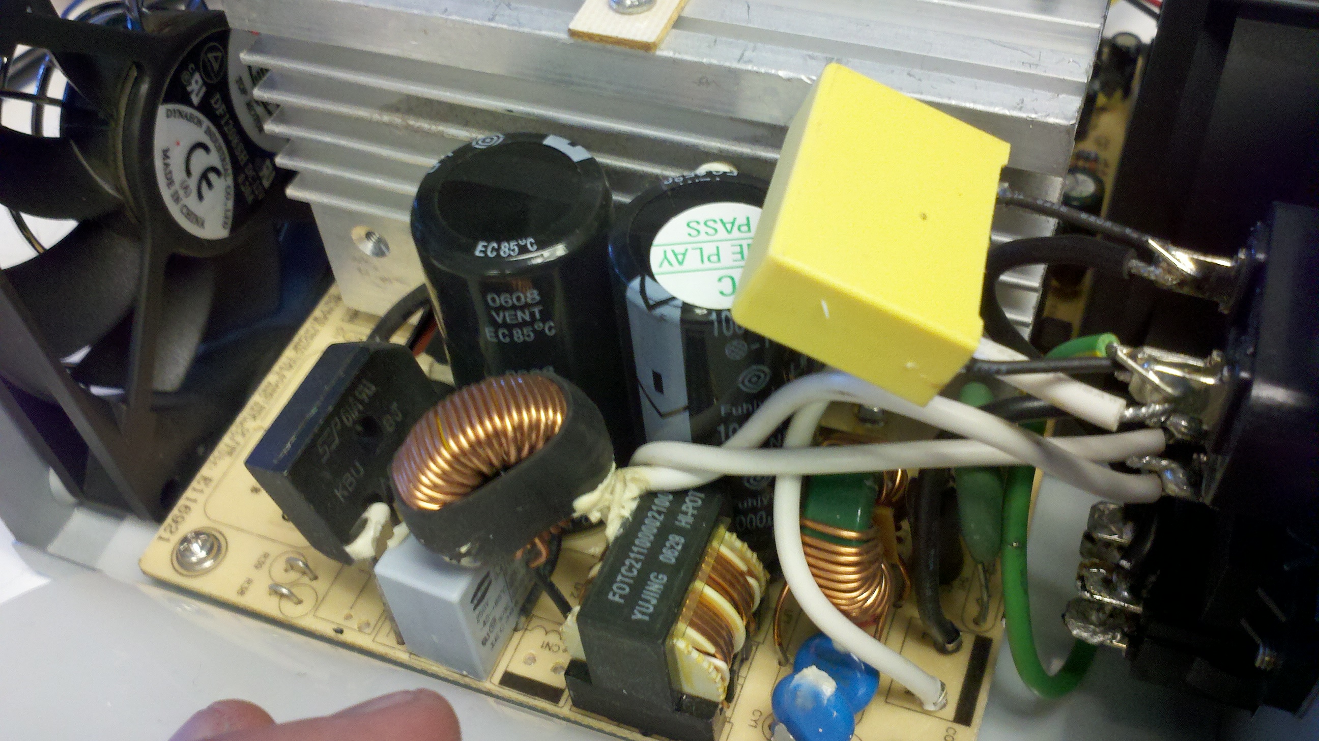

    Computer was brought in that wasn't powering up, saw the Stupid Power sitting in there and knew why When plugged in all it gives is a high pitch whine, and when unplugged slowly fades quieter until it's silent. Does this mean that the 5VSB is working? It has an Asia-X cap on the 5VSB and the rest of the caps consist of Teapo, Koshin, Fuhjyyu, the primaries also being Fuhjyyu I dusted it out and removed some glue in it, I'll upload some pics

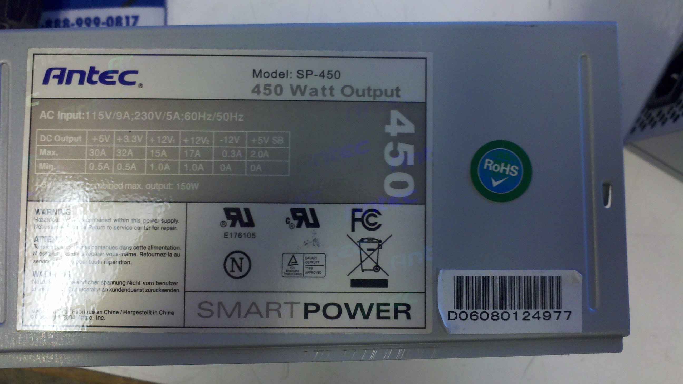

                I guess I'll just recap the 5VSB to start and see if that does anything. And if any of you guys know, what is the combined 12V output on these PSU's? Here are some pics for those who want to see
                  Re: Have an Antec 450W "SmartPower" that is dead
                  32Ampere (I just added up the 2 rails )

                    Isn't it usually lower though by at least a few Amps since it has 2 rails?

                      It depends on what the rectifiers on that rail are capable of (along with the choice of capacitors and their specs), but if it's one 15A and one 17A rail it probably means that combined it's something like 22A (or 264W), though I could be wrong.

                        A brand like Antec would state such limitations on the label. By not doing that you can assume that the total 12V amperage is the sum of the 2 rails.
