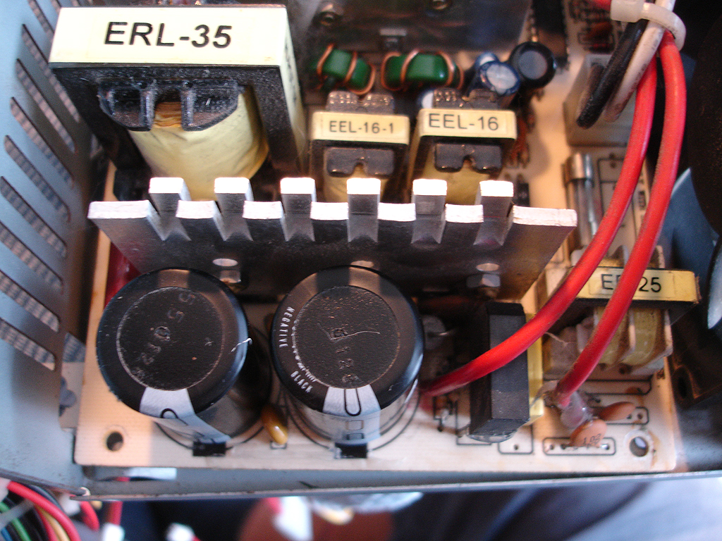

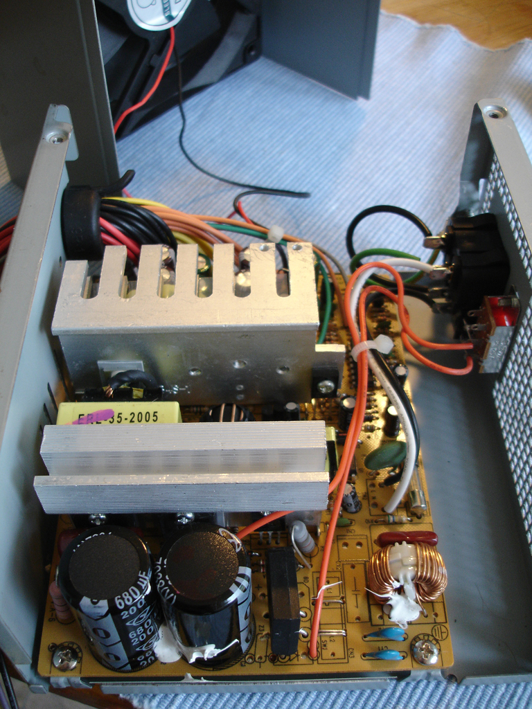

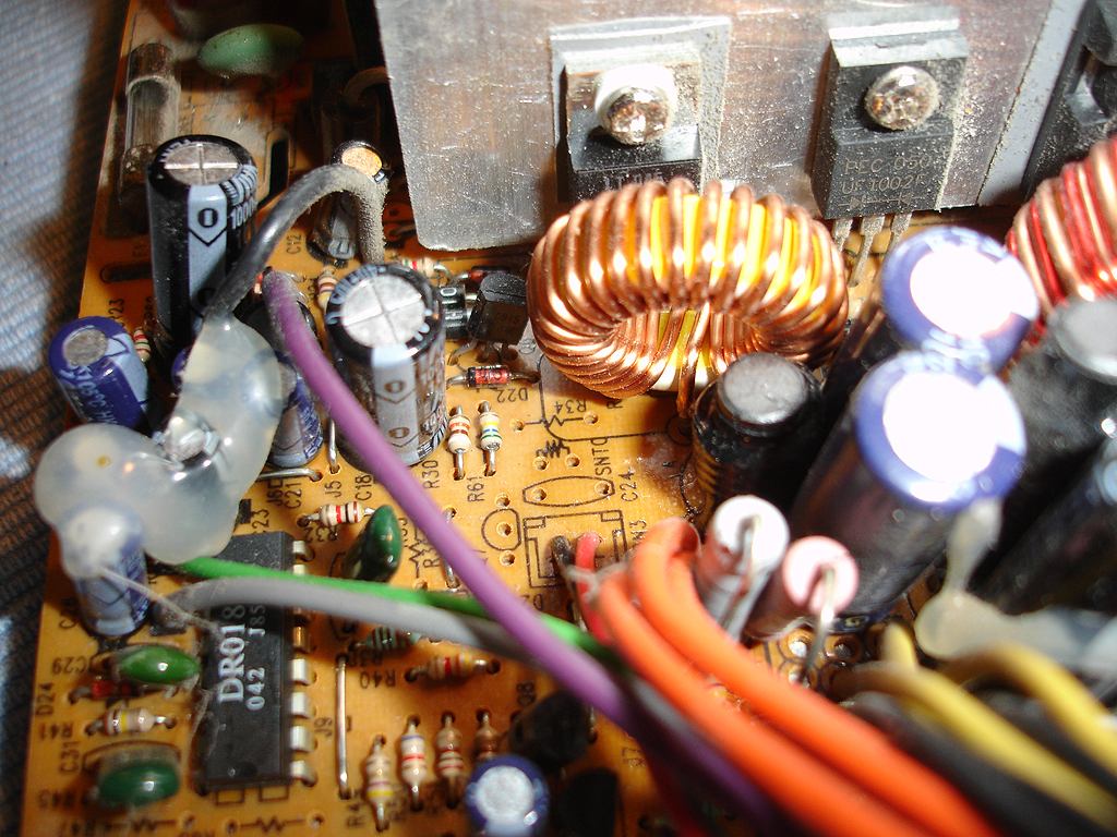

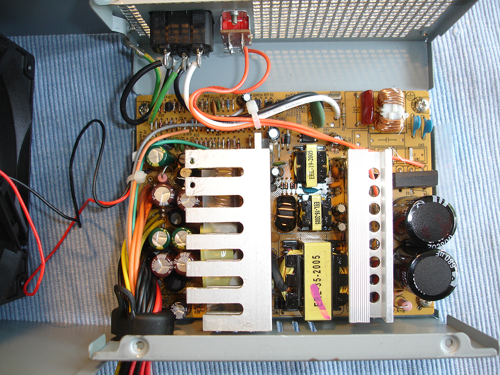

    The PSU in the pics is an ICAN DR-8500BTX Rated at 500W.
    It uses the ERL-35 Transformer and the Primary Mosfets are large, labelled 13009. I suspect the real rating is less than 350 watt.
    I would like to enhance the primary filtering, as you can see I have already yanked out the Asia-X caps and substituted UCC KY and Panasonic WG.
    I have included a pic of the Primary filtering on the SH250 PSU which also uses ERL-35, for comparison, and a pic of an X2 cap I liberated from another PSU that I hope to use in this one.
    If someone can suggest the missing filter elements and where they should go it would be great.
    Thanks in advance

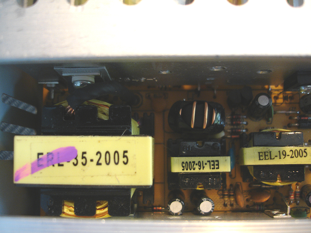

      If I'm not mistaken, size 35 transformers look larger than that... I think that's size 33, which makes it not much more than 250W. So yes, definitely not 350W, much less 500W, though since this is a Deer PSU it's no surprise and it looks halfway decent for a PSU of that ilk. A PBU605 (6A) rectifying bridge seems to be more than enough for 250-350W. Maybe it could use another X capacitor in the transient filtering, if I'm not mistaken (I'm assuming the grey one you removed is from it). It may also be able to use another ferrite coil, and I'd upgrade that transformer to genuine 35 size. Its heatsinks are average at best, in my eyes. Its secondary rectifiers and capacitors will also determine what it can do, along with the quality of its fan. It may be able to use more MOVs too, along with more Y capacitors.

      • goodpsusearch
        • Oct 2009
        • 2850
        • Greece
        Re: Suggest Filtering Upgrade for ICAN PSU
        2 coils
        2 Y capacitors
        2 X capacitors
        1 inrush current limiter (NTC thermistor)
        optional: 1 or 2 MOVs for surges
        You need to add 1 more coil and 1 extra X capacitor (CX2).

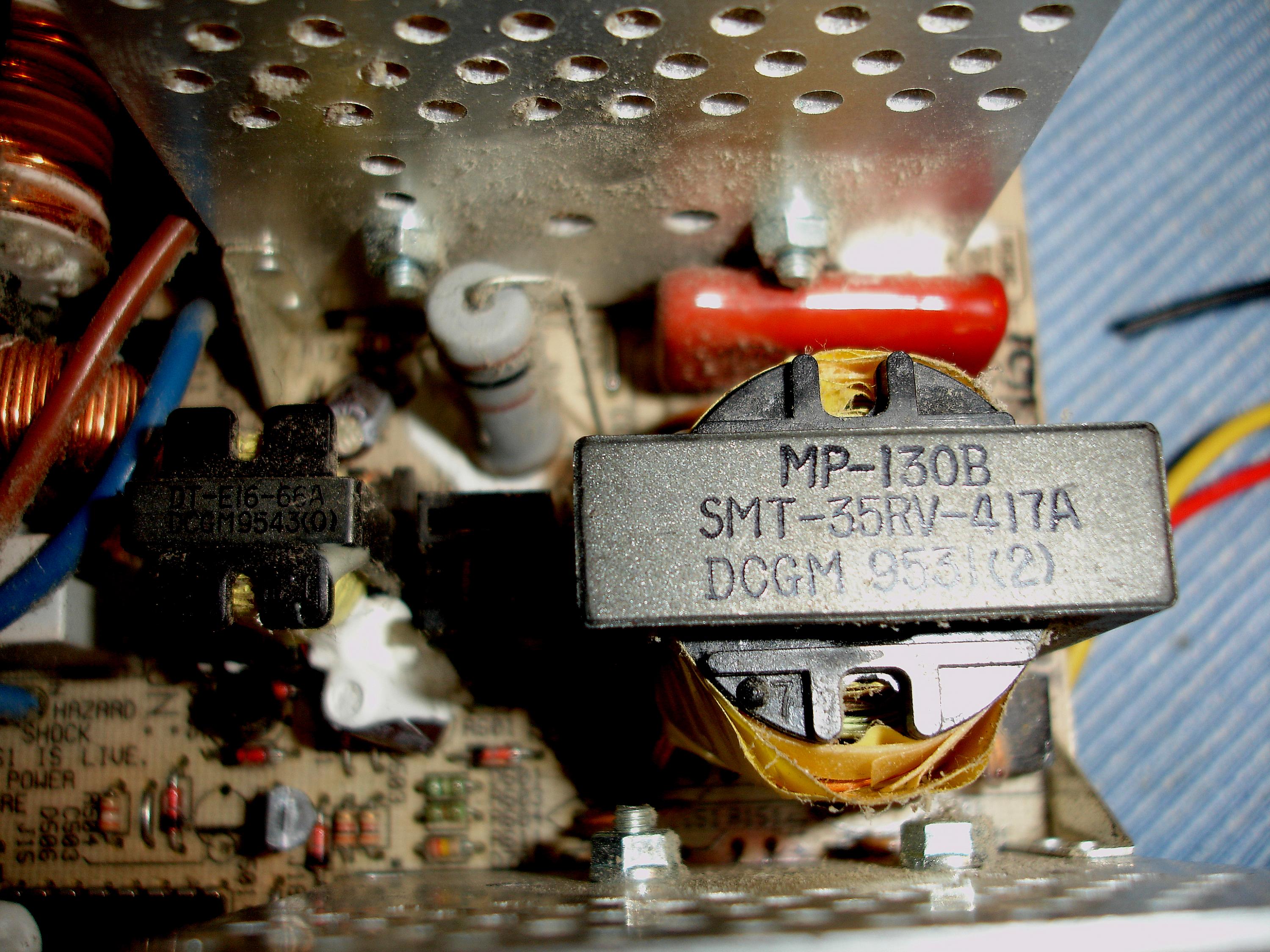

        • Th3_uN1Qu3
          Believe in
          • Jul 2010
          • 6031
          • Romania
          Yes, the one marked ERL-35-2005 is actually an EI-33. Will do 300W, not any more. The one in the 7th pic market only ERL-35, is a real ERL-35.

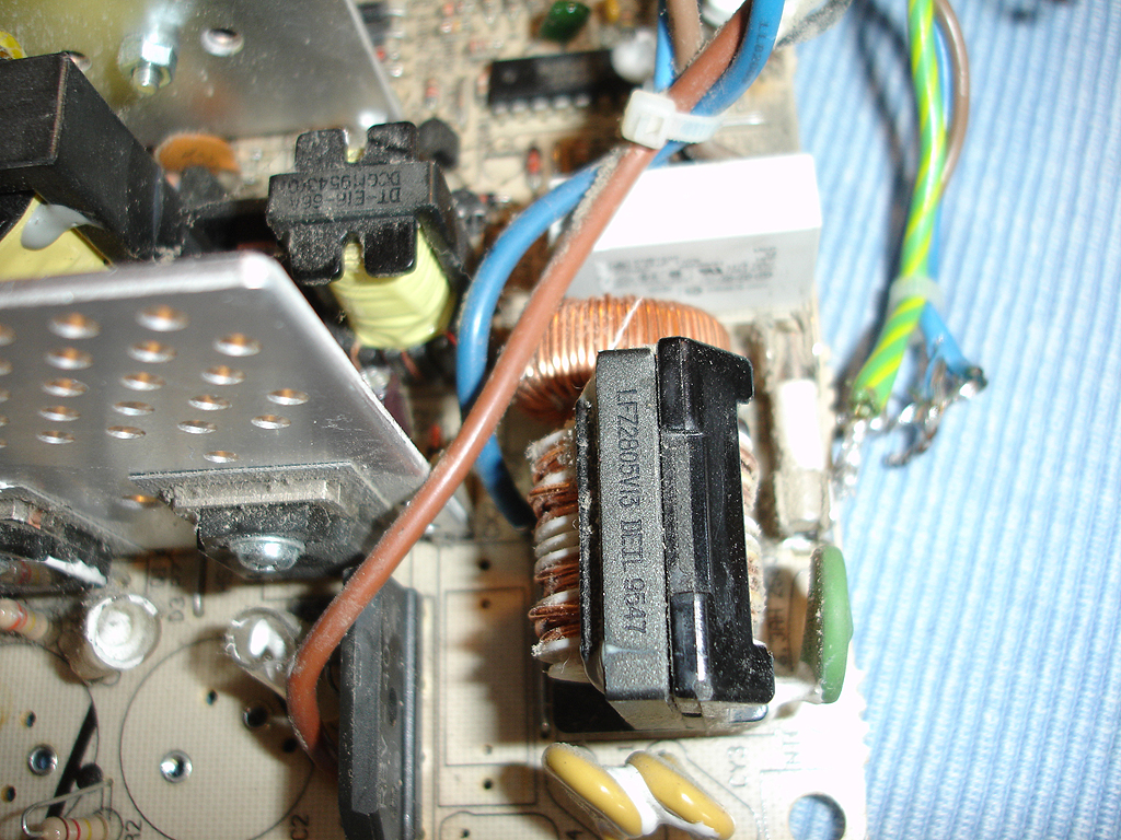

          • bigbeark
            • Jan 2010
            • 661
            Thanks for all the suggestions, much appreciated.

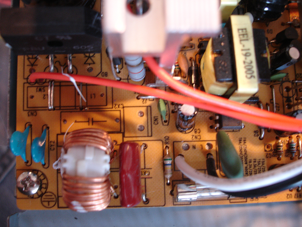

            I'm not very knowlegeable re electronics, so please clarify the following for me:
            I looked up 233191 on CSA site, could not find it. How do you know it's a Deer?
            I removed the grey X2 cap from a different PSU. I am assuming it would go into location CX2 on the ICAN and that orientation does not matter as these caps are not polarized.
            Location CX1 on the ICAN is already occupied by the large brown device.
            Should this be replaced by another X2 cap?
            CN1 and CN3 locations are open. Where does the ferrite coil go?

            So I add the grey X2 cap shown at location CX2?
            Where does the extra coil go?
            Is this thing an X cap?

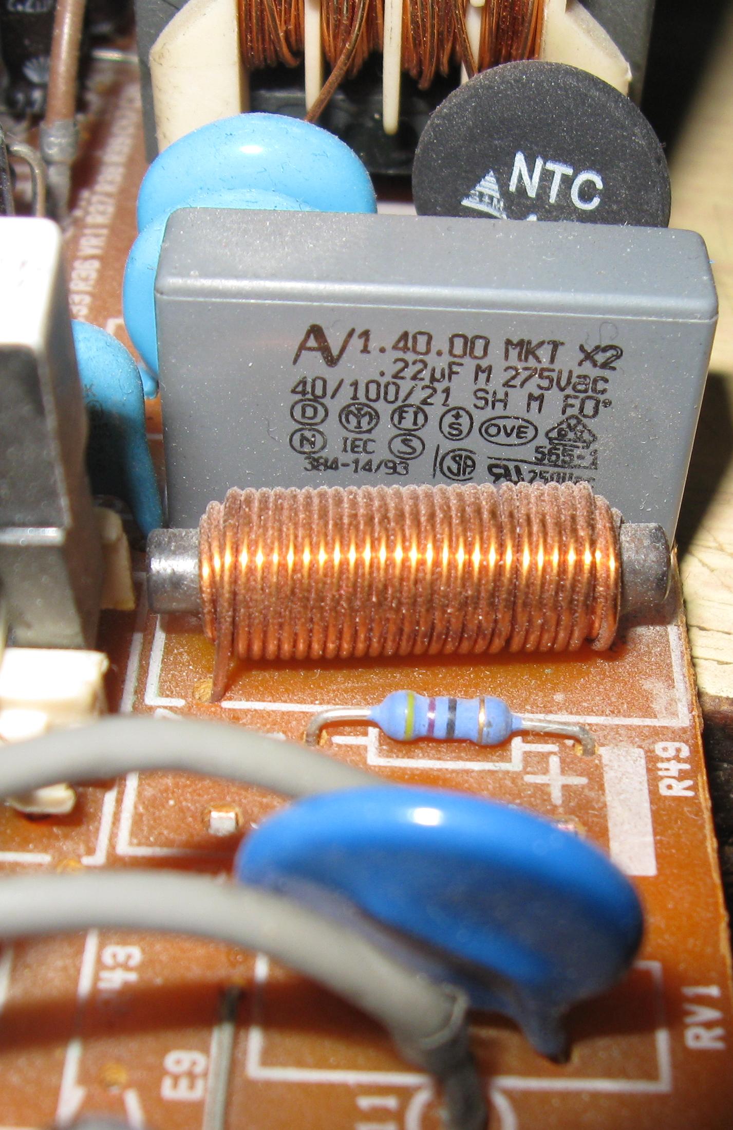

                2 years ago I added a coil at a Deer psu like yours. Here are some photos for your help:
                before:
                https://www.badcaps.net/forum/attach...3&d=1257287093
                https://www.badcaps.net/forum/attach...4&d=1257287093
                after:
                https://www.badcaps.net/forum/attach...2&d=1276874565
                https://www.badcaps.net/forum/attach...3&d=1276874565

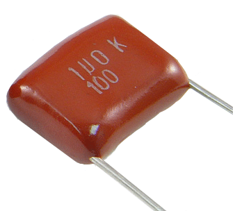

                It's a low quality X cap.
                  It's not an X cap at all. It's a polypropylene capacitor. The difference? In operation - none. However, when subject to excessive line surges, an X cap fails with a puff of smoke and goes open. A poly cap burns and can start a dangerous fire as it will not self-extinguish.

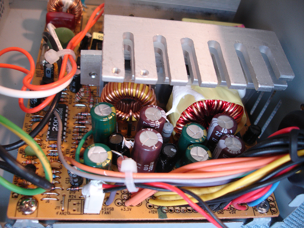

                  • bigbeark
                    • Jan 2010
                    • 661

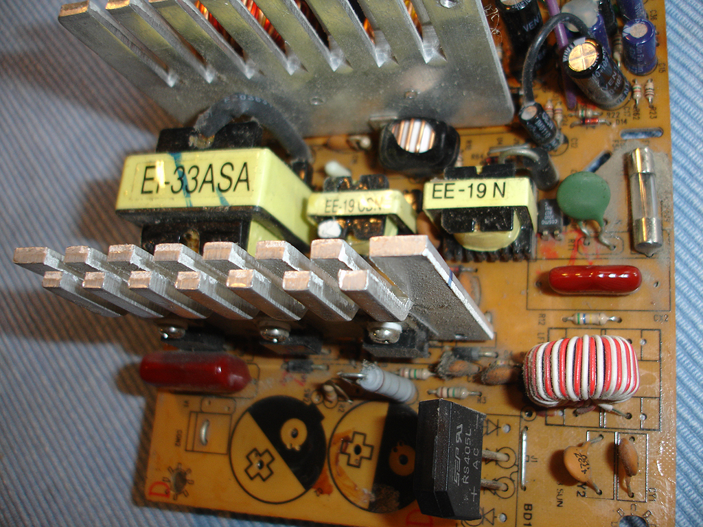

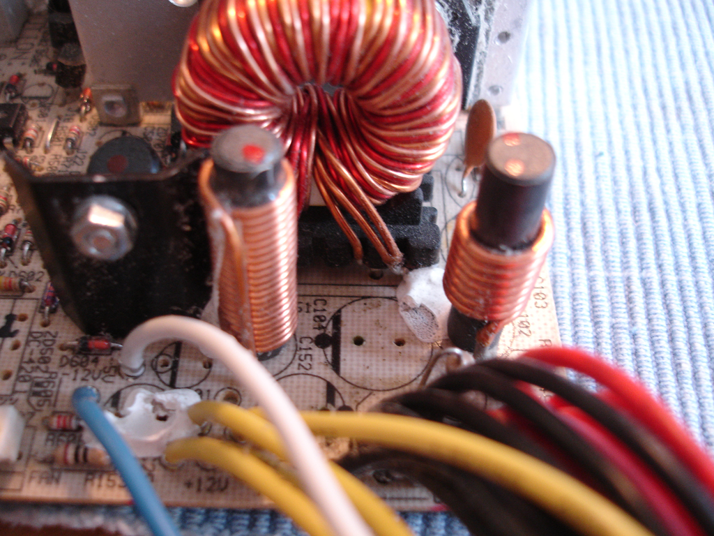

                    I have attached 6 new pics. The Delta Donor board , picture #1, shows the remaining X2 cap still on the board. These are 22uf 275V. Is this capacitance adequate? I note the Delta coil has way more wire turns of a smaller diameter than in goodpsusearch photo.
                    I am suggesting using a secondary coil shown in picture #2 taken from an old dead Deer PSU, and adjusting the number of wire turns and reorienting the leads to suit the "new Deer" DR-8500.
                    Are the number of turns on this ferrite coil significant? This coil is one continuous piece of wire wrapped around the ferrite core. For curiosity sake, what is the difference between this and the vertical coils shown, in picture 6, where the wire is coiled around a ferrite rod?i
                    If I yank the brown suitcase polypropylene cap at CX1 on the DR-8500 and replace it with the grey Delta X2 does the orientation matter at all?
                    I threw in picture #3 of the old Deer showing EI-33 in company with the EE-19, indeed suggesting that the DR-8500 ERL-35 is fake.
                    I am also suspicious of those "Saturn" 680uf primaries on the Deer DR-8500. The pics of the old Deer primaries,picture #4, show 470uf, but they actually measure 330uf with the capacitance meter.
                    Those polypropylene caps sound dangerous. Should they always be replaced with proper X-type caps?

                      Yes, I would recommend replacement of those. It would in fact be better without that cap at all, even if it kicks back more EMI, it means less fire hazard. China will do anything to cut corners...
                        No, this is completely not compatible. You need a coil taken from a primary filtering section of a power supply. The coil shown on the first picture (LFZ280..) is compatible, but unfortunately there is no space on your Deer psu for that type of coil. So you have to pick a coil like the one shown at my previous post. The other thing near the white X cap could be an optional filtering part that is used in some power supplies. Have in mind that the coil needs to filter both Line and Neutral of the AC.
                        X and Y caps don't have + and - iirc.
                        I didn't change them in a power supply I fully recapped, but I don't know if that's a good idea.

                          1. I thought those brown lumpy things are X caps?
                          2. I hope this PSU isn't an ICANN-accredited registrar

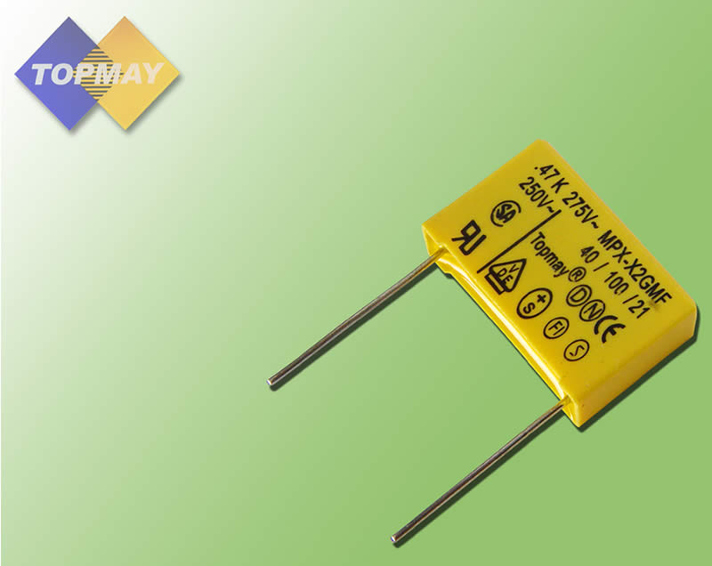

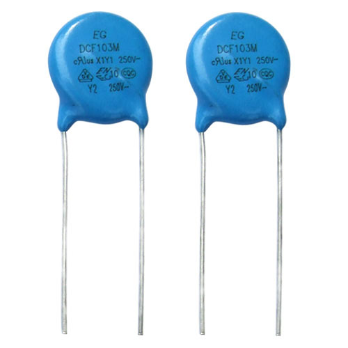

                            An X-cap looks like the left image; Y-cap middle; poly cap the right.
                            X and Y caps are safety rated. They are both rated to open on failure. X caps are live to neutral; Y caps are live-earth or neutral-earth. They must NEVER be interchanged.
                            I had a BBC Micro which had an X-cap failure. A bit of smoke came out of the back. You can see the failure in the below image:
                            https://www.badcaps.net/forum/attach...9&d=1325952789
                            This cap failed safely, as after letting the magic smoke out, it failed open.

                              Re X caps, Panasonic had/has one or more agency-approved series with polyester dielectric and dipped in brown epoxy. The one in that P/S could be one of those, though it looks a bit small. More likely a DC-rated polyester or polypropylene part. Both polyester and polypropylene can be used in agency-approved X caps. The part removed from the Delta P/S was made by Iskra, formerly of Yugoslavia (not sure if Serbian, Croatian or ??), and the "MKP" on the case means it's a metallized polypropylene capacitor.
                              PeteS in CA
                              • PeteS in CA
                                • Aug 2005
                                • 3583
                                • USA, Unsure of Planet
                                Further ... AFAIK, both X and Y caps are available in polyester, polypropylene, impregnated paper and ceramic dielectrics. So, for example, not all Y caps are disc ceramic like what tom showed; and I'm pretty sure that box case X cap in his pic has polypropylene dielectric. As I mentioned above, there are agency-approved parts in epoxy-dipped packages, and Roederstein had/has X caps in a cylindrical radial-lead case.
                                Bottom line, you have to read the markings on the part. Look for the agency approval marks. Look for a "~" after the voltage. Look for "X" or "Y". Look for "MKT" or "MKP" (metallized polyester and polypropylene). I wish I could say there is consistency from brand to brand, but those are common markings. You might need a magnifier for some of the smaller ceramic disc parts.
                                PeteS in CA
                                  That is new to me. I've only ever seen the box type X caps and blue dipped Y caps. I thought it was an industry standard of sorts. I wouldn't entirely trust the markings though, as they could be fake, like a lot of things in the cheaper PSUs.

                                    Yes, some could be fake. I have seen a few blue 'y' caps which only say '102M 250v'. Only once have I seen a regular red film cap used as an x-cap.
