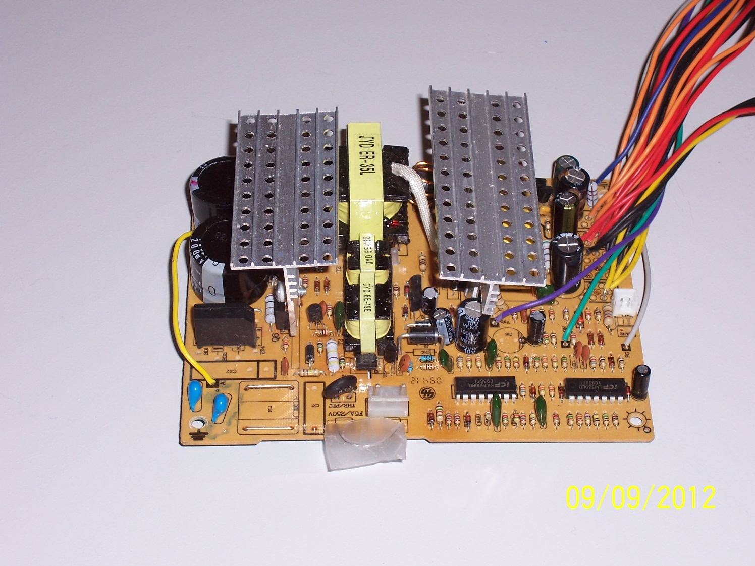

    I removed this power supply pc board from its case because I was going to part it out. I didn't think it was much of a power supply. Then I noticed it was a little different. It has 100 Mfd/200 volt Nichicon CE capacitors for mains. The pwm chip is a KA7500B. The switching transistors are C2553 rated for 400 volts 4 amps. So now I am wondering which case I pulled it out of several months ago. Anyone want to venture a guess as to who made it?

    Well, at only 100uF per primary cap... I'd rate it at maybe 50-60W output, possibly a little more but you'd be squeezing it. So either a really cheap crappy PSU or one for very low power computers, I'm betting on the first as I've never heard of a 50-60W ATX PSU (and I'm pretty sure it's ATX - it's got a standby transformer.)

        Based on the number of wires coming out of the secondary side, the power supply was probably rated for 80-120w output.
        It doesn't even have a lot of extra holes for 5v and 3.3v wires, the main voltages that were used on this psu (I see a '94 date code on the pcb).. and the wires that are there seem to be AWG20 or some other thin stuff.
        So 100uF is probably not really that bad... my Delta 100w psu has a single 220uF 400v cap.
        The transformer is also big enough, much more than needed. Overall, it looks good to my not so experienced eye.
        Maybe it's from some small factor Compaq / Dell system from those times, that had no options for video cards or hard drives?

              A 4A rectifying bridge is more than enough for 100-200W, assuming that the secondary rectifiers are up to par.

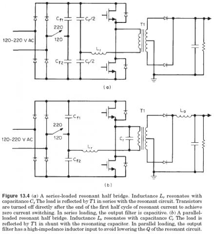

                Re: Mystery power supply
                The two caps are in series is setup as voltage doubler setup for 120/230v Operation, or part of the Half-bridge drive setup.

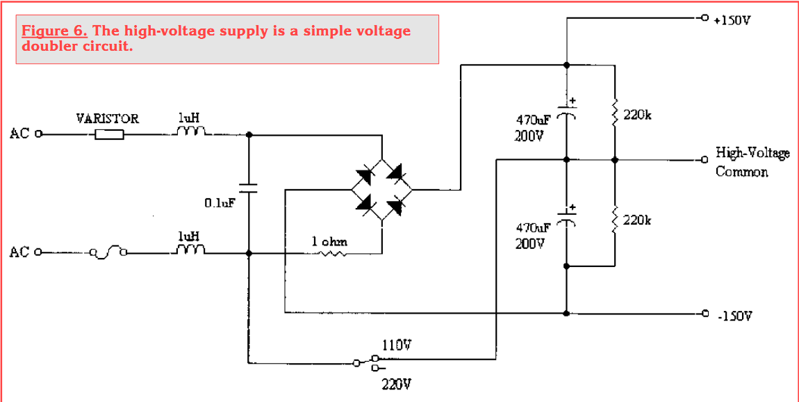

                    Capacitors in series:
                    1 / Ctotal = 1/C1 + 1/C2 + ... + 1/Cn
                    On this power supply like it was already said, the capacitors are in a voltage doubler circuit :
                    Ignore the actual values.. btw got this from https://cdn.badcaps-static.com/pdfs/...44a9724ffd.pdf which is pretty interesting
                    In this power supply above, the psu is set to 110v input using that yellow wire.
                    On Active PFC power supplies, the voltage can go up to about 350-400v.
                    Depeding on the power supply topology, even with active pfc it's possible to need 2 capacitors, because of how the psu works.
                    Rather than simplifying and screwing the explanation, see this app note: https://cdn.badcaps-static.com/pdfs/...4fc807c47b.pdf
                    You'll find the half bridge converter at page 19 - that's one of the topologies that works fine with two primary capacitors.

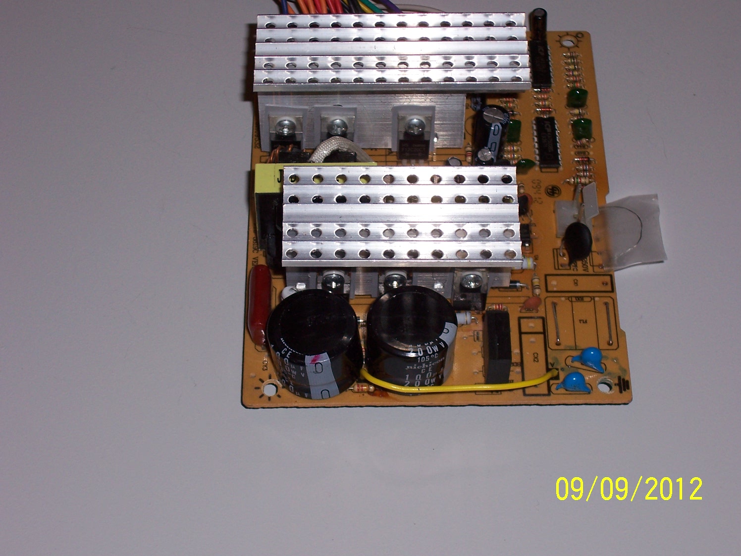

                        Did ANYONE see a fuse on the PSU? I didn't!
                        Muh-soggy-knee
                        • mariushm
                          • May 2011
                          • 3799
                          What do you think that thin wires taped on the pcb at the bottom is about?
                          • Behemot
                            • 4845
                            • CZ
                            Yep, the thin wire inside transparent tape
                            I have lately seen similar fuses…original blown 25A car fuses inside UPS were soldered over with thin wires. I am curious how precise that was, +-10 A?

                              You are correct. The fuse was blown when I got the power supply. I soldered a thin wire across the fuse holder and wrapped tape around the wire to prevent splatter if it should blow. So far it has not blown. Known as my "economy" fuse!
                              When I wiggle the green wire on the 20 pin ATX power connector, the power supply intermittently turns on and off. That may have been the original problem.

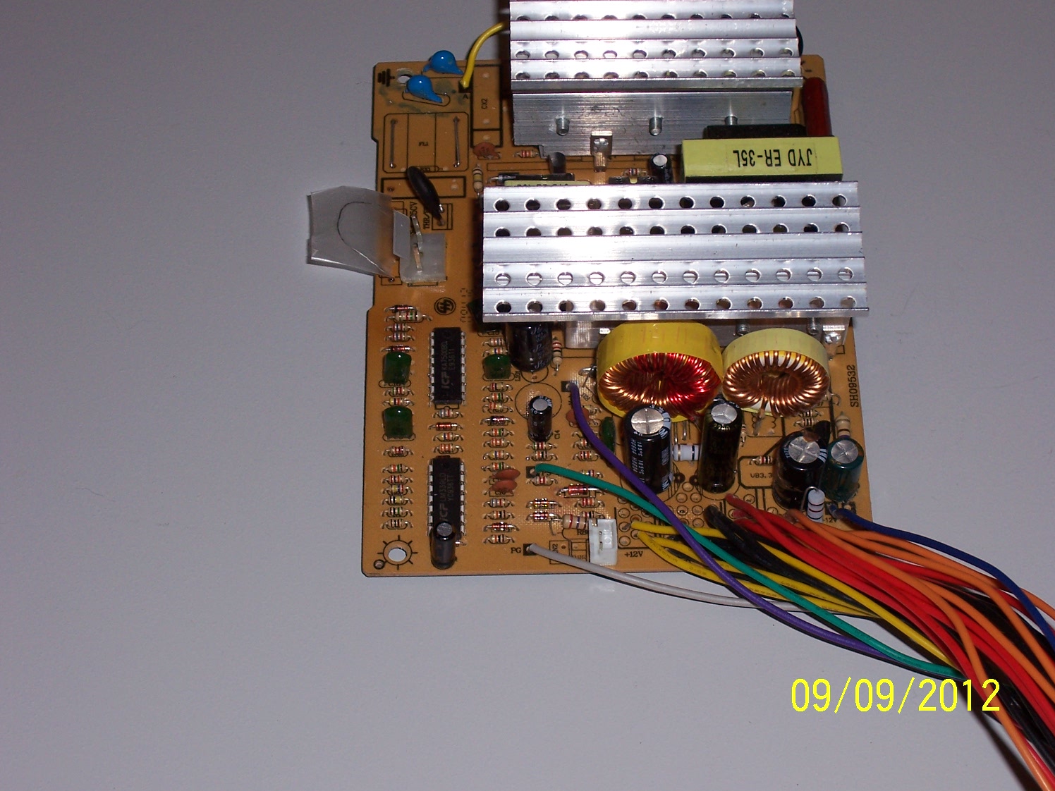

                              Anyone ready to take a guess at who the manufacturer might be?
                                  Leadman or Sun Pro maybe?

                                    Or maybe any generic chineese one? They all share almost the same design. You can see e.g. empty position for second fan connector, characteristic heatsinks, +5V SB diode, 2 small transformers and so.

                                      If it were a cheap L&C I would expect the pwm chip to be a "chip of the year" 2003 or 2005. The pwm chip on this one is KA7500. The output rails do not have pi filters, only output capacitor. No coils. I don't know if Sun Pro would stoop this low!!!

                                        I am interested too. Eurocase here got many models lately like this one. There is the 2003 PWM, but, they got also similar, more full and even 550 W rated models. They can really do arround 400 W, never stressed it more. Posted one here.
                                        You think only L&С does these? I have seen some which used green transformers, totally different heatsinks, but other than that were almsot same. They looked like some chineese CWT scam made according to this topology…
