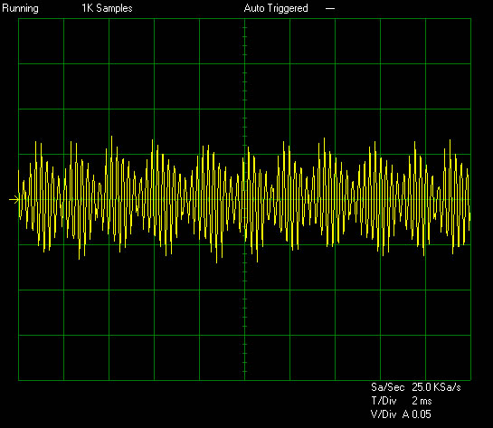

    Hi frequency = radical voltage fluctuations?
    Technical question here.....
    The FSP Epsilon units no doubt lack any kind of mass.
    I understand that is the voltage is rectified at a very high frequency, smaller components can be used.
    Most PSU's are 50kHz, but I'm guessing these FSP's are probably better than 100kHz.
    Typically, PSU manufacturers stay away from this practice because the high frequency causes horrible EMI.
    I have both an OCZ GameXstream 700W and FSP Epsilon 600W and both exhibit a HORRENDOUS fluctuation on ALL of the rails. On the 12V rail alone, I'm seeing .05 at low loads and .1V fluctuation at anything above 50%.
    Typically when I see this, I also see a lot of "bounce" on the output voltage reading on the ATE. I don't see this with these FSP's, but it could be because the fluctuation is so rapid, that the LED's (which only have about a half second refresh) don't pick it up.
    So...
    Is the EMI creating the crazy voltage fluctuations?
    Is the EMI causing the O-scope to report false readings?
    Does the fluctuation have anything to do with the EMI ro frequency of the voltage at all and that FSP's of this genre just have poor voltage regulation?
    Any insight would be appreciated. I'd like to get the OCZ review done for the weekend.

    Re: Hi frequency = radical voltage fluctuations?
    The 600W is doing it too? Very interesting... I wonder if the secondary caps aren't just a bit undersized. I was somewhat concerned about the multitude of Capxon 1000uf in there. This isn't helping me think of these units as FSP's top of the line next to the independantly regulated older generation server units.
        At any rate, it's probably some side effect from the higher switching frequency. Just looked at Xbit's review again... he said he got ripple as high as 78mv on the 12v.
            Unless the components in question are filtered enough to be resistant to such short pulses...
            These seem to be getting real popular real fast though... haven't heard any major complaints about instability, even when overclocking to the moon. I guess when they designed these, they went for power first and compromised a wee bit on stable regulation.
            Certainly they're no replacement for the regulation in Zippy or other high end units.
                Are the fluctuations periodic? If so, does the period match the switch frequency. If it is periodic but doesn't follow the switch frequency, but is several hundred Hertz to several KHz, you may be observing oscillation. OTOH, if the fluctuations aren't exactly periodic, is the +12V O/P powering a DC fan? If it is, DC fans draw current in large pulses, and that might be the source of the "problem"; also, if there is a separate fan O/P, but the mfr. goofed the PCB layout, fan noise may be getting into the feedback loop.
                Just some ideas. One way to see how much radiated noise is affecting your oscilloscope is to clip the ground lead and the probe tip to the same point (usually circuit ground). Whatever spikes you then see are due to picking up radiated noise.
                  I think this is due to the active PFC circuitry they are using in that psu`S. I am not realy familiar nor i have understand the full benefit from this new circuit desing, but i have seen some differences, an APFC circuit can deliver. Firsyt, the APFC controler is normaly an stepup regulator, e.g it is desinged to bring the voltage from any moment of the sinwave up to the nominal 300 or 400v, wich is then stored in the i/p cap. As the voltage is very high, the capacitance of the I/P cap could be degreased, but voltage musst be higher.
                  Then this b
                      I think this is due to the active PFC circuitry they are using in that psu`S. I am not realy familiar nor i have understand the full benefit from this new circuit desing, but i have seen some differences, an APFC circuit can deliver. First, the APFC controler is normaly an stepup regulator, e.g it is desinged to bring the voltage from any moment of the sinwave up to the nominal 300 or 400v, wich is then stored in the i/p cap. As the voltage is very high, the capacitance of the I/P cap could be degreased, but voltage musst be higher 8in normal psu`s the v is maxed to 300 or some 320v, but unregulated.)
                      Then this preregulation of the i/p voltage enables the desingner to use a somhow sepciall desing, wich will act like a dual phase vrm (in my noobish understanding ;-)).
                      So, even if the nominal fruequency is the same, there are two independent pulses with a 180° shift.Therefore the o/p capacitance can be dramatically degreased, and the regulation will be very fast, like they will have choosen the doubled switching frequency (may be this is as trivial as an full bridge smps, but i don`t know why this needs the APFC circuitry).
                      So in the end, it is obviousely, that you can`t reach that perfect stable power like an simpler unit with lots of bulk capacitance, as a good capacitor with very low esr will close to an perfect power source. But adding to mutch capacitance will slow down the regulation loop as far as i have understand that,but this means to sacrifying the fast regulation capability of this circuit. But of course, as caps will cost some money, the PSu maker wants probably only reach the specifikation, wich will tolerat IMHO about 120mV ripple on the 12v rail. And those fluktuations are no subjekt in those specifikations, as long as they are within the voltage tolerance (e.g +-5%)
                      I have seen similar behaivior in all APFC units i have owned (e.g Seasonic ss400SFS, 300FS, Amacrox Frei Erde 500w, FSP Bluestrom).
                      Some of those APFC units e.g Seasonic S12 will itroduce some 10MHZ noise into the power lane. As those frequencies aren`t in any harmonic regulation....they probably skimped out on the filtering.
                      This theory is based on the 80+org sample shematic, wich is IMHO from ST micor devices.May be some other sources i have read too.
                            These are rail readings. I'm not oscoping the main transformer.
                            I'm sure I'm wrong, but how is the APFC circuit going to affect the DC output so dramatically?
                            Here's the 12V2 on the OCZ 700W during test 5:
                            X is 2ms, Y is .05V. As you can see, I'm seeing about a .12V wave there.
                            By comparison, here's the 12V2 on an Ultra X-Finity 600W during a similar test:
                            Here's the 12V2 on an Antec TP2 550W:
                            BFG 650W:
                            Understand the concern?
                                johnny, try changing the trigger source to "Line". Looks to me like you're observing line frequency ripple. If it syncs up, then it's line frequency ripple.
                                  Guys....
                                  The O-scope is not set any differently than when I tested any of the other PSU's. The OCZ was done prior to my ST75ZF test. The ST75ZF's test results didn't warrant concern.
                                  I put another PSU (a Mushkin) back on the tester after I did the FSP 600W and the results of that do not warrant any concern.
                                  Please read: I can take any of these other PSU's and plug them in and not touch any settings on the O-scope program and get predictable results (see photos.) I can unplug any of those PSU's and plug in either an FSP or OCZ and get the > .12V fluctuation.
                                  The only variable here is the PSU. Two different PSU's from the same manufacturer.
                                  Not the o-scope, the load or the o-scope settings. The o-scope settings are the same in all of my tests. I don't change them so I can make side by side comparisons like this.
                                  I also checked to make sure there was no interference with the o-scope and cables. I've seen where sometimes if the o-scope shielding touches the chassis or the o-scope is too close to the PSU or the load tester, etc that I get interference. O-scope is free from any of this. It sits on the bench. Nothing touches it. Same place it sits during all the tests.

                                    Originally posted by Oklahoma Wolf
                                    According to Xbit, the switching frequency is around 55kHz for the FSP...
                                    Really? That would be very disappointing. I can see using a higher frequency in an effort to use smaller components, but if the frequency is the same as any other PSU on the market, and the components are smaller, and the heatsinks are smaller... then I'm not in the mood to conclude this is a decent power supply. Would you?
                                      According to Oleg in the review, most PSU's are below 30kHz... that's why I was thinking the sampling frequency on the scope may be perhaps too low for this particular PSU. Then again PeteS knows a lot more about the engineering side of these than I do.
                                      Here's the quote from Xbit:
                                      Originally posted by Oleg Artamonov, Xbit Labs
                                      Another interesting feature of this power supply is the increased frequency of the PWM regulator. It is usually near 30kHz (this looks like fluctuations at 60kHz in oscillograms of a PSU's output voltages since the push-pull inverter doubles the frequency). In the Epsilon this frequency is 55kHz or almost two times higher than usual.
                                      http://www.xbitlabs.com/articles/oth...roundup_7.html
                                        John, that looks like a nice AM signal to me. You could discern the frequency components by looking at the FFT of the signal. I'm not sure if your scope has an option to do this or not.
                                        If you noticed, all your PSU's display the same AM envelope, but the OCZ has a higher frequency carrier. The problem of higher harmonics is usually due to small valued filter caps. My wild guess would be that the envelope is due to the input caps, while the higer harmonics are due to the output caps.
